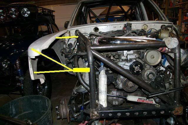

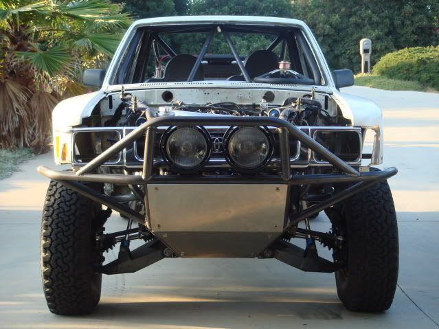

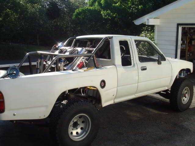

Hi all,
Here is a little bit about my build up project:
1992 Pickup, 4x4, 5 speed. 22RE, extra cab. Caged front to rear with 1 3/4" 4130 Chromemoly. JD Fab upper and lower arms. 930 cv's with custom axels. Sway-a-way 300m race torsions. Fox bypasses and set up for fox 4" air bumps. Full Total Chaos steering system. 62" leafs set up for 16" fox shox and air bumps. Jazz 22 gallon cell. Brand new pierburg fuel pump. Relocated PWR radiator to rear Meziere external electric waterpump and a TON more stuff that I am forgetting. More story and pics to come.

nice fab work.
what glass is that?

Thanks, The rear is Hanneman Tacoma Conversion and the front is old school Downey.
