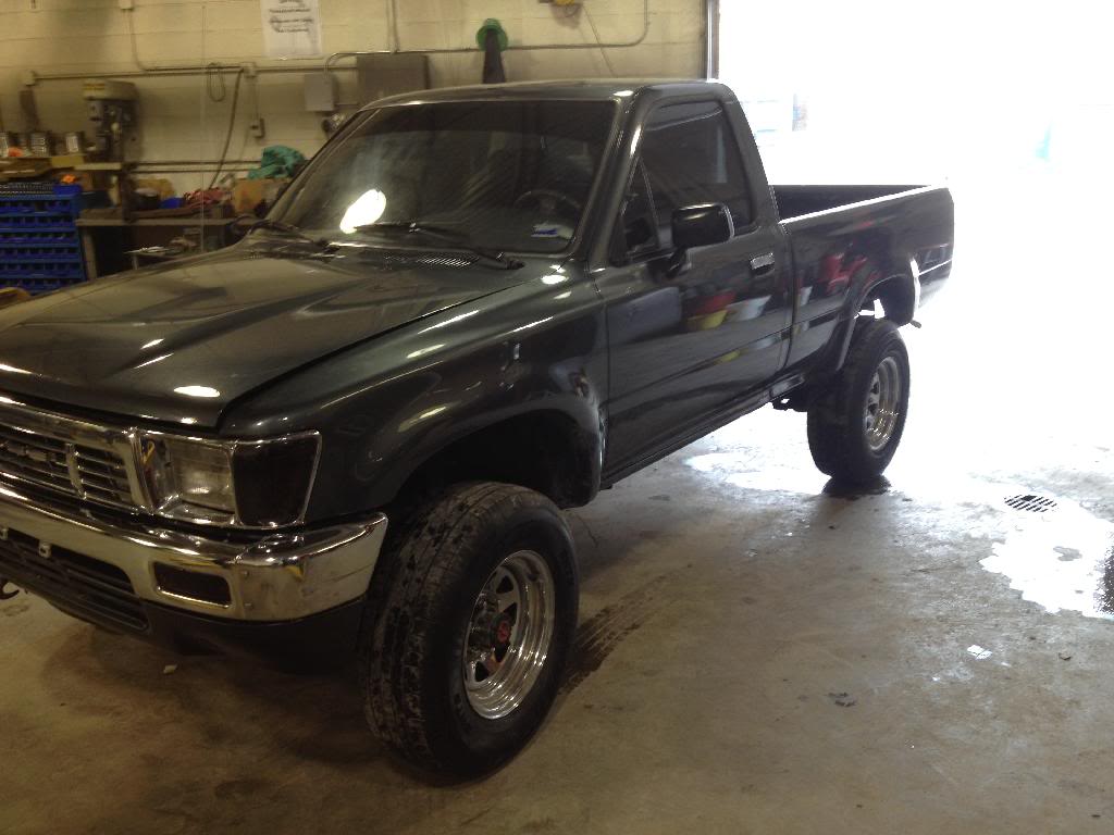

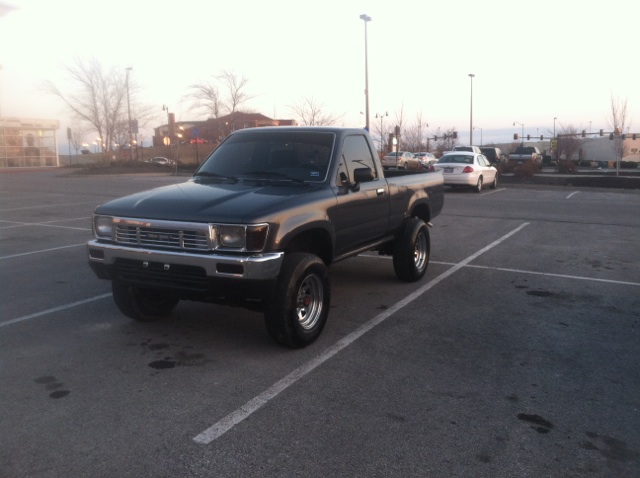

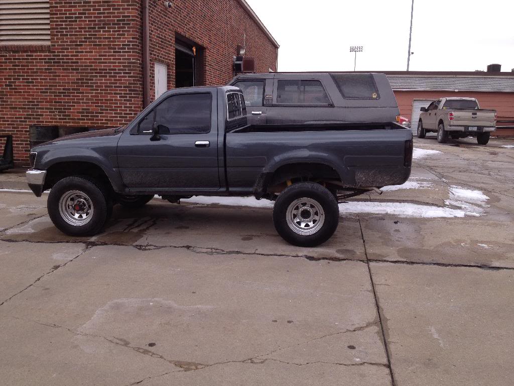

I just bought my first toyota pickup. It is a 2.4L single cab. I drove about 2 hours to go pick it up and I'm sure glad I did.

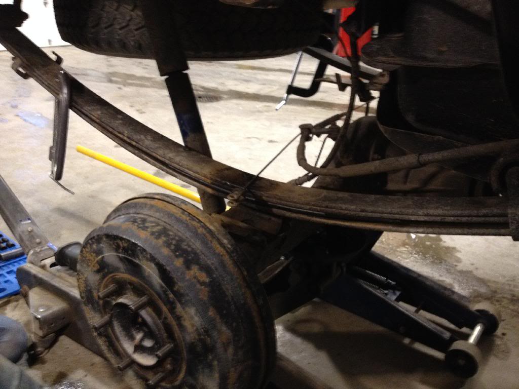

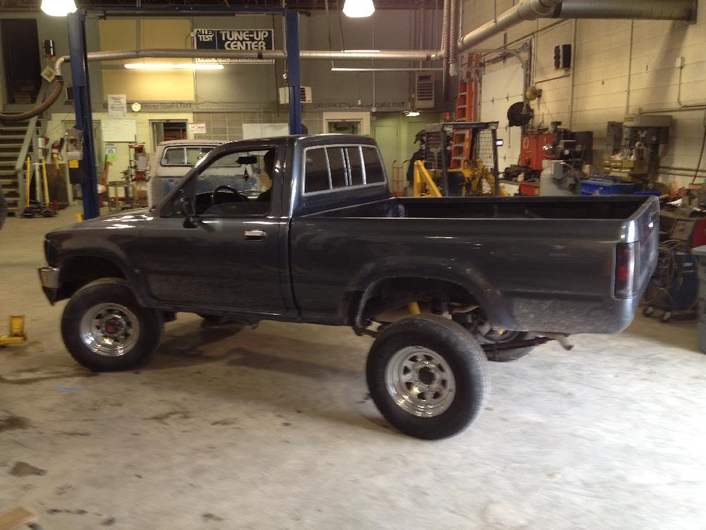

Put an AAL in

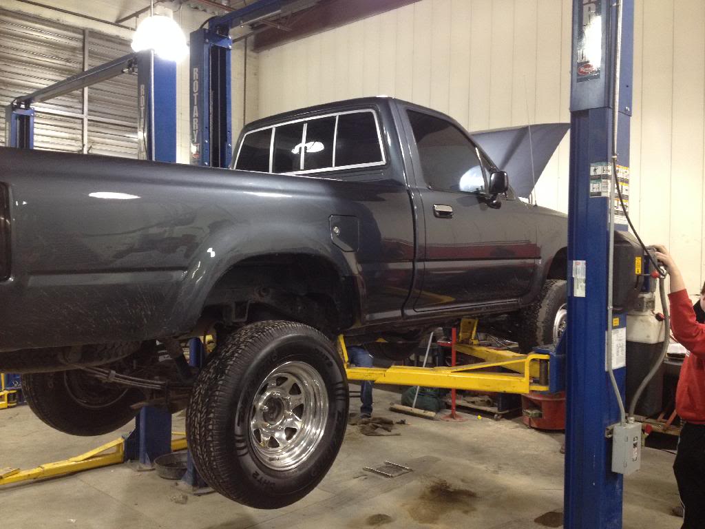

From: Pennsylvania

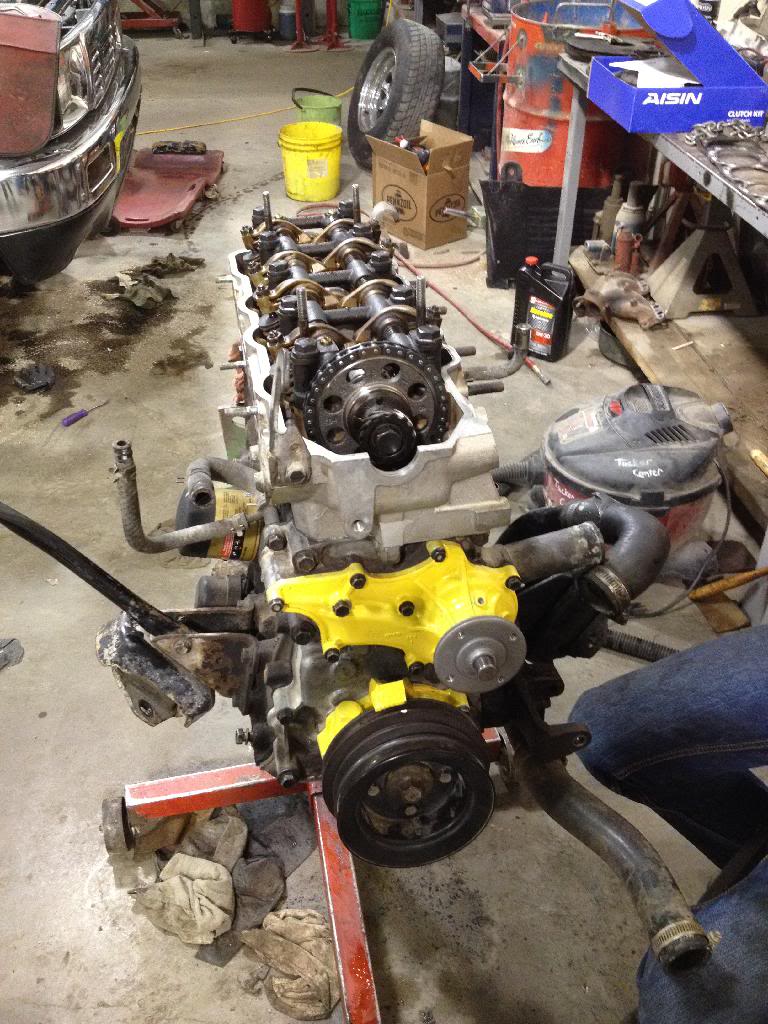

Ill help you out with an update here.

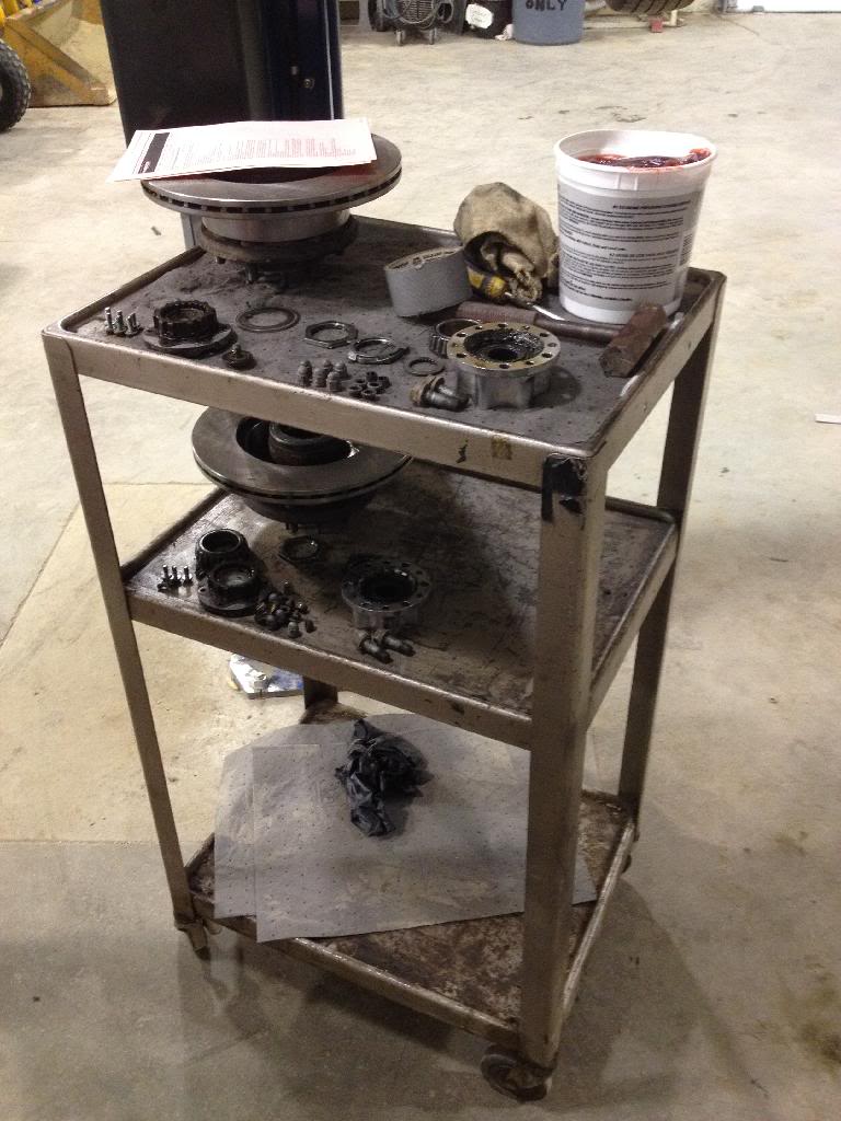

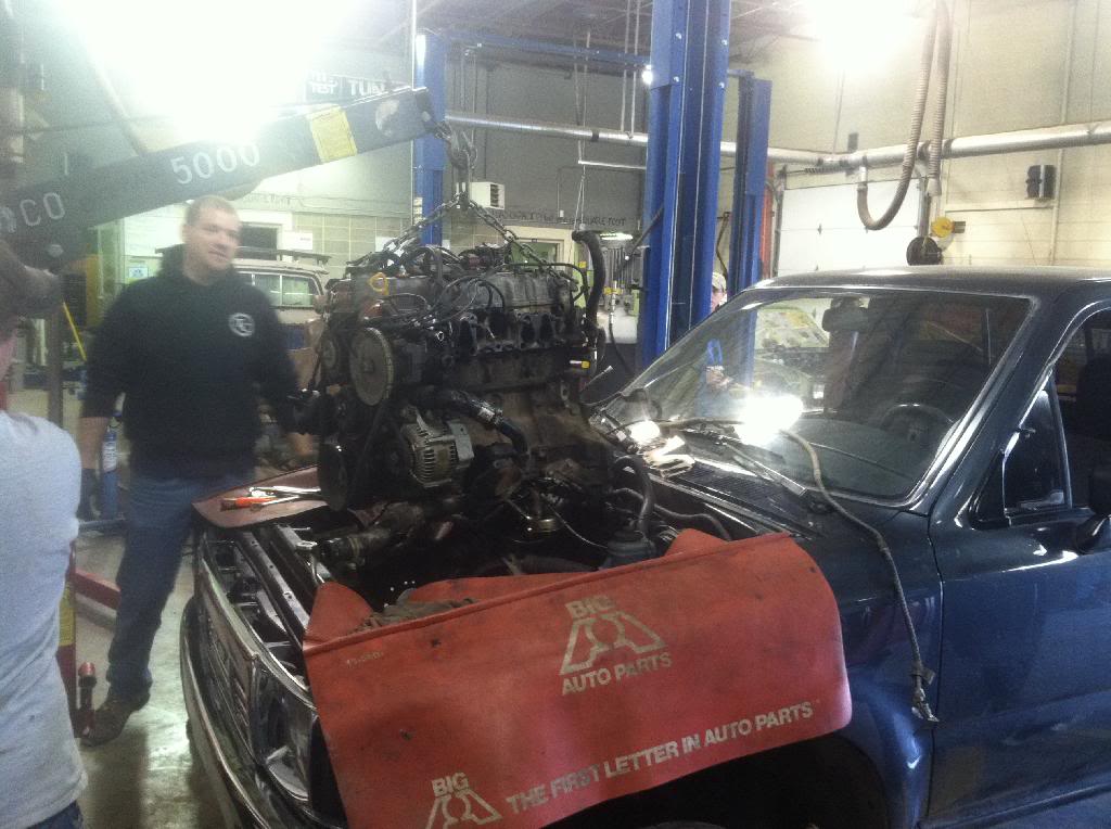

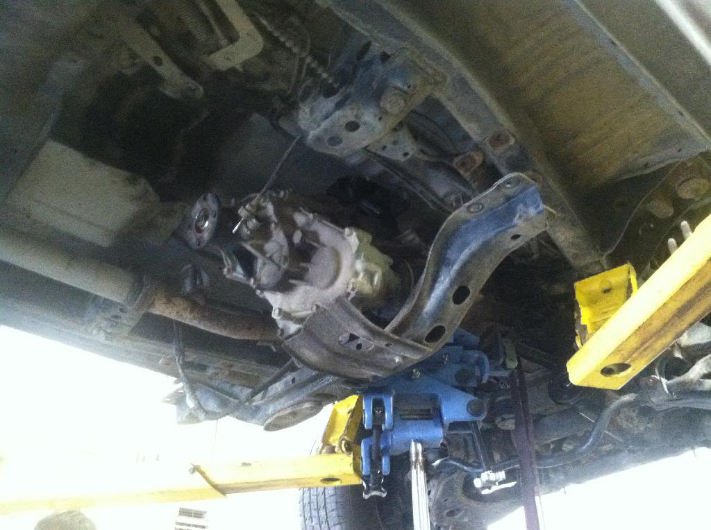

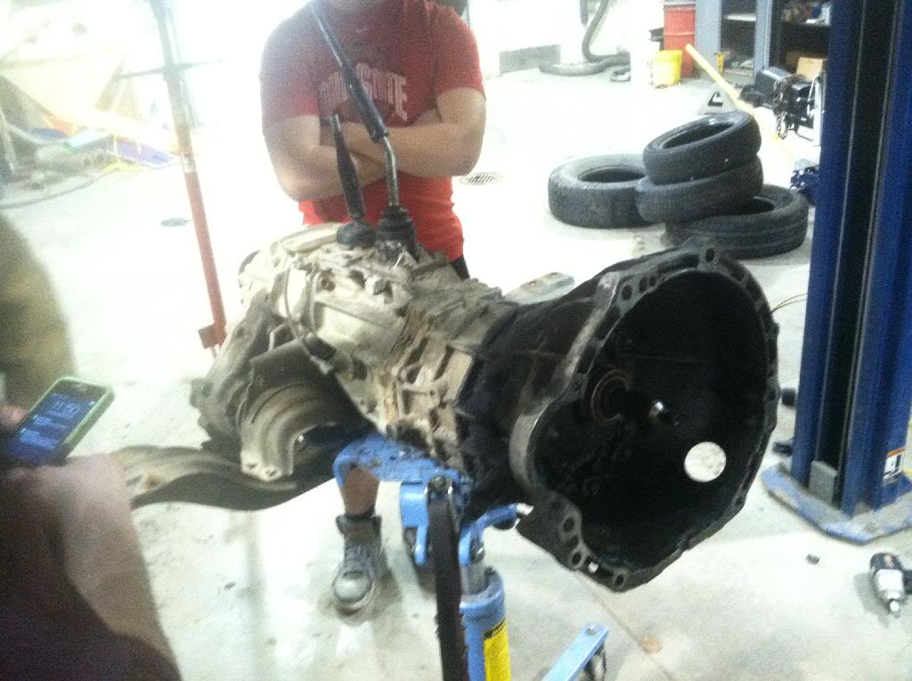

Decided he wanted to change out the rear main, new clutch, and a new to him transmission that we got from 283yotacrawler.

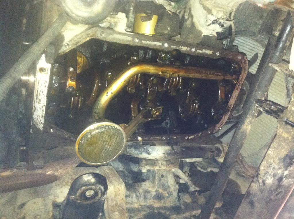

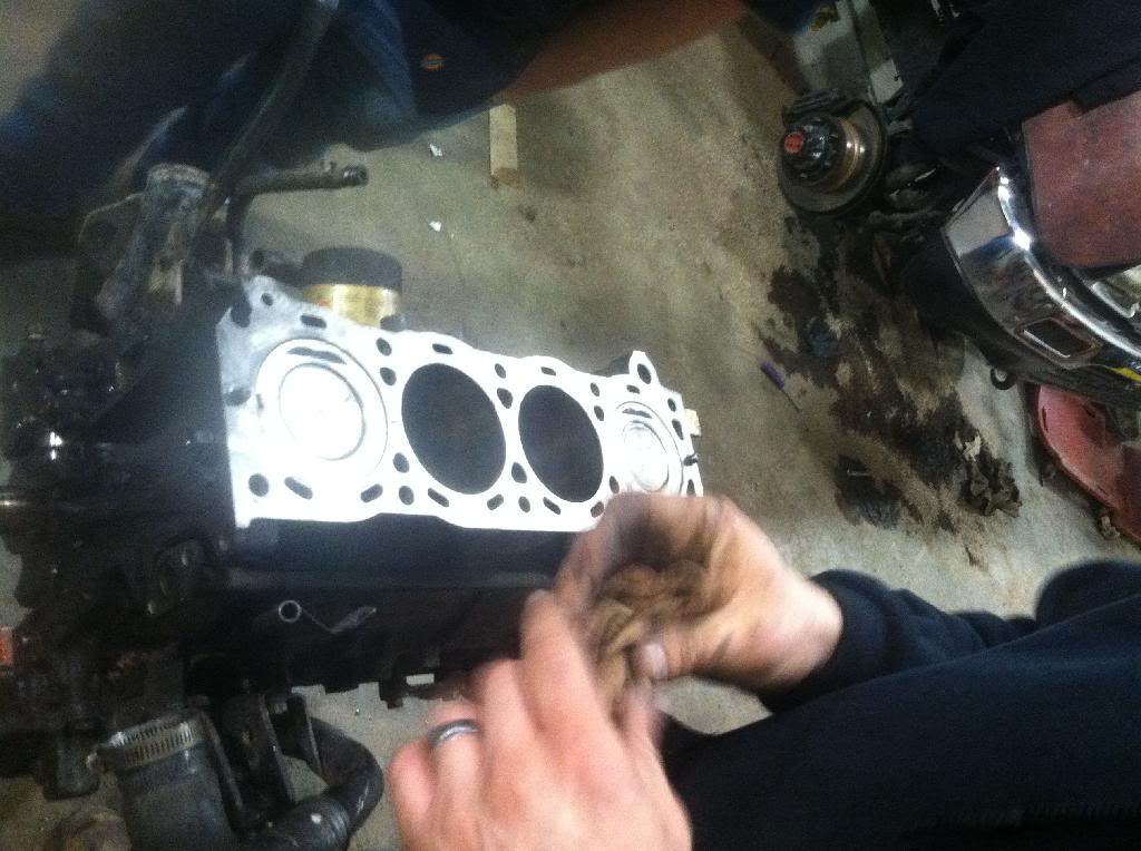

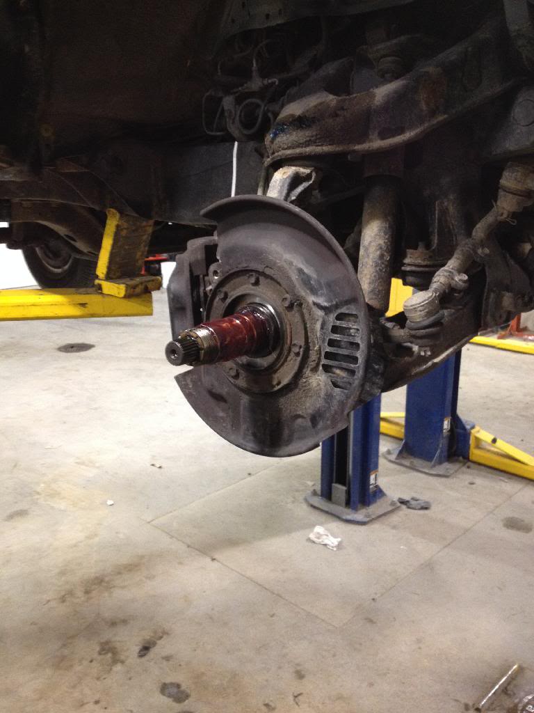

Upon dropping the tranny and front diff to access the oil pan removal, we found bits and pieces of the timing guide in the pan. So I suggested that while we are this far, we just pull the engine.
Now we are going to tear it down and do the timing kit, oil pump, water pump, head gasket, head bolts and any other odds and ends that it will need.

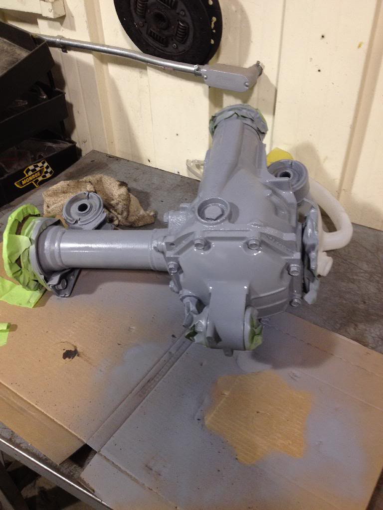

Painting the front diff.

Dropping the transmission to replace my rear main seal.Name:  9AD8B0B0-AB7F-44AE-81B7-051C845C9606_zpsasxmhlkc.jpg

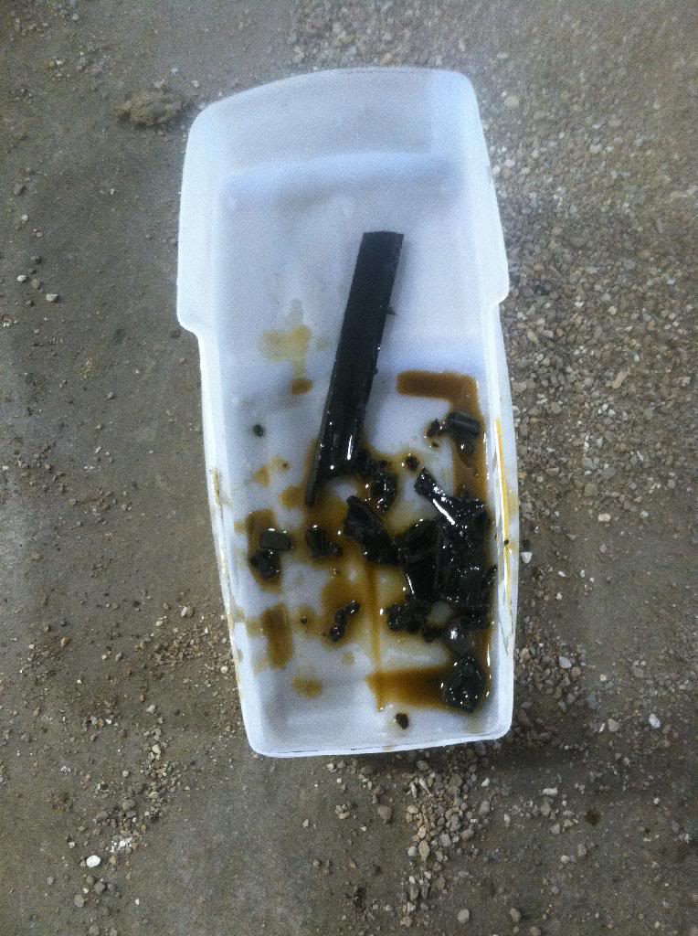

Found a part of my timing chain guide shredded up and sitting in my oil pan. Luckily we fought it before the chain rubbed a hole in the timing cover.

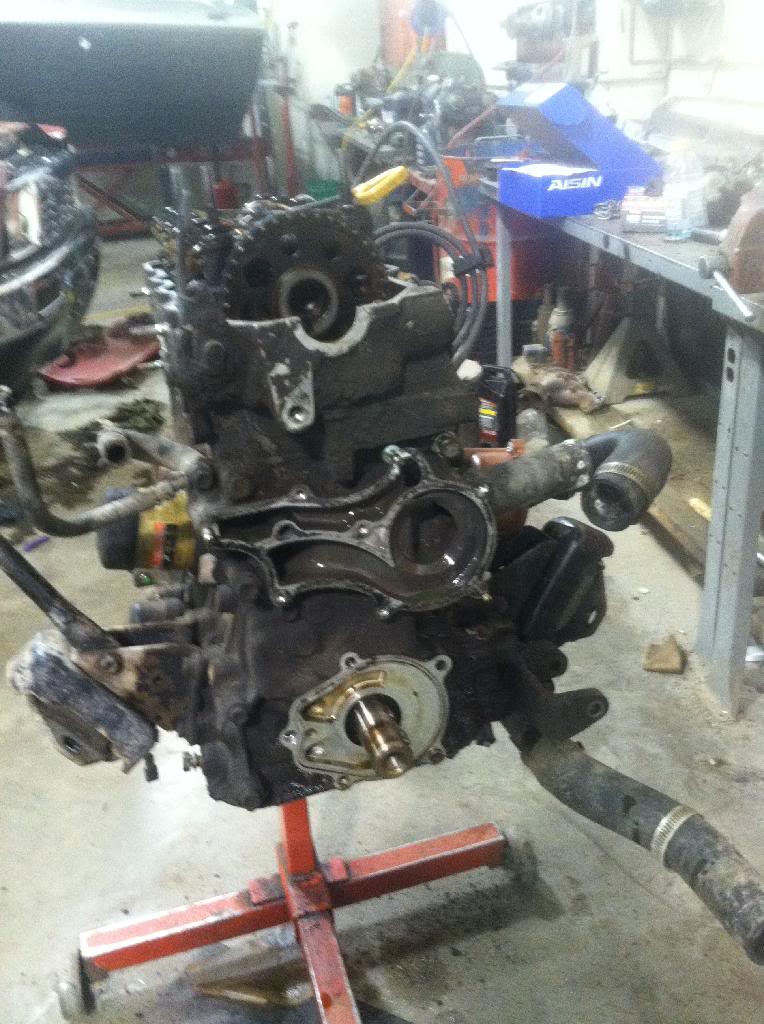

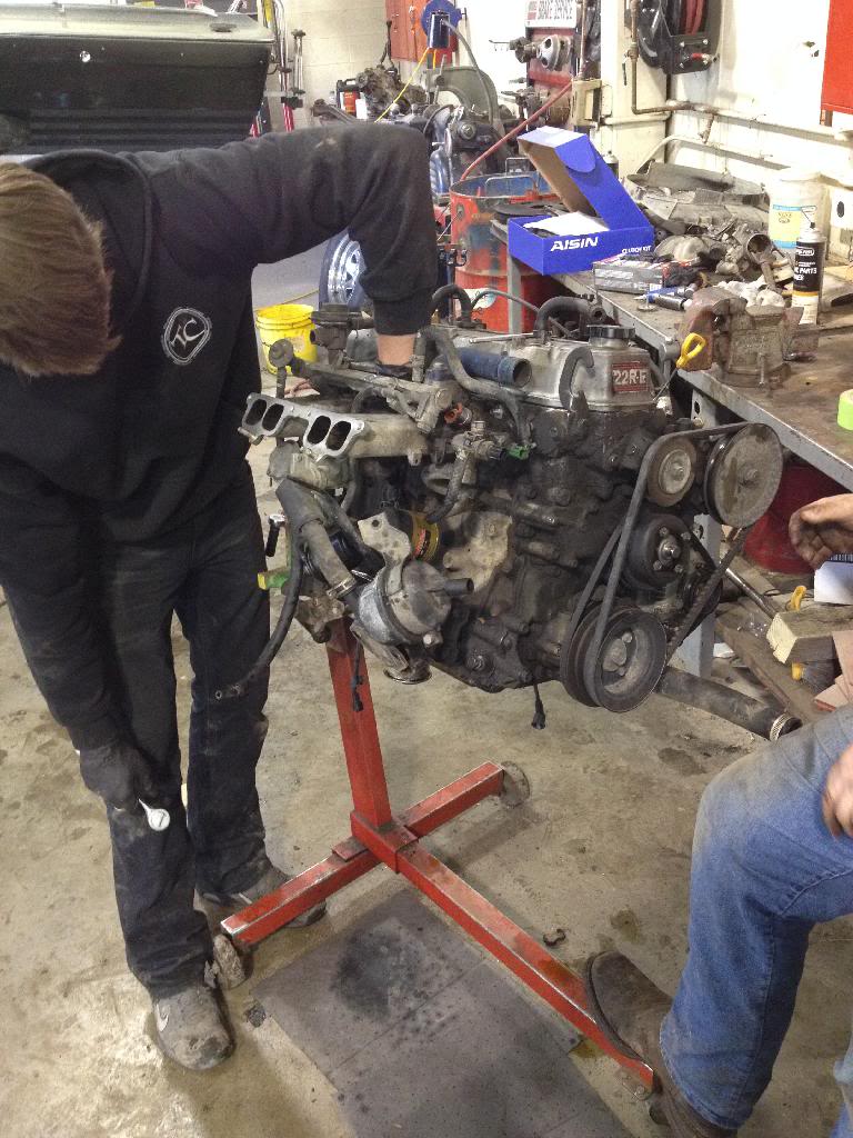

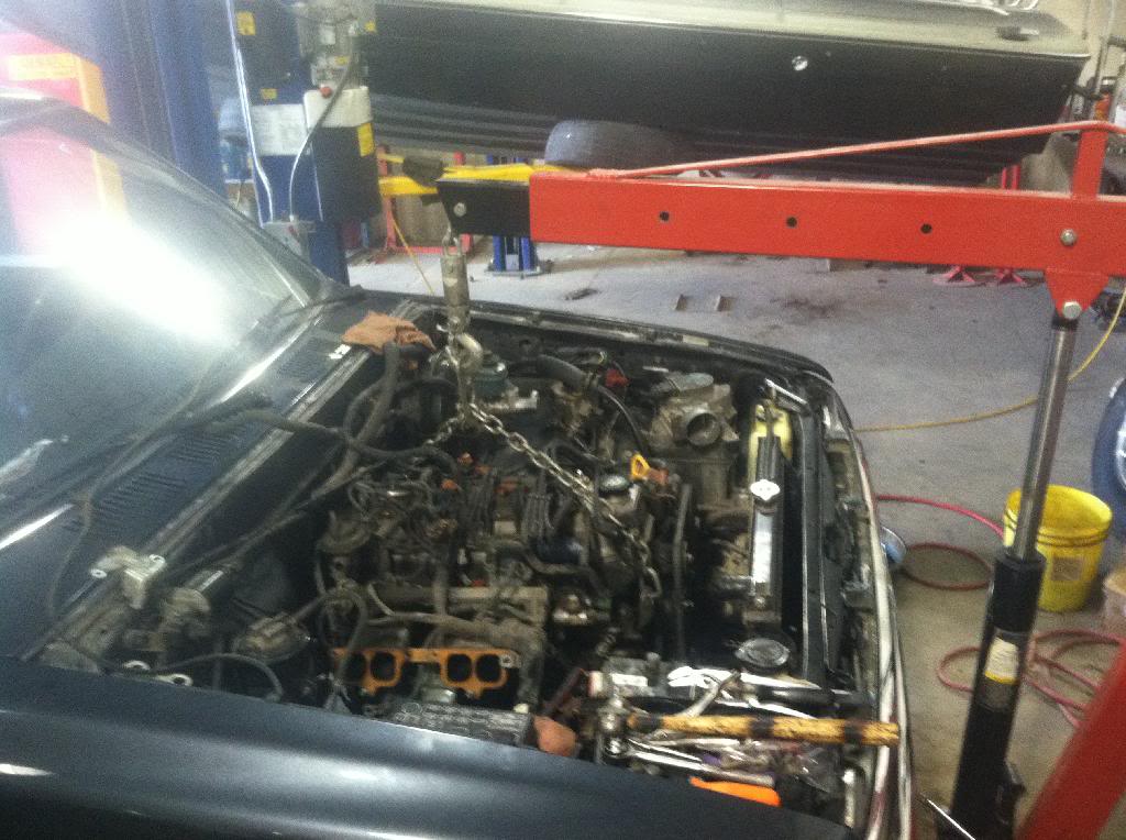

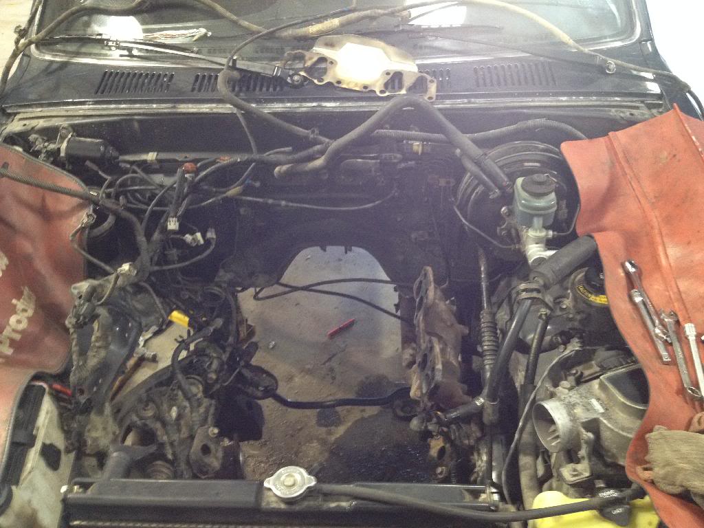

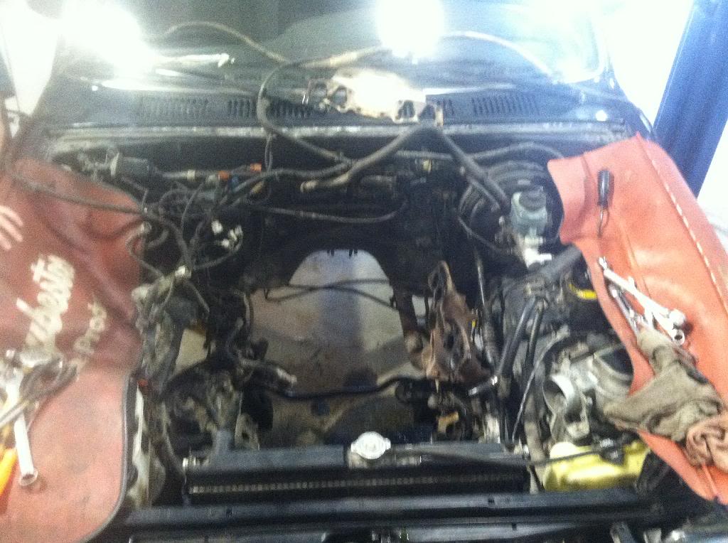

Decided I am this far into it, might as well pull the engine out and see what I'm working with beings I just got the truck, who knows what has/has not been done to it in the past!
And she's heartless

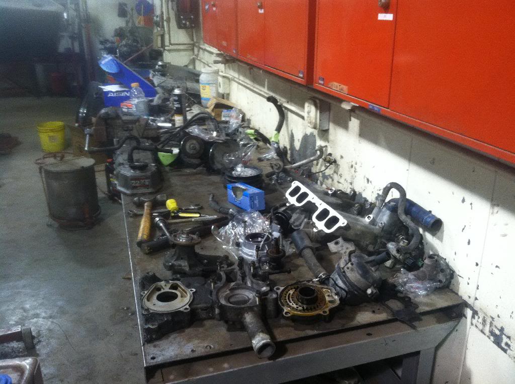

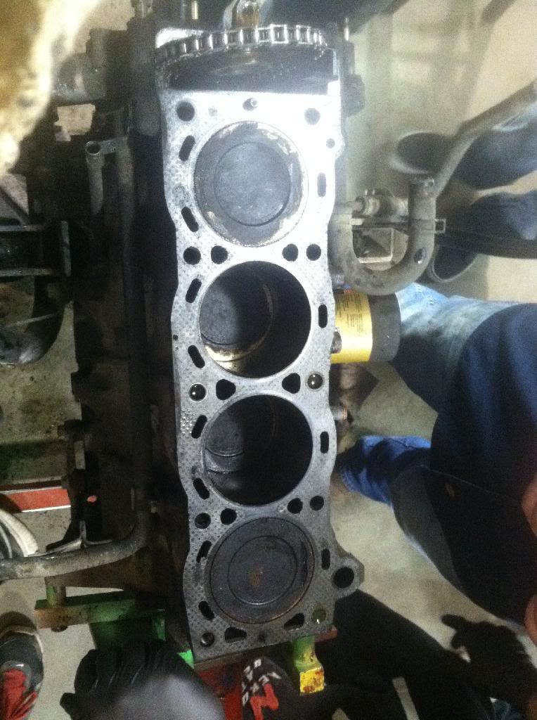

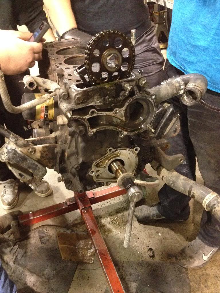

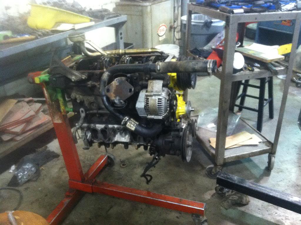

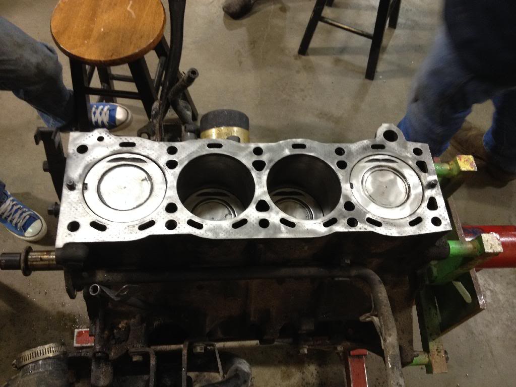

Got the engine on a stand and started tearing it down to access the timing cover

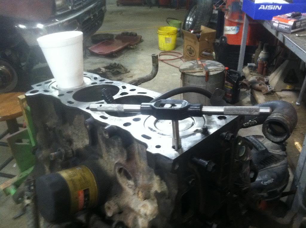

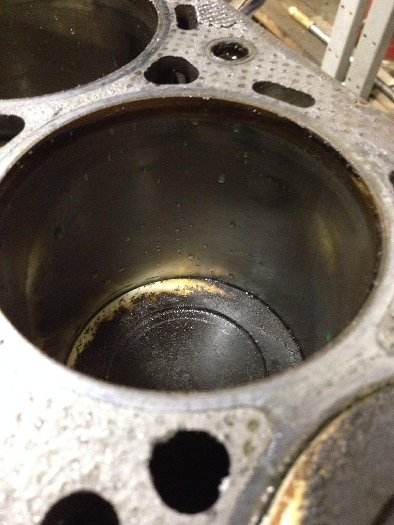

Getting the block all cleaned up for the new head gasket. Also going to tap out the threads for my new bolts.
And a table with all of my stuff in order and in labeled baggies.

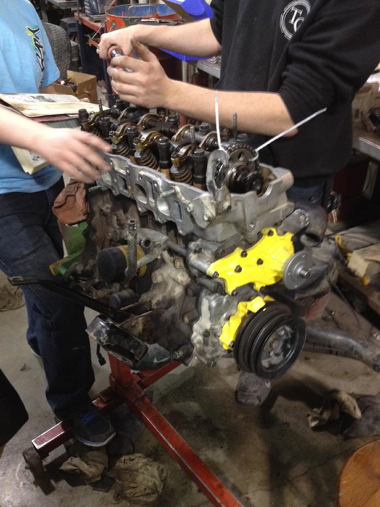

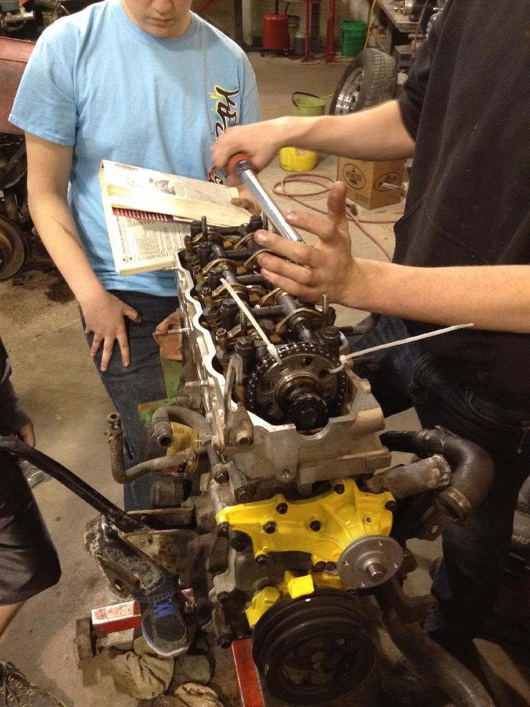

Old Mar 27, 2014 | 05:42 AM
Gizler00's Avatar
Joined: Aug 2007
Posts: 3,276
From: Pennsylvania
Heres a few pics for you kiddo.
Nick torquing the head bolts
All torqued down

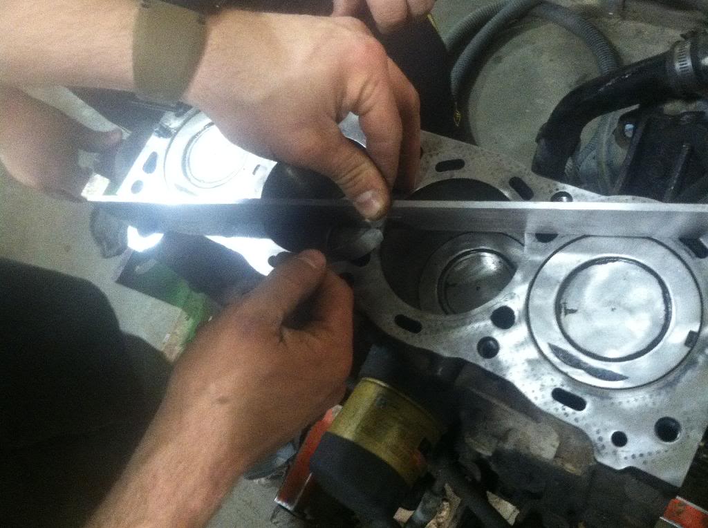

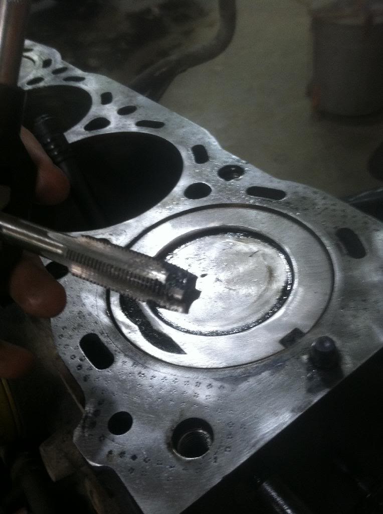

Tapping out the holes for the head bolts.Name:  583EE3C1-65A6-4CAC-B385-A7766B2D2AB0_zpsjlkauumr.jpg

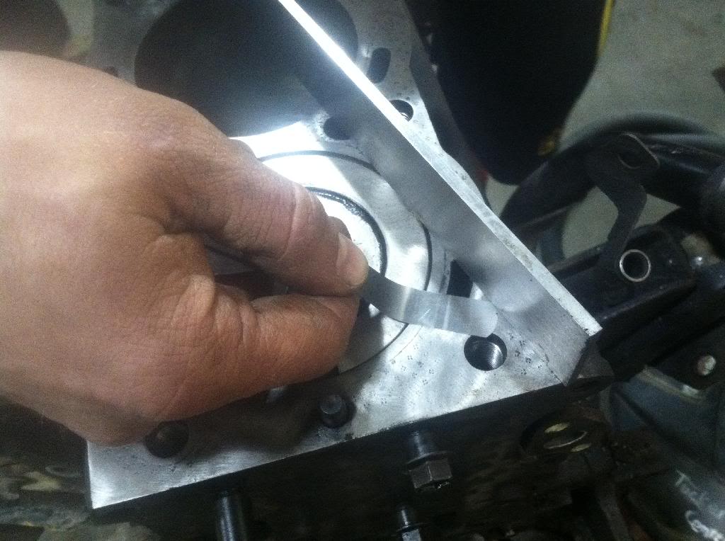

Making sure the head and block aren't warped

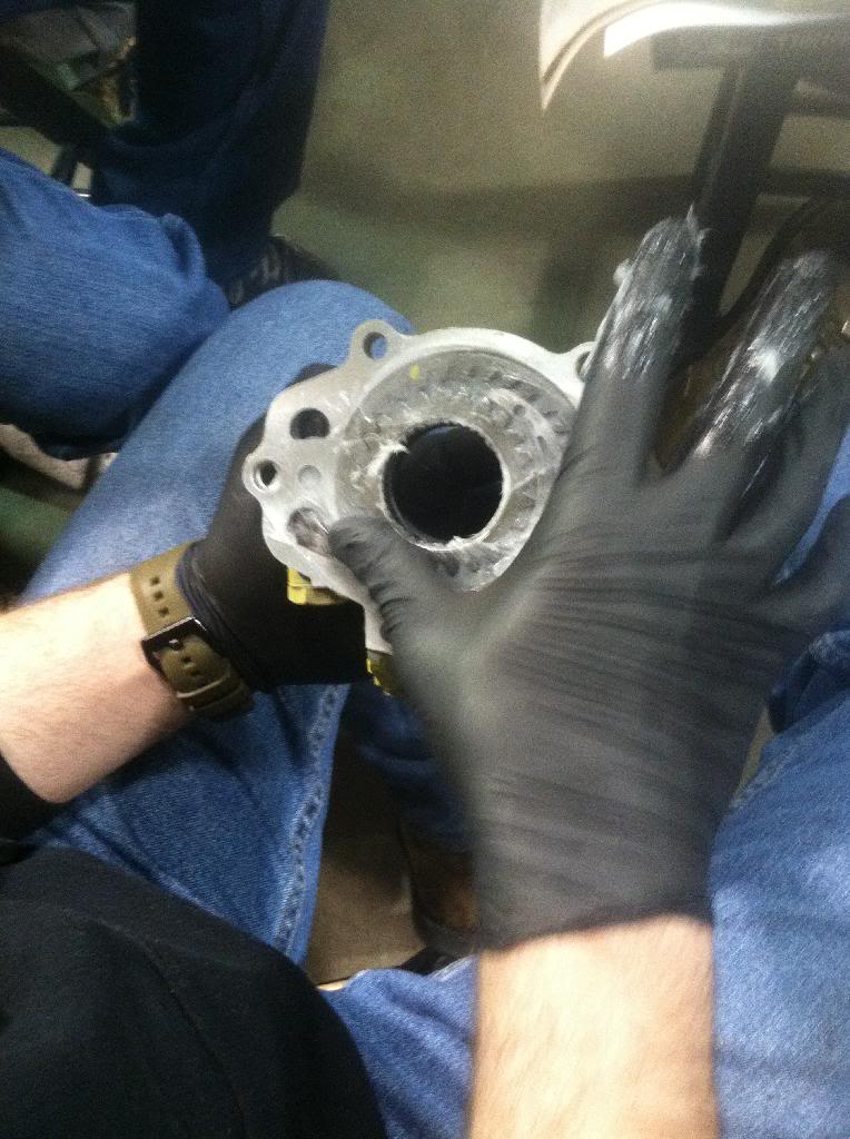

Primed the oil pump by packing it with vasoline

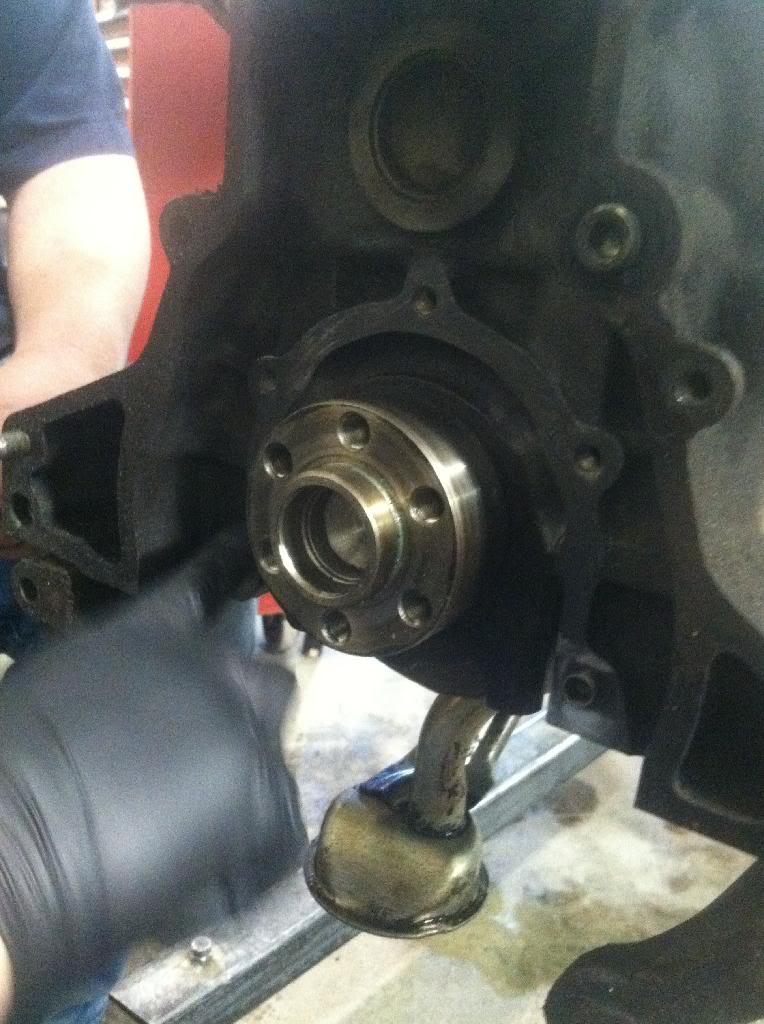

The whole reason behind this heart transplant, the rear main seal.

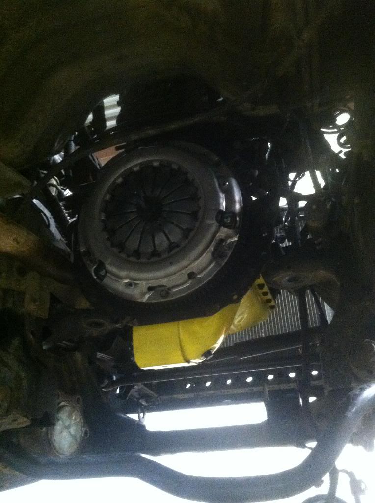

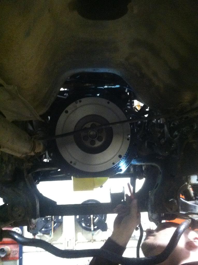

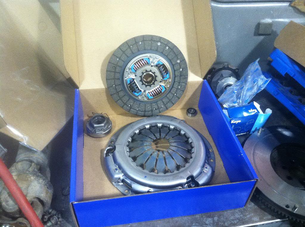

Machined flywheel and new AISIN clutch kit

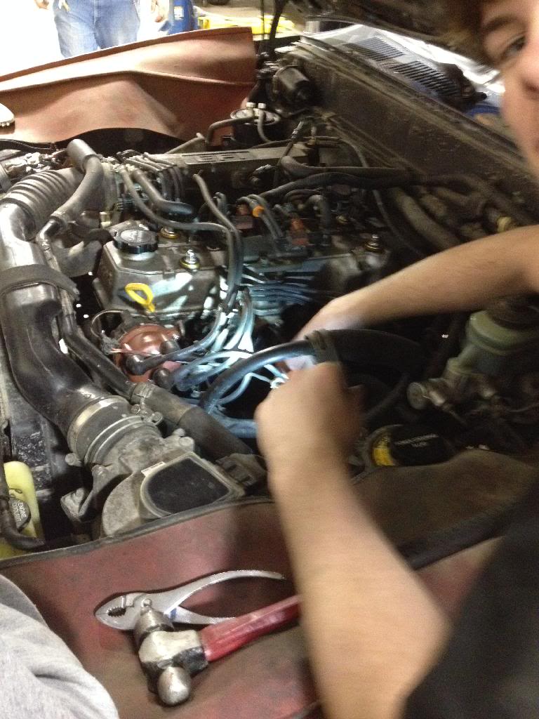

From: Pennsylvania
Looks good! We should have it all back together and test run it before day is out.
