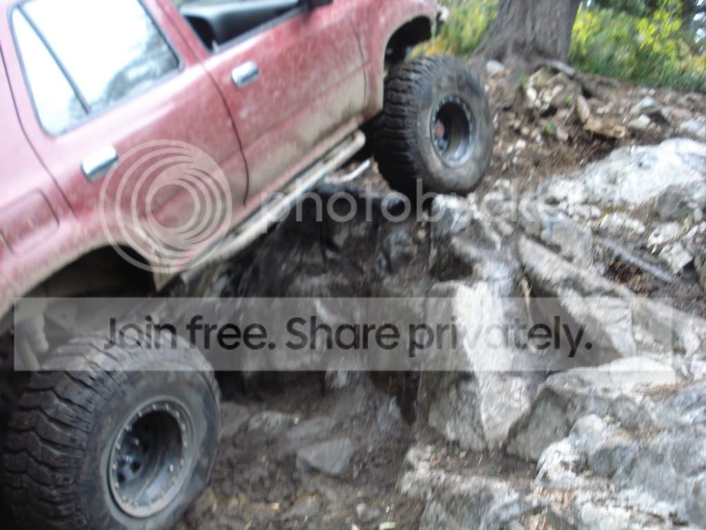

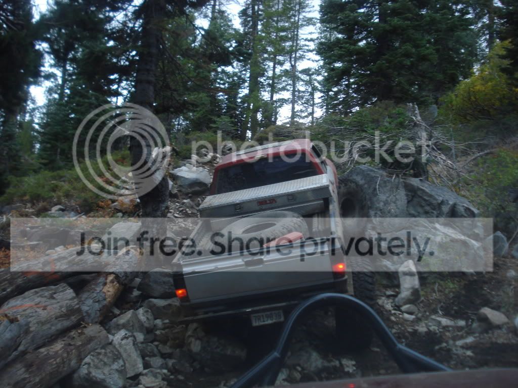

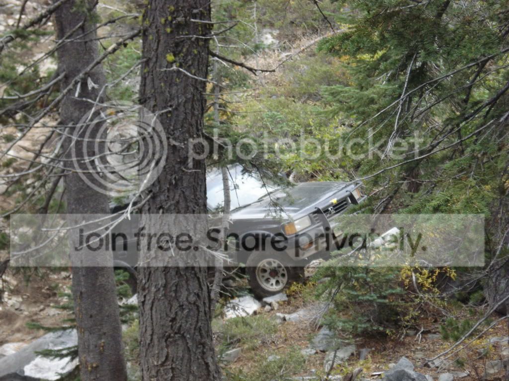

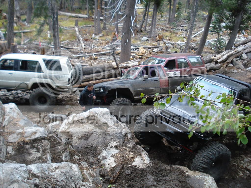

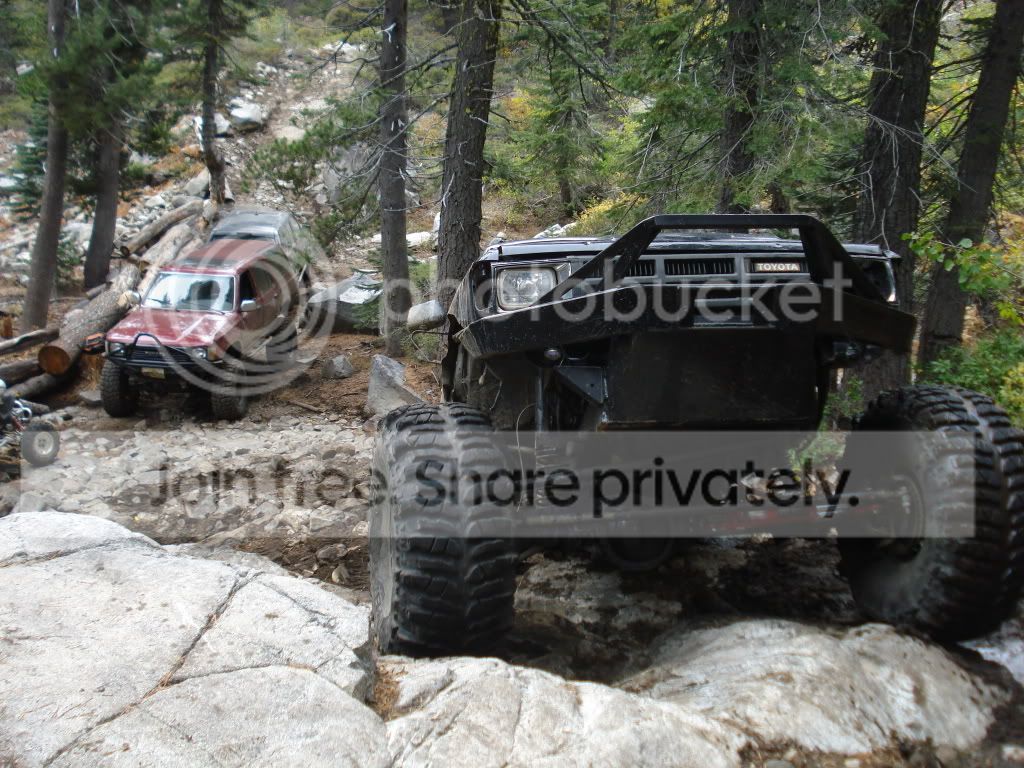

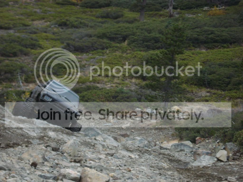

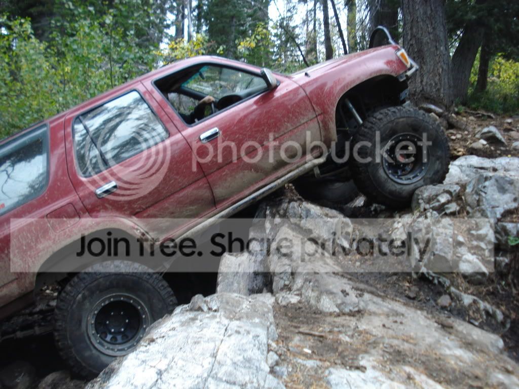

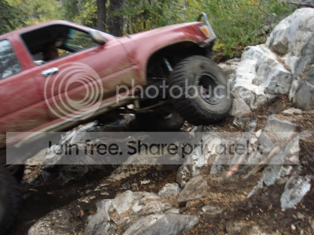

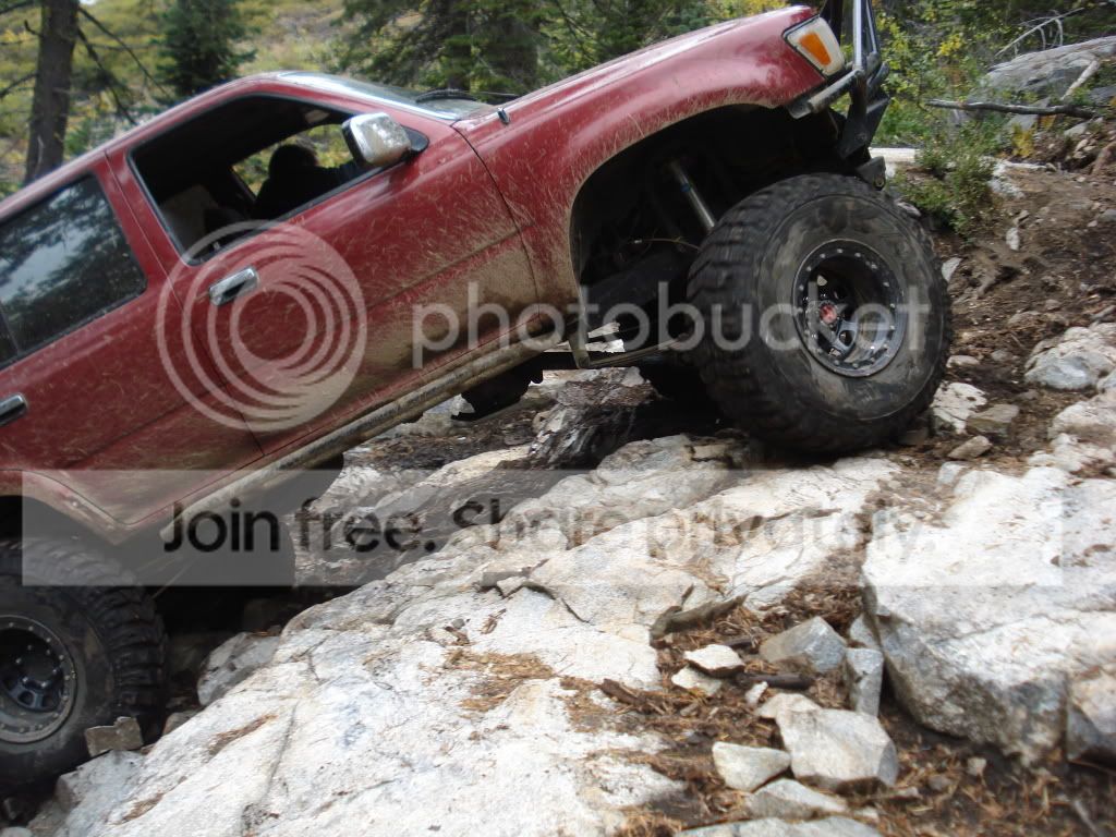

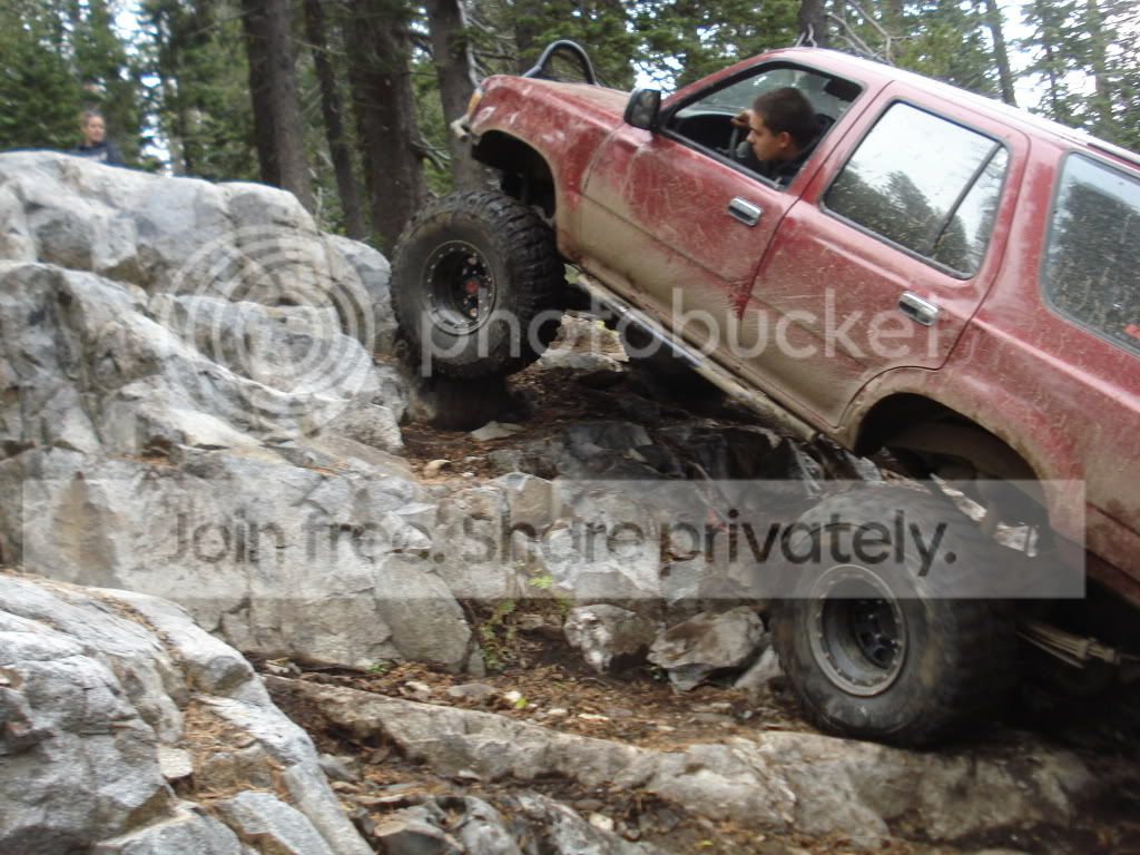

So went and did some wheeling yesterday.
So went to saddle today.
Heres some pics... ill try to get some videos up later.

Nobody made it up the harder sides all day. 42" iroks = denied, 40" boggers = denied, 35" procomps = denied...

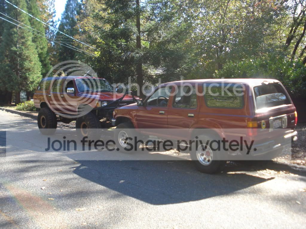

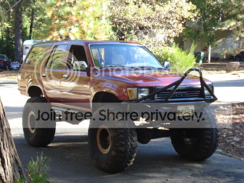

So heres my new stance..
Next to a stock runner:
Now just have to figure out what this slight death wobble is from..
It has always been from my shackles coming loose, and i would tighten the bolts and it would go away, until the bolts would come loose again..
Well the spacer things that came with the TG shackles loves to destroy bushings, and mine ARE TOAST.....
Im hoping if i replace my bushings the DW will go away..

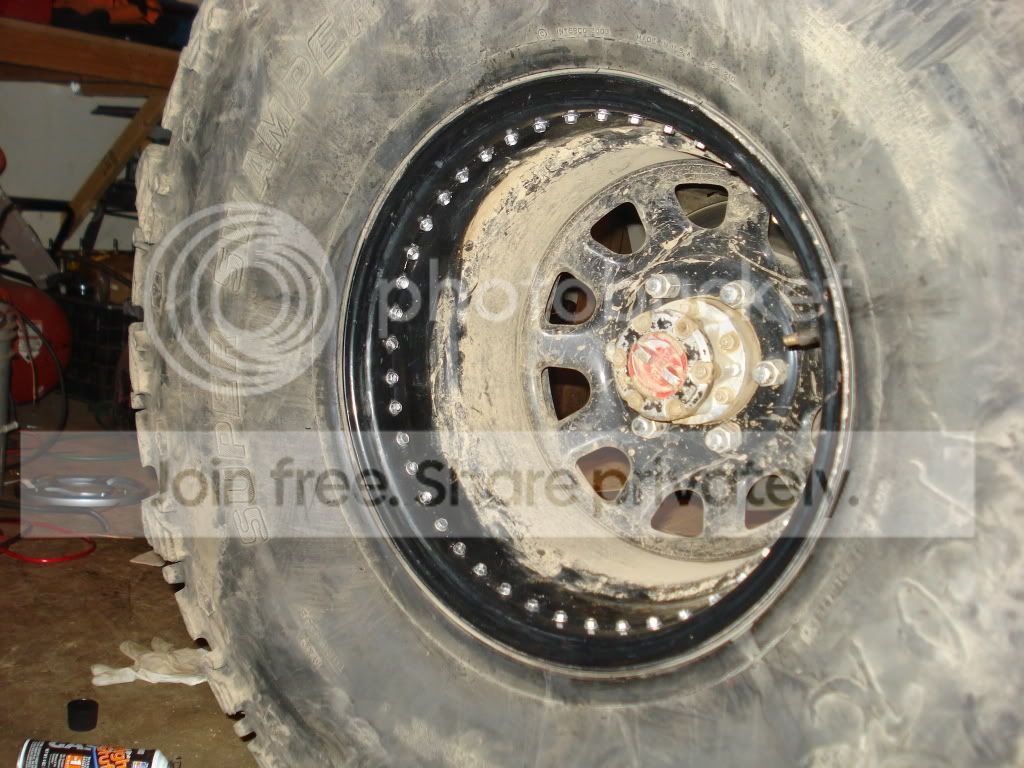

So put the 35's back on...
gonna paint the rings on the beadlocks soon.... Man let me tell you though....
The 35's DO RIDE SMOOOOOOTh compaird to those 40" bias iroks..

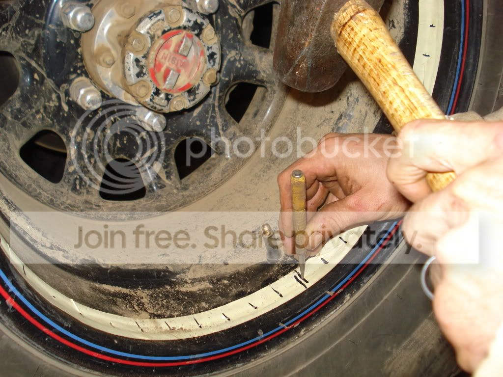

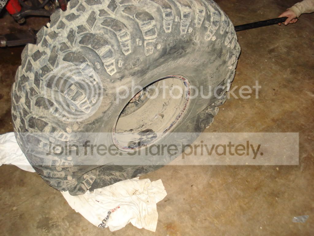

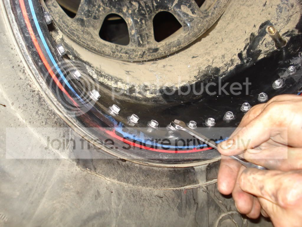

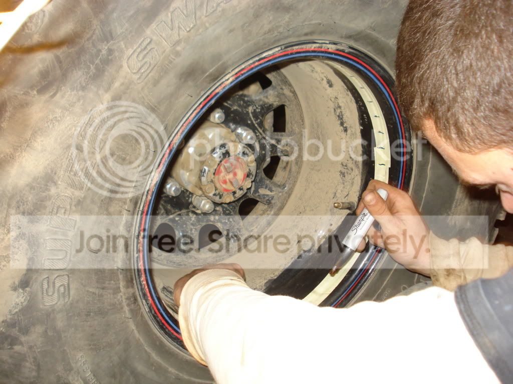

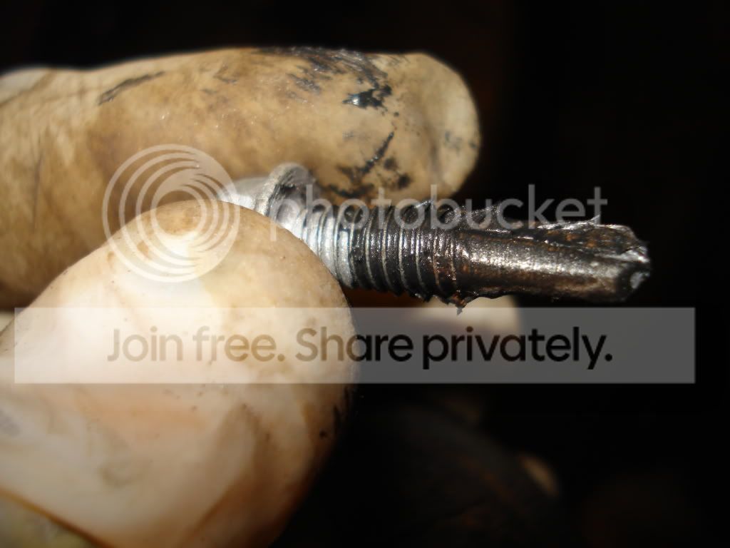

So hears a small write up on the inchworm beadlock screws..
First pull the valve stems and let the air out of the tires.. Then jack the wheel up so you can spin it around to make the installment go smoother.. (oh better grab a few :beer: before you start, youll be here a while)
Then Thomas used a piece of tape and measured an equal distance between each screw..
Take a punch and make a guide mark where each screw will go

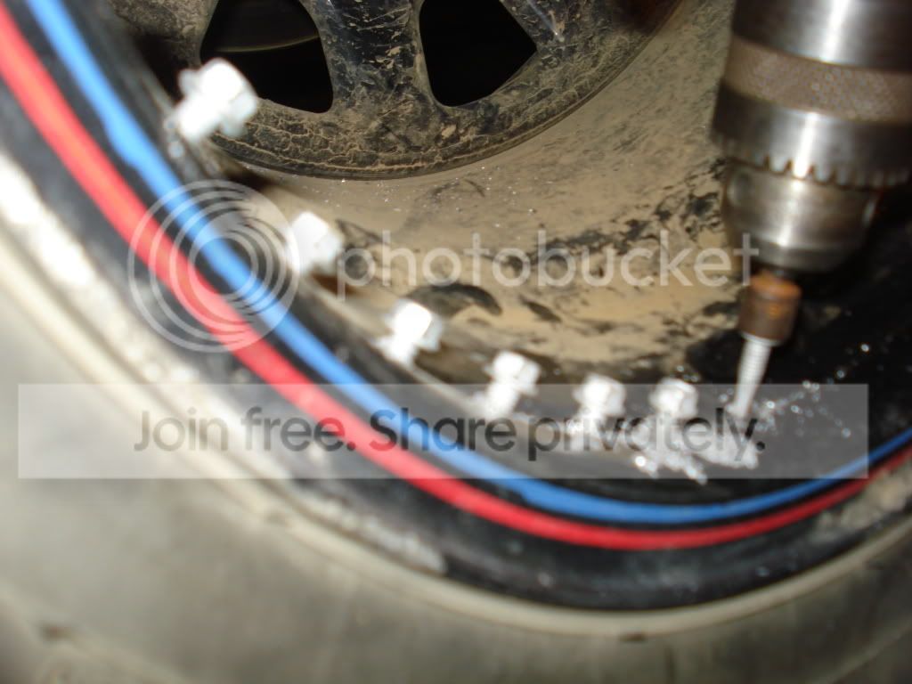

You might choose to do this and add right stuff to the screw before you attempt to drive them into the wheel, but the metal shavings stick to it, we found it better to start the screw and leave 1/2" room so we could apply right stuff before torquing down the screws.
Drive the screws down and then go over each one with a wrench so you don't strip them out with the drill.

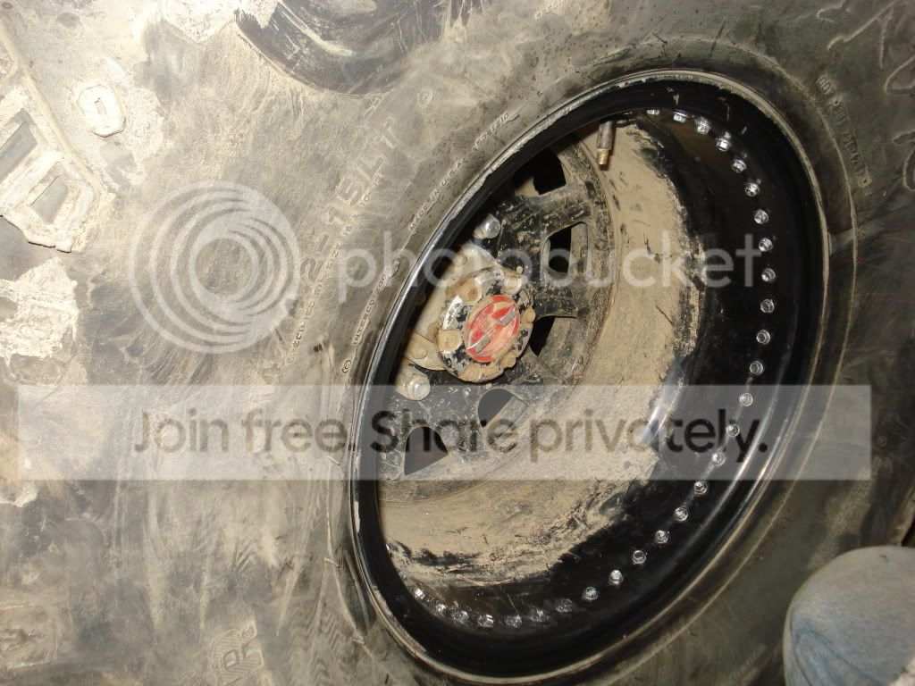

While you are cleaning off the excess rtv that got everywhere, might as well take that brake cleaner and get rid of those :stopit: blue and red strips on the wheels.
Thats it for now..
Youll get a review later once snow falls to let you know how they work..
