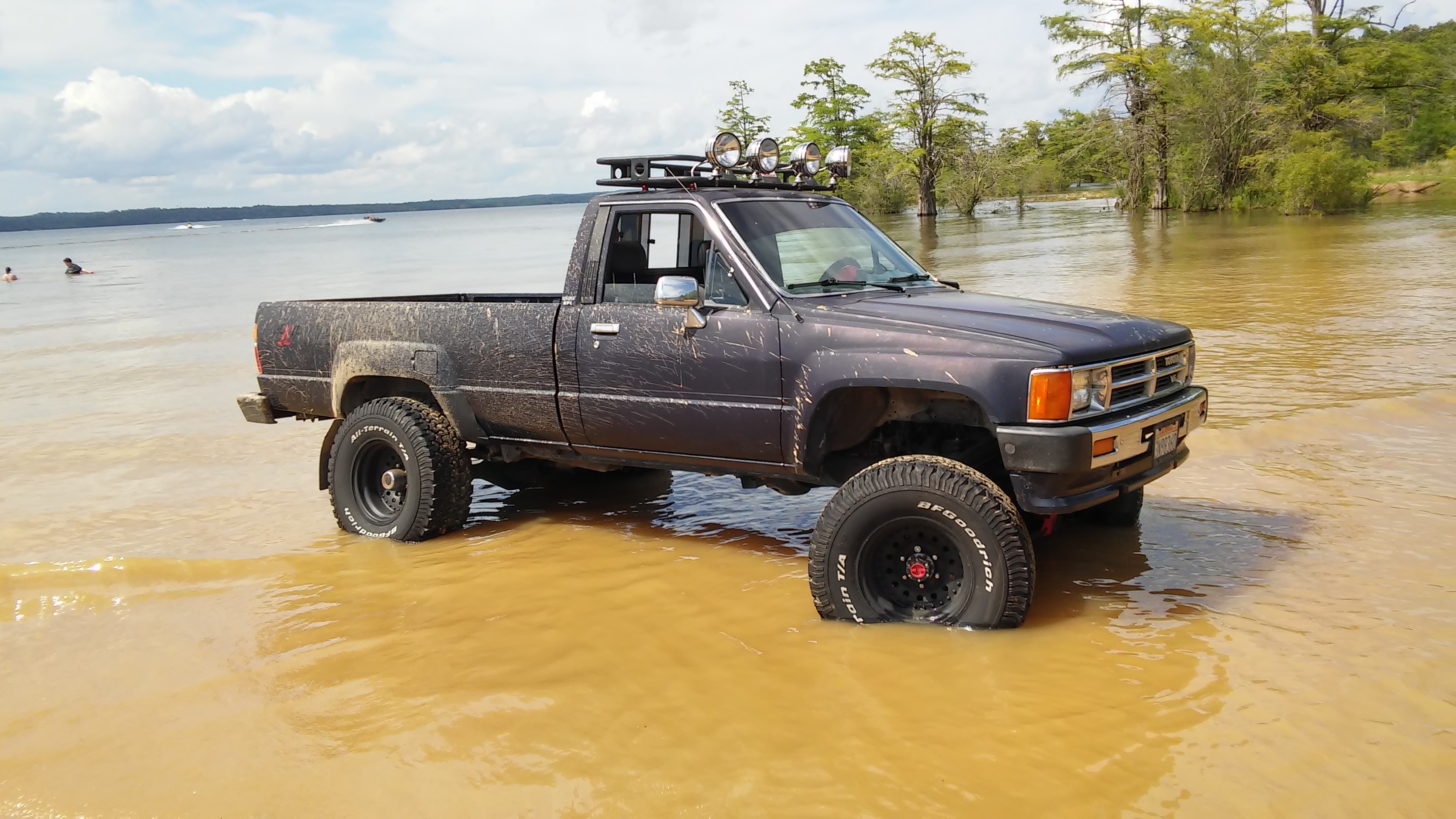

What's up, folks. So as many of you know, the 88 3.0 3VZE has a reputation for blowing head gaskets. After having white smoke billow from the exhaust pipe and power loss fluctuations, I had to take it to a mechanic - simply because I don't the time to work on it. The mechanic says there is metal shavings in the oil. After discovering this (without draining the oil) he says I need a new motor. He has not taken ANYTHING apart to try to find where the problem is, and says "it may be coming from this or it may be coming from that". He just says that his magnet picked up metal shavings in the oil.
Question 1: How can a mechanic determine that I have a ruined motor without taking the cylinder head off to look at a possible blown head gasket?
Question 2: How can he determine that the motor is ruined because he found some metal shavings in the oil without draining the oil or taking ANYTHING apart?

1. Nice long bed. I LOVE long beds. ESPECIALLY 3VZ-E long beds!
2. Whoever told you the 88 3VZ-E is notorious for blowing head gaskets lied. Mine went 218K before the HG popped. Fact is premature 3VZ-E HG failures are rare. Whatever you've heard is a hyped-up myth.
3. There's much to know about the differences between the 88 3VZ-E and later years. I happen to know in great detail what all of those are too. None of them are HG related though.
4. I doubt it's a head gasket failure anyways. Does the white smoke smell like coolant? If not, it's not a HG.
5. Does it sound to me like there's some other major issue with it? Most likely. But with little to go on, I couldn't tell you what.
6. A rebuilt 3VZ-E is a wise investment IMO. It's as much, or more, reliable as/than a 22R-E or 5VZ-FE. And would be 10x easier to put back in there than either one.
BTW, the block is not aluminum. Nor does it have sleeves..
EDIT: Then I remembered something. I've never seen another 88 V6 long bed before. So far as I know we own the only 2 ever built. NO BS!!!
