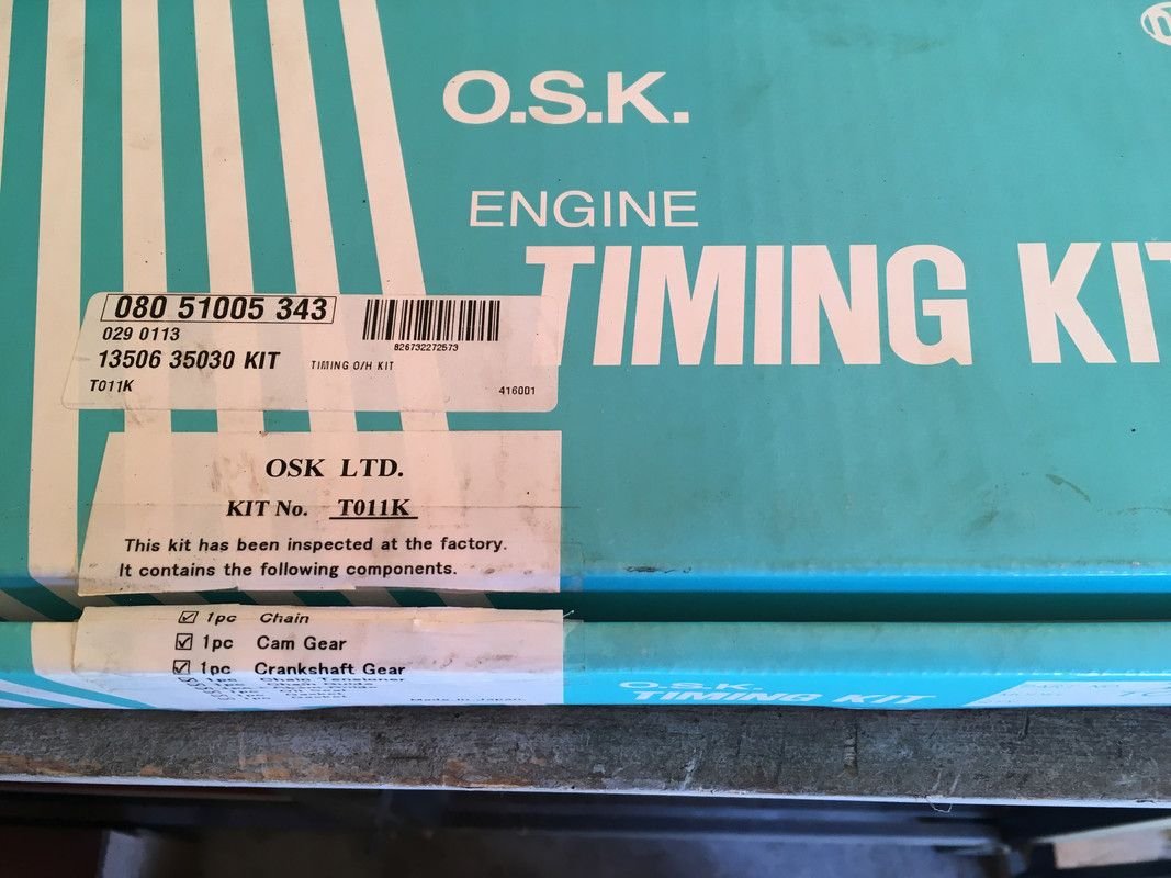

Metal Backed Timing Guides $40.02 (YotaShop)
OSK Timing Chain Kit $130.42 (YotaShop)

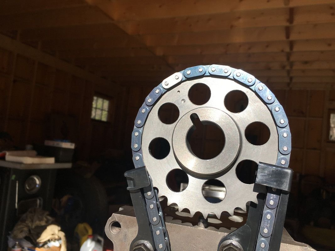

replacing the timing chain, along with the head gasket, is a pretty basic job that doesn't take too much time to complete. it is a "driveway-job", if that's all you have available. i've done it three times - twice in the driveway (on '87 #1), and once in the garage (when i rebuilt the engine on '87 #2).
the garage job was with the engine on a stand, since it was part of a rebuild. basic stuff, very easy as far as doing the timing set and head gasket, but not needed for just a timing and head gasket job. reused the aftermarket timing cover on this one.
the driveway job was done twice simply because the original head gasket started to leak externally (down the side of the block) after 30+ years. i did it again about a week later because i forgot to torque the chain guides, and one of the bolts backed out and dropped; when it wedged itself between the cover and crank sprocket, it snapped the chain. so i did the job a second time, making damn sure to torque the guides properly (i had only finger tightened them during the install - just plain forgot to do it). the second time it took about 5 hours from start to finish, but only because i'd just done it, and knew exactly what parts had to be removed, what parts needed only to be loosened, and what parts didn't need to be touched. used an oem toyota head gasket both times (purchased from mcgeorge toyota) and an osk timing set (timing cover was fine). i did not use metal-backed chain guides; the original lasted for 30+ years, and 200+k miles. plastic is fine, and the reality is that most owners will sell their truck before the osk plastic guides fail because of age.
i guess my main point is that this is a basic mechanical job, and can be completed in almost any environment. no garage is required.
edit: fwiw, '87 #1 now has over 20k miles since i did the second timing set/head gasket, and '87 #2 has over 30k miles since the rebuild.

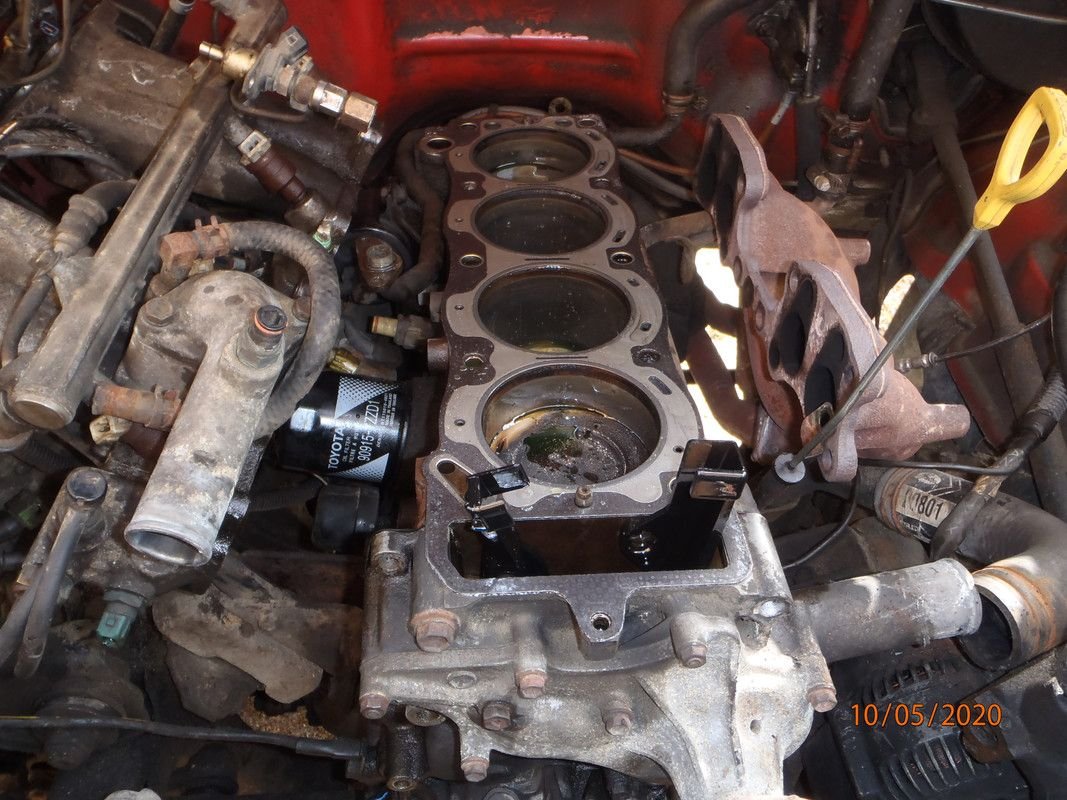

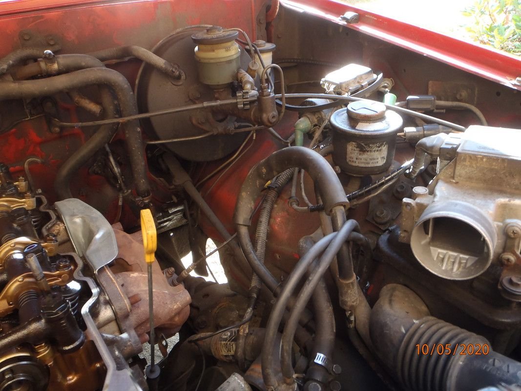

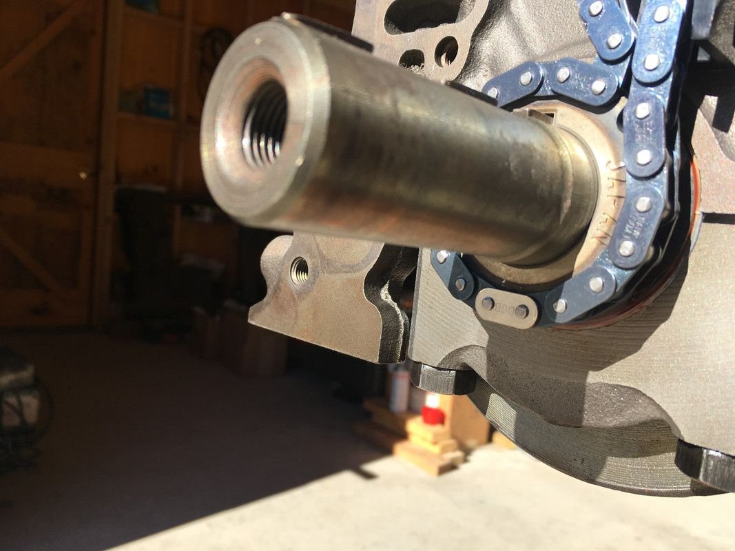

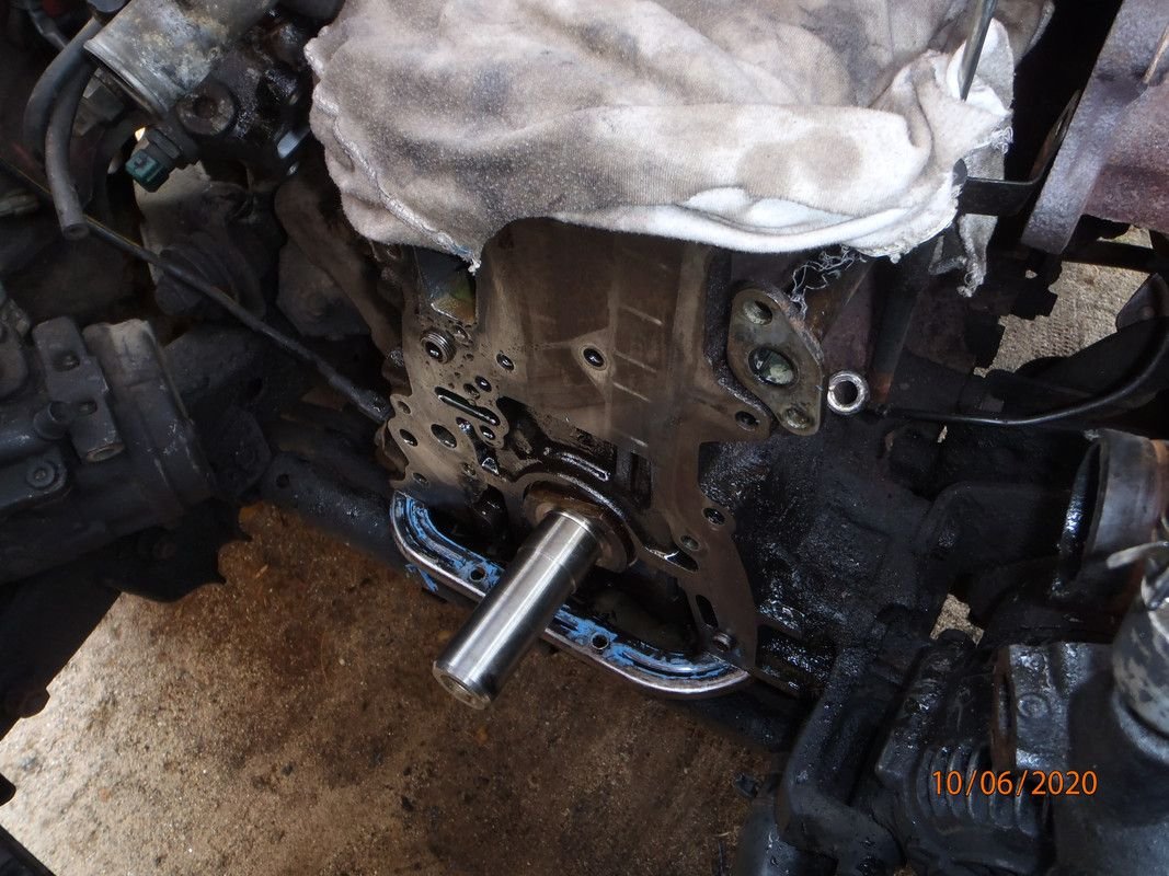

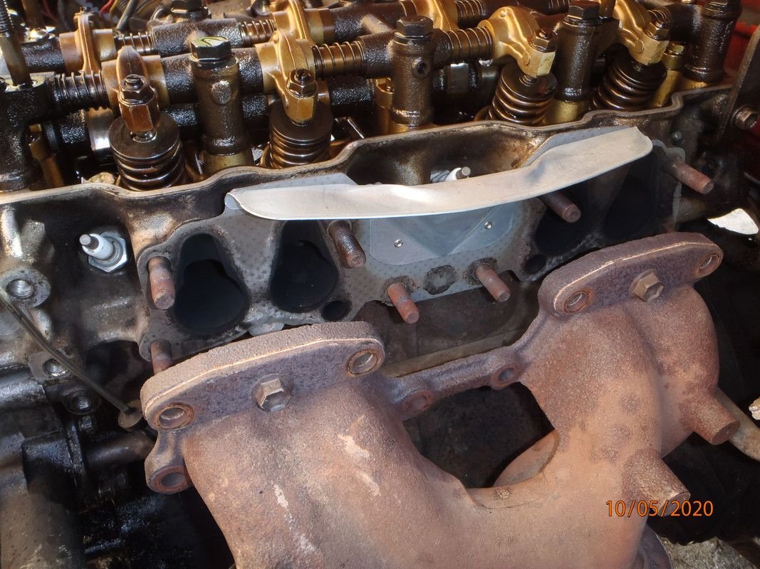

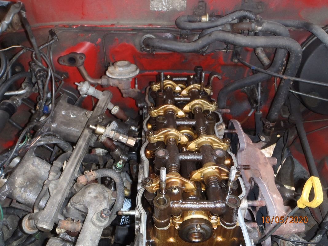

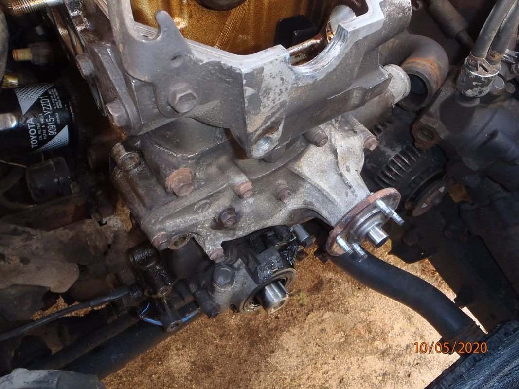

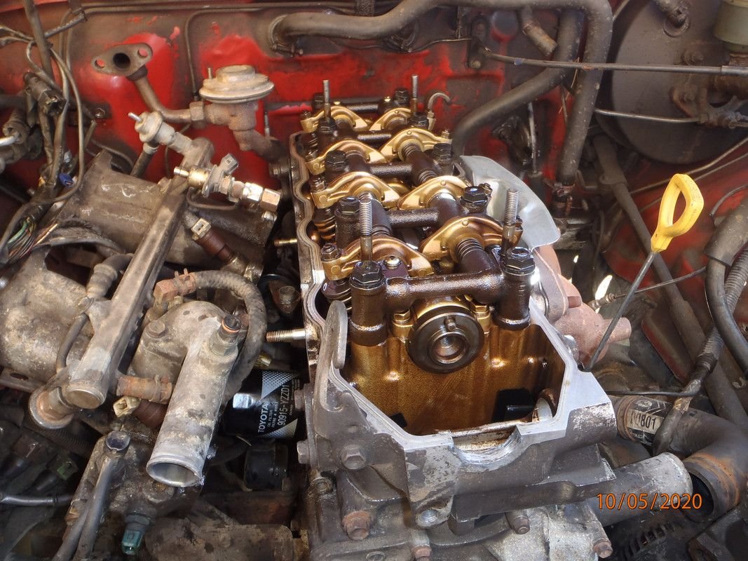

First, the only reason most people endorse leaving the head on is they claim it saves time. I firmly believe if you go in prepared and with the mindset of doing it the proper way it takes the same amount of time.
The FSM way has you remove the oil pan and head, then pull the timing chain cover. So the cover is literally "sandwiched" between the two. So if you pull the cover without removing the head you're gonna have to finagle the cover back in, all the time trying not to compromise the fresh sealant you just put on the pan and head, along with whatever you put on the timing cover gaskets(I use gaskacinch for the timing cover gaskets, the oil pan has fipg.)
No wonder so many of those shortcut chain jobs seep oil when they're done. I can't tell you how many 22R's I've seen with all kinds of silicone sealant slathered on the seams of the timing cover trying to stem a leak, and not working.
Some people loosen the head bolts to give some room to slide the timing cover in, but i think most can agree that it's not a great thing to untorque headbolts on an already-squished, well used headgasket. Now, I can see leaving the oil pan on and trying to save some work there. That's fair. And if it doesn't work out you only have the pan to deal with, none of the upper work needs to be redone.
One reality with the 22R. The headgasket and timing chain have very similar life spans. So the timing chain goes bad. You do this short cut that in the end saved negligible amount of time, and a year later(or less) the headgasket goes. Fantastic.
Our techs would unbolt the header pipe, remove the belts and upper hose, and plenum. With the plenum off they could unplug injectors and other sensors and pull that harness out of that valley.
Once they detached what was necessary they called over another tech for help. One grabbed the intake manifold, the other had the exhasut manifold, and they just lifted the entire assembly off as one piece. Went back on the same way.

Blueman, you leave it assembled the whole time. Now, if you got a head kit that included those gaskets and wanted to put new on you could, but I'd do it on the bench and drop the head back on with manifolds attached.
