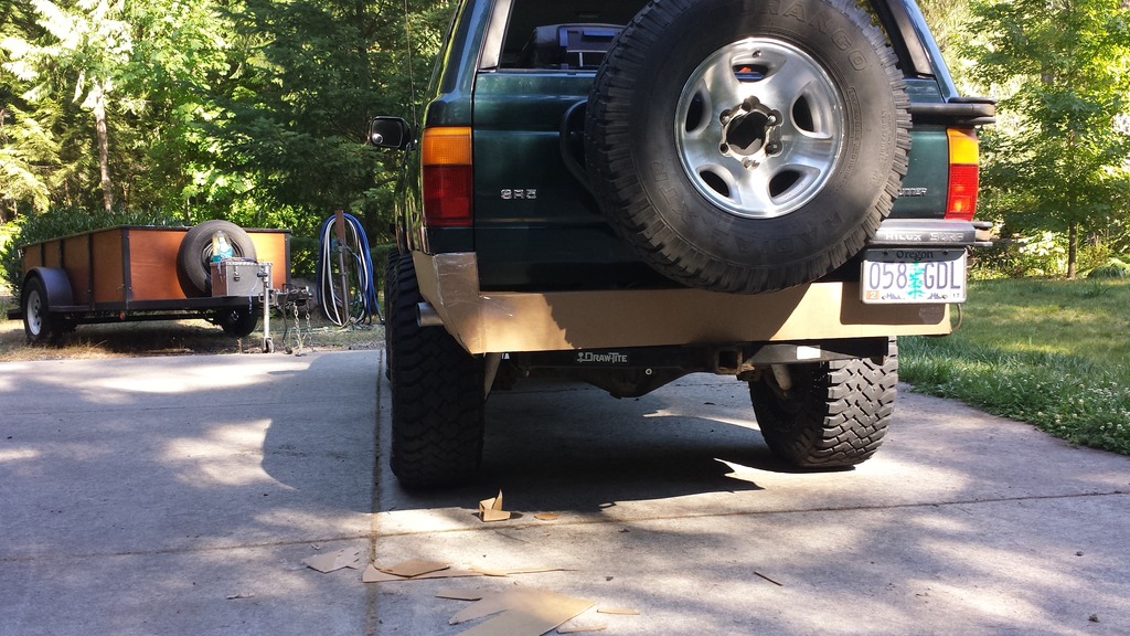

Ok, so I have been playing around with cardboard today for this rear bumper. I am using a 6" piece for the center section. While this isn't going to make the bumper any less obtrusive then the old unit, it will be able to hold a winch which is a plus. The side brace will be reinforced to the frame to offer some protection the corner panel and the exhaust. I have played with this for a while and think this the route I am going to go, but I am looking for input both good or bad.
What is everyone's thoughts?

I like your rear bumper design, looks great. Is the rear trailer hitch staying, or are you going to incorporate a receiver into the bumper?

Hey bud,
Thanks for the compliments the bump design. I haven't decided if I want to keep the receiver where its at or not. I originally planned on putting a winch into the bumper and leaving the hitch as it sits. I have also thought about putting the receiver into the bumper and just using a portable winch.
I don't know yet. Thoughts?

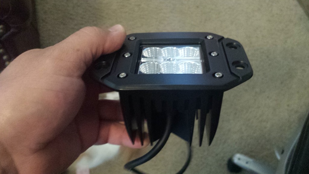

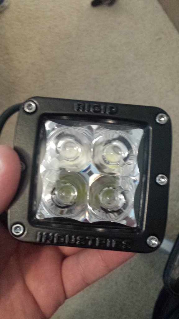

On a side note. I picked these up yesterday. Gonna place the flush mount units in the new rear bumper for pack up lights since I don't have anything right now with the spare tire in the way.
Square units will be recessed into the front winch bumper.

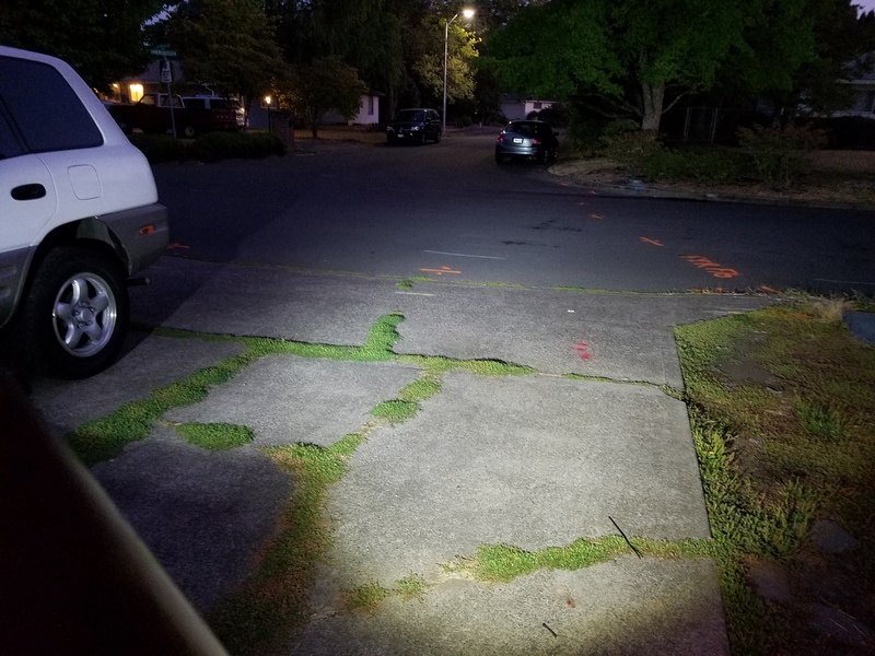

you will be impressed at the output the flange mounted lights put out. Are your's Rigid? mine are just the generic version
Passenger side is partially blocked by the license plate mount
still daylight left..

That looks good! Yeah I git rigid units. I couldn't pass up the deal so I snagged them. Paid what a set of generics cost. Old lady I got them from just got divorced and her ex hadn't come to pick them up so she posted them online for a just take these away kind of deal. Lol

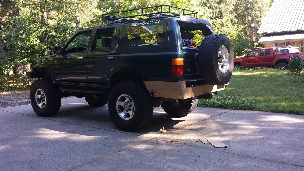

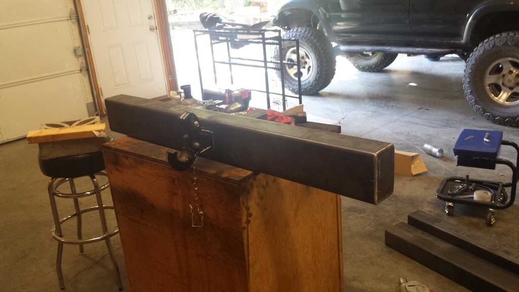

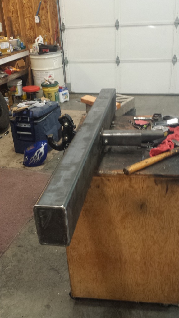

So here is where I am at with the rear bumper.
I started with 4"x6" 3/16" wall rectangle tubing. I have welded 3/16" plugs into each end. I will use this as the center section under the tailgate. I then cut out and welded in a piece of 2 1/2" 1/4" wall receiver tubing. This is the main body of the bumper. I will brace the back side of the receiver on each side and add a place to secure trailer safety hooks. This will create a very smooth front with no obstruction from a hitch. Still need to cut out for the recessed backup lights too.
The end plugs will be tapped. I will build the wings as a bolt on item. This will be so if any damage does happen to the wing I can replace them easily. The wing will also have a bar that will bolt to the frame towards the end of the wing so bending will be less likely.
I have thought about building these for sale, but other companies have done the same thing and discontinued them for one reason or another. If I had a big enough request I would look at building these for others. I still need to work on the tire swing out carrier.
I will get more done as soon as possible. I am working on an engine swap for a customer at the moment as well as building a rear bumper, rock slider for another customer, so my stuff does take a back seat from time to time. Again if I have anyone that wants one, then it will become a priority to get it buttoned up asap.

that rear bumper is off to a great start.
I love the idea of the side wings being a replaceable part instead of having to cut and weld a tweeked part
