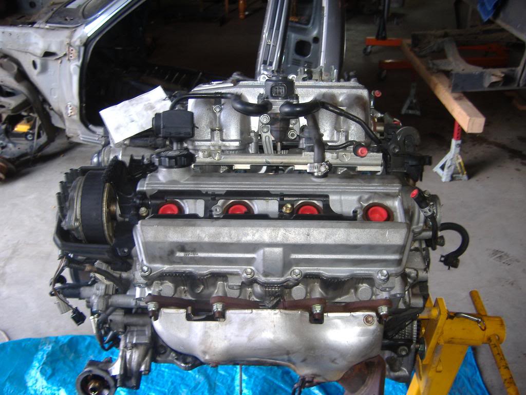

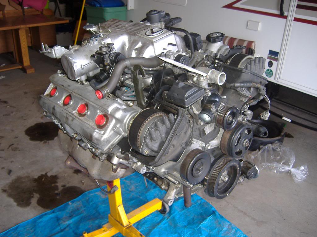

So I have started building an 84 front axle and have it all tore down and getting ready for the build up. Marlin Crawler truss's for the balls and shock mounts. I also have a sky manufacturing Toyota logo top truss getting ready to install. Next up is to order Bobby longfields and hub gears to match. Finally install some 4.88's.
When I did my 1uz swap I installed an LS400 engine with the front sump pan this isn't well situated for a SAS. You have to have the front sump for IFS but a center or rear sump if going in a solid axle rig. I couldn't find a core motor so I bought a complete good running engine and have removed the sump, lower housing, pan, pickup tube, and dip stick. I guess I will install the injectors from the SC into my motor as well.
Now I have a virtually complete 1uz as an extra motor. Thinking about piecing it out and selling the parts off of it.
Anywho pics of the work as of recent.

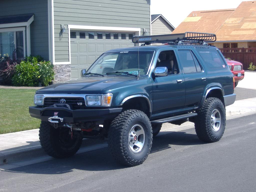

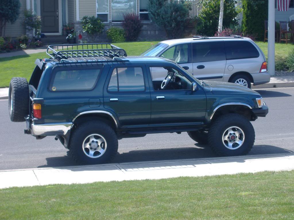

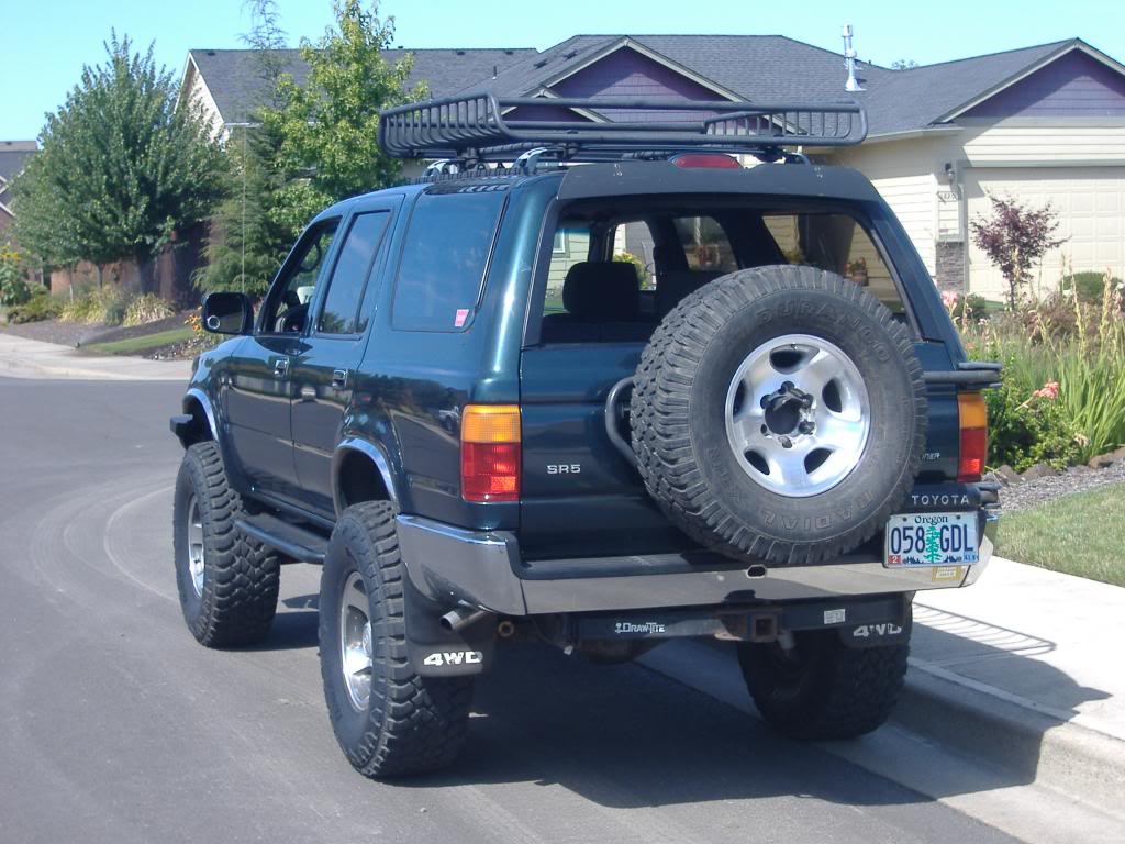

Here is a recent update. I added a neoprene winch cover for the xd9000i's synthetic line. I also added a Yakima roof rack, alpine speakers thru out.
Engine parts are sitting on the work bench now and waiting for parts cleaner so I can make them look new before installing them. I have also stripped the front axle and getting ready for the build as soon as the gear sets get here.

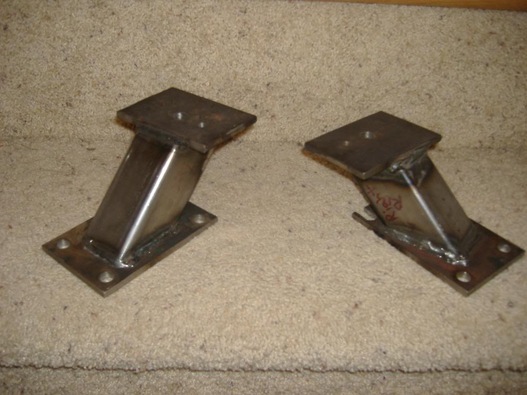

I wanted to let everybody who is looking for an easier way to get this motor into your V6 truck or 4Runner. I have started producing the items I needed to get mine done.
Motor mounts. These are custom built motor mounts that will allow you to use the stock perches that came on your V6 rig. These will require that a 1" body lift be used. The mounts come in raw form and are ready to have your pads installed and placed on your motor. $250

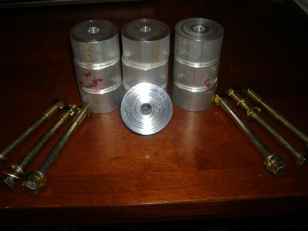

Aluminum 6061 T6 body lift. I have a milling machine and can cut these to any size you wish, all the way down to the millimeter. Price for the 1" body lift blocks and necessary hardward to put this on your rig starts at $130
We are in the process of finishing a steel 3/8" flat belly skid plate crossmember that will allow you to have a heavy duty skid plate replacing the modified stock stamped steel unit needed when running this engine and the 5 speed transmission combination . Price TBD
