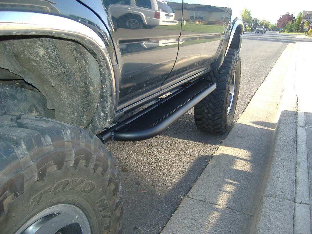

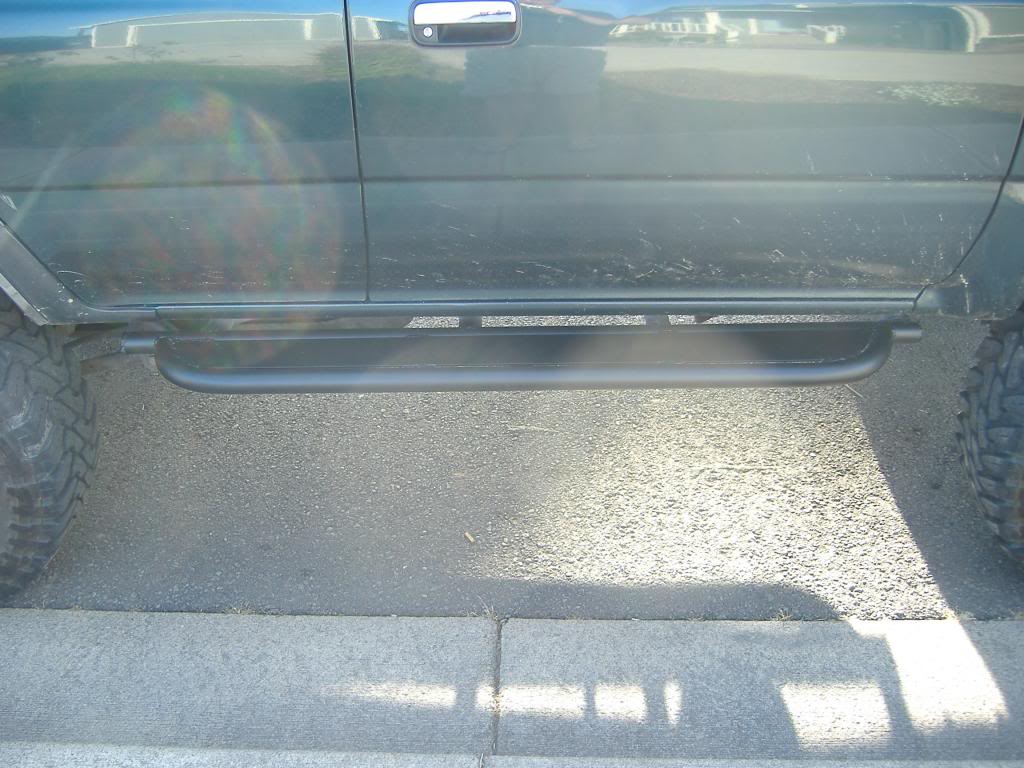

Update: so I need to reduce my gears from 4:88's to 4:56's. I know I can get better mileage out of this thing but it is just gear so low. I can take off in second gear just fine. I am around 3K rpms at 65 mph. I should be able to lower that to about 2500 rpm with a gear swap. I just need to find a rear pumpkin to swap with. I just want to get this perfect so I can get gears for the front pumpkin for the straight axle. Thinking about a high pinion diff out of an FJ80.
On side note, I had some time to spend in the shop today and thought I would kick out a set of sliders. Got them all bent up and welded on the rig today. Looks pretty good at least I think. I sunk some plating just below the rim and put a nice textured underbody finish on them. This should give the kido's a stepping platform to get into the back seats as they have been protesting about getting in, and protect sides from logs and rocks, for the win!!! two birds one stone.

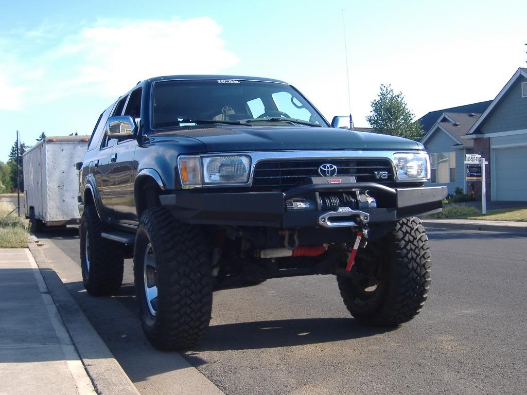

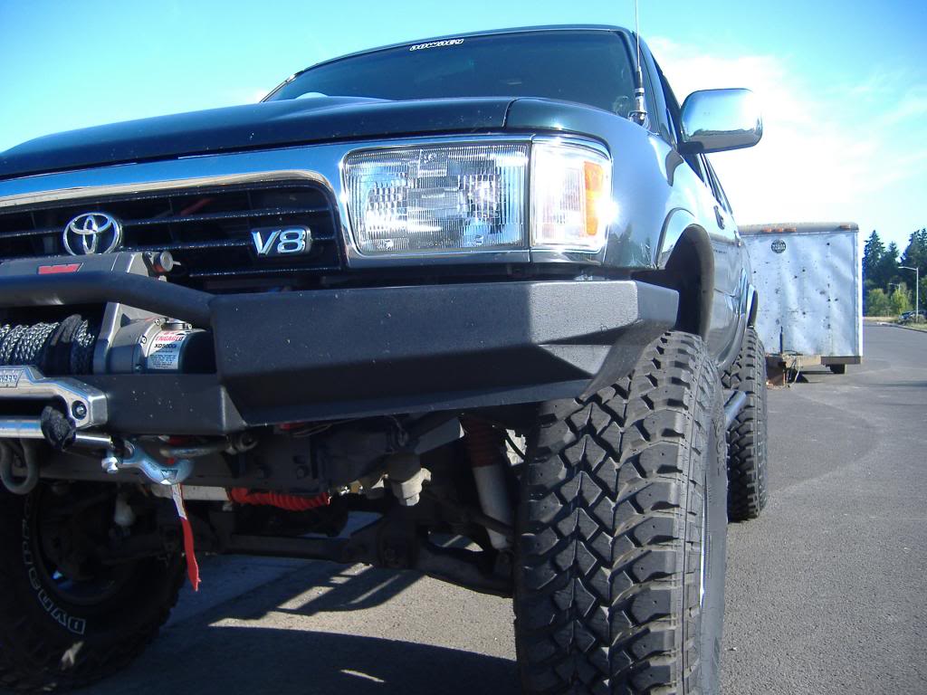

Here is the new winch bumper and warn winch installed. I am thinking about modifying it to move it up and cover up the body lift gap. That 1" really sticks out to me.
Updated bumper adjustments

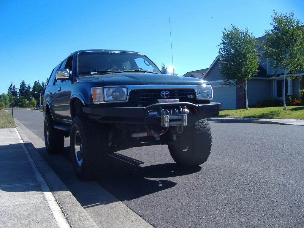

Old Jul 2, 2013 | 05:10 PM
  #200
85toyman's Avatar
Joined: Oct 2009
Posts: 1,044
Likes: 6
From: Centeral Willamette Valley Oregon
I have some recent upgrades. Warn synthetic winch line. I also upgraded to 315x75x16 Hankook Dynapro M/T tires.
