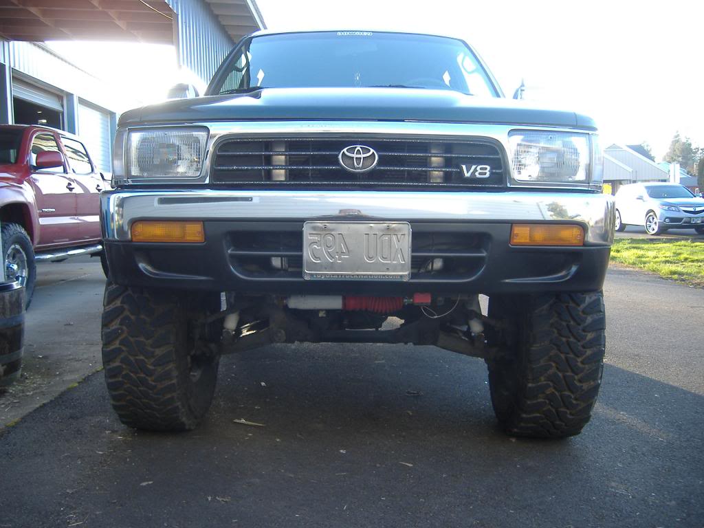

Put some miles on her today. Drives like a dream. Here are a few pictures of her and her new bling showing off her under hood engine swap.

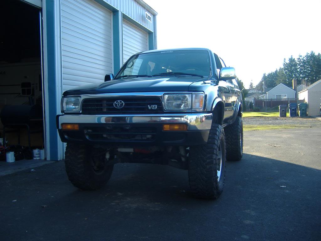

I just installed a front quick disconnect for jumper cables and winch today. I have also measured out so I can start building my sliders too, and roof rack!
