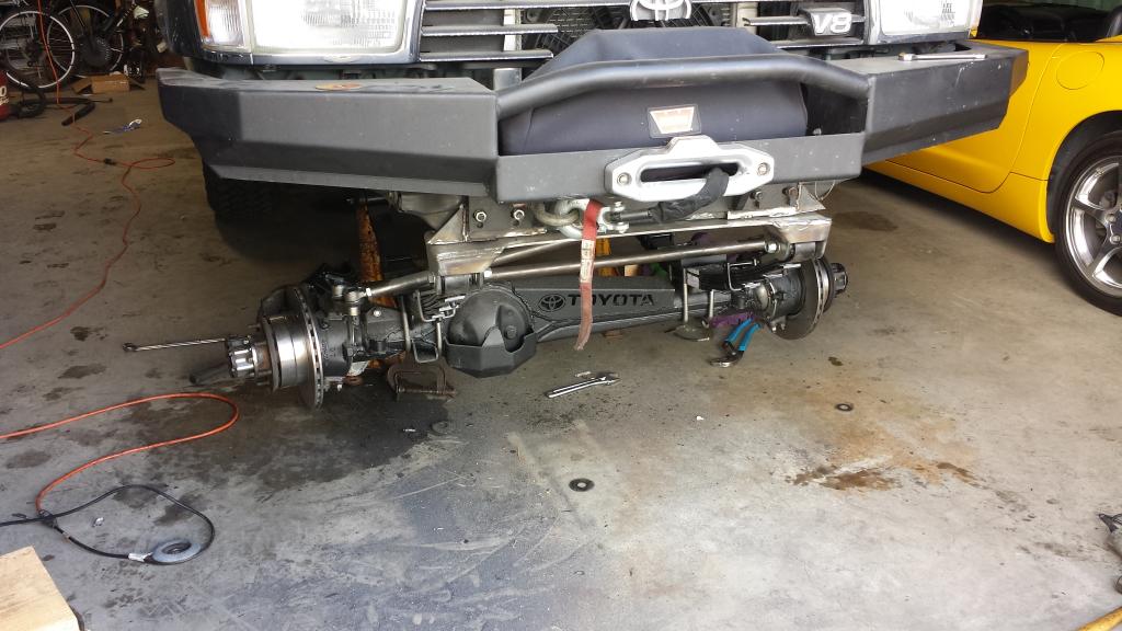

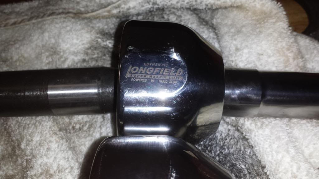

Well no serious offers and I had nothing better to do so I bought this for the front axle. Gonna keep working on getting the sas done.

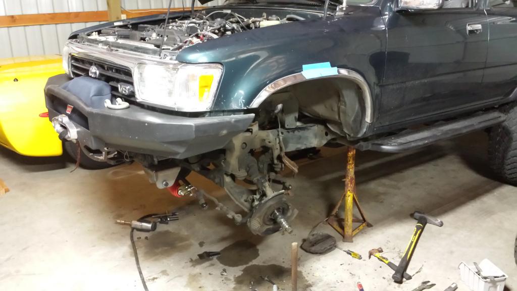

The SAS has begun. T bars and ball joints are out. Working on removing the rest of the stuff.
The shackle tubes are burned in and the front hanger is bolted on waiting on final placement then it gets burned in as well. Hope to have the rest of the IFS stuff off this next week.

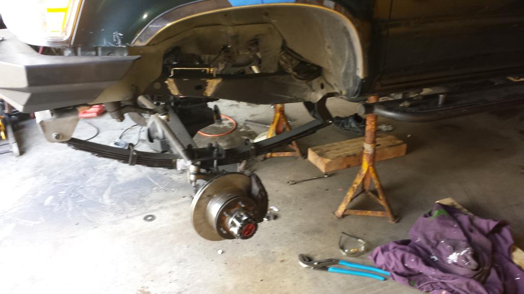

Here are some quick pics for everyone to see. More to come.
FJ60 Rotors waiting for the IFS hubs and sky wide axle kit to be installed
Custom built set of 3" leaf springs. Using our stock hanger these will net me a total of 4.5" of lift and move the axle forward about 2" over stock. yes I picked up a rear 14 gallon aux tank. Gonna play around with it after the SAS is done.
IFS is just hanging out waiting to finish unbolting the items worth anything and then plasmaing the rest off....

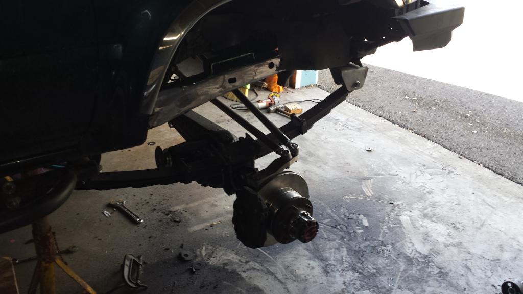

Here are some pics of the work that I have been doing.
Since we are a SKY vender we are using all sky manufacturing parts.
I am using the low profile front hanger. It is still just bolted on right now. The springs we are custom built 3" lift front spring with a centered stock spring pin. With the spring hanger sitting 1" forward of the front cross member this puts the axle about 1" forward of the IFS hub position. This will give me a more stock look rather than what most of the other people are doing with pushing the axle forward as much as possible. Again I want this to be an all around wheeler and expedition vehicle sitting on 35's. I am not too worried about stuffing anything else bigger under the Zrunner. I am worried about over all performance, not just what it can do in rocks. The reason for the swap was durability and strength over the IFS that and the lack of flex the IFS offered.
Using our custom motor mounts we have right now, it looks like we should be able to keep the LS400 oil pan and such. I will keep everybody posted as things progress.
We still need to weld the motor mount plates in place, weld the front hanger, paint the frame and the rest of the components, install the shock hoops, install shocks, torque all the bolts down to spec.
Once the SAS is done, it will be time to start installing the A/C system on this motor. Removing that IFS stuff opens up a lot of space!!!!
