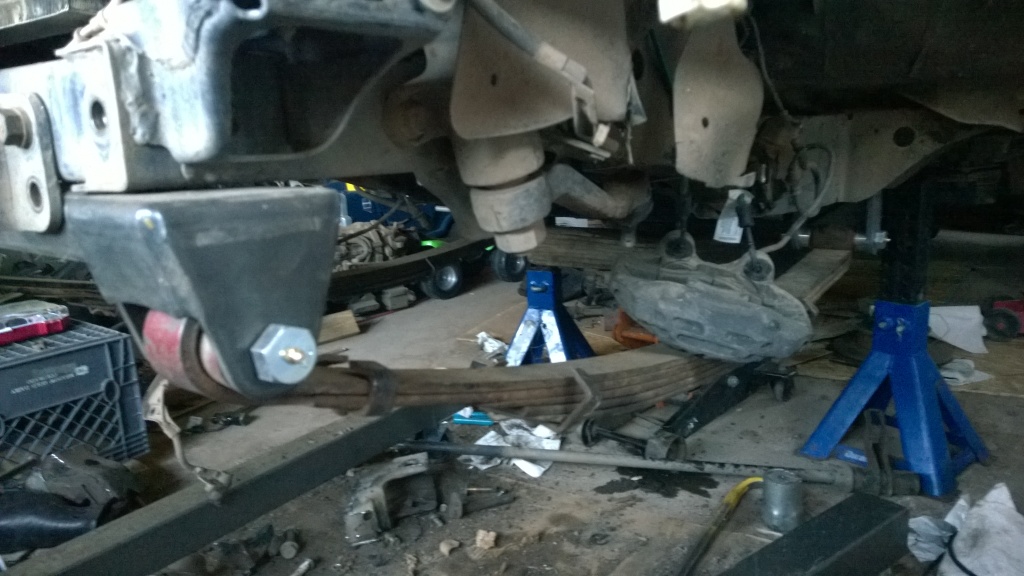

got some more done...
got my marlin front axle rebuild kit last week
swapped over the 3.0 oil pan w/ new gaskets
got my frame tube shackle mounts even and square
hung the front springs
shackle angle looks good (4" shackle plates on stock 84 front sprinsgs)

I would imagine the stock springs would definitely keep the height reasonable, it seems like you have been doing nice scoring used parts! Out this way toyota parts are more valuable than gold.
Im sure your little one is having a good time wrenching!

Only thing I am thinking may be an issue is the front springs. It is very common to see them negative arch from the factory over time. I am worried that the added weight of trying to hold up a 3.4 will make them arch quickly.

I have already taken the extra weight into consideration and removed to bottom leaf and added 2 more arched leafs so it should sit flat when done since they gave the previous truck about 1.5" of lift

worst case maybe get sme Old Man Emu springs or Low Range sells stock height/length heavy duty springs for a decent price or i might even get some 4" Allpro springs and go spring under cant really say till I get it moving under its own power and drive it for a while to see how it rides

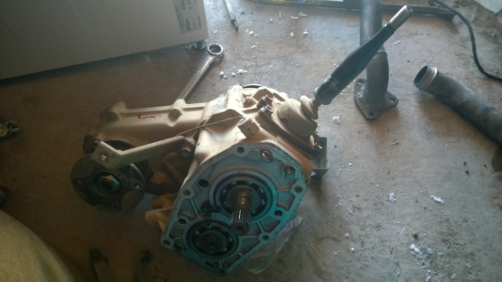

Not much progress on the build just been collecting parts
got a top shift t-case

have you got this sitting on the axle set?
Shackle angle looks like it should just about be perfect on all fours

the frame is still on stands and the axle is just placed under the springs for now to set the wheel base and steering placement the shackle should swing back a few more degrees when the weight is applied
