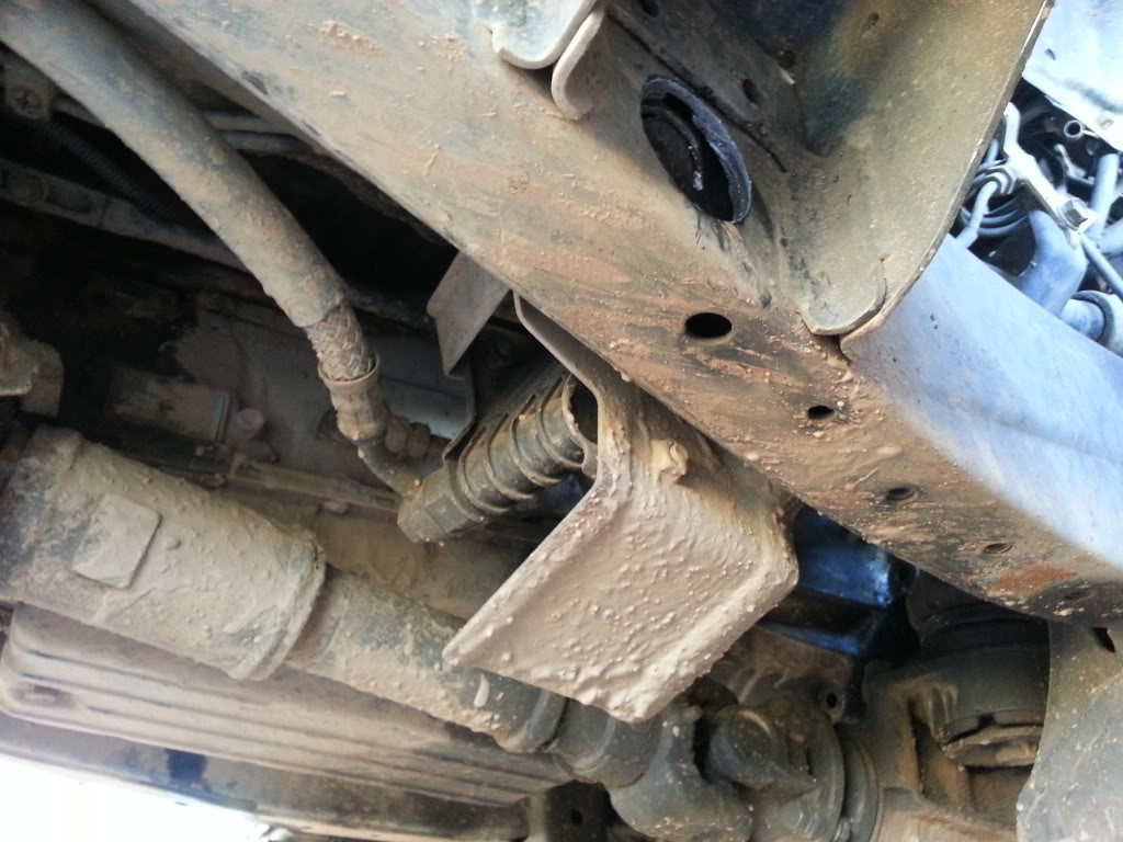

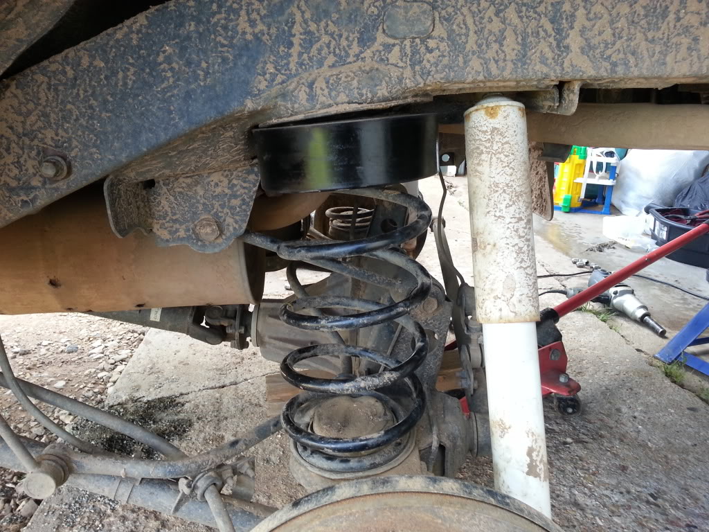

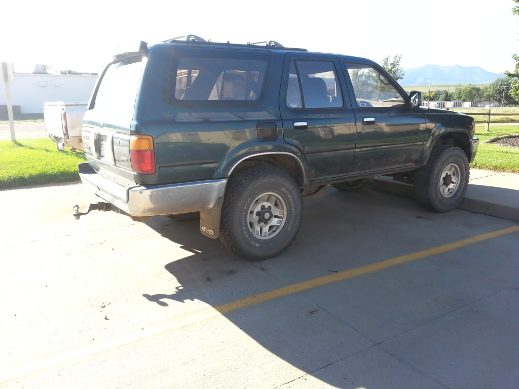

recently did a 1.25" daystar spacer in the rear to level it with the front
before spacer
adding spacer

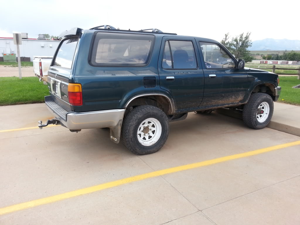

after spacer

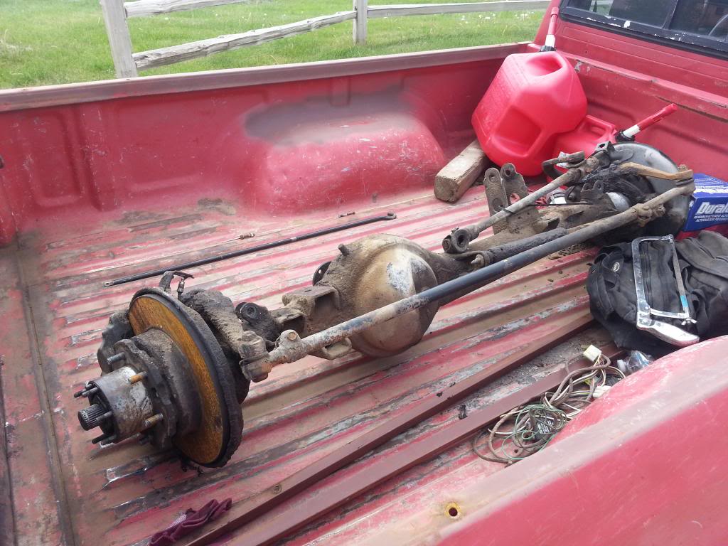

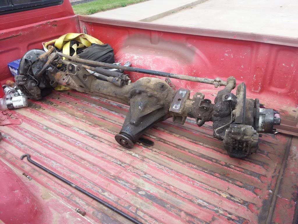

not much done in work but I have started to collect parts
got a deal on a E-locker w/motor (and a line on another)
84 front solid axle
next week I am going to place an order for my spring hanger and shackle tubes
I am going to use Sky Off Road Designs hanger and Davez Off Road Performance no death wobble shackles
I like there design of Skys hanger for ease of placement and the use of bushing sleeves to make suspension tuning easy rather than fight a M18 bolt through a bushing if I want to swap springs or shackle plate lengths

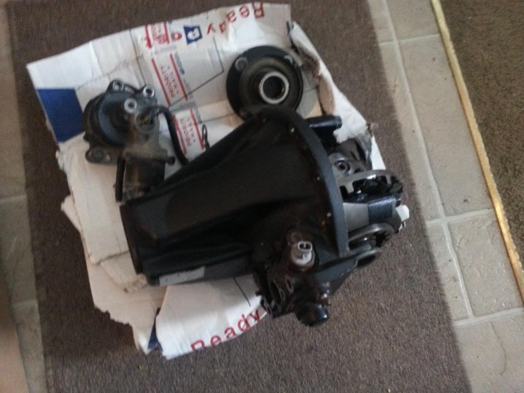

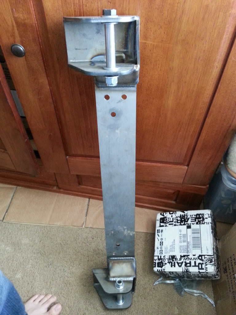

spring hanger, shackle tubes, and shackles arrived along with new pitman arm and diff triple drilled flange. just waiting on shackle bushing sleeves from davez offroad and then i should be able to drill the frame for the shackle tubes and then decied where to place the spring hanger...
the sky hanger is way better then TGs and i like to stockish style/look better

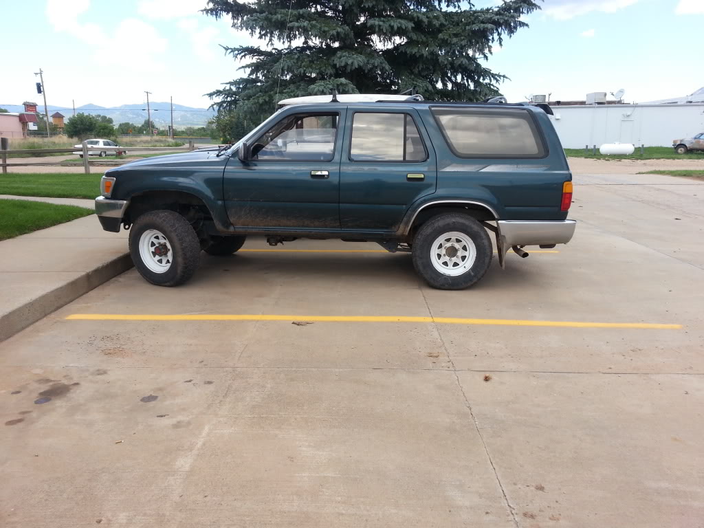

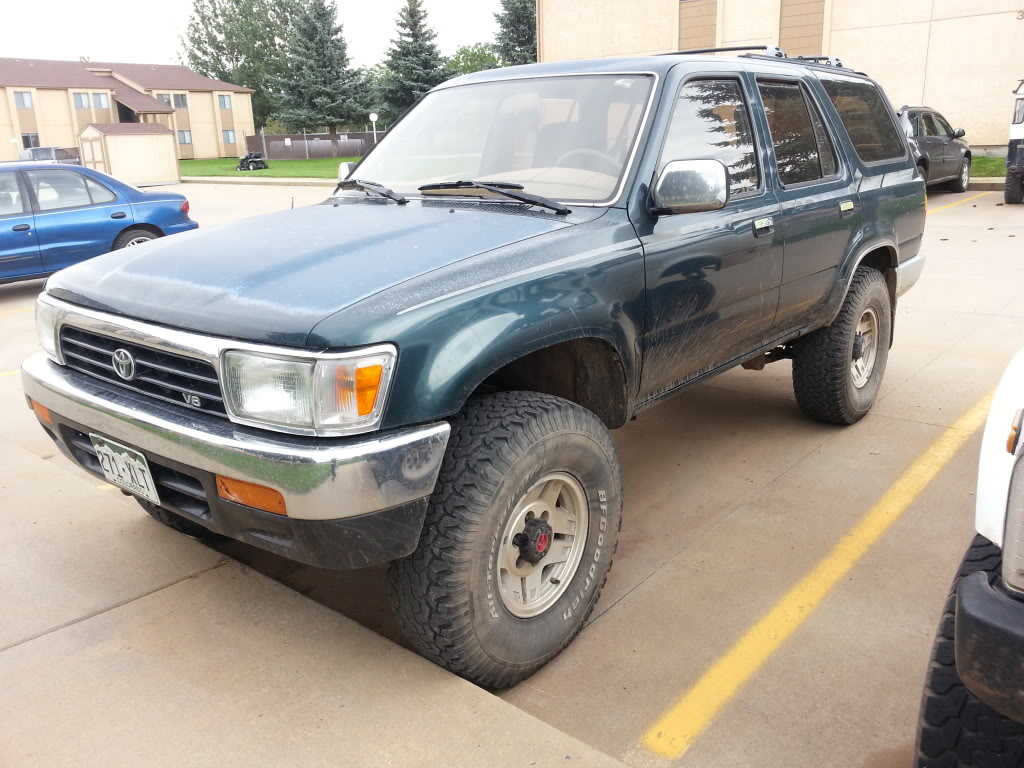

33s on with stock wheels... looks way better

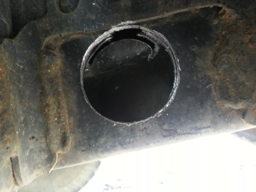

start of the frame tube holes
