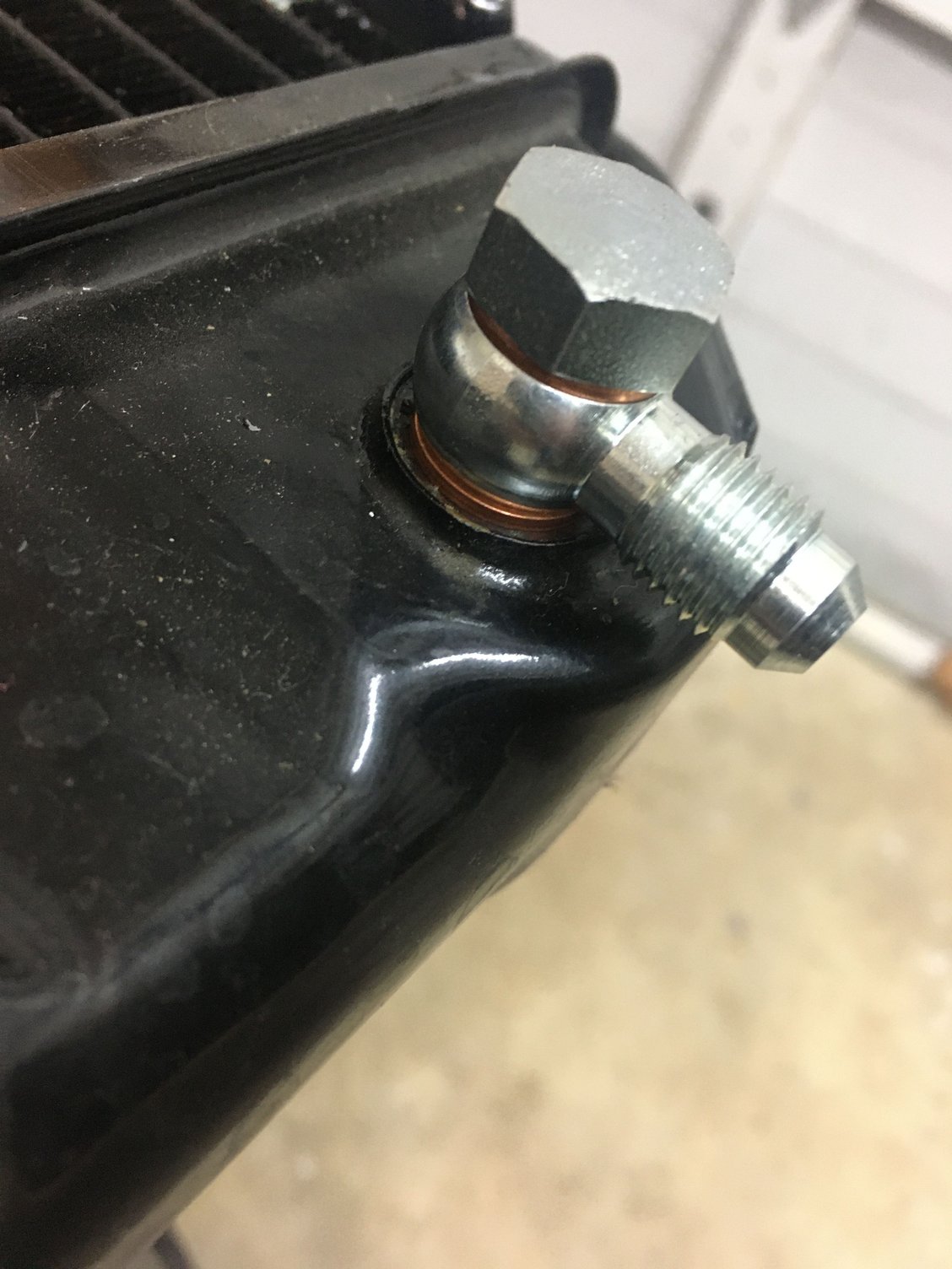

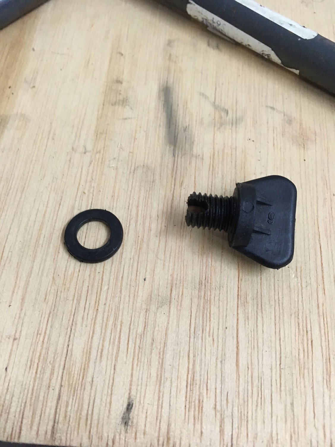

Another "service" upgrade was to replace crappy plastic "spray everywhere" radiator drain petcock.
Fumoto did not make a size valve for the radiator, so Chris sourced a banjo bolt and bell. Not shown is the AN cap for this fitting. Draining radiator will be less messy now.

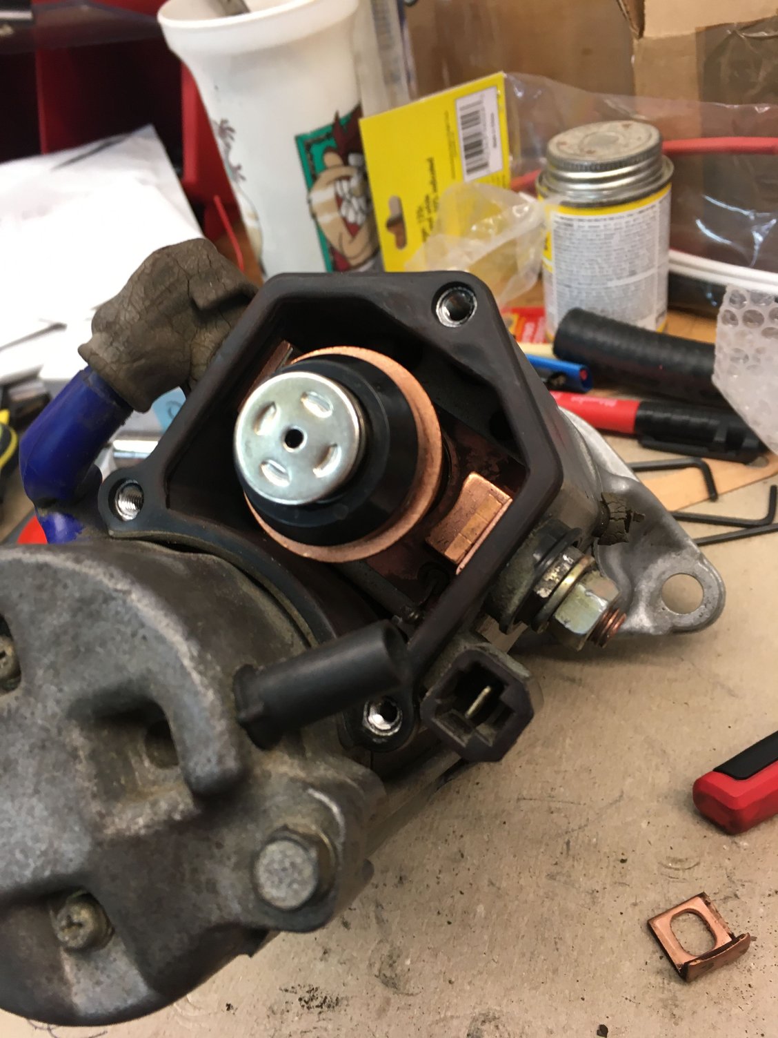

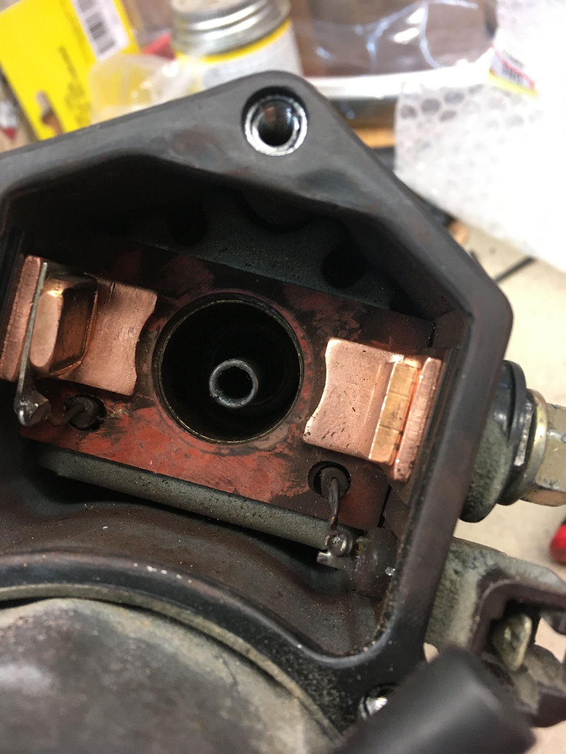

Starter was cleaned and contacts were replaced. The old ones worn.
Just the contacts and plunger replaced. The started was not completely rebuilt. Replacement contacts are cheap. Worn contacts are a frequent cause of start problems.

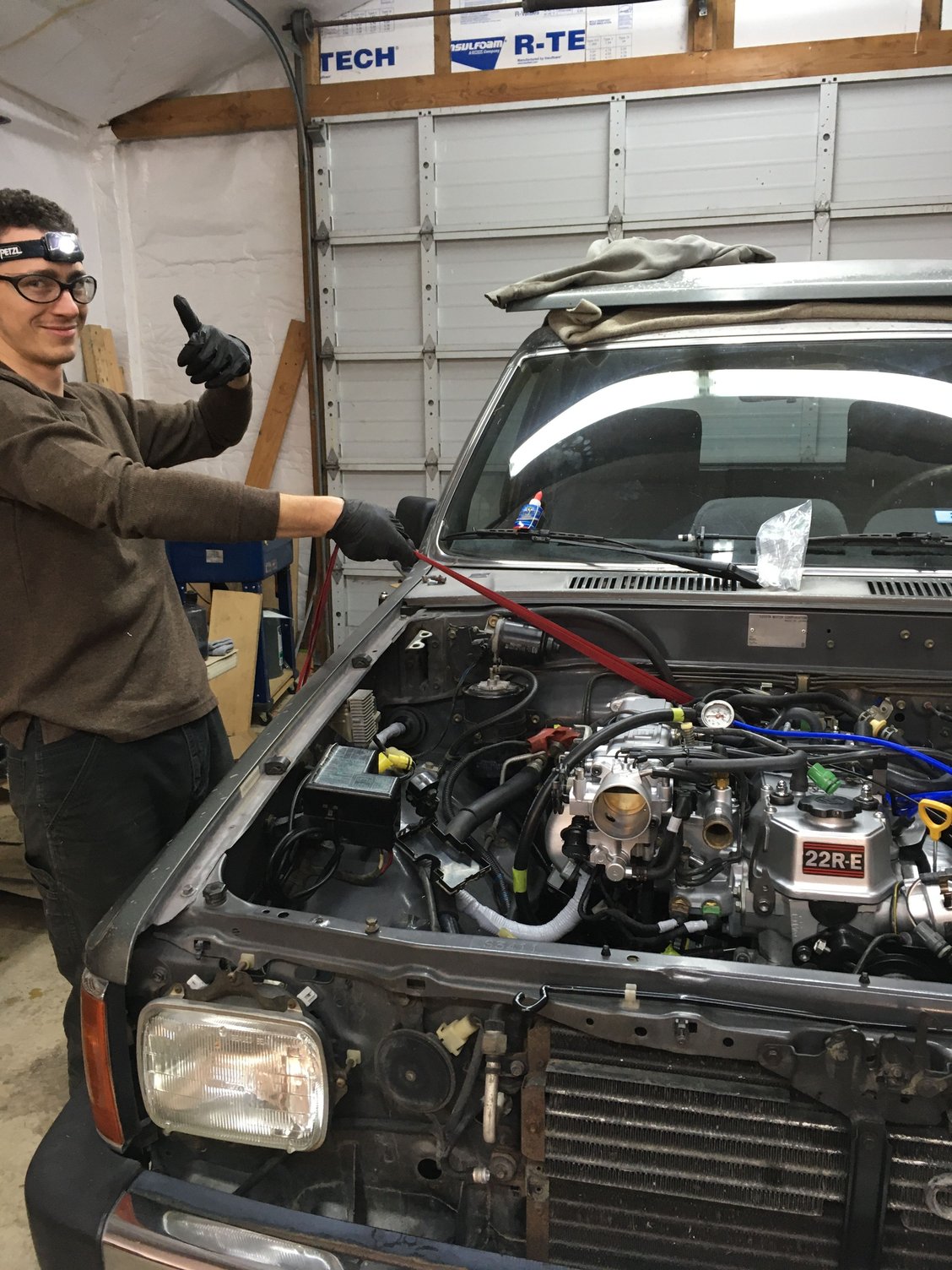

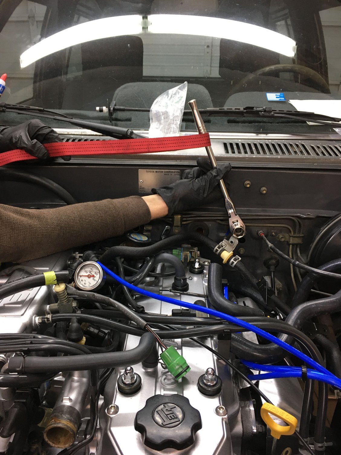

Long extensions and swivel used to start bolts from bell housing to block. Here, Chris shows our method of final tightening top two bel housing bolts. Swivel head ratchet and strap.
Chris gets those pesky top two bolts tightened.

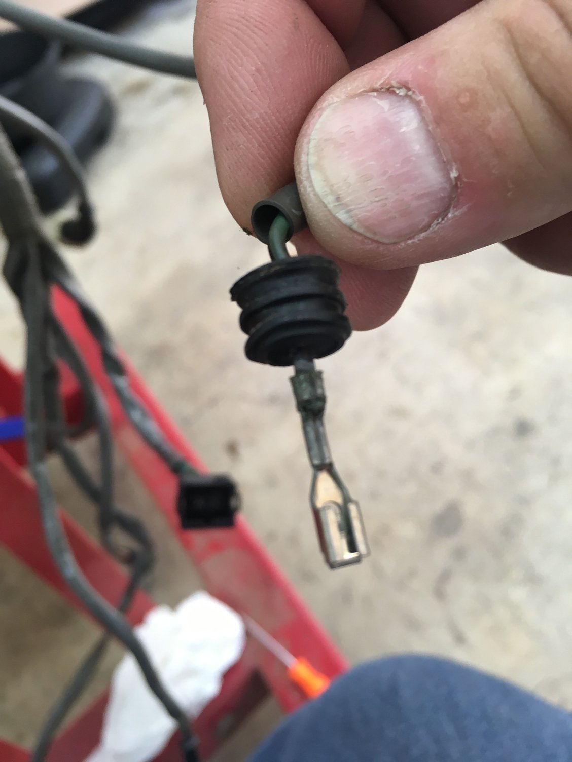

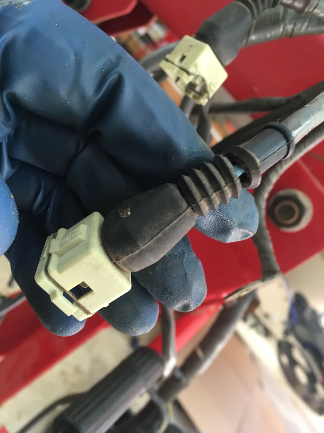

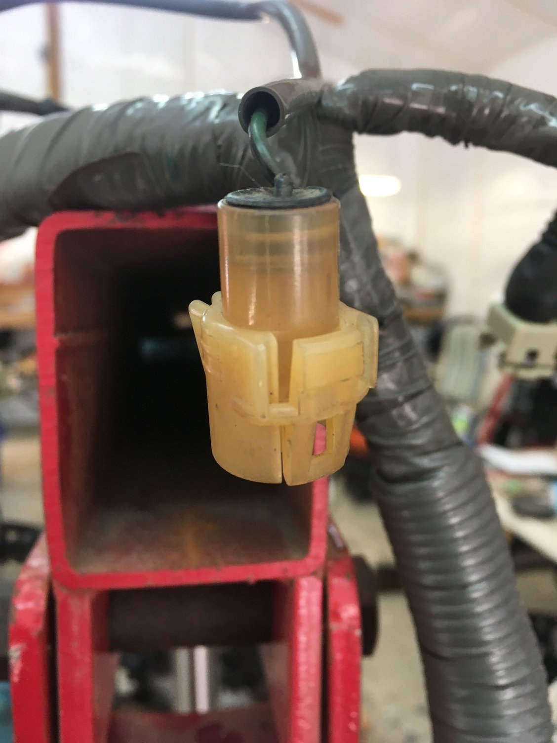

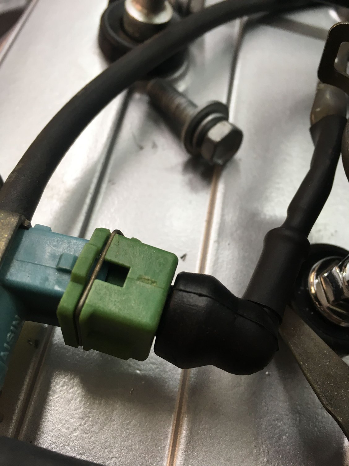

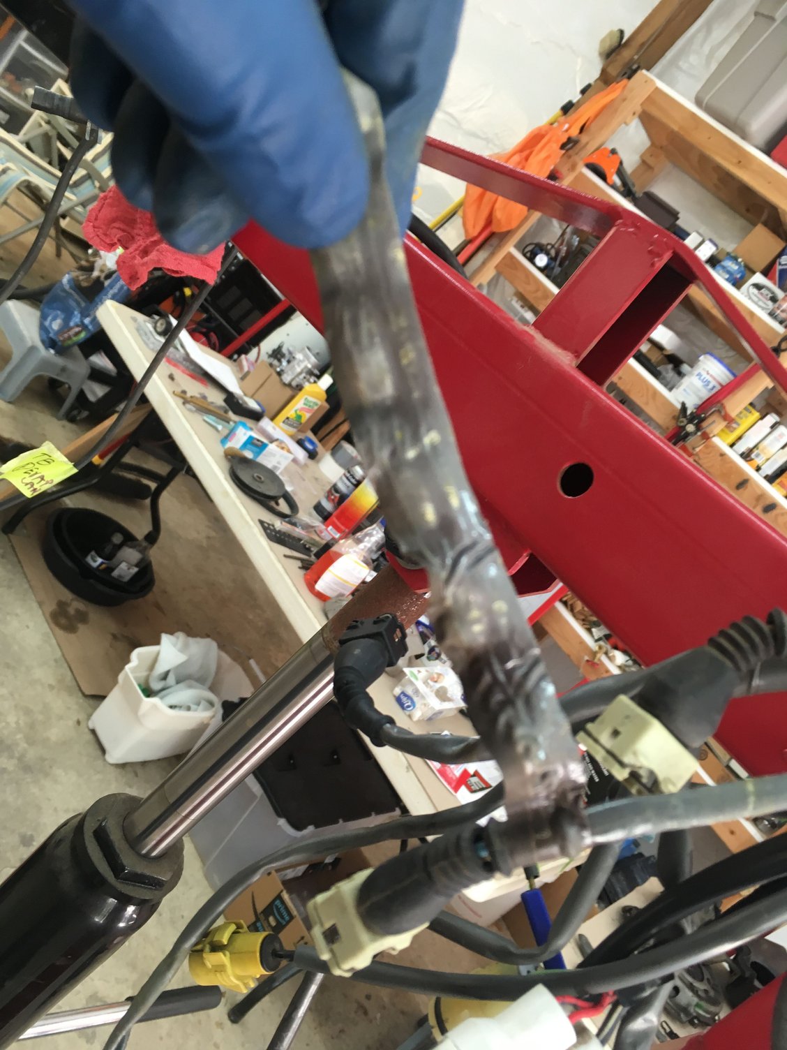

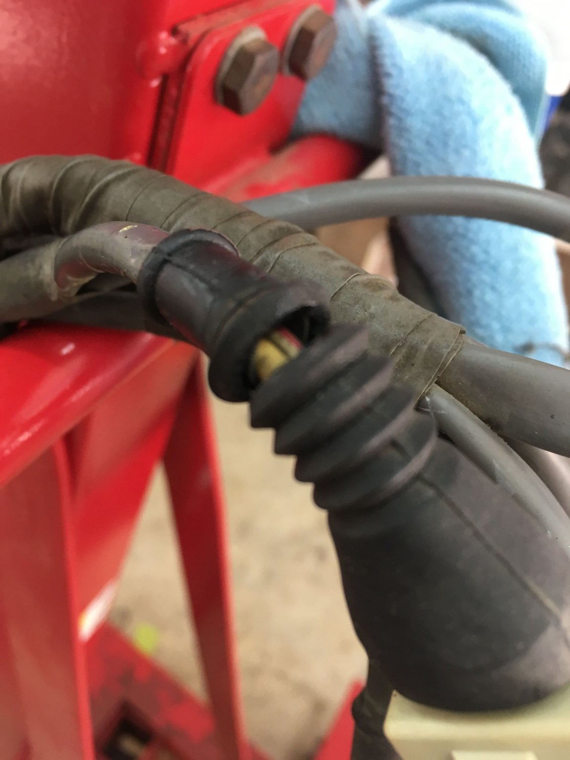

32 years of rock hard and broken boots. Could not source Toyota boots. I found suitable replacements from Prowireusa.com.
Carefully unwrapped some of the old, deteriorated wrapping.
Another broken boot.

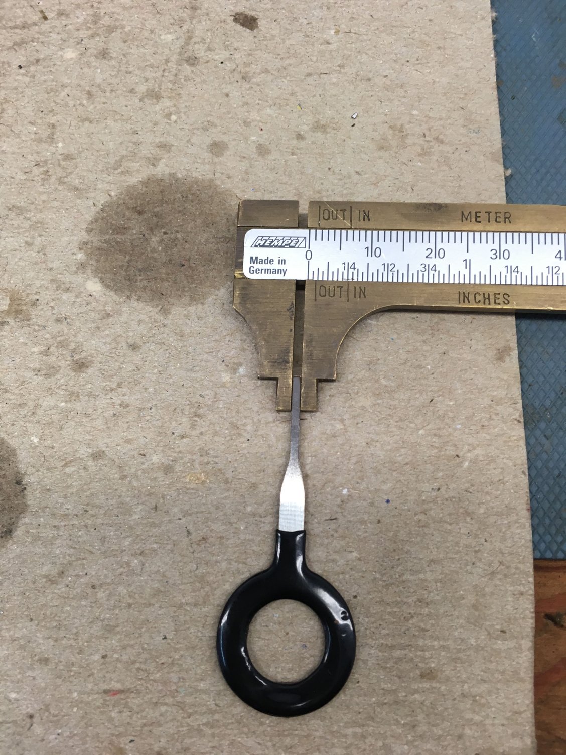

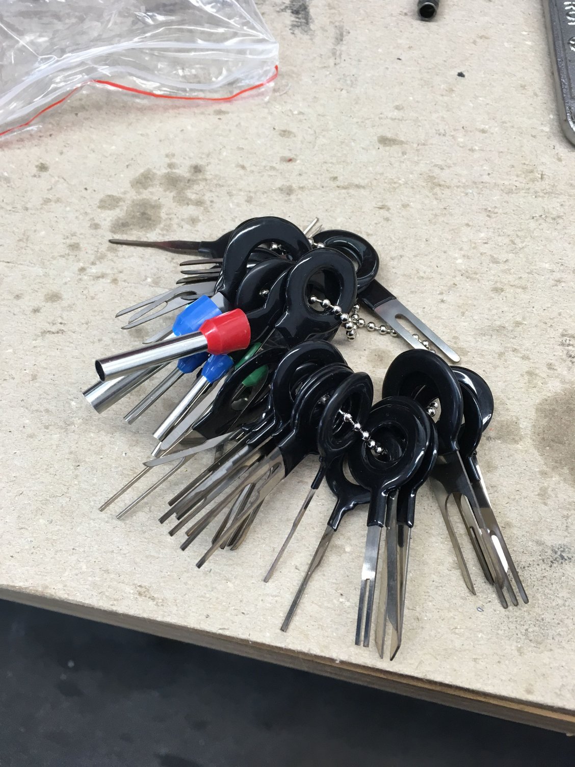

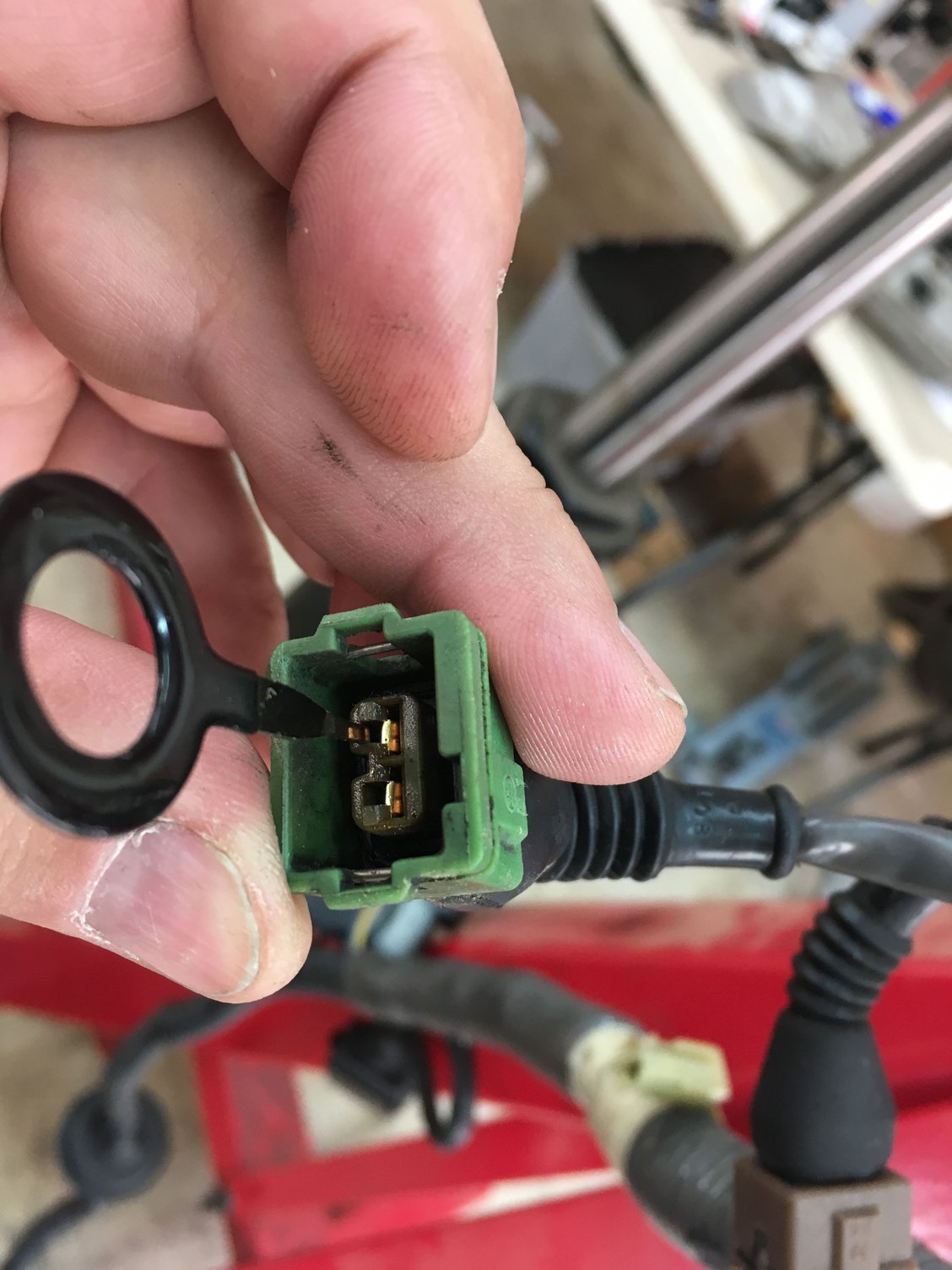

Cheap "de-pinning" tools via Amazon. About 5 bucks.
Of all the de-pinners, the 1.5mm did the trick. It was a learning process. Go gently. Push in, slight gentle twist, push-pull wire.
De-pinned! Take lots of pictures and reassemble correctly or your injectors won't work.

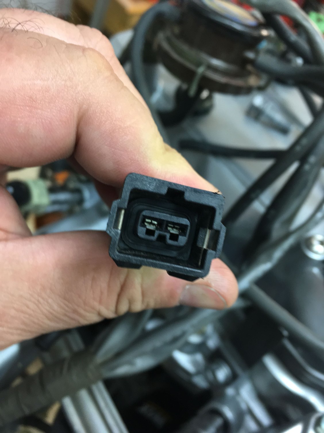

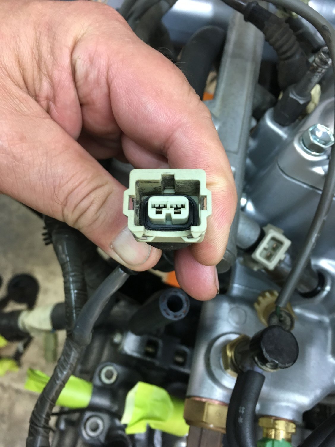

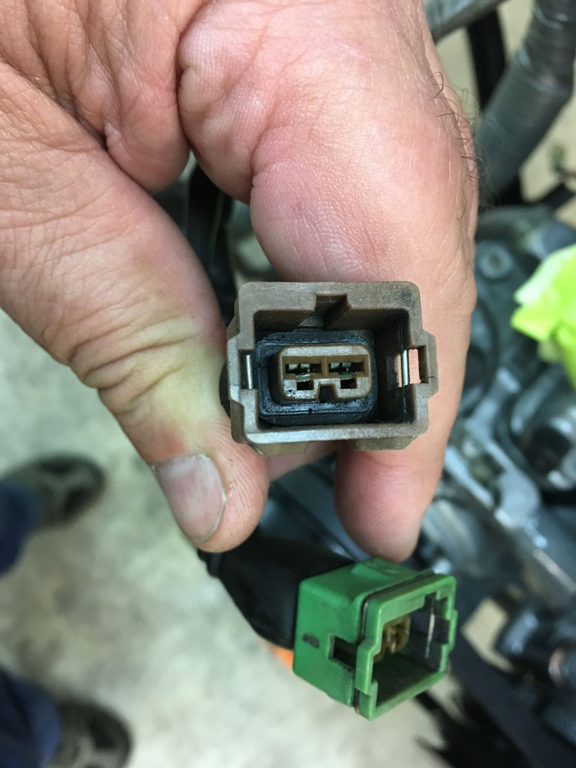

Main injector connectors type C center lug. White. All my connectors were de-pinned and cleaned in ultrasonic tank.
Cold start injector type C center lug. Black.
Cold start timer sensor type C center lug. Brown

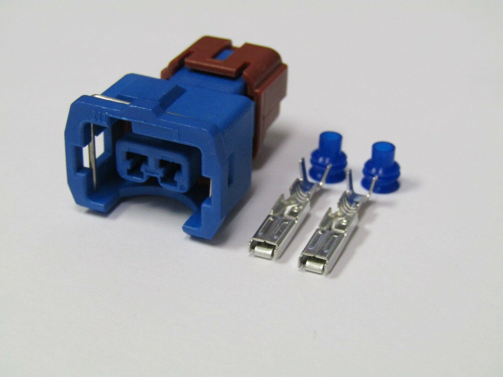

Standard makes the correct type C center lug plastic connector if you have broken plastic. Available only in white.

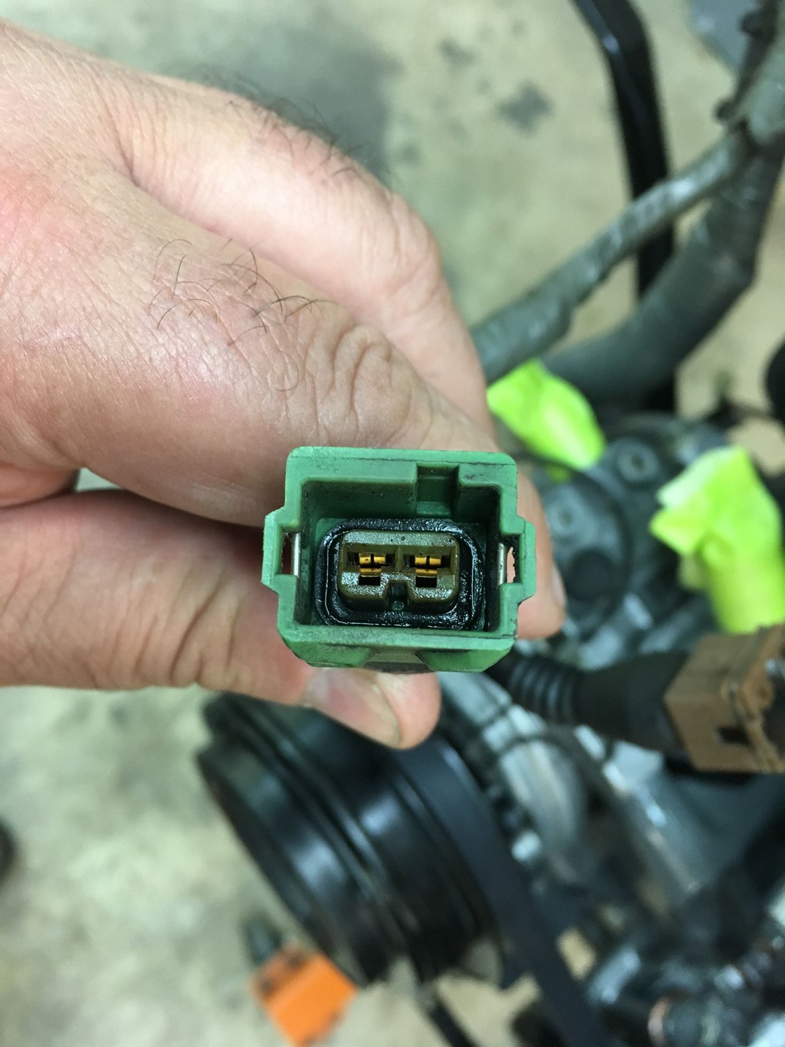

Green ECU connector has an offset lug. I could not find the Standard replacement for this connector.

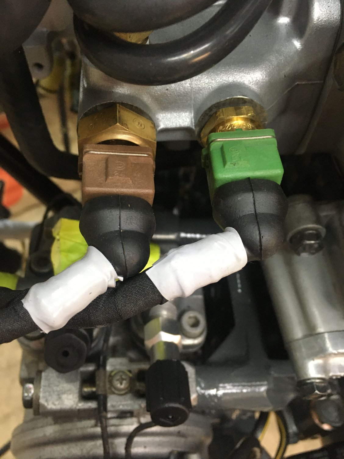

De-pinning ECU temp sensor connector.

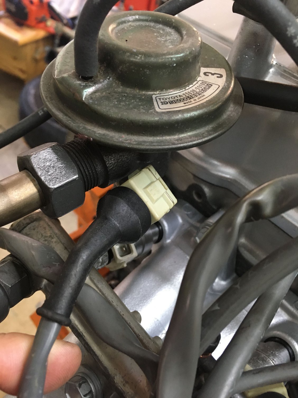

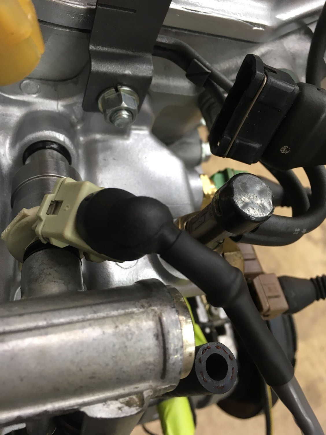

New 90 degree boot on VSV.

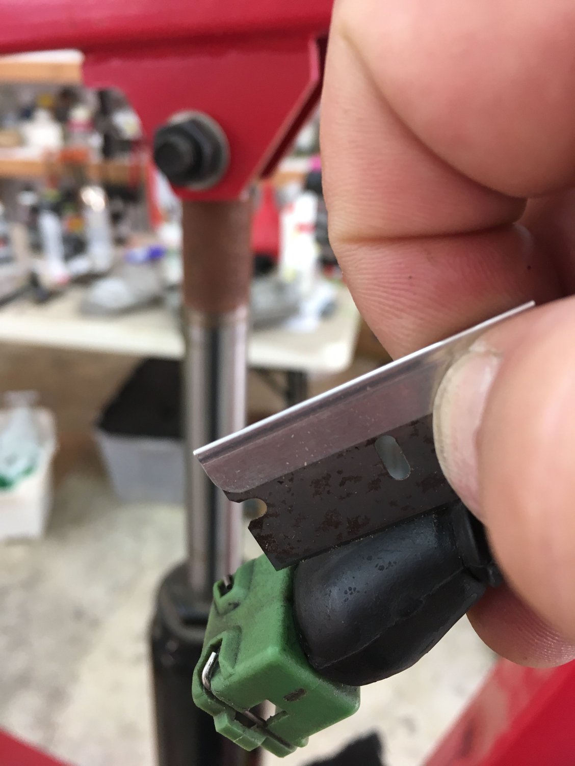

Carefully cutting off old hard boot.
I used 90 degree boots on ECU and Cold Start Timer sensors. Also used a 90 on cold start injector.
I used straight boot on injectors 2,3,4
A 90 boot worked better on injector 1.

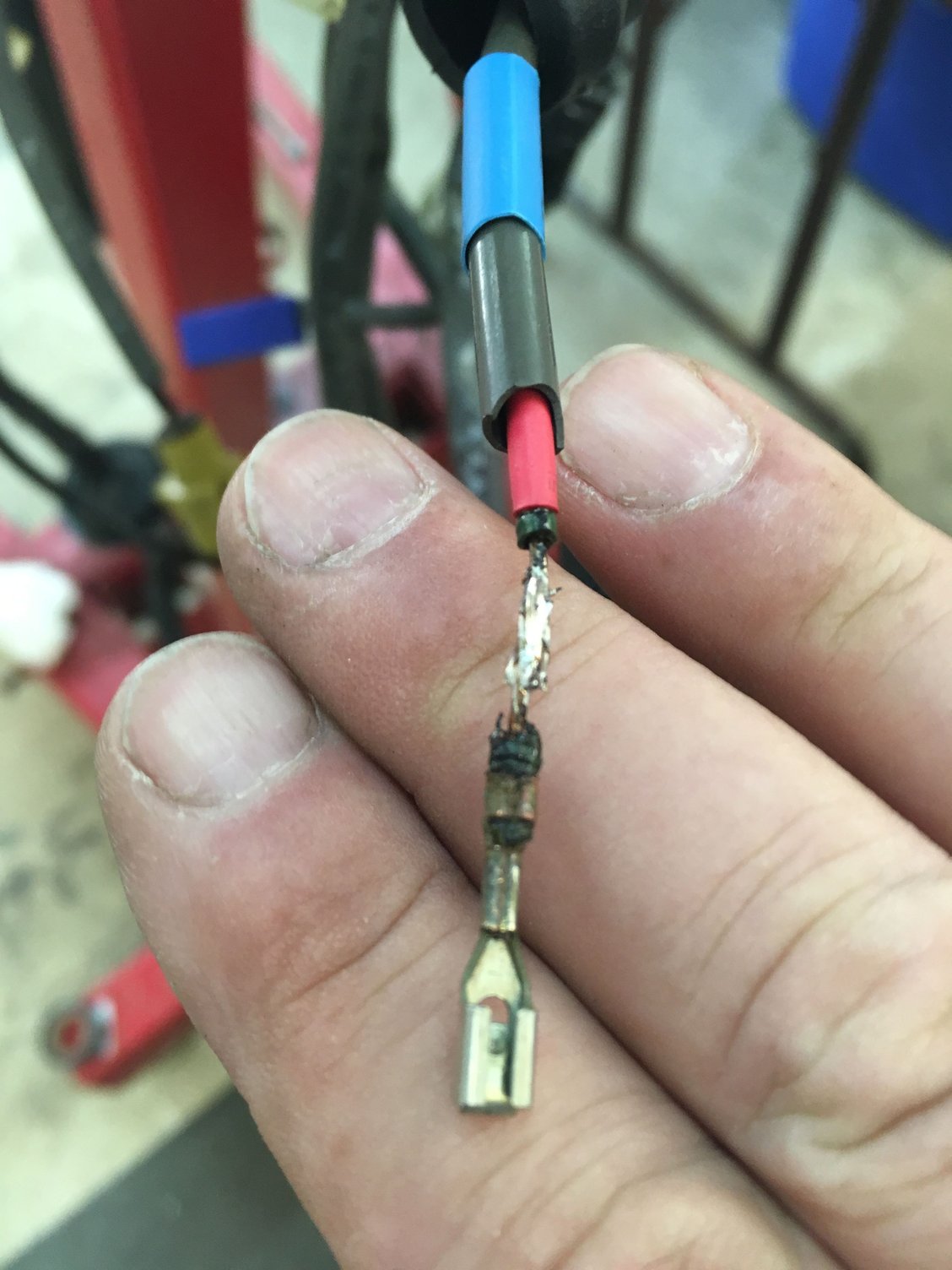

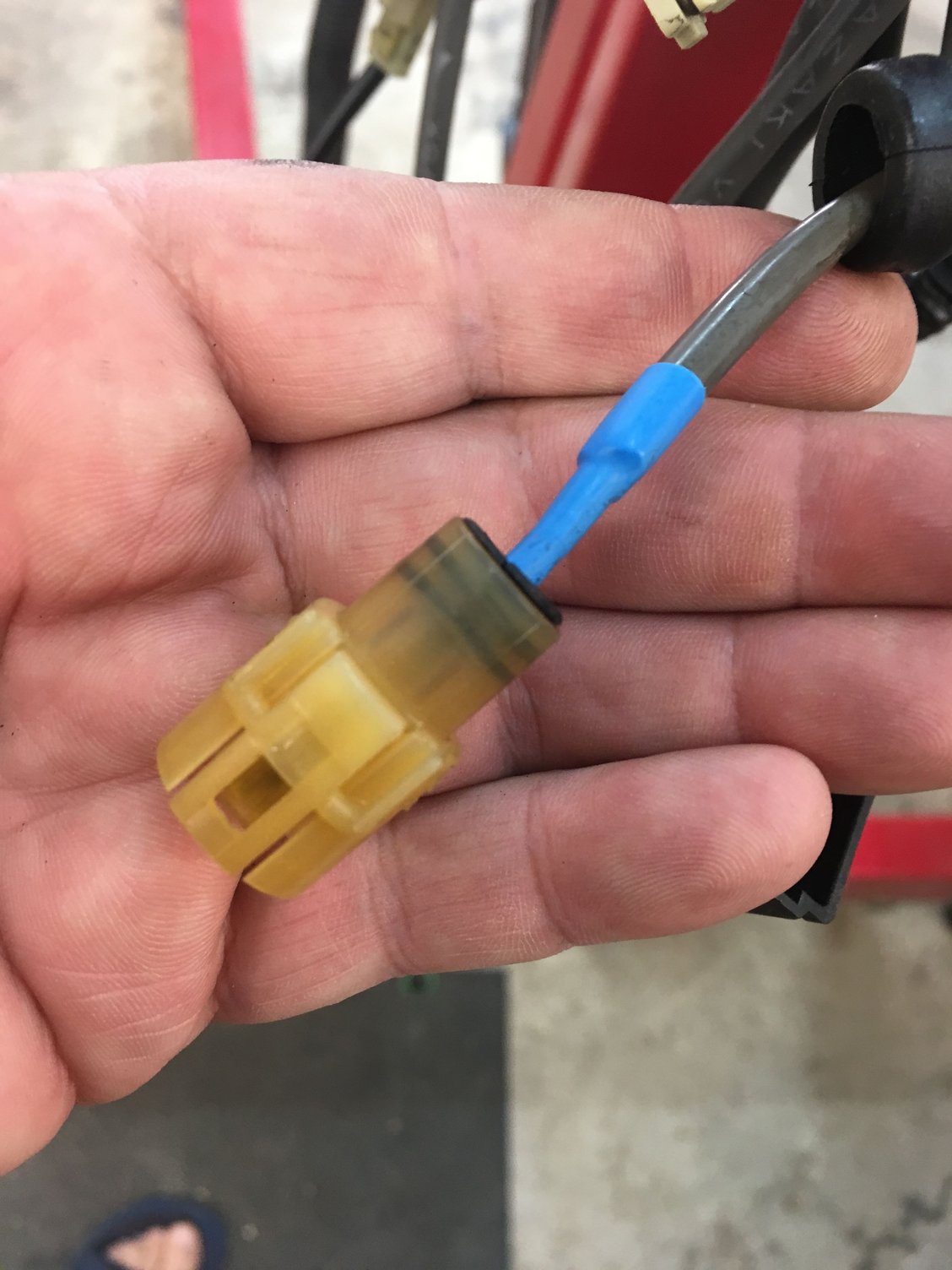

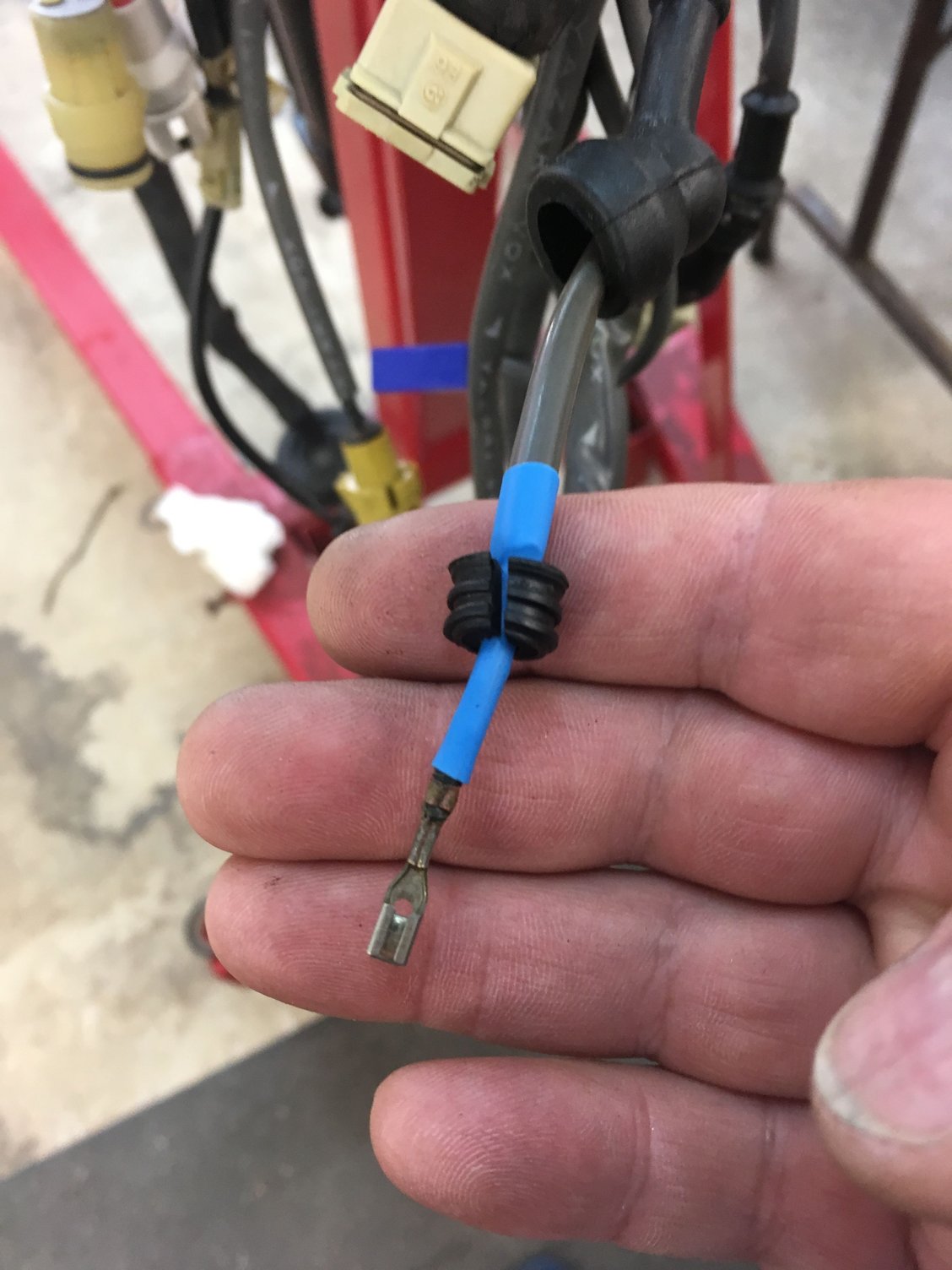

Single wire from sensor (idle up?) on top of thermostat housing nearly broken.
De-pinned and plug removed.

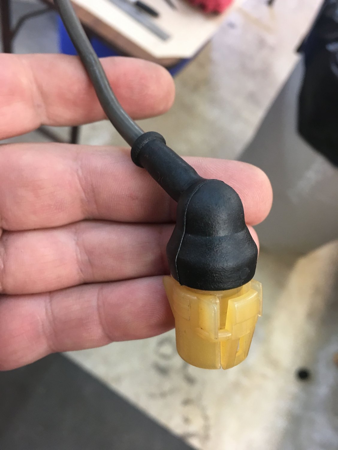

New 90 deg boot and shrink insulation placed on wire. Wire resoldered.
Shrink insulation.
Re-pinned in plastic connector and replugged.
Boot installed.

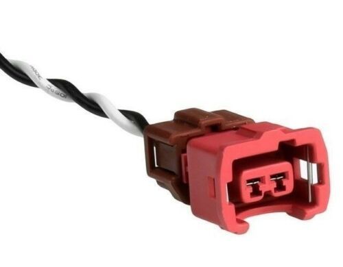

Here are two similar connectors where one is notched L and the other notched R. These have a different back end design, but might work without any modification. They're available on ebay.
Above - Coolant Temp Sensor & Idle AAC IACV Plug Connector for Nissan 300ZX
Above - Fast idle / Air Regulator connector for Nissan 300zx
