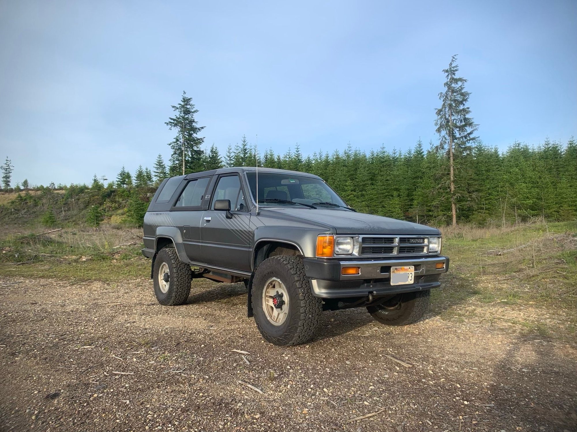

Chris here (84 yota dude). I made a thread discussing the fuel issue. Here it is: https://www.yotatech.com/forums/f116...96/index2.html
Beyond excited to get this thing running correctly. Such an awesome project!
And here is a picture of the 4Runner. Love this rig!!
