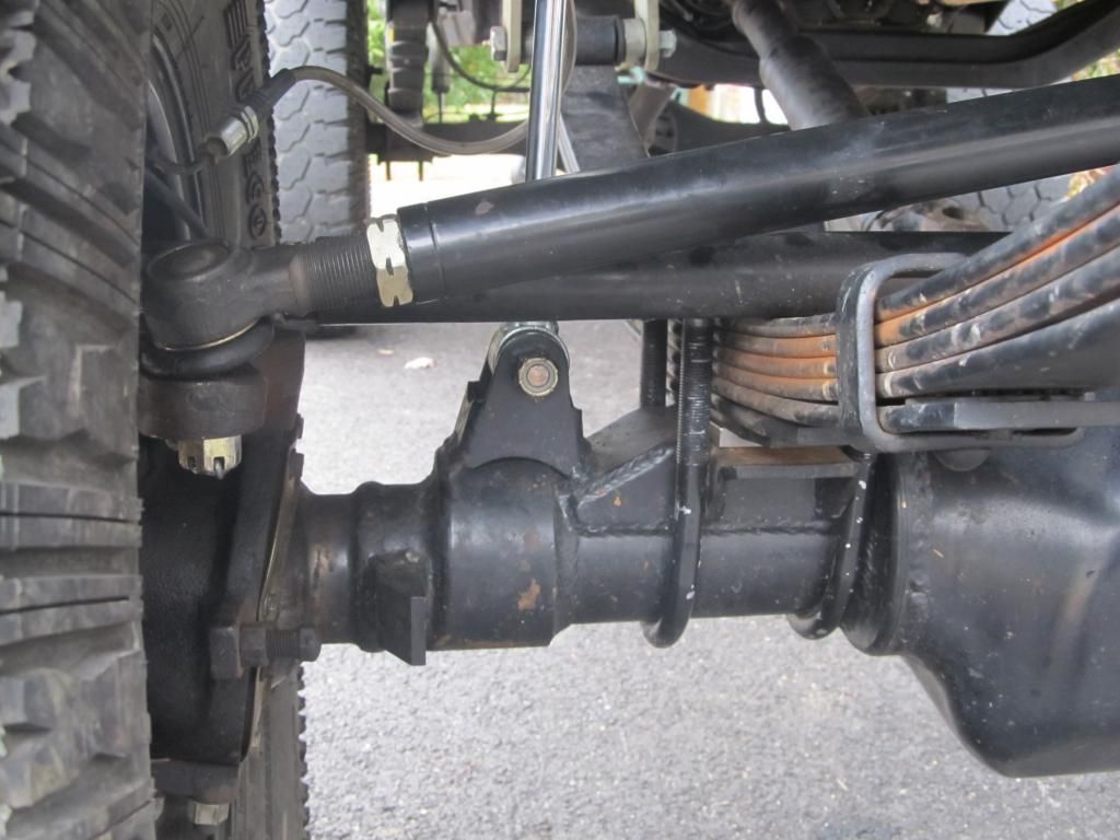

Just put my 4 degree shims on the front the other day to hopefully decreasethe angle a little bit on the front drive shaft. I didn't go with the 6 degree because of the steering drag links and good thing I didnt go with the 6 because the 4 is making them rub a little bit. I need some help trying to fix this problem...any advice is awesome.
Has anyone ever heard of lowering the drivetrain by throwing some washers or spacers on these bolts? I was thinking of loosening the engine mounts and these drivetrain bolts, throw some washers in there to lower it a little and then tighten everything back up. I know it sounds sketchy, but has anyone ever heard of this?
A picture of my steering arms, how can I fix this rubbing?! :-/
Hardly any difference in the angle compared to before...AHHH!

Why not do it like this:
Obviously it would be longer than pictured but that would eliminate the stress on the driveline and you could remove the shims. You could even put one of those joints on the rear shaft and remove any shims back there.
(Also I could be completely wrong. I am by no means a professional when it comes to driveshafts)
