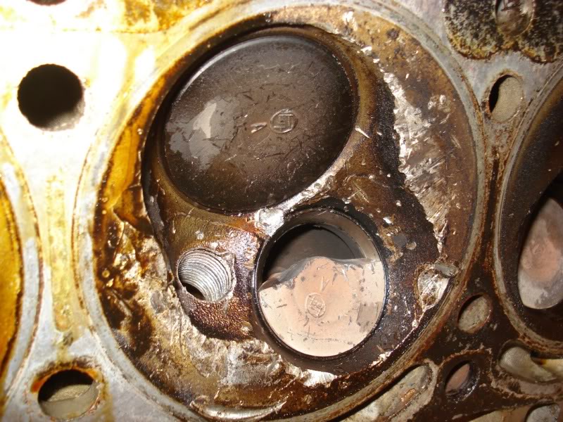

Shattered Exhaust valve in cyl #2 is what caused the pre mature rebuild.

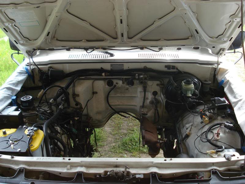

Motor is out of the truck and block should be back in my hands by early next week. Big Thanks to Couger69 for letting me borrow his cherry picker!

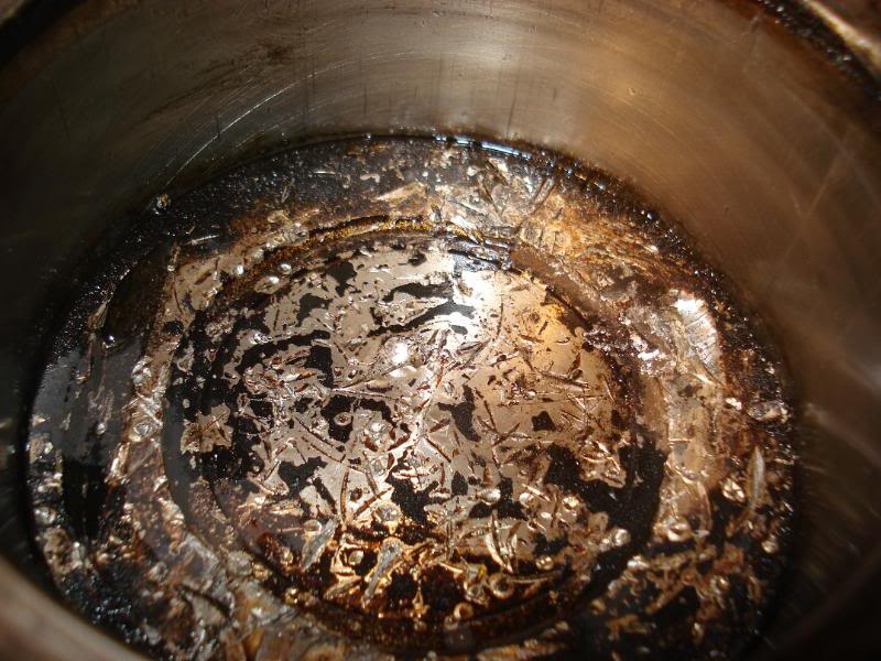

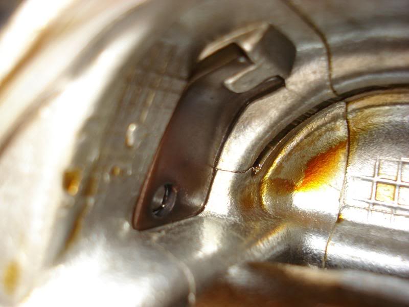

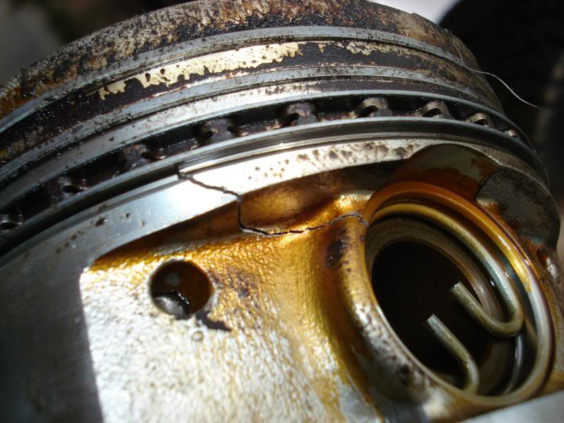

Piston # 2 actually cracked all the way through from the force of it smashing the valve pieces into the head!

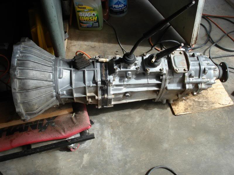

Trans is out and getting a good cleaning or maybe even a soda blasting to get it really clean.

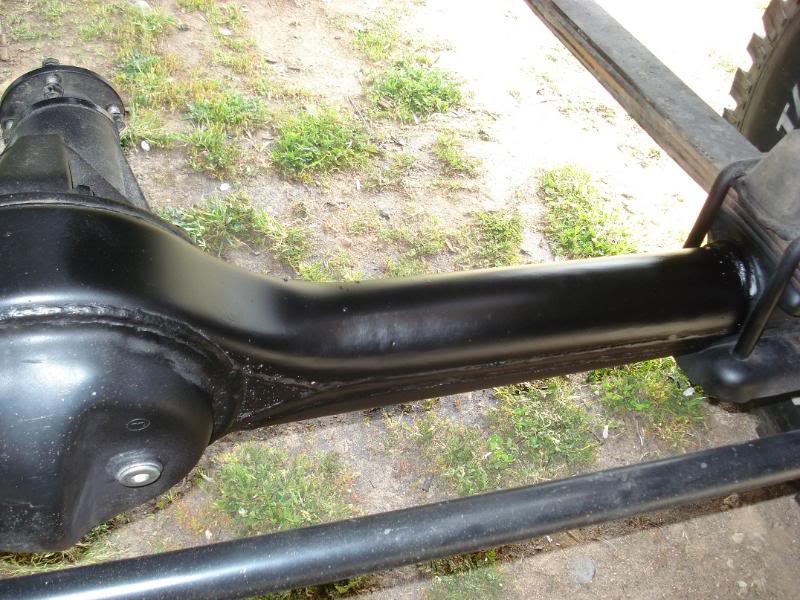

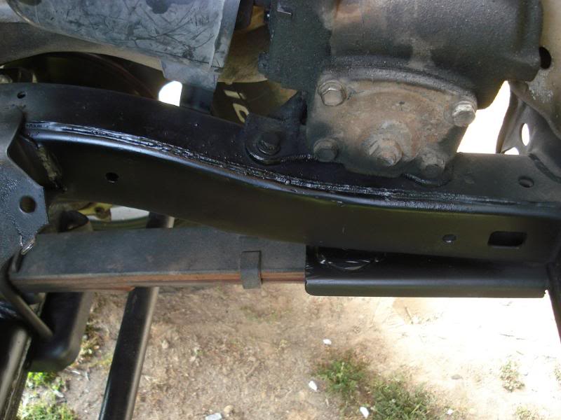

Since i have all that free room under the truck right now i decided to get under there to shave the Torque rod bracket off the axle along with the steering stabalizer and sway bar tabs. Now it will be ready for when i brace it later on.
Also shaved the torque rod bracket off the frame because that will be in the way of the high steer box and plating later.

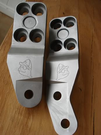

Oh and i picked up some Marlin high steer arms on Thursday! :thumbs: They were used, so i had to clean them up a little but i cant wait till i get started on the steering. :willynilly:
After the sand blasting and ready for paint....

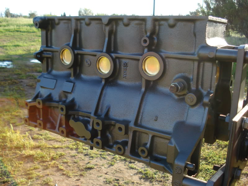

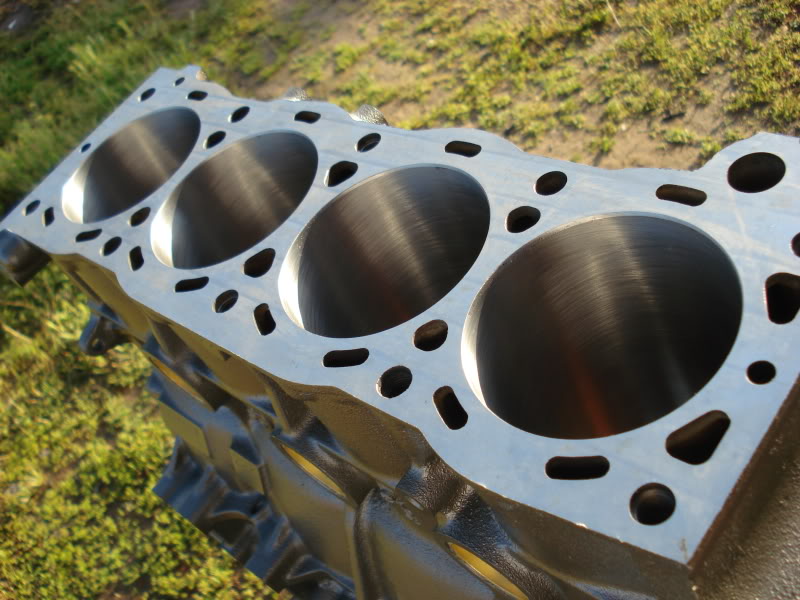

OK, got my block and crank back on Friday from Ron's Machine shop. I ended up picking it up from Auto Machine Specialties and taking it to Ron's because they were slacking big time on the machine work :nonono:....they had it for almost three weeks! :tantrum: and Ron's finished it in about a day and a half! :clap2: but anyways.... i Painted it and pressed the new freeze plugs in today so i am just waiting on my new King bearing for the bottom end and my head to ship out from Putney's Next week Then we can really get roll'n :wink2:
painted with fresh freeze plugs
Bored .030 over and decked the block as well as the timing cover so the head gasket sits flush on both.

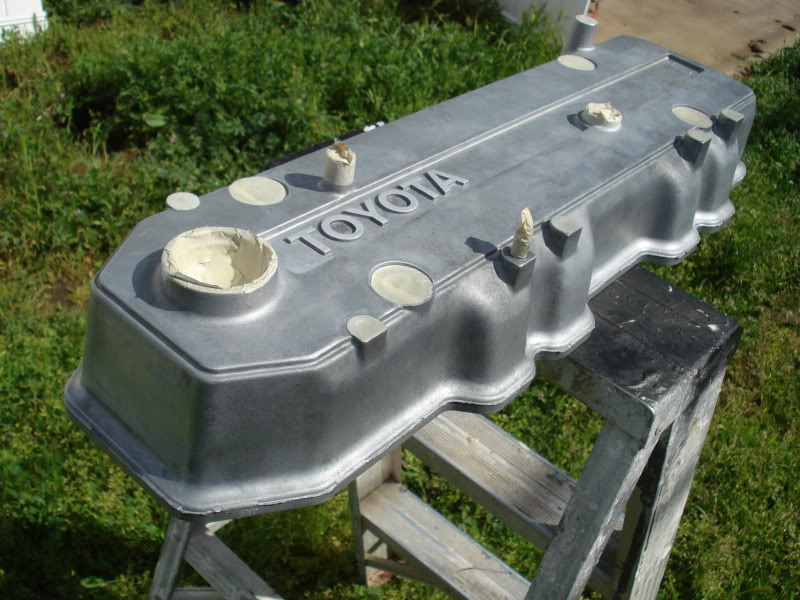

Valve cover soda blasted and masked

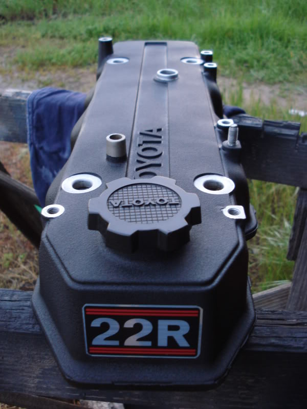

Valve cover Painted with VHT Wrinkle Black paint and fresh 22r decal.

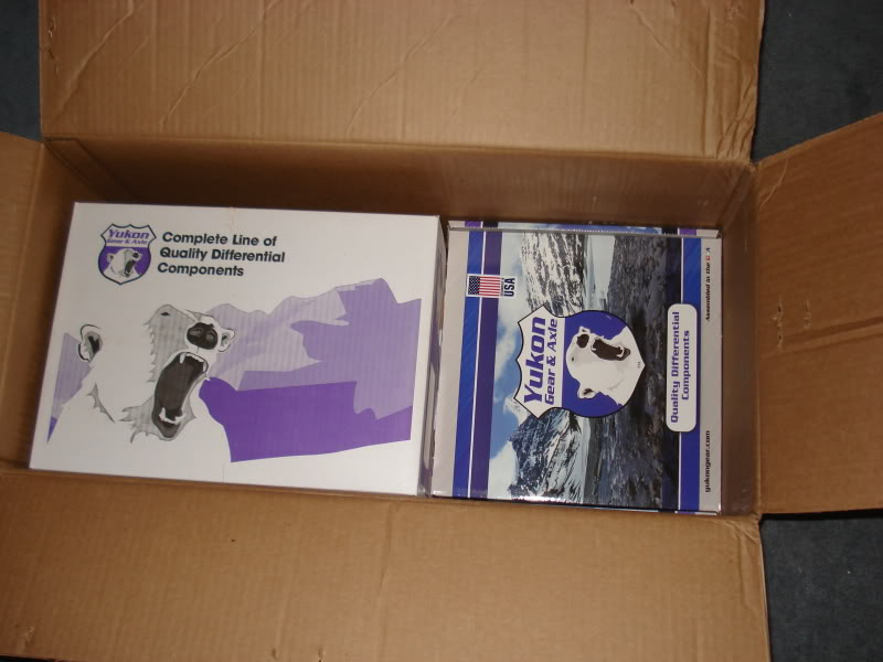

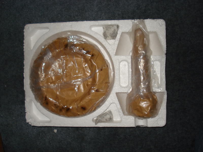

Got my Yukon 5.29's & setup kits for my 2 e-lockers! :circle: Now i just need the time to set em up.....
Its a good sight!
Can't wait!
THAT LOOKS AWESOME! Great choice! Good luck with the build, looking forward to your updates...
Old Mar 28, 2011 | 11:19 PM
spc mike's Avatar
Joined: Dec 2008
Posts: 119

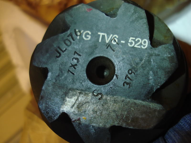

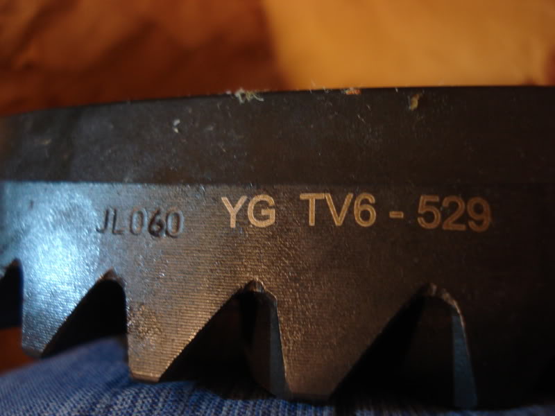

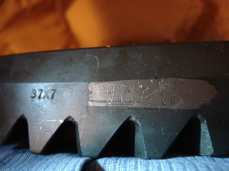

Hey thanks 86 toy. I hope it hold up and doesn't start chipping. But right now it looks awsome...and C0ugar69 here are some pics of the markings that are on the gears..... They are Genuine Yukon's, not like some that have said they got some with questionable markings in a Yukon box.
pinion
heres a couple shots of the different markings on one ring.
