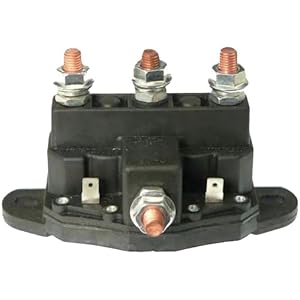

New battery from Napa, and swapped out the relays in Parrallel one that is a little more stout to switch on the villager fan, still need to find some kind of a cap for the open terminals

Dont know if one of the big home stores might have something to cap those off. Never run into that. But I would want ot get them covered also. Somehow I would find away to short it with a wrench if it was uncovered.

If you can't find caps for those treminals at any of the auto or home stores you could try an electrical whole sale place like C.E.D, ESSCO, or WESCO.

You will find caps for those at a boating/marine supply store.

and the new continuous solenoid relay melted.. so I am back to three relays in parrallel until I can find a better set up..

from Amazon:
150 Surge Amps, 75 Amps Carry for 5 Minutes....
What is that suppose to mean on an advertized continuous duty solenoid...doesn't continuous imply ...uh... continuous?
Is that the one that melted? I'd try to get a refund for misleading information.
The Nissan Quest/Mercury Villager fan i use, had 20amp relays attached to them. Now those relays IIRC are rated for 65amp surge, then 20amp constant.
i hope you get that sorted out, i know the feeling of wondering if the efan is going to kick on or not.
good luck
