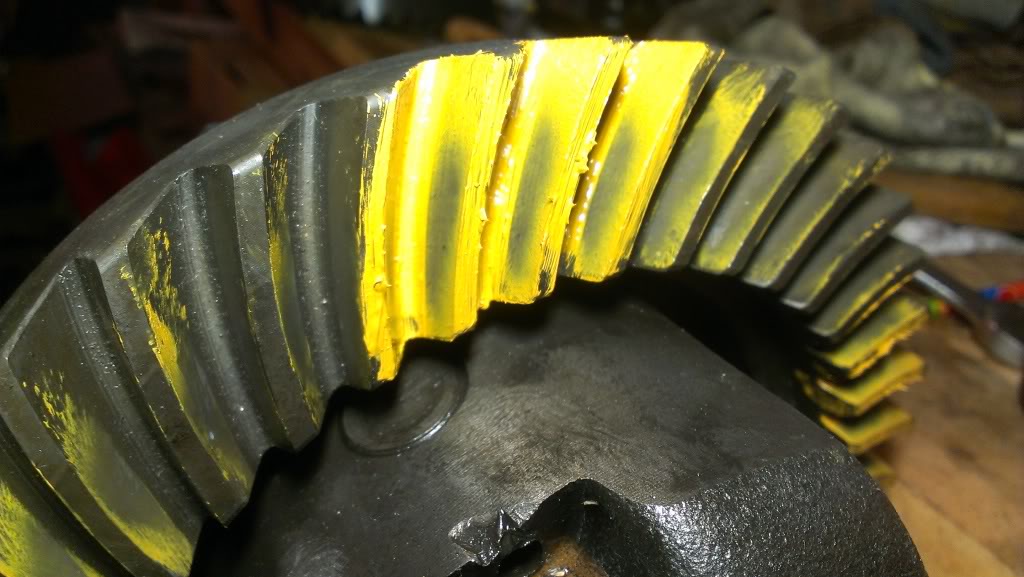

Rear diff starting making a terrible noise while coasting...
ordered new yukon gears, and bearing kit from Marlin...

pulled it out last week
First pattern from last night
backside
seems a little shallow...
then we had an issue with the Solid Pinion spacer not fitting on the Pinion..
this was a New G2 pinion solid spacer and a new Yukon gear set... sucks..

Outsane - just did my gears not long ago. I agree with you, that's a tad shallow. Do you mind sharing what your backlash and pinion shim value is? I'm pretty sure if you ask ZUK, he will tell you that is shallow as well, he seems to prefer slightly on the deep side for strength. That stinks on the solid spacer (maybe they sent you the wrong one?), but good choice on the Yukon gears.
Here's my final pattern:

Thanks cory, I had a buddy help set up my gears and the patter is much better..
