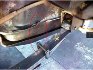

Originally Posted by NYHumpinUtah
What clips are you talking about
The clip that holds the leafs together. Bolt may hit pinch-weld when it flexes.
Attached Thumbnails My 84 pickup ground up-screen-shot-2018-05-06-10.54.36-pm.png
Old May 6, 2018 | 10:14 PM
NYHumpinUtah's Avatar
Joined: Dec 2017
Posts: 839
Likes: 77
From: Enoch Utah
Humm
I'll have to look at that tomorrow, I didn't think I had a problem...................
I know the frame shackle bolt came close but that's not a moving part.
Old May 7, 2018 | 10:07 AM
Joined: Dec 2017
Posts: 839
Likes: 77
From: Enoch Utah
Well, I checked it out today and it does clear, not by much but it is a good 6" from the gas tank. I will however turn the bolt around so the nut is on the outside.
