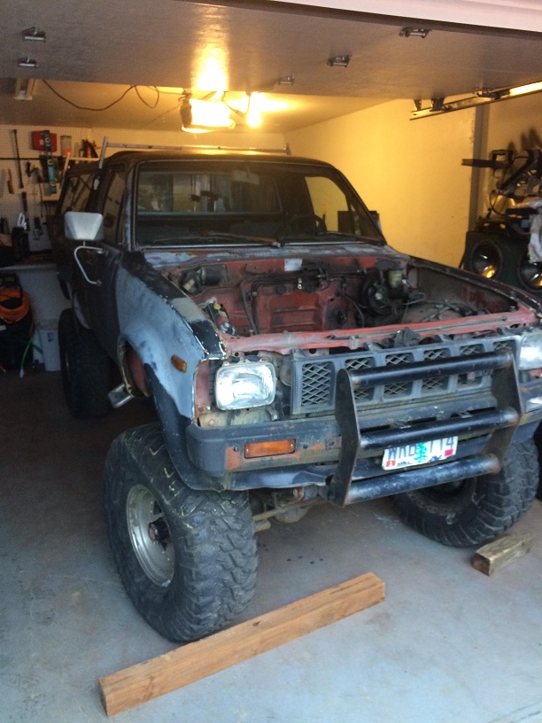

Well now that I've actually got this pickup in my possession I figured I should start a build thread. I've actually owned it for a few years now, got it from a good buddy of mine who initially started a 22RE swap, but life got in the way as it usually does. Its a little rough, mostly due to sitting outside in the Oregon rain for years. This will pretty much just be a hunting/weekend chores rig (at least for now)
To do(in no particular order):
-Swap in 3RZ (after rebuild)
-W56 5 SPD swap to go with the 3rz
-Paint as you can see is a mix of different rattle can jobs
-Lower the suspension, probably a combo of 2nd gen RUFs and the Rancho springs that are in there now, pull the blocks from the rear
-Swap out the 35s for 33s
I'm open to suggestions, thoughts, ideas, links to good references. I didn't get any of the dash/engine harness for the '83, but I have the complete harness from the donor tacoma so I'm going to try and just use it.
And a build thread without pics is no thread at all!
*edit* Oops missed the build thread section, can an ADMIN move this?
Attached Thumbnails Project: Too tall-yota2-2-.jpg   Project: Too tall-yota1.jpg

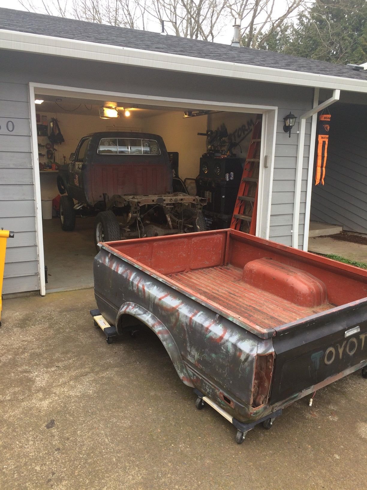

Got a little more accomplished over the weekend. Bed pulled off for better access to swap the tank.
Engine block painted, ready for some internals. If anyone has pics or a link to a 3rz timing chain/cover job I'd love to see it. I got this motor in pieces so its going to be quite a chore getting it all back together correctly.
With the bed off I was able to get a pretty good idea of the condition of the frame. I still need to powerwash it (just picked up new orings for the wand), but I'm extremely happy with the lack of rust. I think some light scrubbing, marine jelly, and maybe some POR15 and it'll be good to go.

I didn't get a whole lot of garage time this weekend, I was able to roll the frame out and get it cleaned up a little more. I used 3 cans of Dollar Tree oven cleaner and let it soak for about 15 minutes, then power washed off the frame. It did a phenomenal job getting the years if grease and caked on mud off of it. This frame is in great shape considering the age. My plan is to flap disk the worst of it, and then spread a rust encapsulater before applying another coat of paint to it.
Sunday I met up with a guy parting out a '94 2wd and bought the fuel tank off of him. I got it for a steal considering I got the tank, filler neck, sending unit, pump, and was able to cut all of the wiring with at least 12" of pigtails, all I had to do was pull it (bed was already sold off.) I can now confirm that this year tank is a direct bolt in for a 1 gen short bed. Paid $50,
Oh and the tank had about 8 gallons of good fuel in it, so it didn't cost me anything to drive out and get it.
