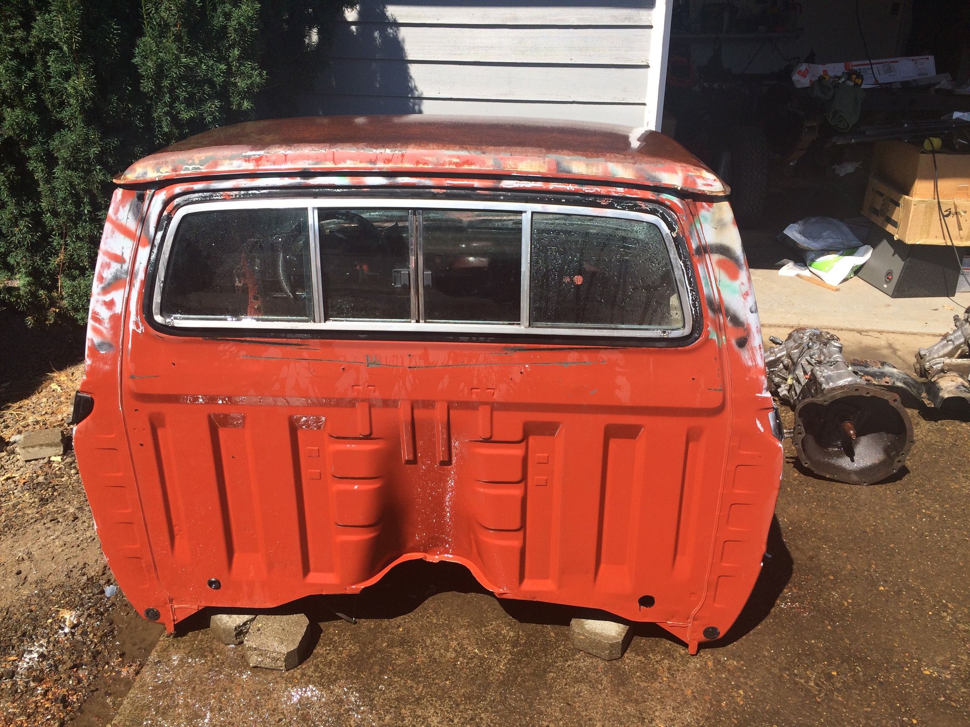

Small update. I was out powerwashing and decided to turn it onto the cab of the truck. It took off some of the moss and dirt, but none of the nasty spray paint its had over the years. So I decided I'd try some Dollar store oven spray which I used to clean engine bay/motors/trannies etc. Worked like a charm taking off a lot of the spray paint. Its a nasty chemical so I only leave it on a minute or two before spraying it off with a ton of water. It did a good job of taking off at least the black paint. I'll have to try some acetone and elbow grease to get the rest off. I'm really hoping to save the paint as I love this color!
Here is what it looked like before:
and after:

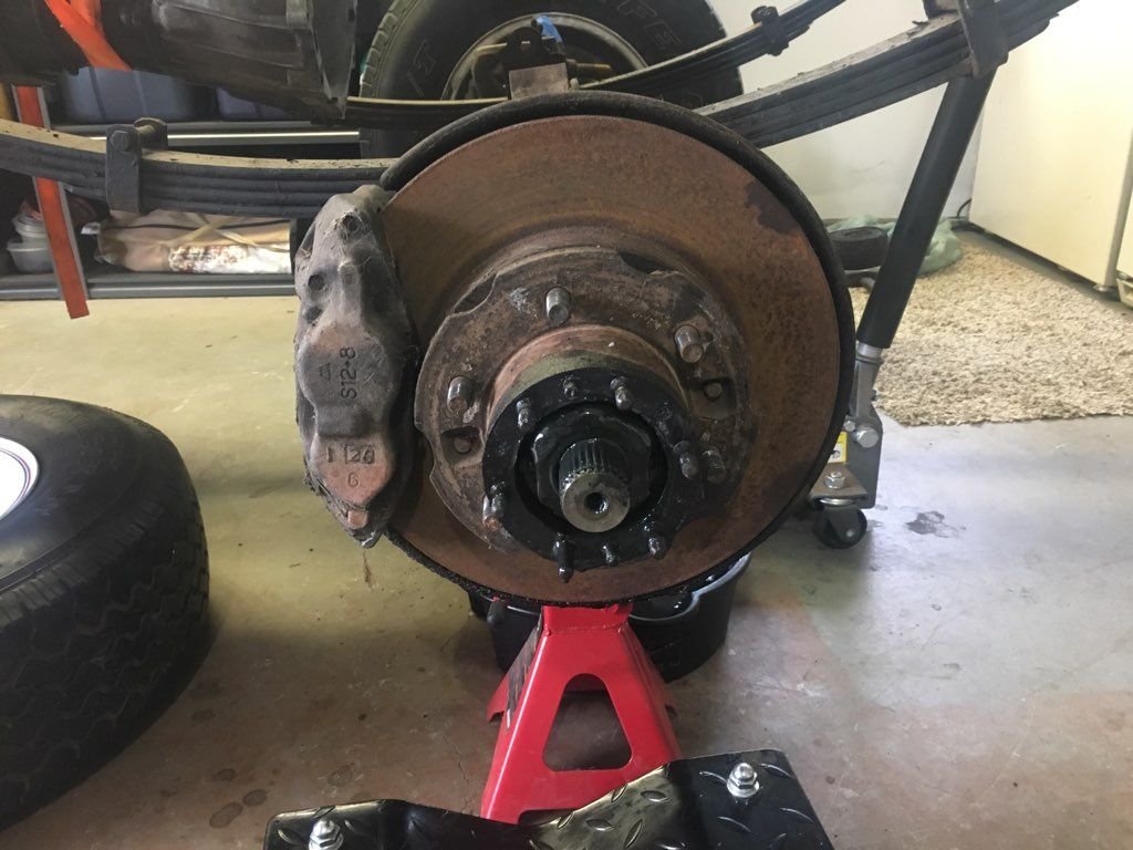

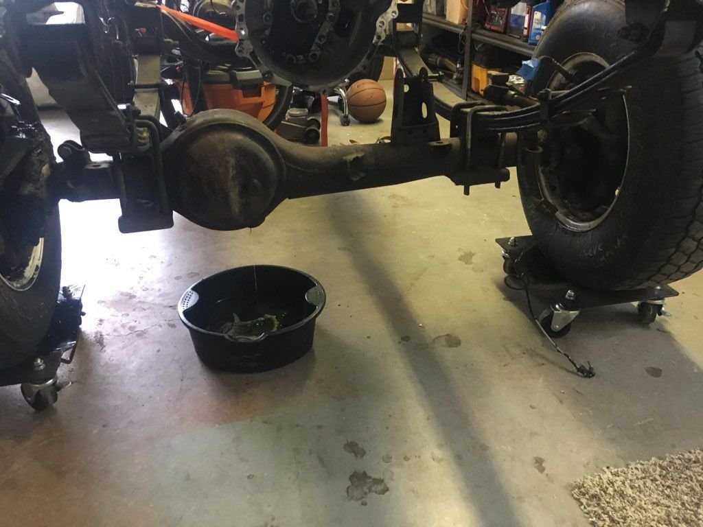

I've been finding a few minutes here and there to get in some wrench time. I got all of the steering components off of the frame and axle (minus arms) to make room for the hy-steer which I still need to purchase.
So then I moved onto the knuckle rebuild (because I already purchased this from Marlin)
Yumm axle grease gear oil stew
The large axle nuts are completely marred from years of PO using punches to spin them off. Thinking I'll get some replacements to put it back together.
Made it this far last night, decided to let it soak in degreaser to help with clean up.
My immediate plans are to finish the axle tear down, including completely removing it, sand, prime and paint it and the leaf springs. Then reinstall and rebuild the front knuckles. HOPEFULLY, this will get done this month, but only time will tell lol.
