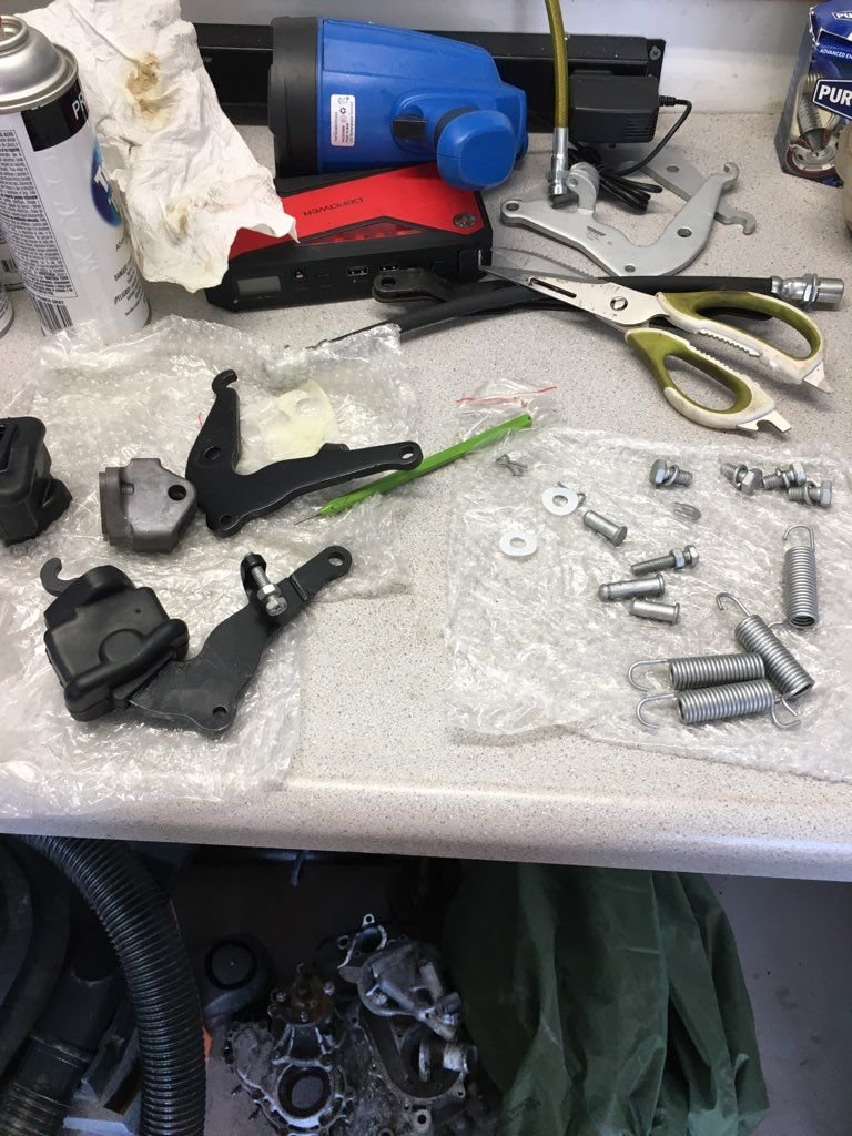

Life sure has a way of getting in the way of progress! The wife and I are shopping for a place with more land than we have now so that I can build a shop, but the housing market here is going crazy, and we got bid out on a couple places. So we decided we would sell our house and move into a travel trailer so that we don't have to buy on contingency. Which means I need to get this frame so that we can roll it onto a trailer.

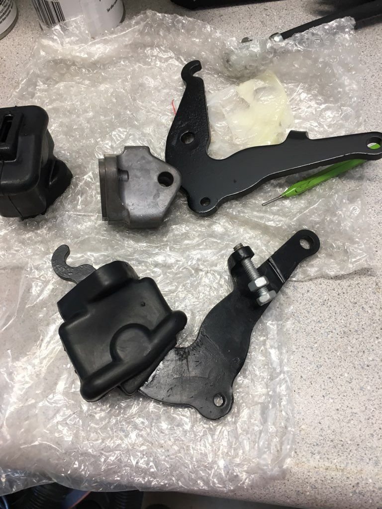

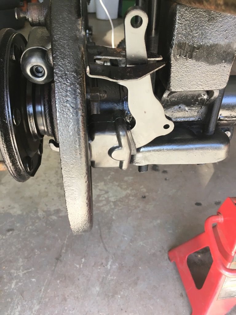

I dismantled the rear axle, bought Marlin rebuild kits and repainted.
The bell cranks that came off were absolutely shot, so I bought a dorman kit for a Tacoma, everything in it worked great except for the bell crank arms. So I wire wheeled and painted the originals.
Then I reinstalled all of the drum components, and wrapped up the rear axle.....only to realize I put the bell cranks on the wrong side
So I had to take it all apart again, switch sides, and then reinstall, needless to say, I'm pretty good at doing drum brakes now lol

Nice and shiny parts! Nice work. I skipped doing my bell cranks, the arms are seized and I just didn't have the funds.. plus I have an auto, who needs an e brake!
This is the kit I used
Amazon Amazon
, wasn't terribly expensive. Looks like everything fits your rig, I used everything but the bell crank arms.

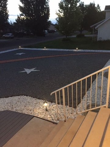

Originally Posted by jakey poo
Haven't really gotten much accomplished, I did order new body bushings and received those. With the nice weather we've been having my time has been spent on the yard. Hoping to get some more work done on the pickup with the extended weekend that's coming up. In preparation I did get the garage all cleaned up.
Here are some pics of what I've been doing in the yard.
Completely relandscaping the front yard, including trying to get it a little more level. Will have fresh grass, barkdust, shrubs and we're thinking a dogwood tree added.
Where we're at as of today
Smaller project in the backyard, 12'x12' remote patio for a fire pit. This will be finished with pavers,
Hey Jake
This is what I ended up with on my front yard
No more cutting grass......................

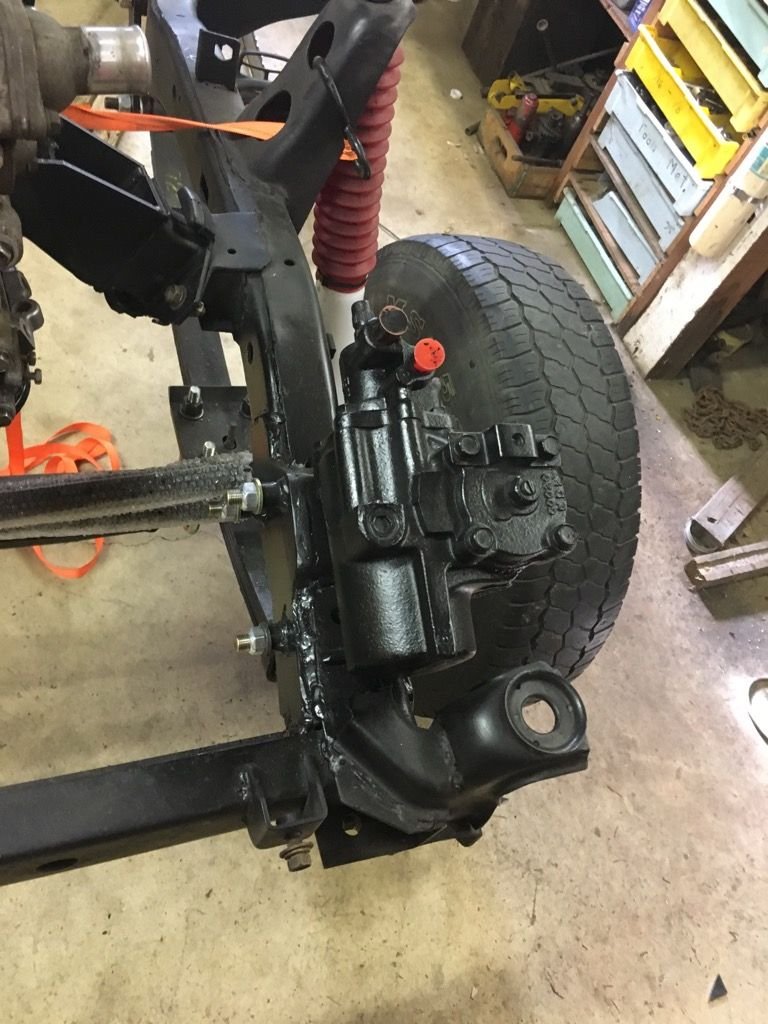

Its been awhile! We sold our house to become more competitive in the market around here and moved in with my inlaws. I was how able to get quite a bit more accomplished on this pickup.
I bought an IFS steering box from NYHumpinUtah (thanks again!) and got it installed.

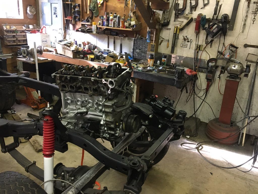

Then I finished building the motor, and dropped it in the frame for hopefully the last time. I guess I didn't get a good picture but I also installed the transmission/trans case/Bud built crossmember.

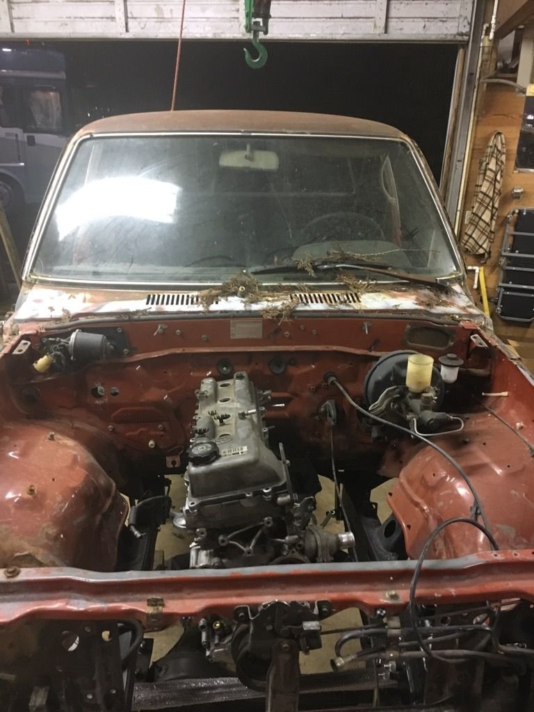

Then we got the cab mated back to the frame!

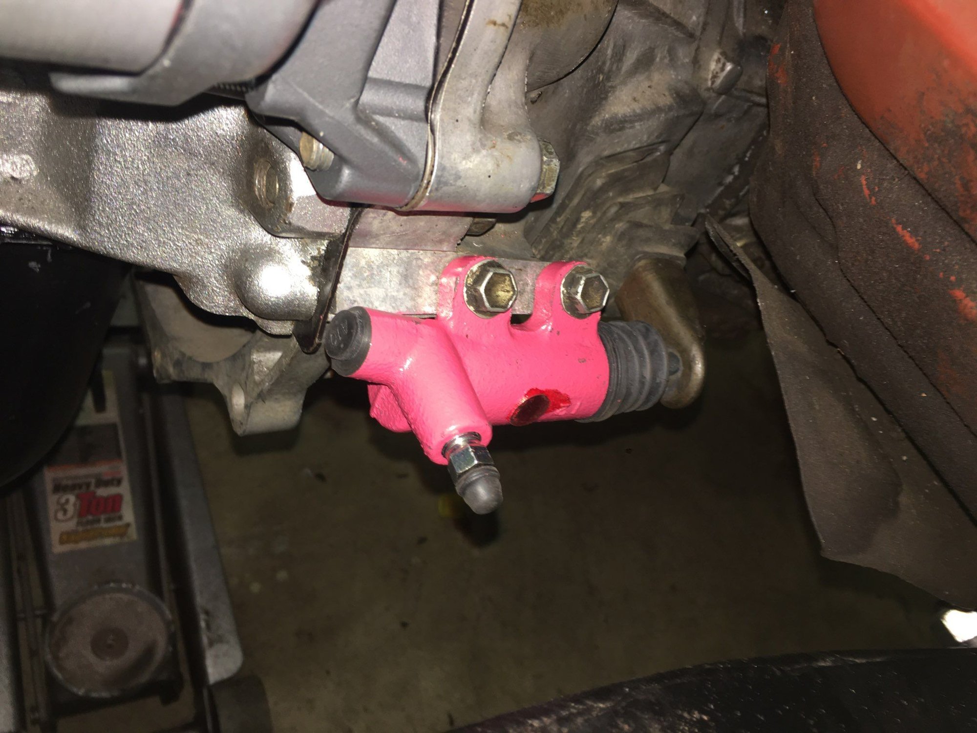

Spent the holiday break at my BILs, but found a few minutes in the shop last night. Installed a reman Denso starter:
And an Aisin Slave:
I've got an Aisin master sitting on the shelf, decided to let the hardware soak in PB blaster overnight before trying to remove the old one.

Idk if its the same here, but on my 3.4, I had terrible clutch problems until I installed both aisin cylinders.

I've been trying to purchase OEM to avoid any problems

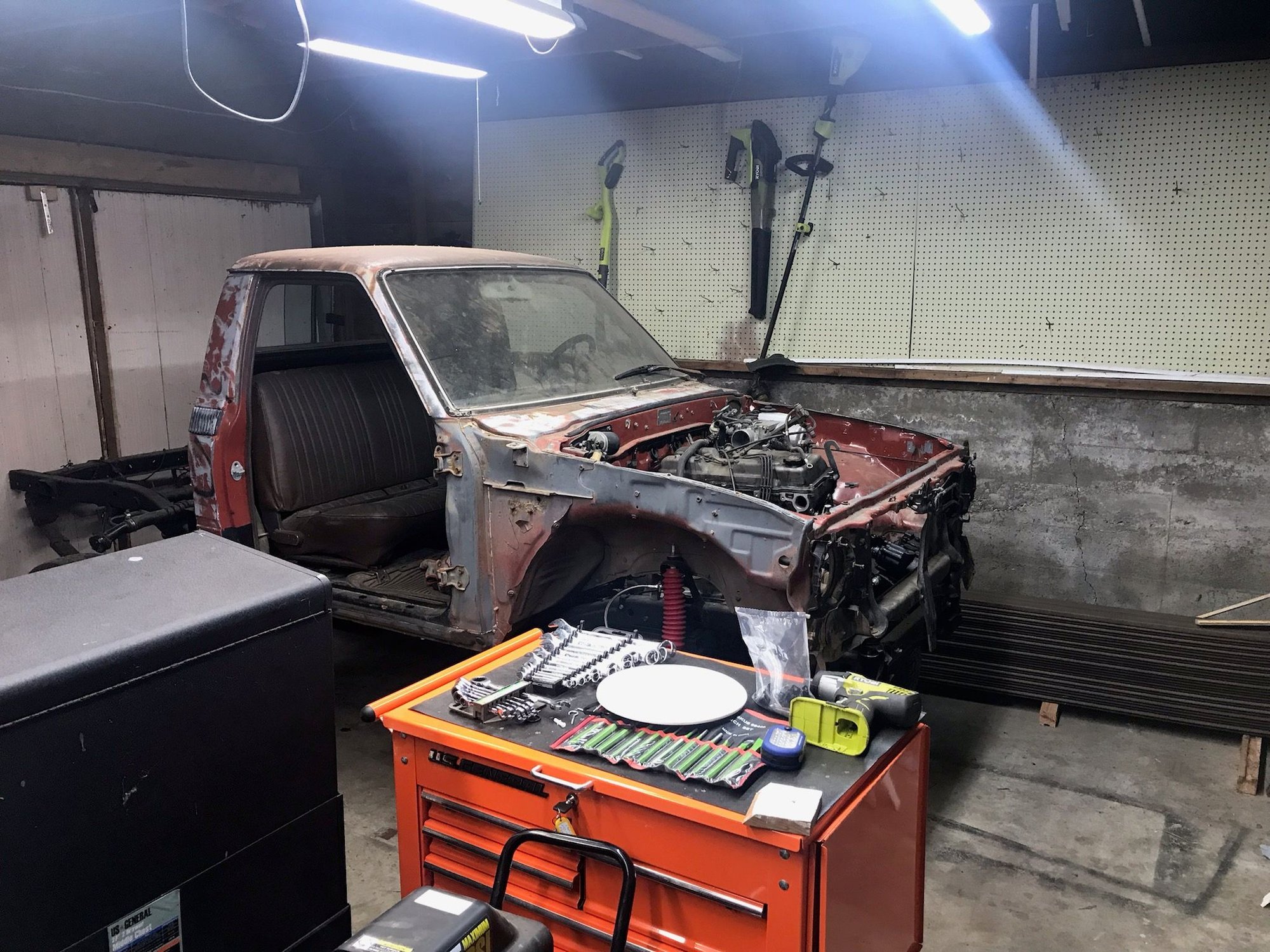

The pickup has made it to my garage! I'll have limited time to work on it, but at least its home. I need to go through everything I have already done, and refamiliarize myself with what has been done, and what still needs to be done. Unfortunately, the latter is a much larger list. The brakes are covered in surface rust from being stored in a barn that flooded last winter so I may need to purchase those again.
