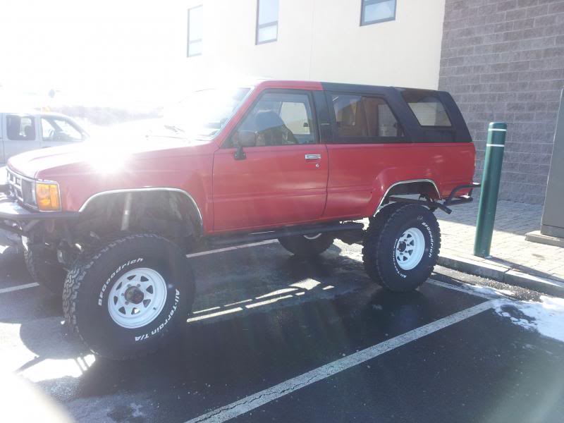

Here's what it looks like today.

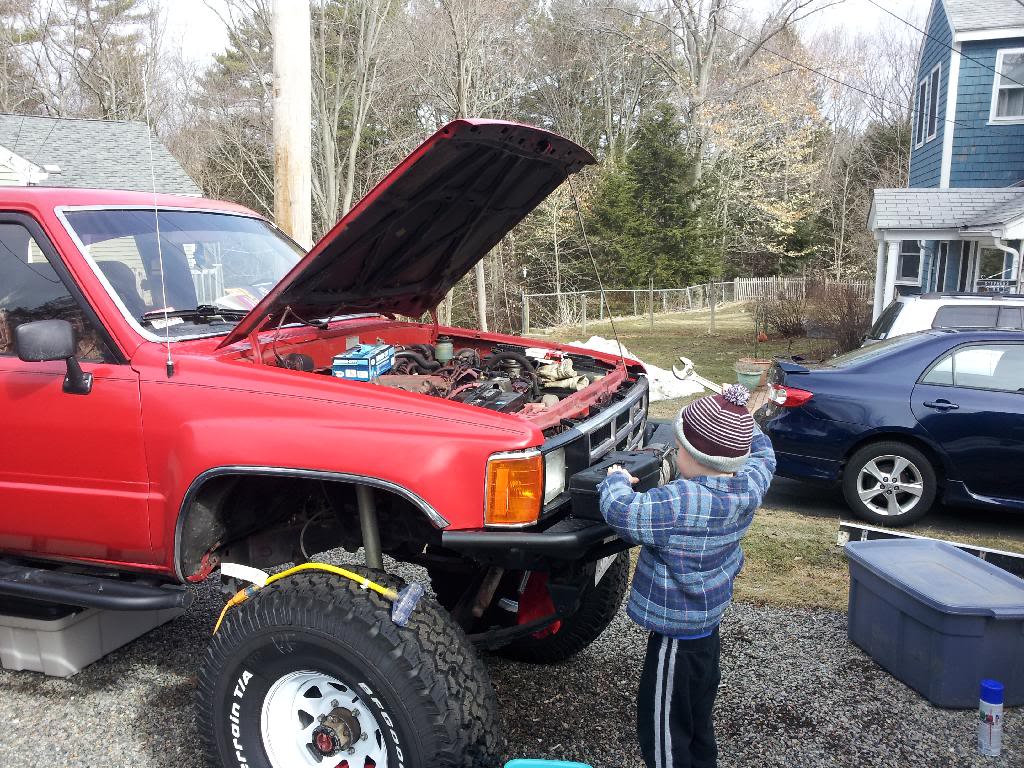

First things first, get ya some good help:
Yeah so if anyone knows where to find good help these days let me know. JK, I love the little man but he's 3.5 and there isn't a lot he can help with right now with a project like this, especially where I'm learning as I go. He's very patient, but got tired of truck work by the end.

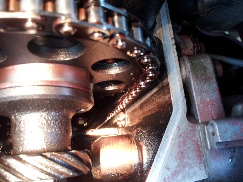

First time I've seen the inside of a timing cover, even a n00b knows you're not supposed to see THAT inside a timing cover.

Diagnosis:
Leak down low: AND high on the driver's side oil pump but nothing on the top/passenger oil pump
Double-check the oil seal, all OK
Not the sealed bolt, not the crank oil seal, must be the o-ring. YEP!
I guess I pinched it when I installed it. I used axle grease (as sticky as possible) to hold it still the next time around:
And all of a sudden it doesn't leak any more. (except from the rear main seal, which is a pre-existing condition)
The only thing I have going on now is an odd noise that sounds like a gear-driven timing set whine. Oil pressure is OK and it's running fine, so I'm going to track that down soon but not now.

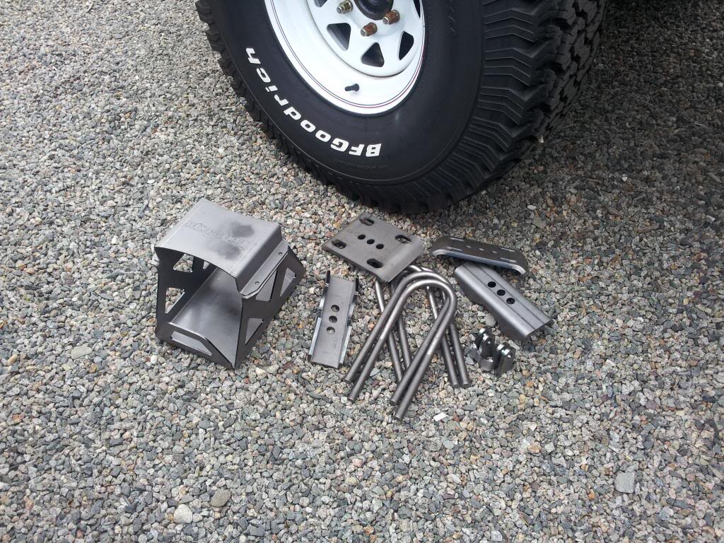

RuffStuff had a 20% off special last weekend. FGZ saved 20% swapping out the cracked rear perches, correcting the rear pinion angle, and boxing his future Odyssey battery.

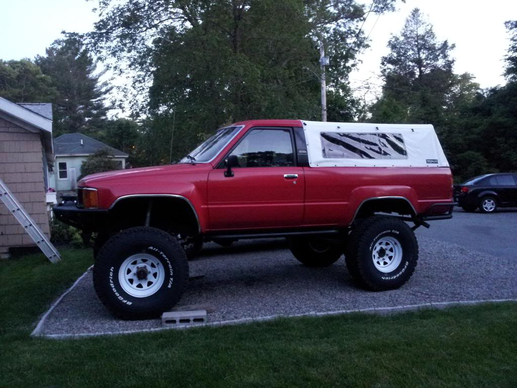

So to make myself feel better I put on the soft top for the first time!

Nice looking Runner! I like the contrast of the white wheels and white soft top, it really makes it stand out! Now that it's summer time I'm starting to get "soft top envy" again, lol. Look forward to seeing your progress!
