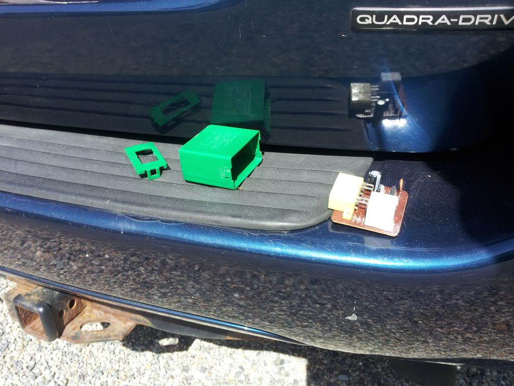

The first thing I looked at might have paid off. I pulled out the wiper relay behind the passenger kick panel, and once I got it unhooked and stared to take it apart about a tablespoon of water dumped out of the housing. Resealing the windshield might need to move up on my list a bit.
Here's the relay drying in the sun

Excellent. Looks like you found the issue.

That ended up being it. Bumper-in-the-sun drying didn't fully dry it, I could still see moisture under the cover. So I did 2 cycles of baking-stone-in-the-warm-oven. Nothing extreme, just waited till the temp fell below 160ish after we used the oven. Nice dry heat in there, no more moisture visible, wipers work again.
