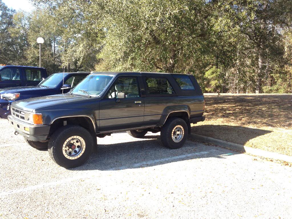

Here's a couple of pics! I didn't get any in detail, I'll make sure I do befores and afters for anything I repair.

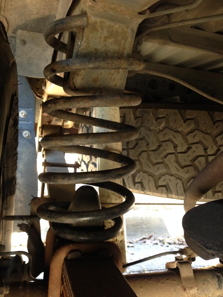

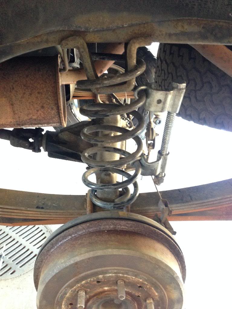

Anywho, the other day I snagged a set of TJ front springs and the 4Runner was mysteriously running normally so I rode down to the craft shop to put them in.
Not too hard of a job, I cut the springs down to 6.5 coils from the small end and ended up still having to use a spring compressor as well as unbolting the shocks and using a bottlejack to push the axle down.
Here's a couple shots of the springs on the bumpstops and a couple of after shots.

Waiting on a new coolant temp sensor in the mail, so I'm not sure how it rides yet until I get the issue in my other thread fixed. But I think it looks way better!!

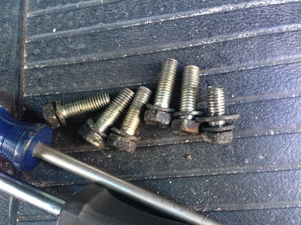

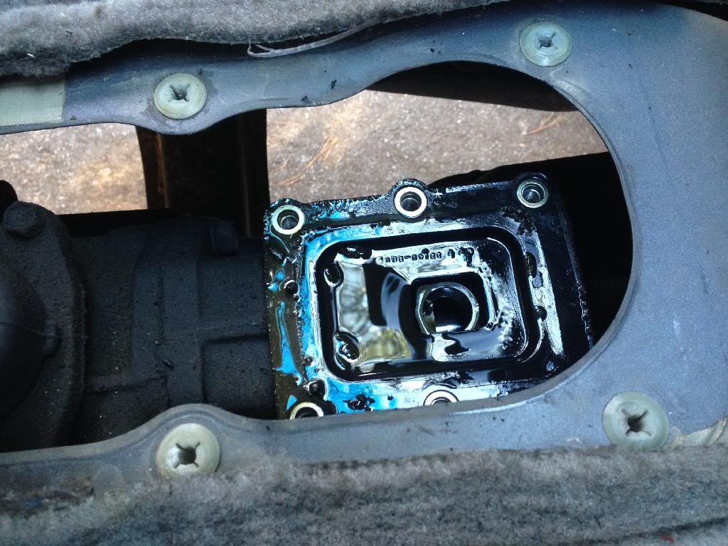

Step one, remove the front console around the shifters. 4 screws and unscrewing the shift knobs, no biggie. Next, remove the rubber boots from over the shifters. 6 screws. Easy. Next there's 6 bolts around the shifter base. Here's mine after removal.
One of these is not like the others... Oddly enough, the hole was fine, just this bolt was ripped apart and had jacked up threads.
So then the base comes off (I left my shifter attached.
And there's a gasket between the shifter base and the trans. I cleaned mine up with a shop towel and set it aside for reinstallation.

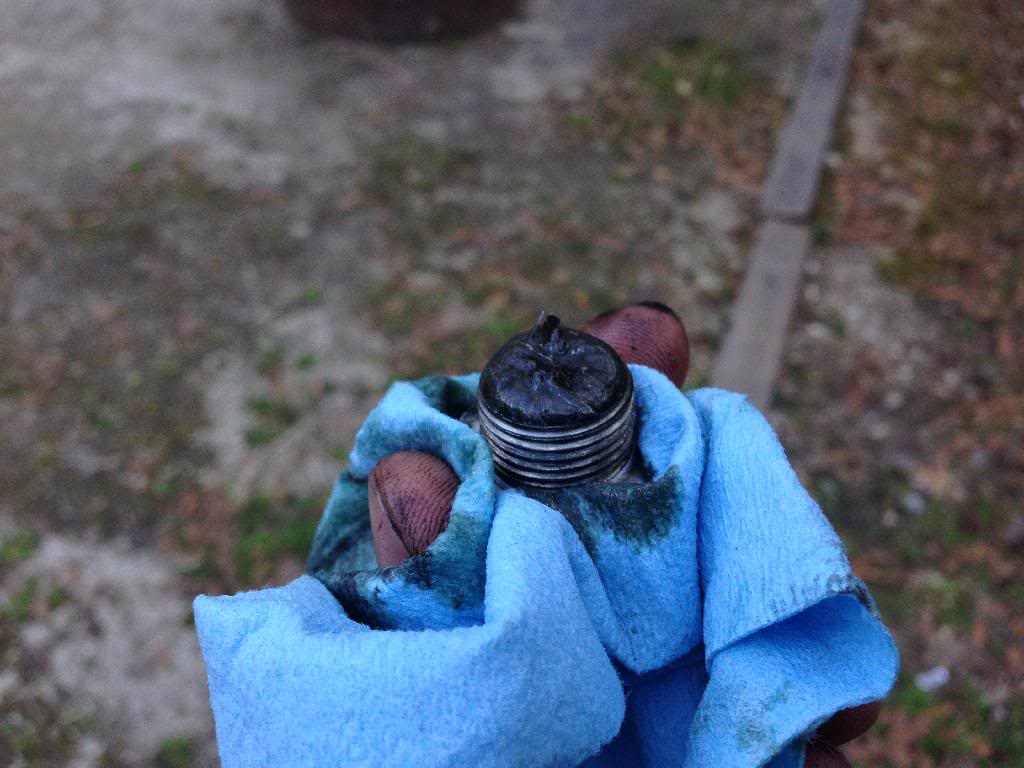

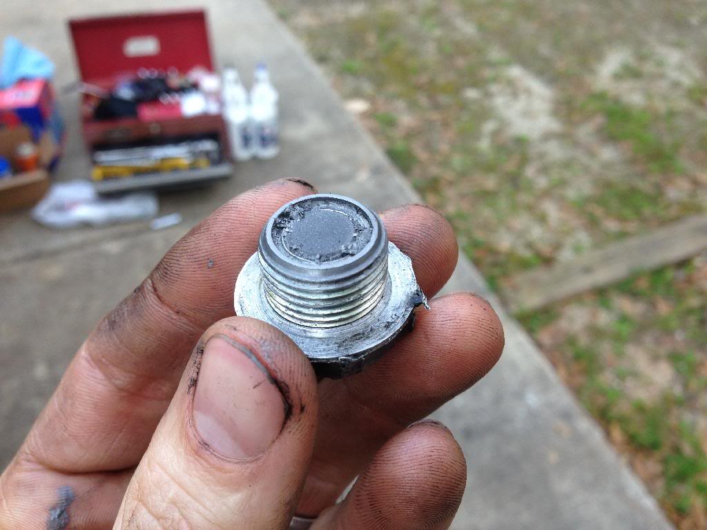

Then I drained my trans fluid. It had the consistency of dirty dishwater. Here's a picture of the drain plug before and after cleaning.

I couldn't get the fill plug out to check the level, so I matched the amount of oil I removed plus a little extra through the shifter hole. I used 85-140 and Lucas stabilizer.

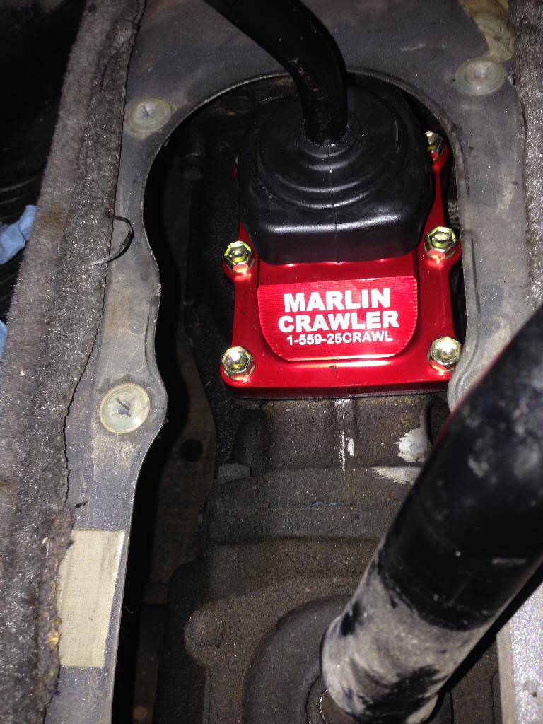

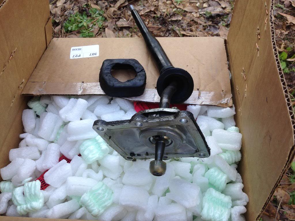

Then the new shifter base and shifter mounted up nicely!

Drove around a little. The throw is definitely shortened. My trans must have weak centering springs because (it did this with the old shifter as well) every once and again it gets stuck on the gate between 1-3 from 2nd gear. Not an issue. I used some Lucas grease on the poly bushings when I put it together so as I continue to shift I'll bet it finds a groove. I'm really happy about the new firm shift feel!

It cuts a good couple of inches off the throw. Best part is it firms up the feel quite a bit.
ALSO WARNING! Do not use Lucas additive and 85/140! It was like shifting in molasses. I grabbed some pennzoil synchromesh because it specifically said it was designed for yellow metals (like brass, etc.) and it feels way better. My centering springs might be weak, but the sludge I had in there was way too thick for them to fight through. Seems much better now, but I haven't driven it since the fluid swap. Just sat in the seat shifting gears and making engine noises :-D
