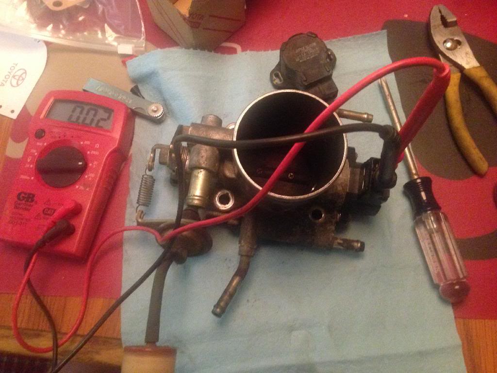

Ok, I pulled the TB and put the new TPS on and got it adjusted tonight. Lucky me that it's raining outside, so cleaning the gasket surface up and reinstalling will have to wait another day.
Here's an in-process:
The old one had two pretty loose pins, so I'm hoping it was the problem all along.
Any tips on cleaning the old gasket off the plenum side surface?
