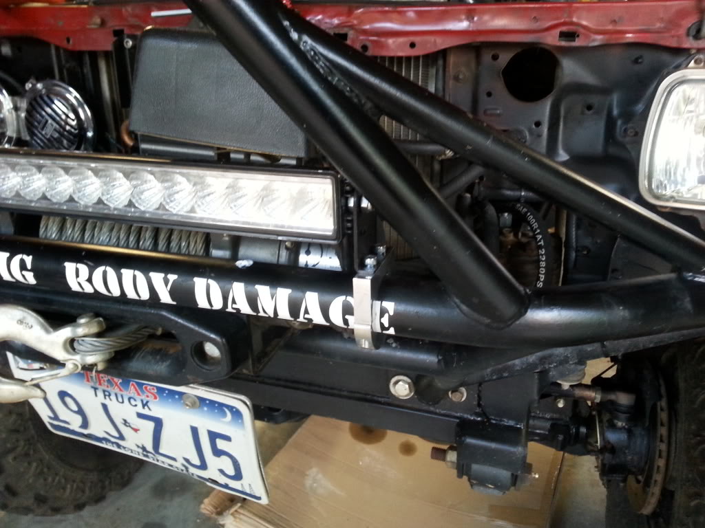

After messing around with this project for a while, I finally got the hydro assist wrapped up and ready to fill.
Looks kinda tight.
Cooler in place. The bracket for the latch support was flipped around 180 degrees to make a little needed room for the install.
I had to chop out a little of the front core support. I used some 3/8 fuel line to put on the sharp edges and zip tied them down. I also used some scrap hose to keep the cooler lines from getting cut.
Got everything tight. Ready for a test drive this week.

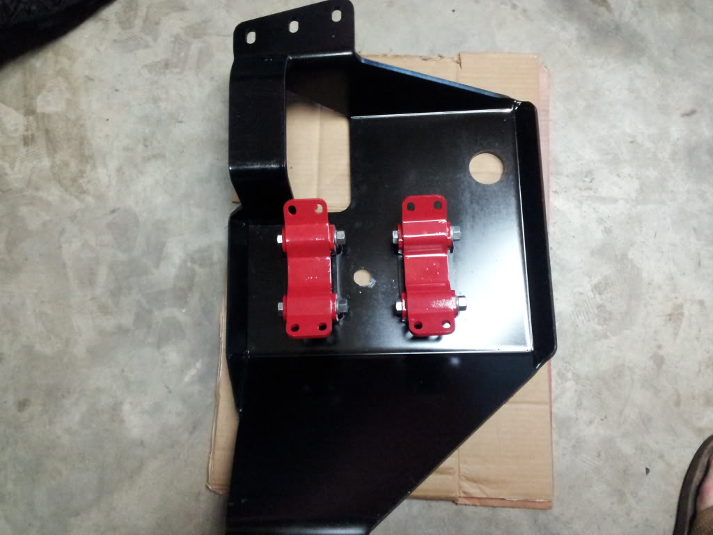

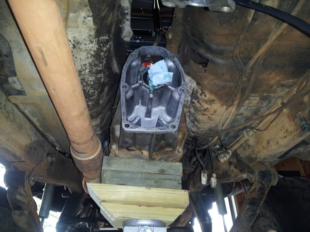

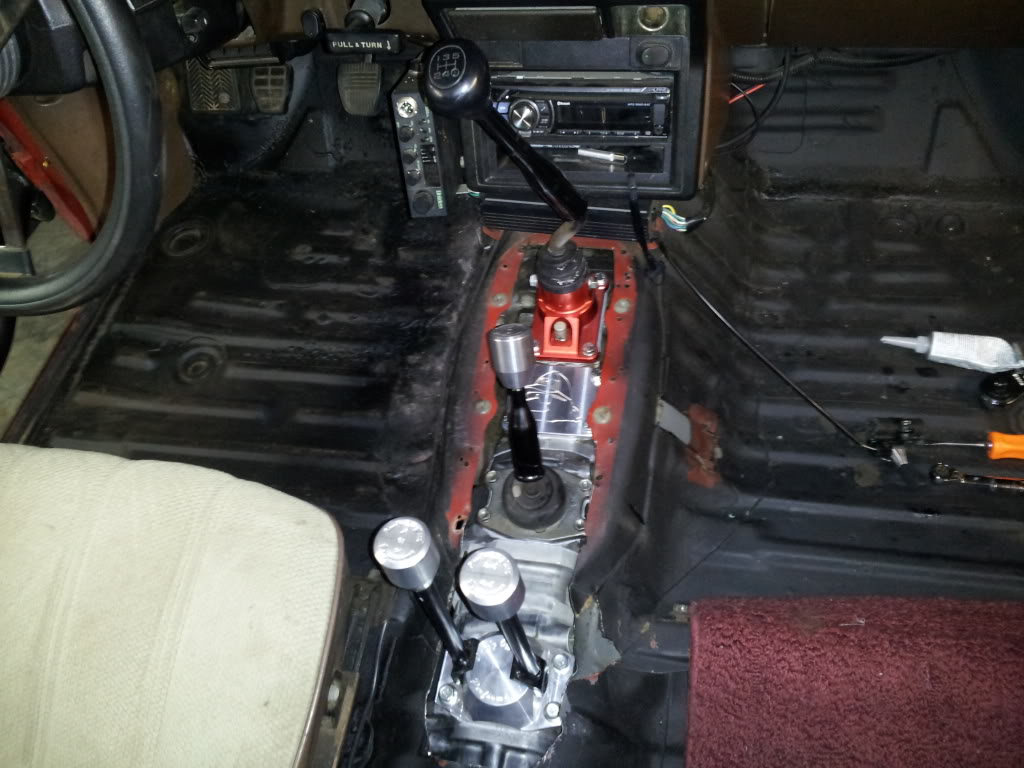

Install the 23 spline Dual Ultimate Transfer Cases.
I have had these put together for a while. The list of goodies include: MC-07 Dual adapter, Longfield Rear output, MC 30 spline front output, MC Total 23 Spline Input, Daves Offroad Twin Sticks, 4xInnovations HD TC mounts and a Sky's Offroad TC Crossmember.
Removed the front driveshaft
Removed the TC shifter and block off plate.
I painted both TC mounts.

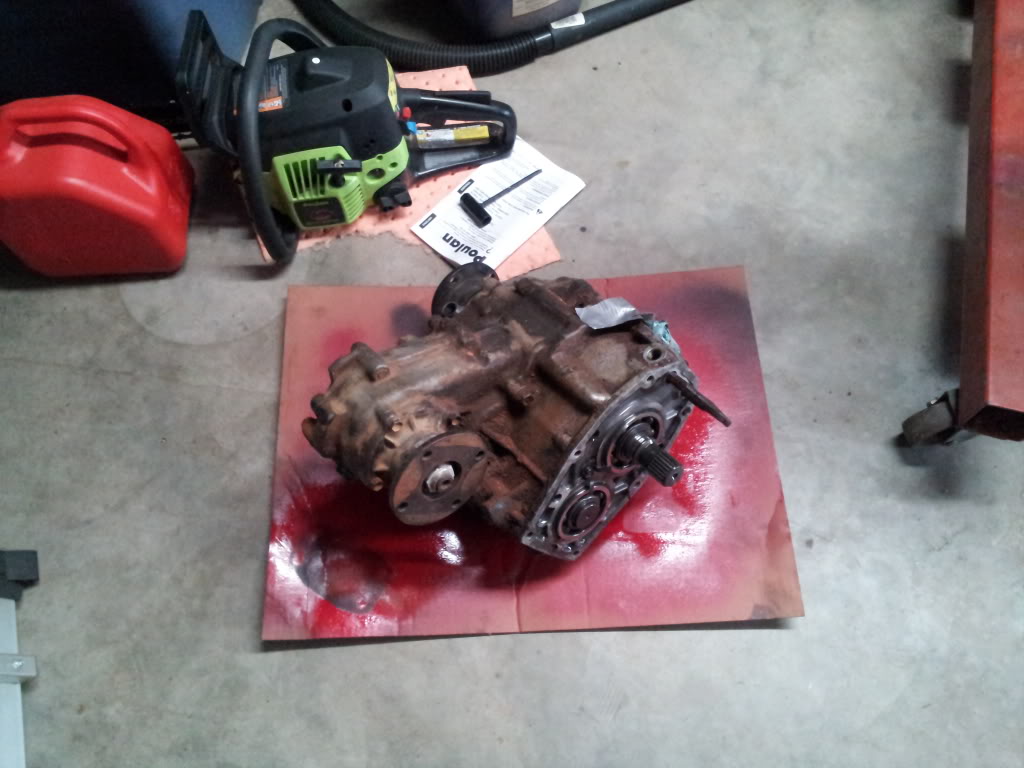

Got the TC pulled this morning.

Drilled a whole in the crossmember in order to drain the crawlbox through the adapter.

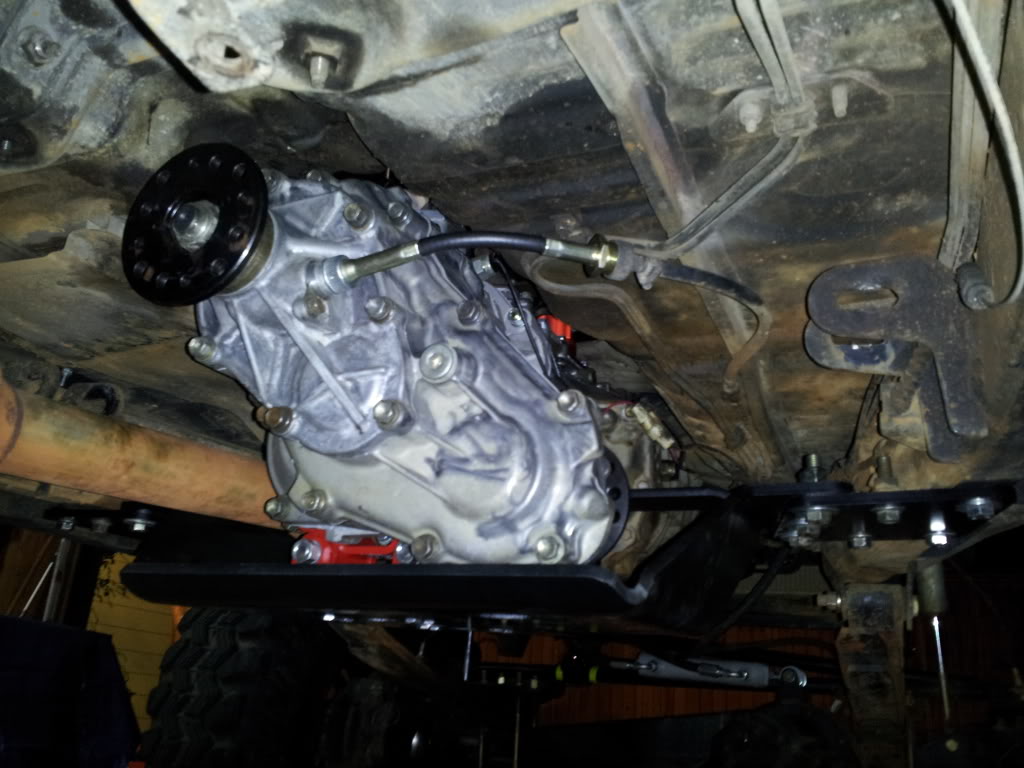

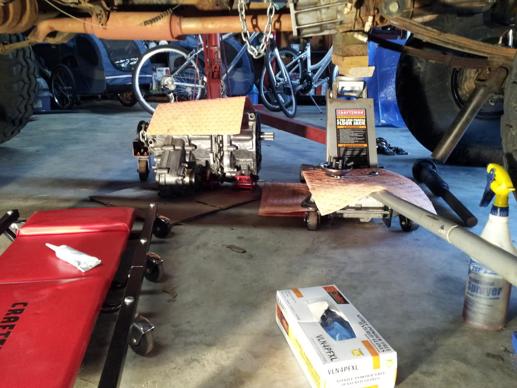

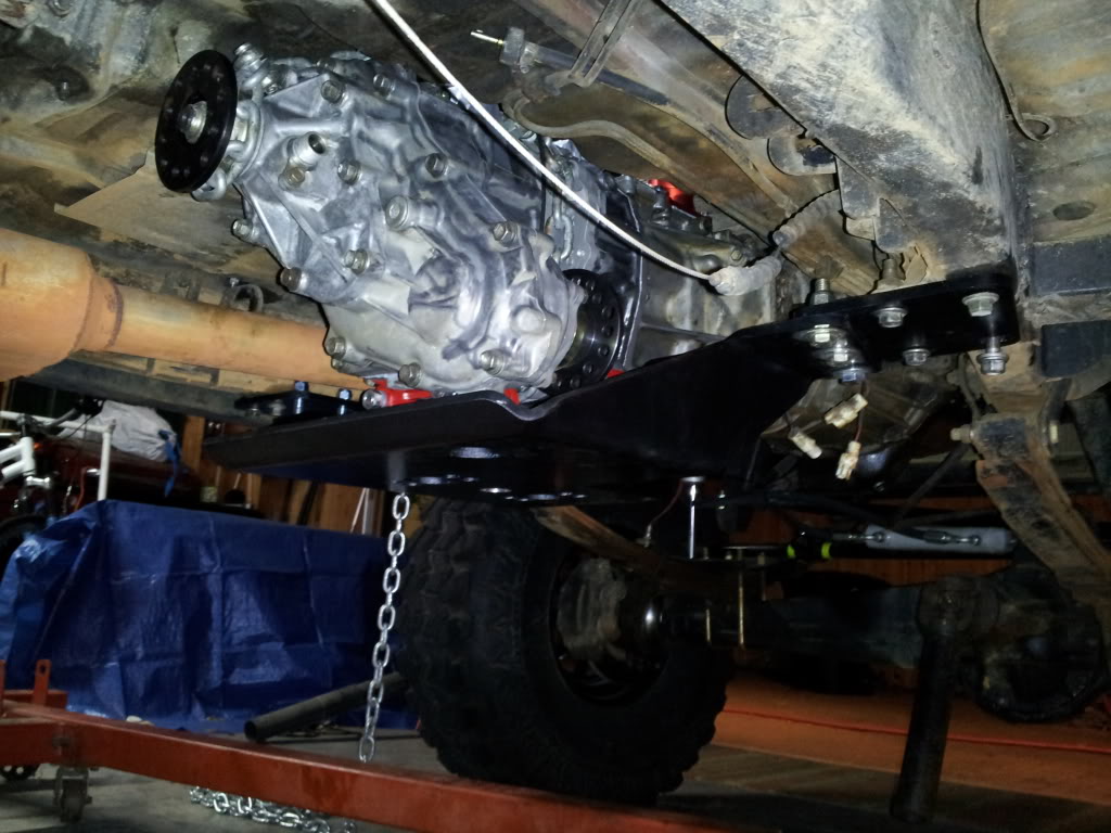

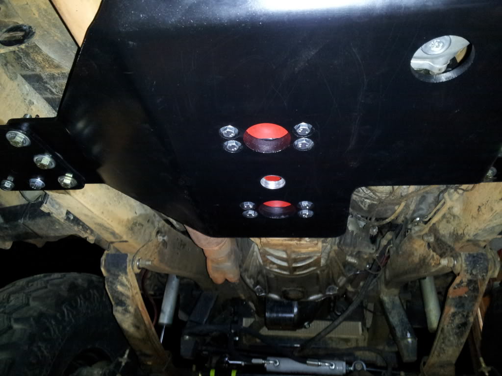

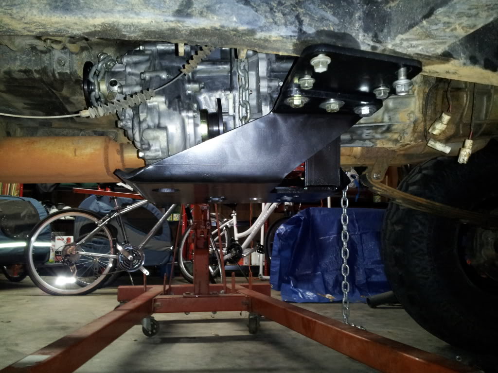

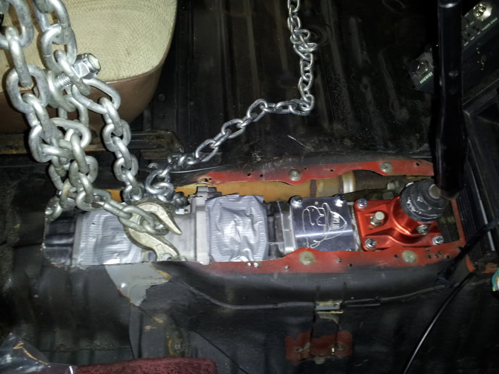

Had some help show up last night. Patrick (scotia) came by and helped me stab the Duals into position.
It was pretty painless. The front input was aligned correctly and we got it buttoned up. I just required and extra set of hands as usual.
The fasteners that came with the x-member were a little troublesome. I got that figured out today. Should have it all buttoned up tonight. Then, I need to add some break in gear oil and install the shifters.
Fluids added and buttoned up

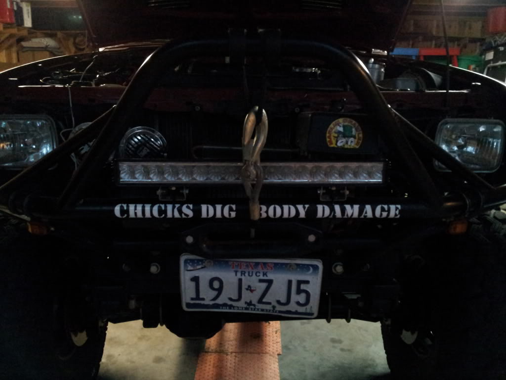

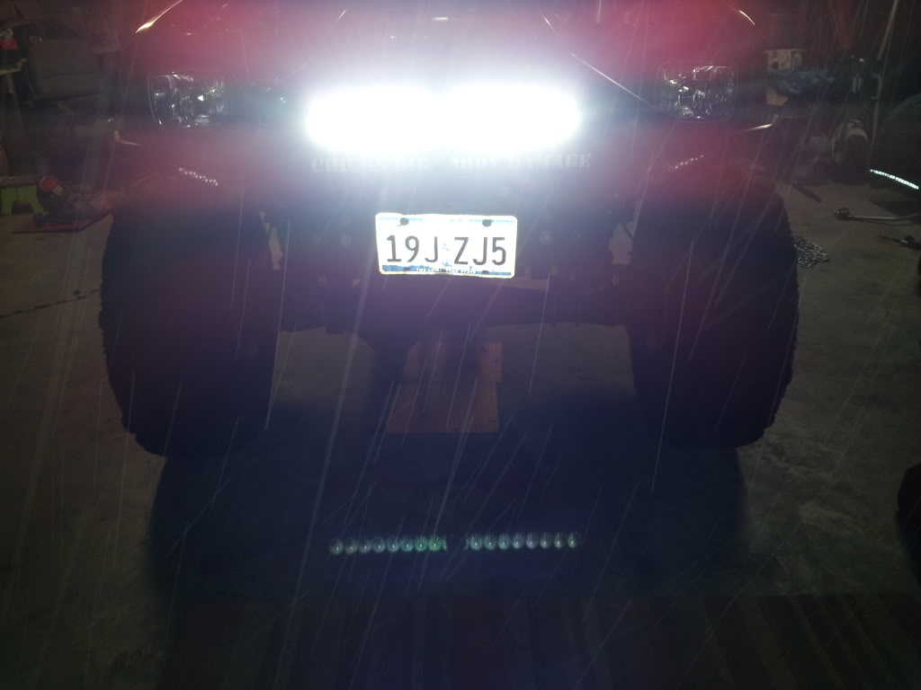

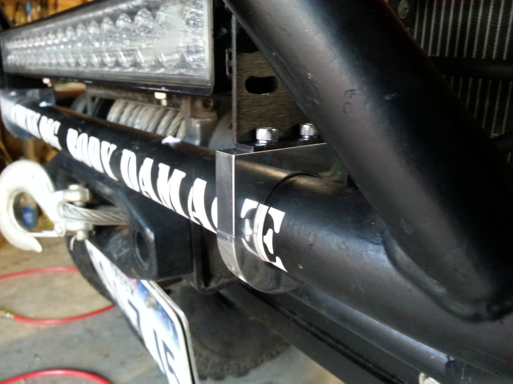

I may have added a few more lumens to the Red Truck with a slightly used Blitzpro 21S LED bar. Fits perfectly under the hoop on my Marlin bumper
I still need to get the mounts figured out but that will be very close to the final placement sans the zip ties.

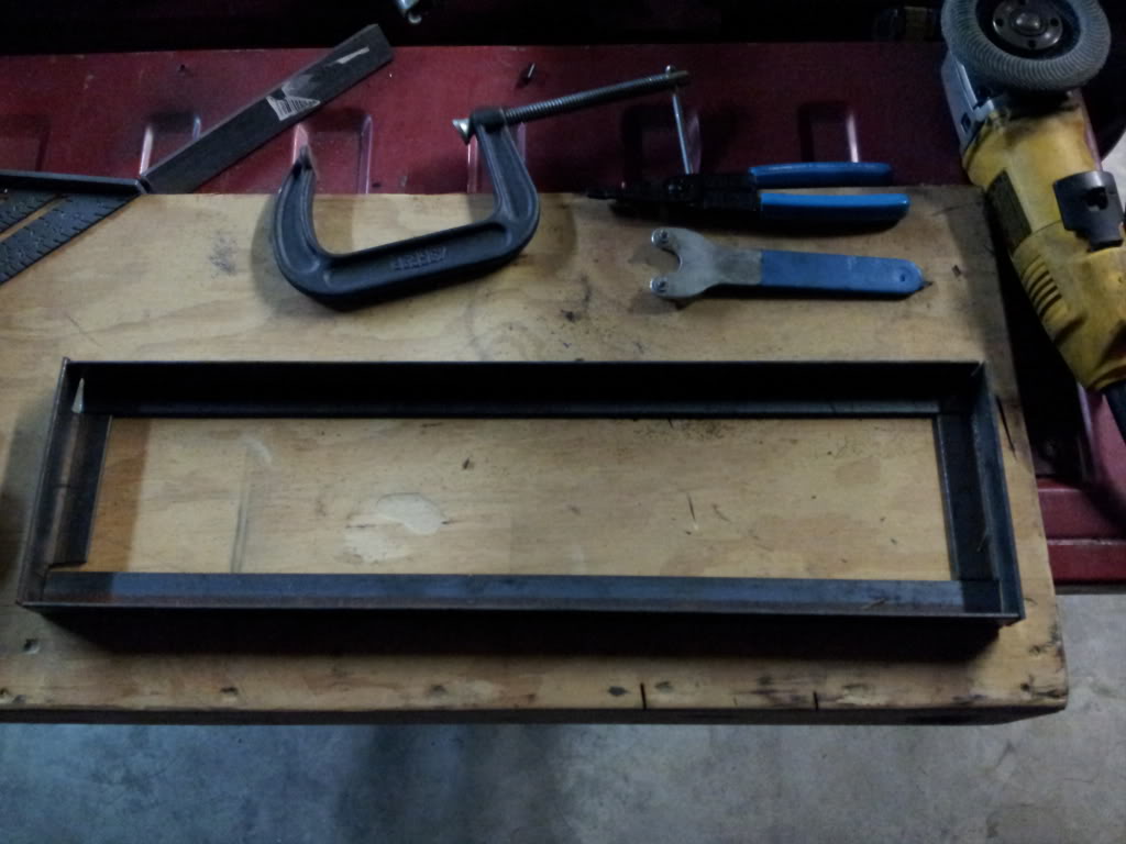

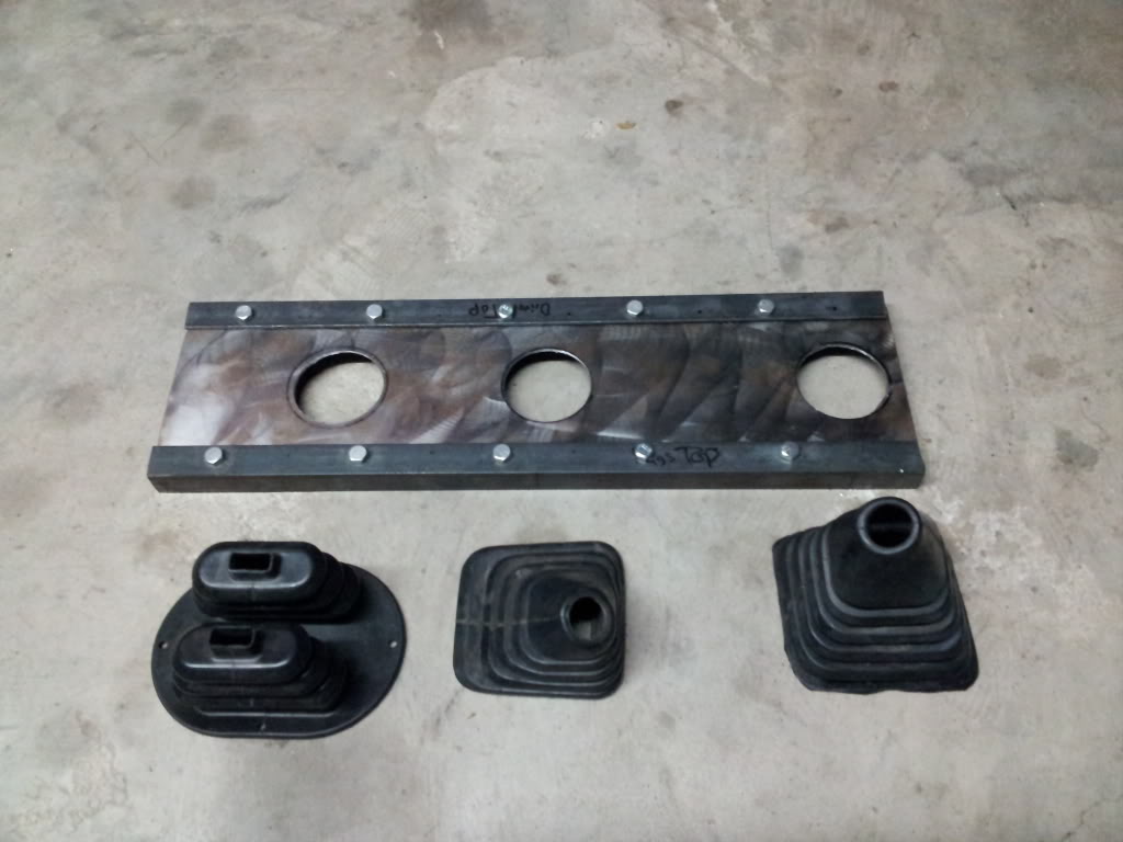

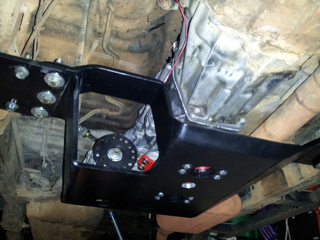

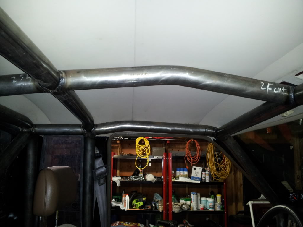

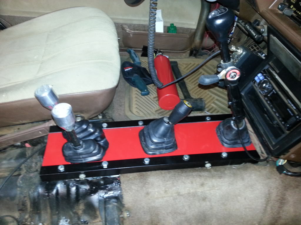

Here are a couple of shots of my nearly completed transmission tunnel cover
The base that the above panel will mount on

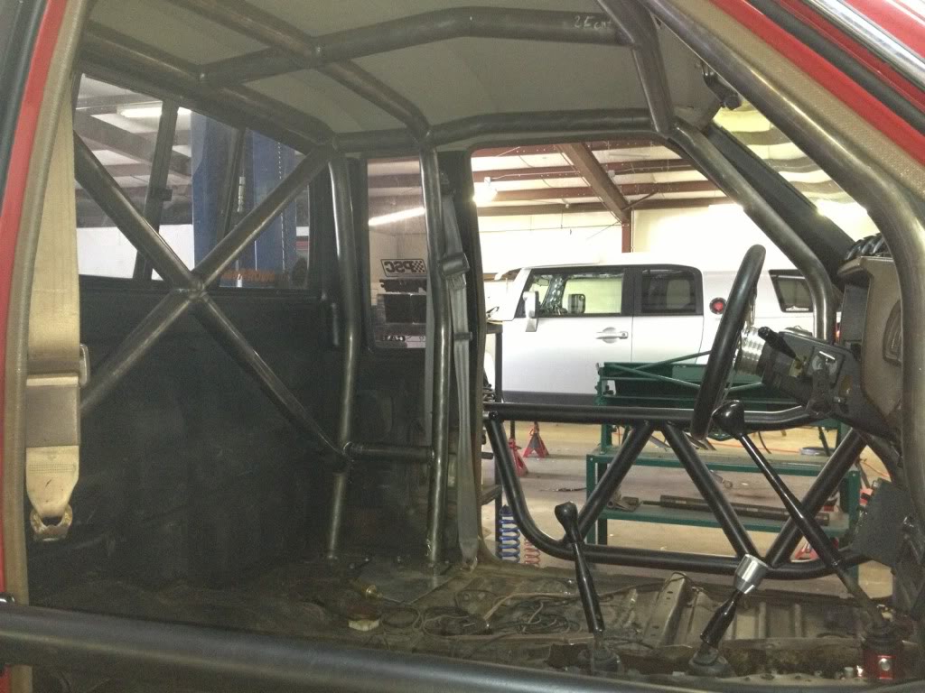

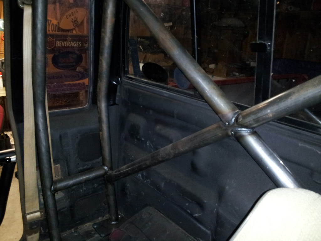

Got the truck back from Brave Motorsports. I'm very impressed with Daves work. Didn't put the grab handle on right now. They seemed like they would be in the way (of my head)in one spot. I need to get some bar padding for sure. He didn't tie the cage to the frame due to my Ghetto Fab sliders and some body mount interference. When I get some new sliders I will get them tied in then.
Here are a couple pics

I have to have the interior back together by wednesday night so I can wheel this weekend.

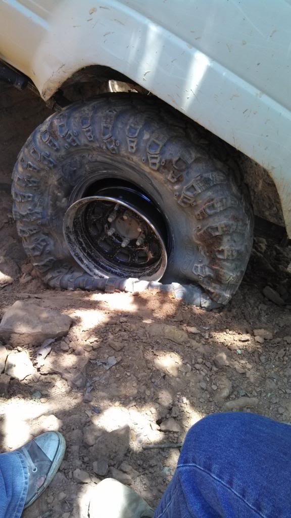

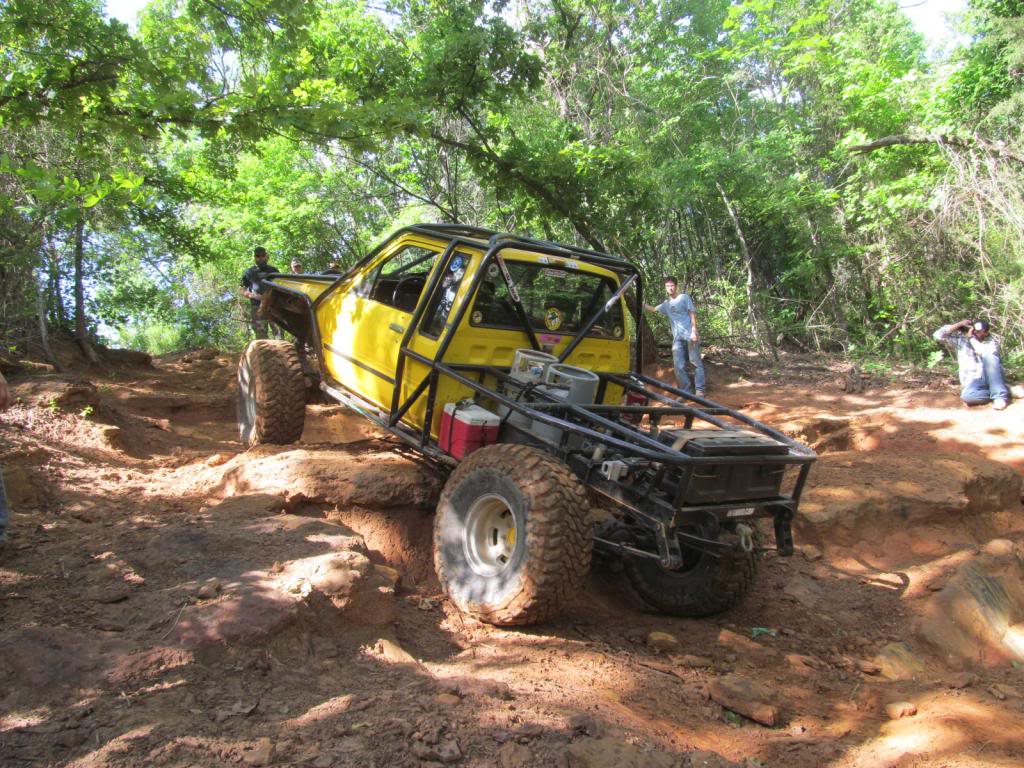

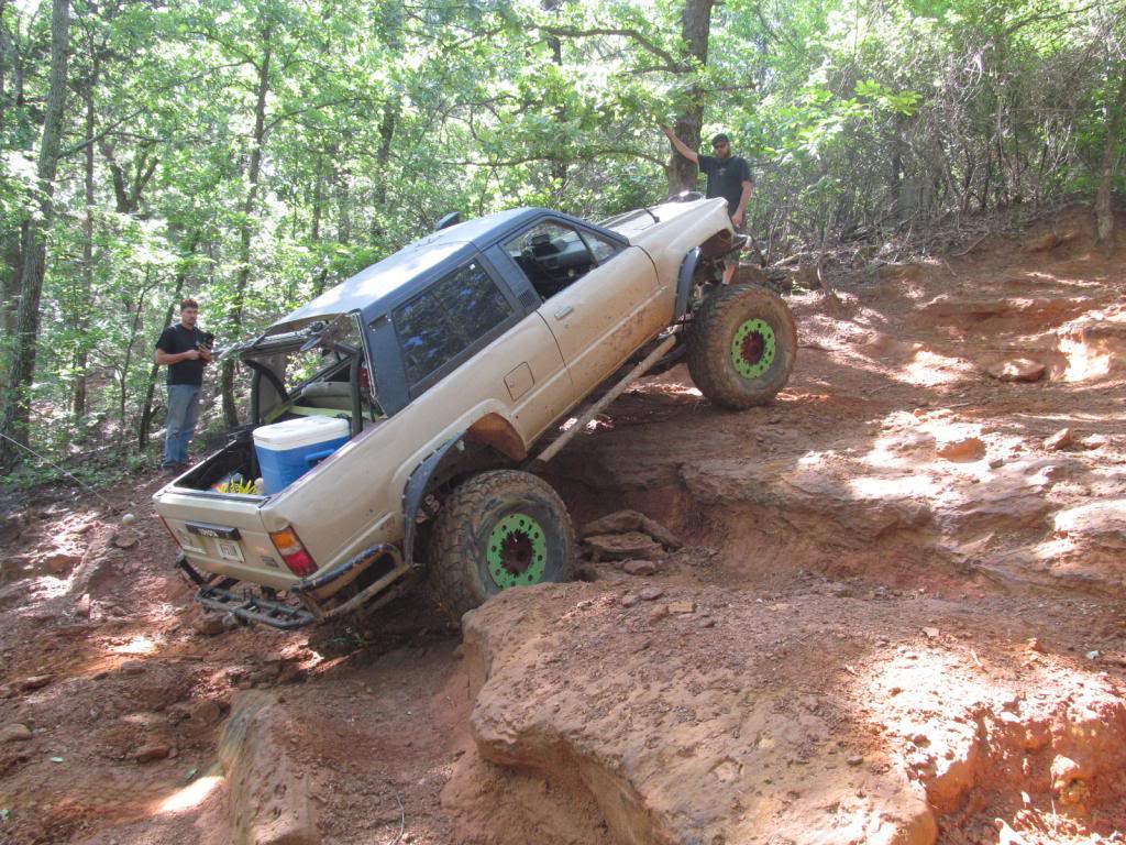

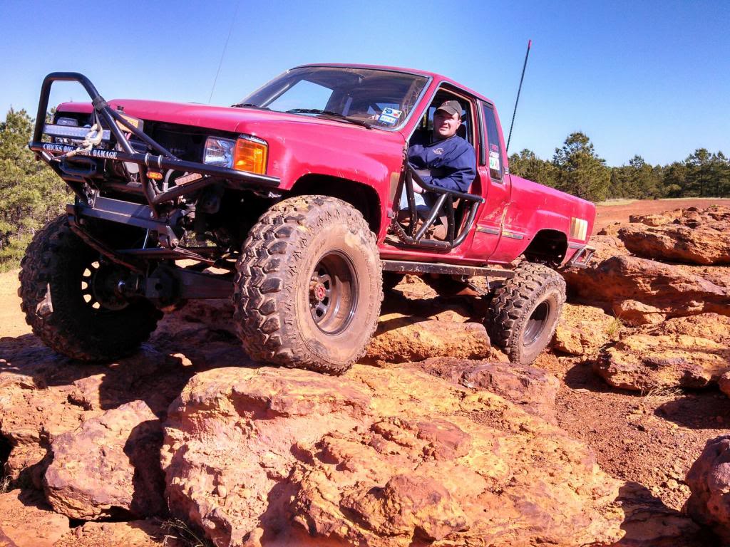

Weather was awesome. Saturday was the mid 60's and breezy.
We hit some Pretty good stuff: Twister about 3 times, the backside where Jason flopped a few years ago. Going down JP Expressway was awesome. I got back at Whatever from last year with some guidance from Jason. Shake Rattle and Roll was good fun. Clydes Ravine was good as usual. Did all the regular stuff mainly. Saw an FJ break a tierod in Twister. I did the rock garden for the first time.
I won some 5/16 x 100 Firewire Synthetic winch line.
Carnage included my cell phone, a little body damage, A TC leak and driveline rattle.
Going to look at that stuff this week.

Blitzpro tube mounts for the Hawk21S led bar

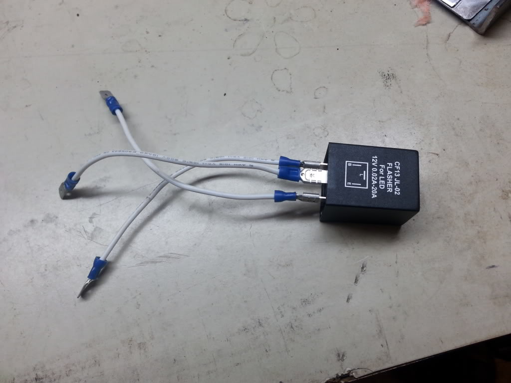

I got my electronic flasher in from superbrightleds and used the Rob method (thanks) and made some short jumpers to get it plugged in on the driver side fuse panel

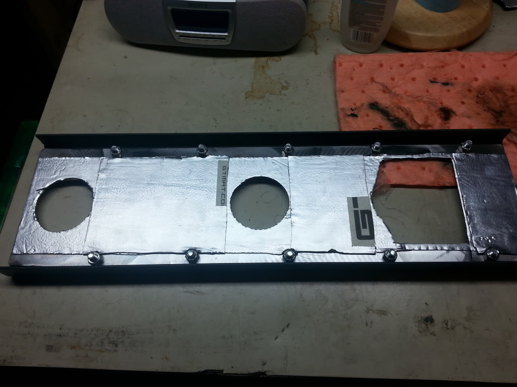

I am still in the process of finishing up my Trans tunnel cover and added some heat/noise deadener (GT Mat)to the underside of the top panel.

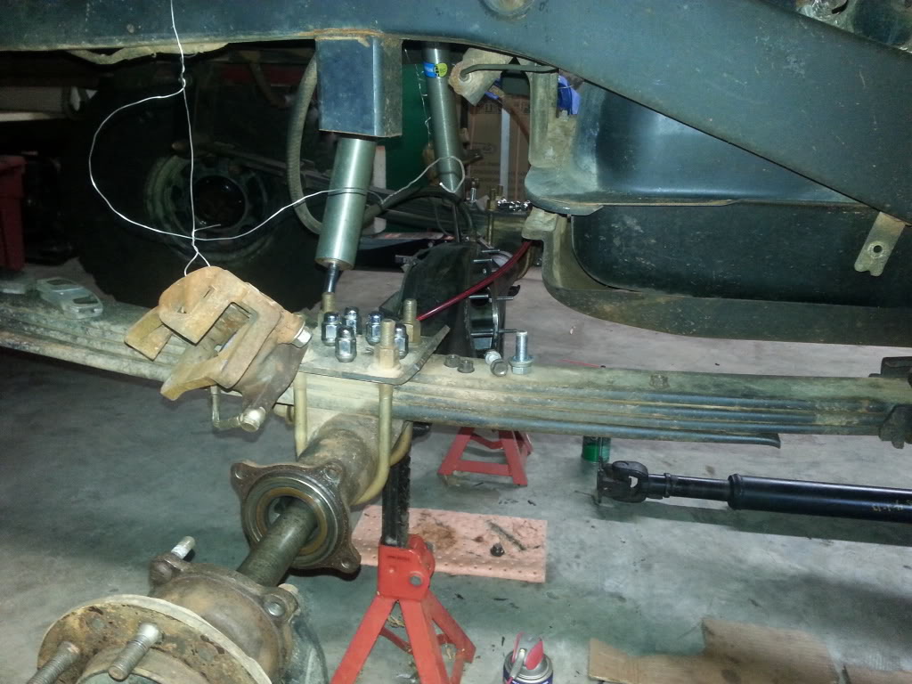

I have a couple little projects to finish up including the rear axle re-assembly.

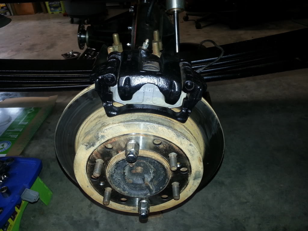

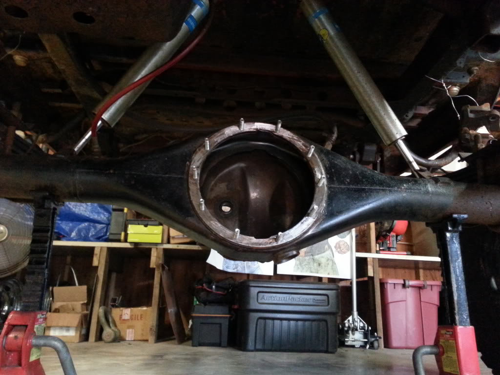

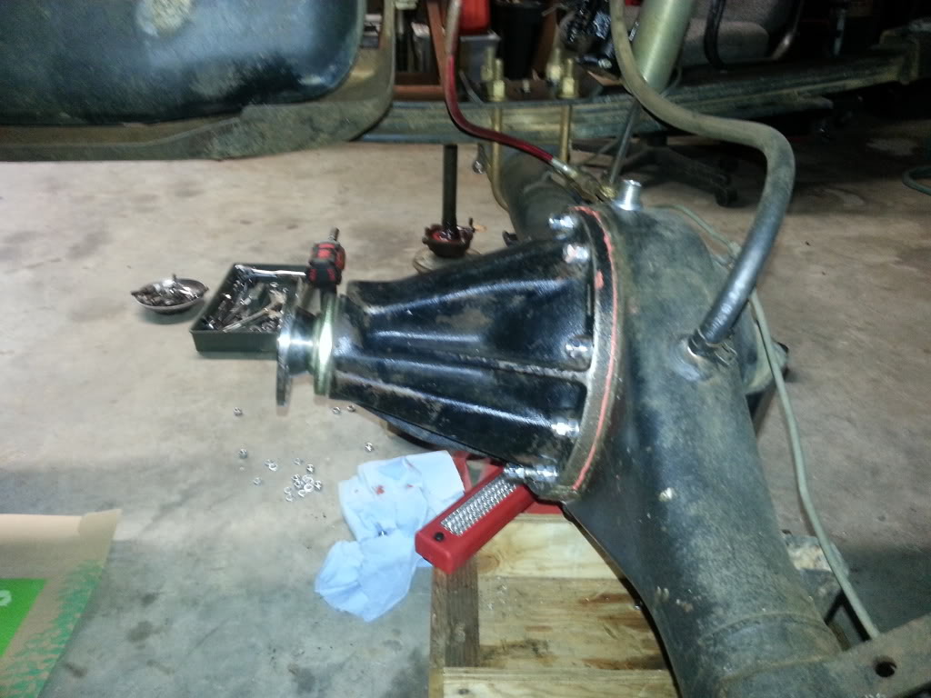

All new rear studs in the rear housing

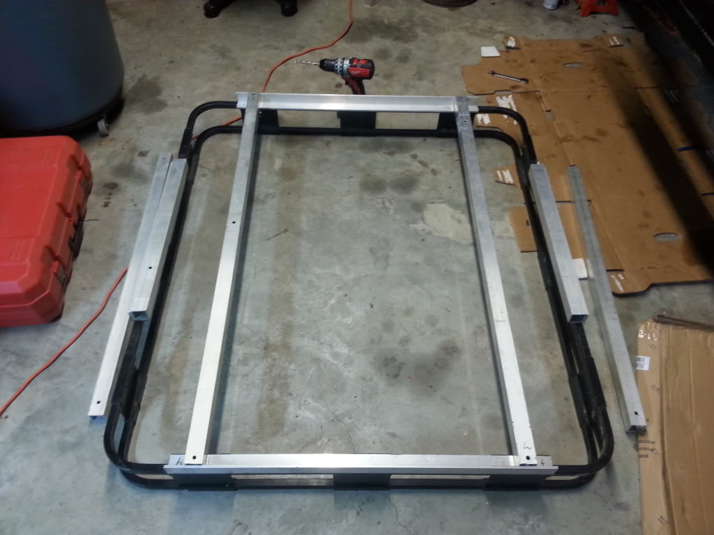

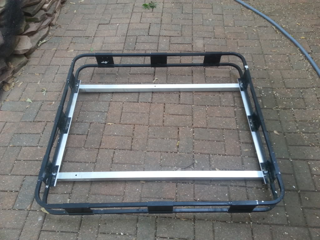

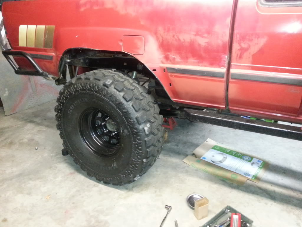

I have also been working on this bed rack. I added 1.5x1.5x 1/4" aluminum angel to each end. the runners on the outside are 1.5" 6061 Al tubing. I need one more piece to put in the middle of the rack and then need to source something to use for a floor. I havent decided if the rack will go in the Tacoma or the Hilux or both. I need to figure that out.

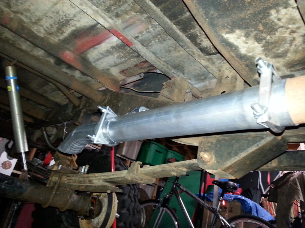

I extended the exhaust outlet further towards the rear to help eliminate some in cab drone. Surprisingly the truck sounds better at idle.
Maybe a little back pressure is a good thing. The exhaust is temporary until I find a quieter option.

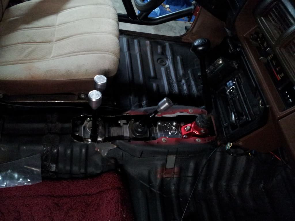

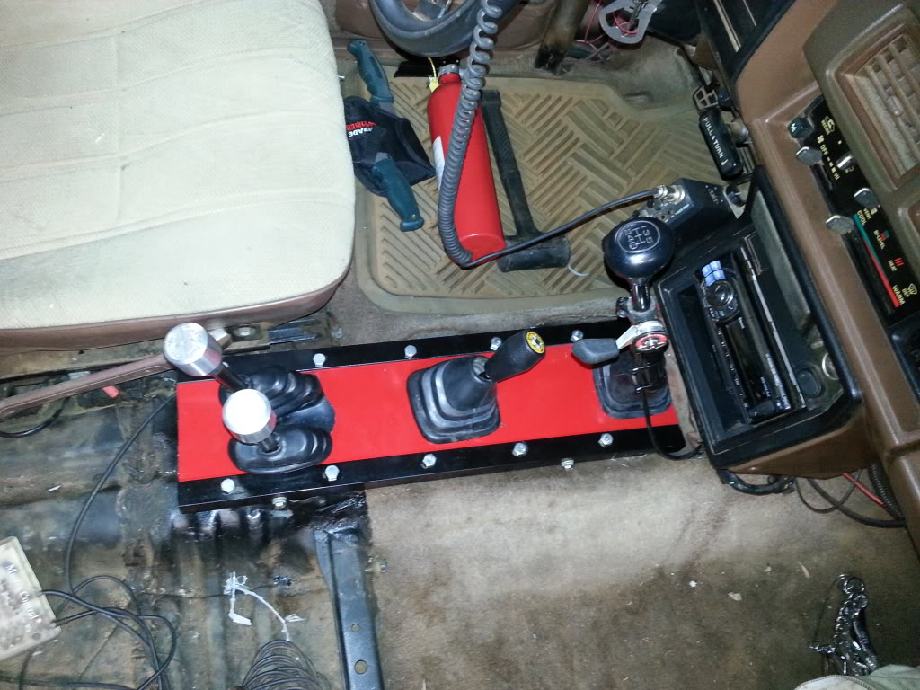

Finally got this 99% done. Just need to seal it up a little better by the twin sticks.

Man did I miss alot. Truck looks great!! I really love the panel you made to accommodate the twin sticks

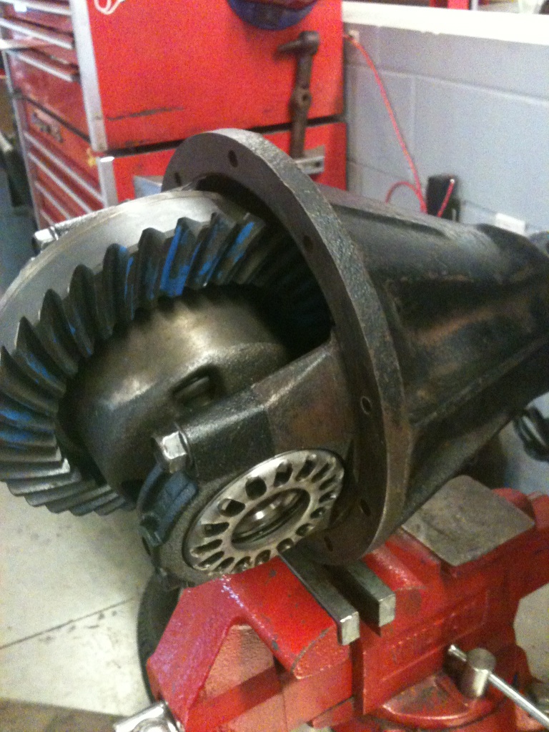

Picked up my 3rd from Joe earlier this week after he had a look over it..
I had him check it out due to the fact I let a friend have my TC flange after he destroyed his rear end and after I put the new flange on It didn't feel right to me. So I sent it to the expert. He also threw in a tube of Toyota FIPG for the install.
I got the fresh 3rd member with the G2 5.29's and Detroit in and sealed up.
I painted both the rear calipers since I overlooked that when I did the rear disc brakes. Its not the best but it is better than rust.
I have a drivable truck now. Just need to add oil to the rear diff. I wanted to let the FIPG set over night.
I wanted to post this pic. I installed my rear driveshaft while the rear tires were still ever so slightly off the ground. This made the install a 1000 times easier due to the fact that you could rotate the DS (w/ the TC in Neutral) to get all the DS bolts tightened in an easy to reach position. I dont know why I never did that in the first place
