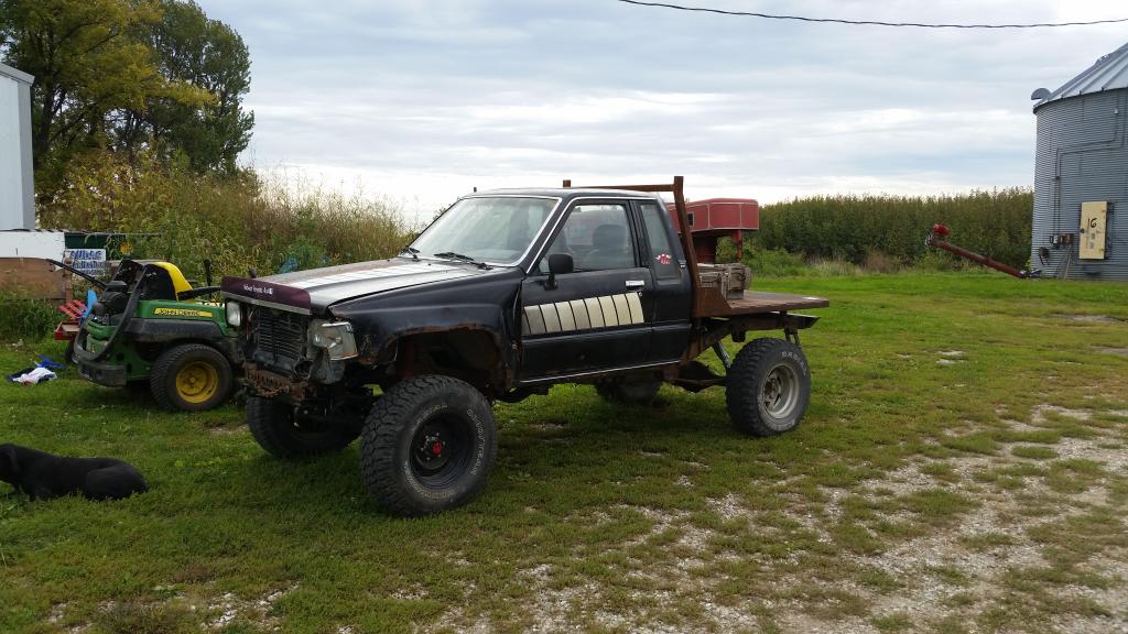

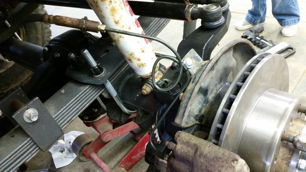

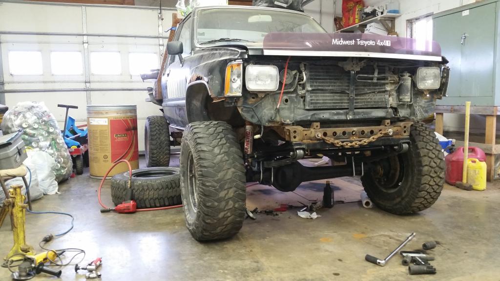

Update time! The truck is back on all fours and was able to take it for a lil spin around the block. I now live in the country so that's a four mile spin lol. Buttoned up the brake lines first thing and instead of buying extended brake line I just got some hard line to attach to the rubber lines. They were a lil longer than I wanted so I put a loop in them and attached them to the factory spot on the dust shields.

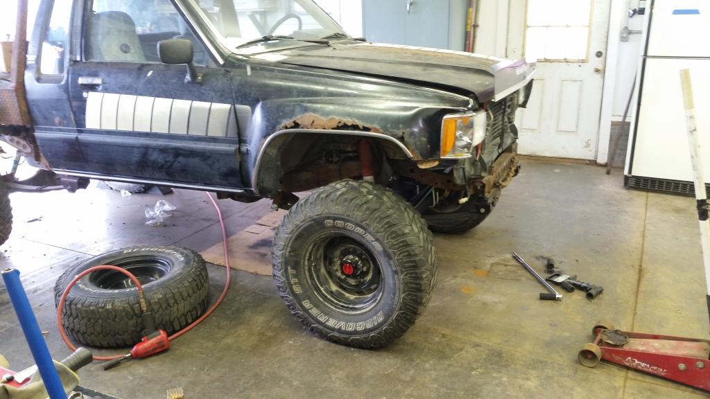

Threw a 33 on just to see what it would look like. Tons of room.

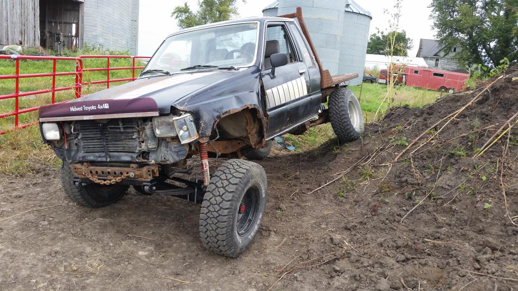

Found the dirt pile and tried out the flex. This is all the farther I could climb up the pile cuz the front driveshaft is out and it's just an open rearend but I'm pleased so far.

The chain on the front cross member scares me a little... Very easy to pull those nuts right out of the frame.
Nice progress though! "test drives" Are always fun and nerve racking. Haha
The chain is just there from when I jacked the truck up to pull the axle out. It is not going to stay on there. I'm planning on building a plate bumper when I get to that point.
