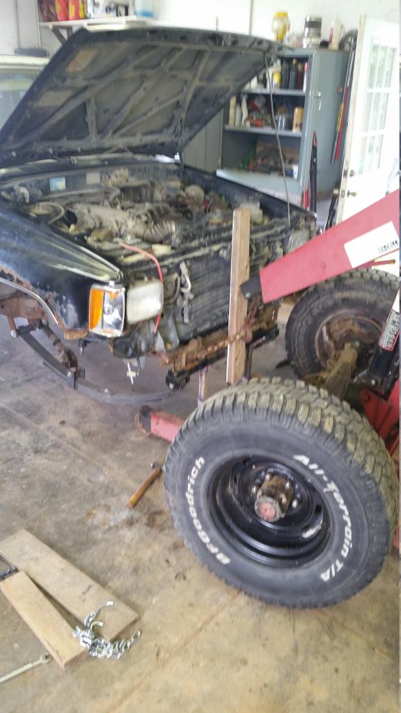

Pic of the axle out and my redneck engineering to get it out. Name:  20140804_121220_zps7rcysxer.jpg

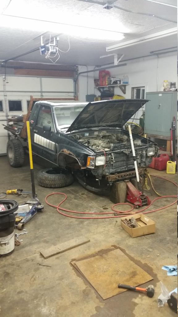

Couple more pics for ya.

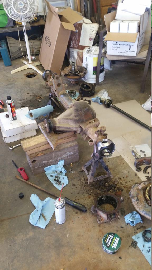

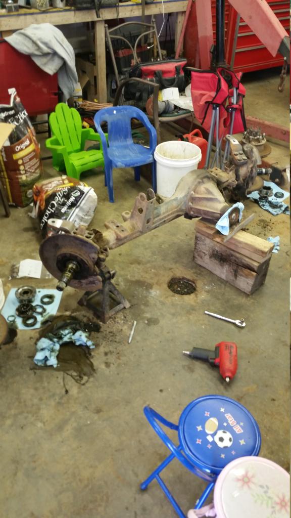

I started tearing down the axle this week. I've only got so far as to get the knuckles off. Name:  20140807_130546_zpswor9ex7t.jpg
I went to the in law's yesterday and snagged the ifs knuckles off my parts truck. Everybody keeps saying the cone washers are a pain to get out and I thought they were crazy cuz I haven't been having any trouble with them.....Til I got to the passenger side on my parts truck lol. I bet I fought getting the lockout off for close to an hour. And I broke 3 of the studs off when I took the nuts off so those should be fun to replace. Oh well, if it was easy everybody would do it haha. Today I'm picking up rotors for a 97 tacoma so hopefully I'll have most off the parts to swap the ifs hubs on. That's all for now.

Yea do yourself a favor and use a big brass punch on them cone washers for the lockouts as well as the steering arms,you just smack the head of the stud and it doesn't destroy the stud but jars the crud loose to get the washers to break free.if you need any help on the axle I took pretty good pics on my SAS build.great work,I'll be interested in what hubs and brakes you use.
Thats a good tip. I ended up using a ball pein hammer on the cast part of the hub(not the lockout part) and smacked it with a 2 lb hammer. Seemed to work well enough. If i remember correctly others have used 97 tacoma rotors with ifs calipers so that's the plan at this point.

Also to break the cone washers loose, I loosen the nut on the stud and take another nut and screw it flush with the stud. It gives it more support and protects the stud from mushrooming.

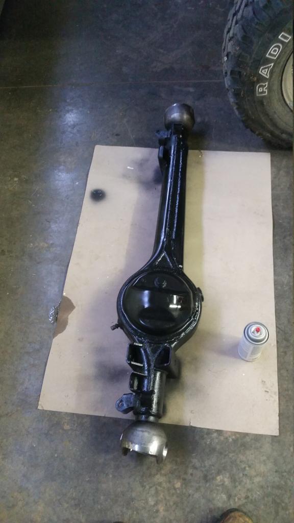

Couple photo updates. Progress has been slow lately but I have the front axle out and stripped down. Been collecting a few parts to put it back together slowly but surely. Name:  20140813_180344_zpsmkym0fah.jpg
Here's the axle stripped down and painted. Name:  20140815_181450_zpsmy65shmr.jpg
