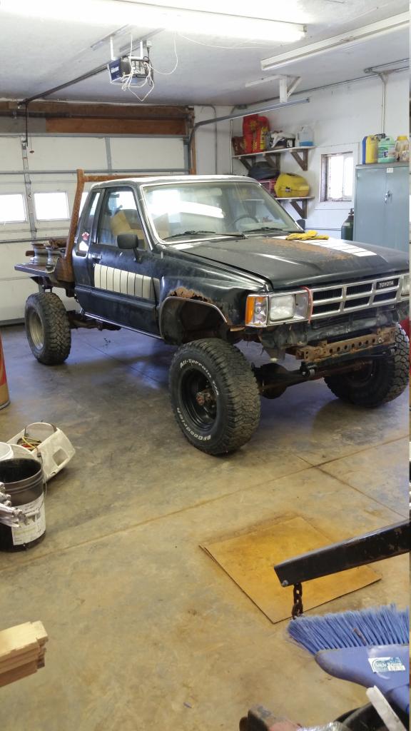

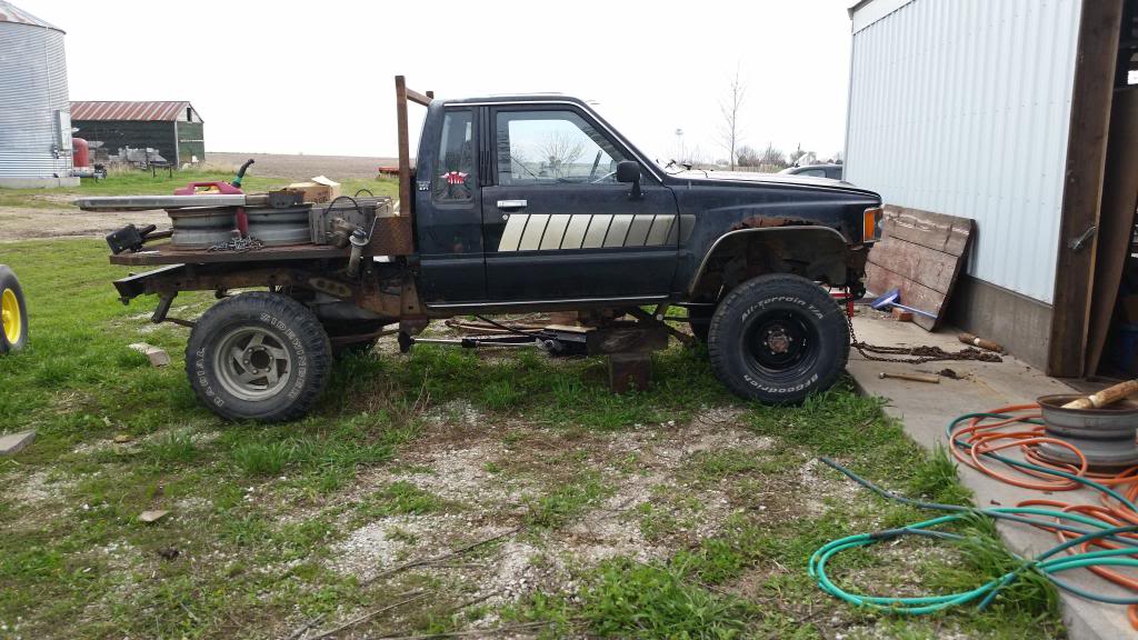

I ran into a bit of a snag with the truck lately. I realized when I went to put the axle back under the truck that I had no way to pick the truck up high enough for the springs to clear the axle. Luckily yesterday my dad had the skid loader out at the farm so we used that to pick the truck up and got the axle slid under it. Nothing too exciting but it is sitting under the truck again and bolted in. Front spring hanger is just ratchet - strapped to the front crossmember because I wasn't sure where it needed to be to get my shackle angle where I want. Pretty pleased with how it sits. Fairly level front to back. Name:  20140504_183149_zpsxdz3jmal.jpg

Thats great. Looks like it is sitting perfect. And the shackle angle looks good also.

Thank giz. I was pleasantly surprised with the overall stance and shackle angle. Still got a long way to go before it's on the road but I'll just keep plugging away as time allows.

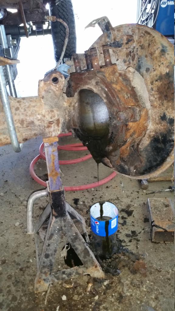

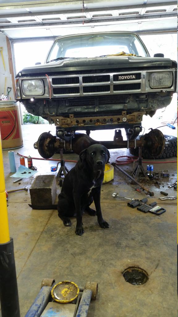

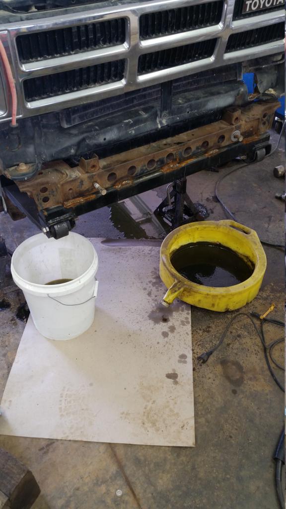

Thought I'd try to get a lil done before work today. Got tie rod and steering arms off. Not near as bad as I thought it would be. Only took about an hour.
Knuckle balls started leaking like a sieve when I got the steering arms off.
Had my pooch watching the whole time lol.

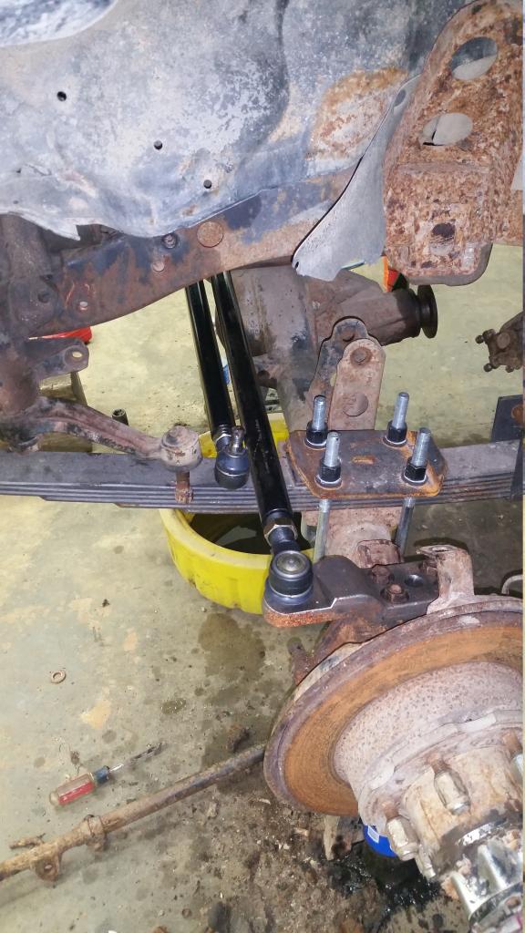

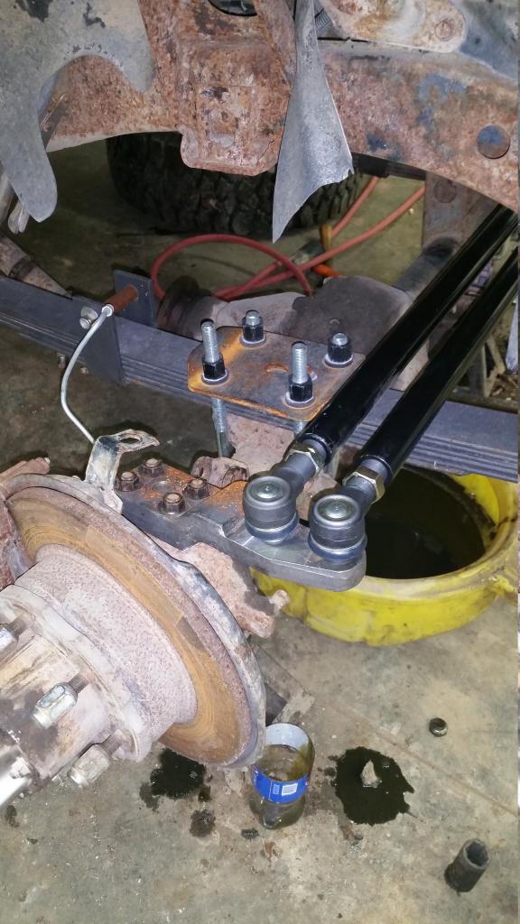

Ok time for a proper update. After I removed the old steering arms, which by the way was not difficult, I cleaned up as best I could and set the new ones in place. Put the tie rods in also just to see how they fit. Name:  20140803_005408_zpskijlyet4.jpg

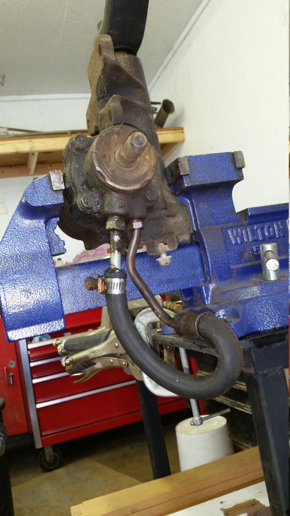

Then it was onto the steering box. I found an old power steering line from a chevy that had the rite size fitting and a rubber hose on it that I used to "plug" the ports on the box so all the fluid wasn't running out of the box. Name:  20140803_105546_zpssrpnnjcc.jpg

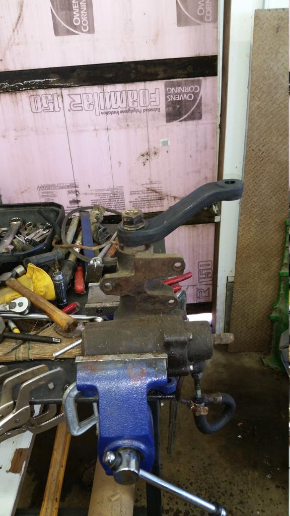

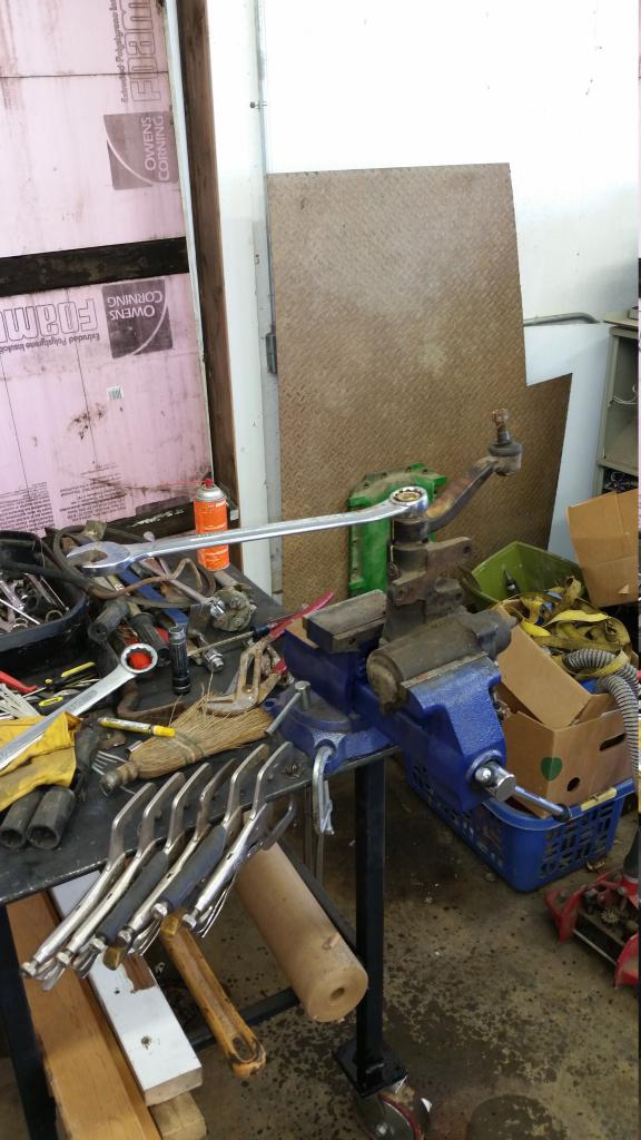

Then I set the box up in the vise to swap pitman arms. Again this went much smoother than I anticipated. Unscrewed the nut with my trusty bfw lol, tightened up the puller, gave it a couple whacks with a hammer, and it popped right off. Name:  20140803_104853_zpskjs9qt0t.jpg
Size:  89.5 KB Oh, I forgot to mention that I also marked the center line on the box and the shafts so I knew where to put the new pitman arm and have it be centered. It was just a matter of bolting the arm on after that. Name:  20140803_105534_zps3e1vizs3.jpg

The oil oozing out after you took the steering arm off is most likely an inner axle seal that has gone bad. Time for that knuckle rebuild!
Progress looks good!

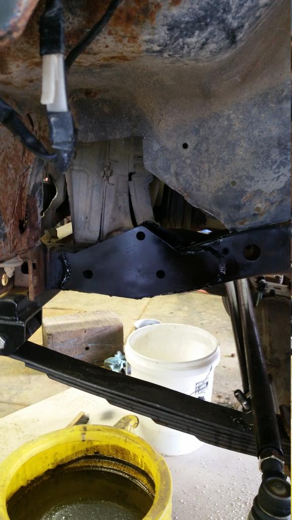

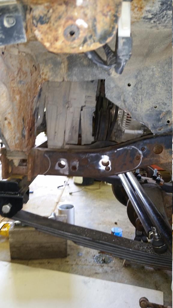

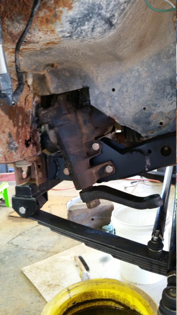

Next up was mounting the box and plates to the frame. I put a bolt in the top hole to secure the outer plate to the box and started the test fitting process. I must've test fit that thing 20 times I'll bet. I had to notch the inner fender a bit and the radiator support/body mount area to get it far enough forward. I clamped the outer plate to the frame in the location I wanted, transfer punched the 2 holes to drill, center drilled them so the drill bit wouldn't wander, and drilled them out to 1/2" with the outer plate still clamped in place for extra insurance. Then I pulled the plate off and drilled the holes out to 3/4" for the sleeves to fit thru. Name:  20140803_130641_zpskuvpeovk.jpg
Size:  73.0 KB I kinda slacked on picture taking after that. I welded the sleeves on the outside of the frame and ground them smooth. Next I clamped both plates on the frame using the bolts to align them and used a Sawzall to trim the extra length off the sleeves on the inside of the frame. Ground them smooth and test fit the box one last time. Everything looked good so I welded the plates on and threw a quick coat of paint on them.
And here's the box bolted on. Name:  20140803_173052_zpsm3sfyh6y.jpg
