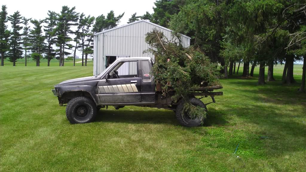

Aaannnddd all put together.

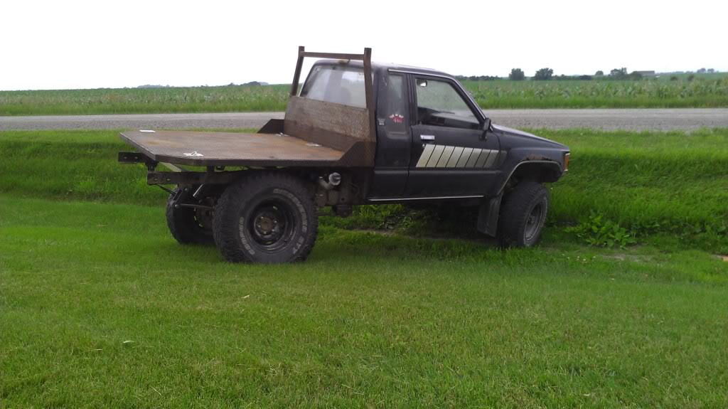

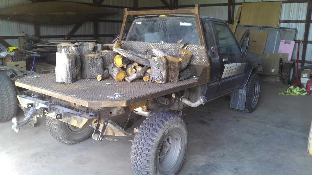

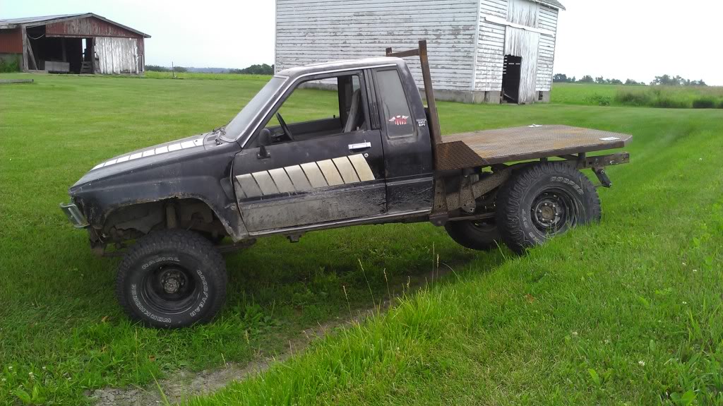

I got a lil time last week to work on the truck again so I set the flatbed back on so I could figure out how much room I have for shocks. Name:  IMAG0147_zps52080216.jpg
I couldn't find a good way to cycle the suspension to measure lengths so I just drove it into the ditch lol.
I was surprised at how well the truck flexed but i def need to get the ifs rearend swapped in. When the suspension is compressed the tire rubs the frame. In the pics the tire on the compressed side is actually limiting travel because it's rubbing the frame.

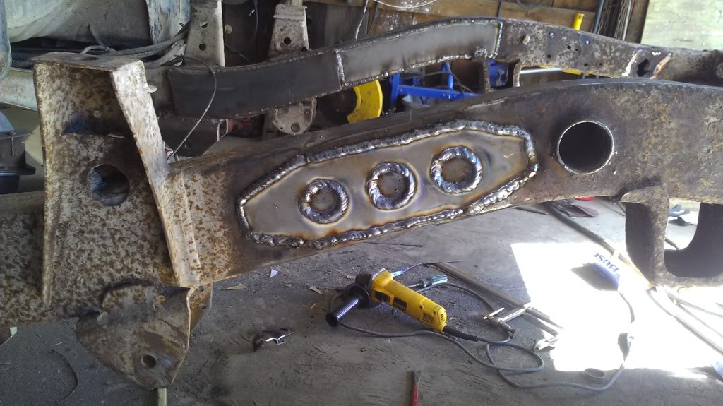

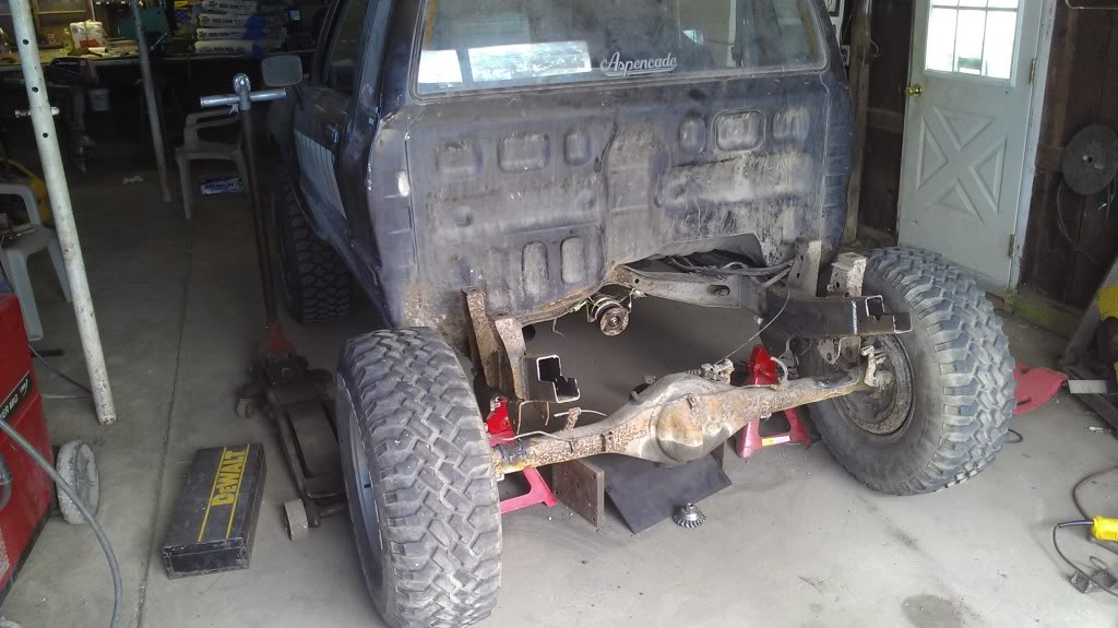

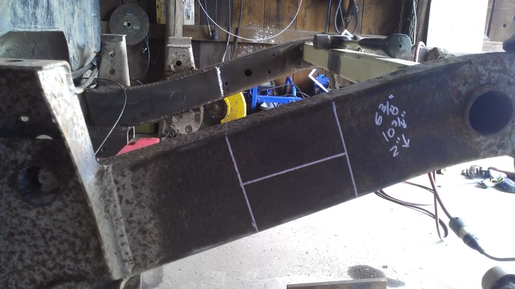

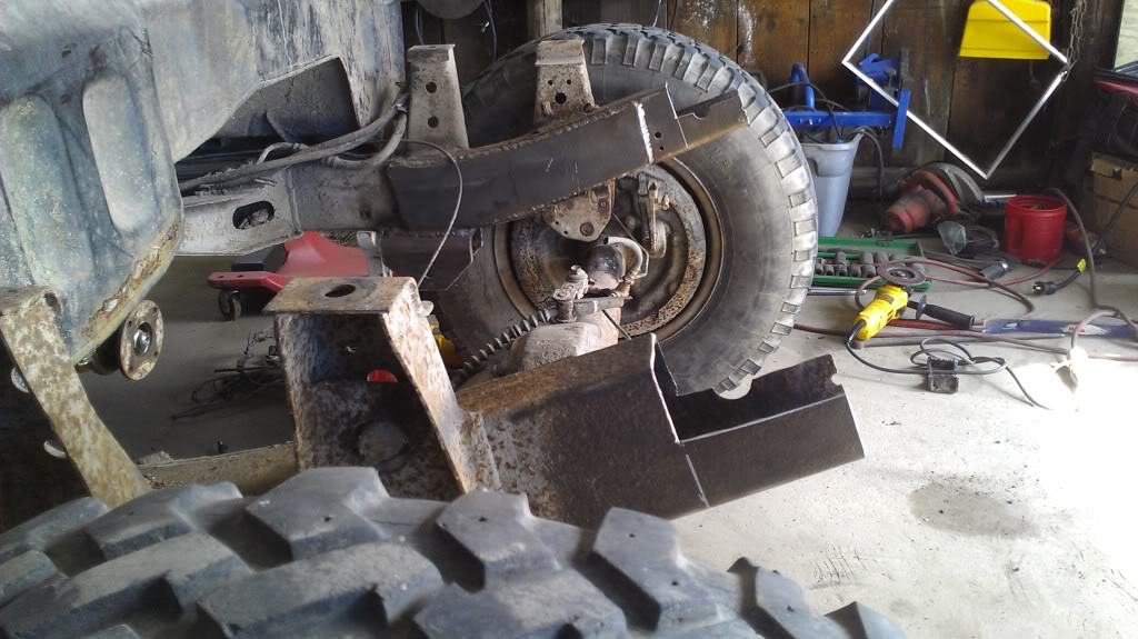

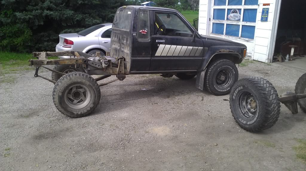

Thanks guys, didn't know anybody was following this so I haven't updated in awhile. I was looking at the rear portion of my frame awhile back and sadly it looked more like swiss cheese than steel so I chopped it off and replaced it with the rear section off my parts truck.
Here is the old frame stripped down
My cuts marked out
Aaaaand cut off.....hope I can figure out how to get it back together lol.
That was enuf work for one day so rolled the rearend inside the shop and under the truck. I instantly got visions of a super short wheelbase lol.
The next day I slacked big time on taking pics thru the process but I got it welded back together, the welds ground down, and plated over the seams inside and out. I intended to cut holes on the inside plates to add a lil extra welded strength but got in a hurry and forgot til they were welded solid so I just did it to the outer plates.
Now that the frame was done I went ahead and swapped in my ifs rearend. And I had a helper....
Daddy I love mud tires!!!

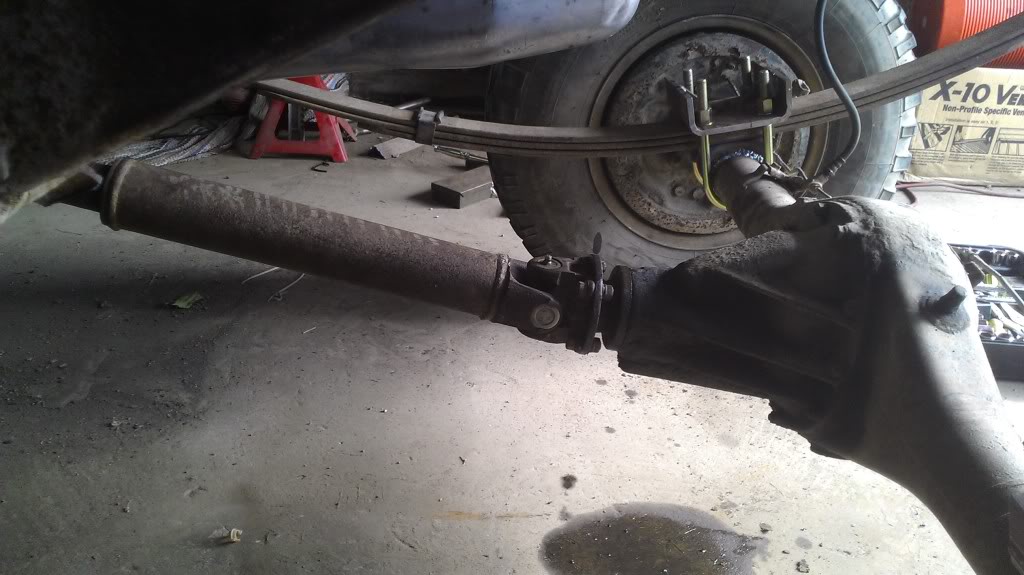

Now when I originally swapped in the ford springs my pinion angle was pointed WAY down and there's no better way to fix that than to cut off the old spring perches and weld on new ones. I am much happier now. I really need a longer driveshaft but most likely will just make a spacer for now unless I come into a bunch of cash. Here's a pic of the ifs rearend swapped in and the new pinion angle.
And all put back together.

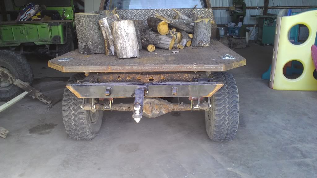

I've still got to make the upper shock mounts b4 I can mount my new shocks but b4 I do that I needed the flatbed back on so I don't have any clearance issues. Oh and the section of frame I swapped has already been bobbed behind the spring hangers so my bumper will be flush with the back of the flatbed. Name:  IMAG0199_zps6741fb1f.jpg
And a shot of the bumper. I'm very pleased with the result.

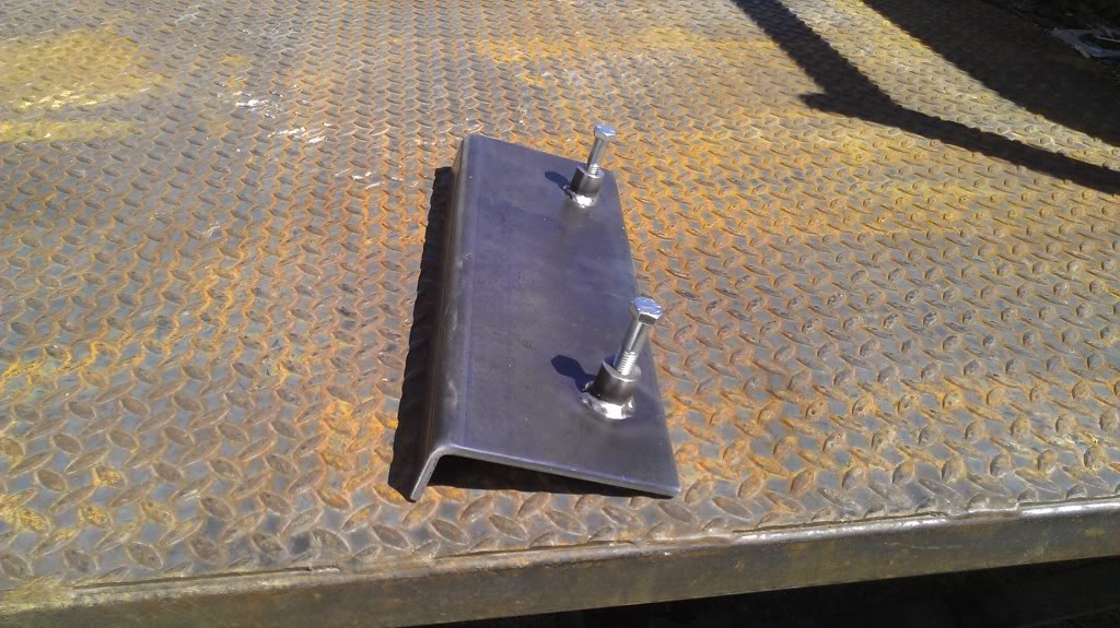

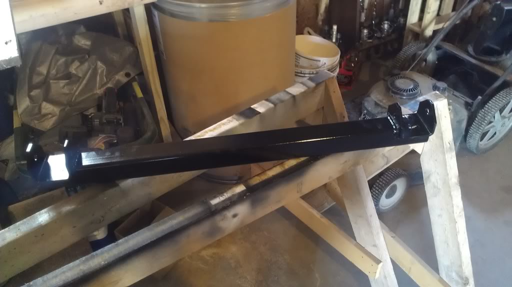

Short update. Got my upper shock mount made for the rear.
This will get welded right onto the 2" square tube crossmember already in place on the frame. Also I've started making a new front spring hanger to swap in my ruf pack. Will post pics when I get it finished.

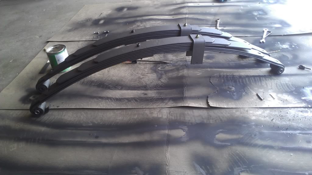

Another quick update. Built a front spring hanger for the ruf's. Maybe someday I'll get em put in.
