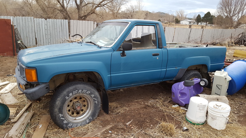

Got an 85 Toyota pickup 4x4 in trade for some welding labor on a co workers dump truck ane a tune up
Truck is a 85 base
22R
5spd
4.10s
Plans are:
35s
4.7 t-case gears
5.29 F/R
Spartan front
Spool rear
4" lift
Bumper F&R
Sliders
Winch
and all the extra goodies in between

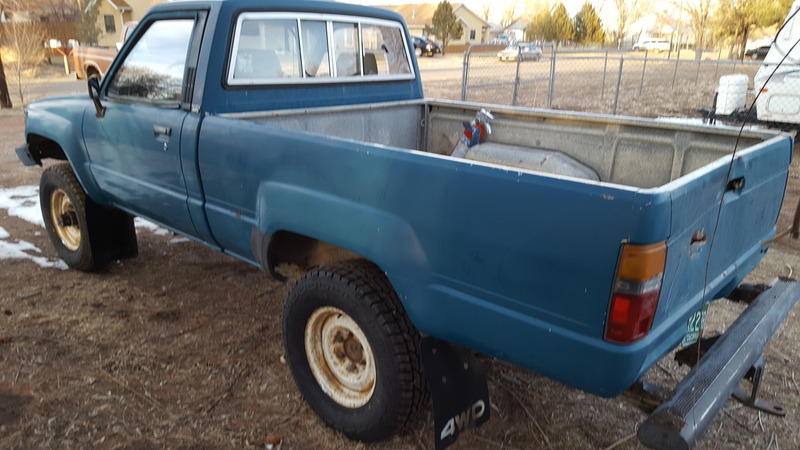

Picture of how i got it

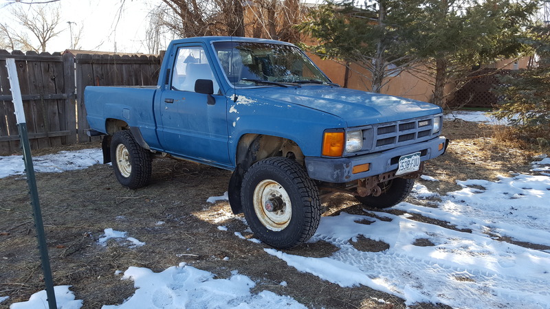

Put some tires off my 82 on so i can get it mobile and cleaned her up

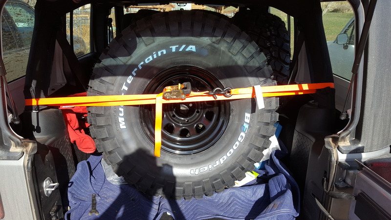

Picked up my 35s

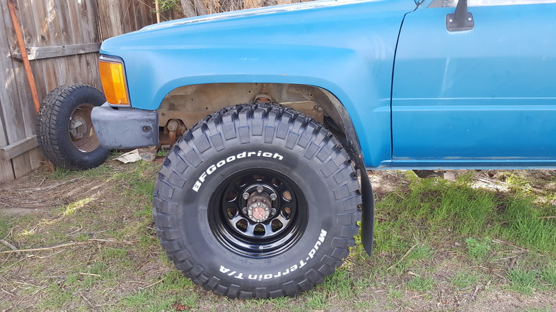

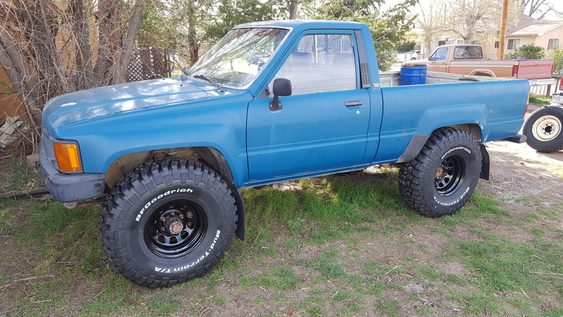

35x12.5x15 BFG KM2s on 15x8 Pro Comp 51s

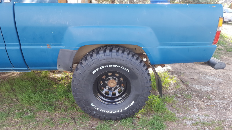

Test fit the 35s
They clear the rear fine but the front is turned as far as it can go...
i ordered a drop hanger to move the axle forward as well as shackles for both front and rear

looks great! If you are moving the axel forward are you going to do cross over steering too, or just work with the stock push/pull steering?

immediate plan is to move the axle forward 1.5" and use the stock push pull and just shorten the drag link to match and go crossover steering as soon as I find a IFS steering box

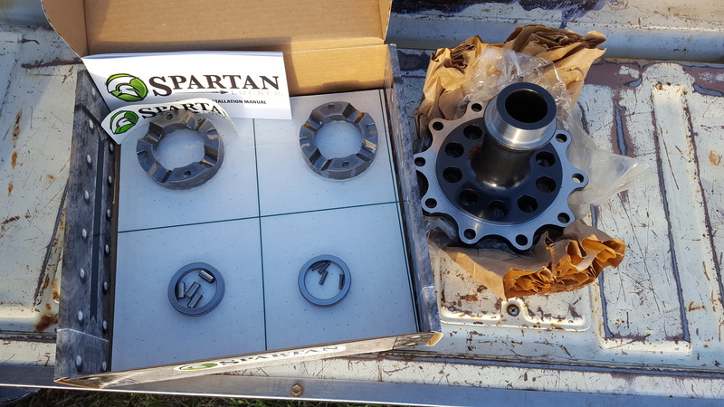

My favorite part of this build so far is getting all the new parts.
Lockers showed up
