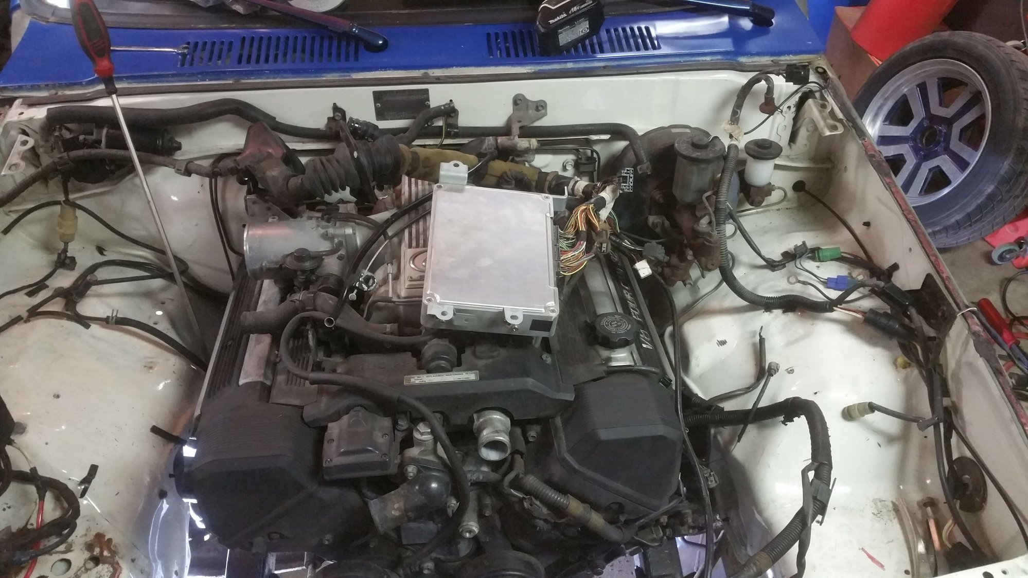

The day i picked the truck up and trailered it home. It originally had a 22r in it but the previous owners decided to start the 1uz swap.
As shown in the original Craigslist ad 9 months ago. The body is in excellent shape as the previous owners did a full frame swap, cab swap, and bed swap for the best parts they found.
In the above picture it was already attached to a w58 toyota 5 speed manual with the use of the adapter kit you can buy.

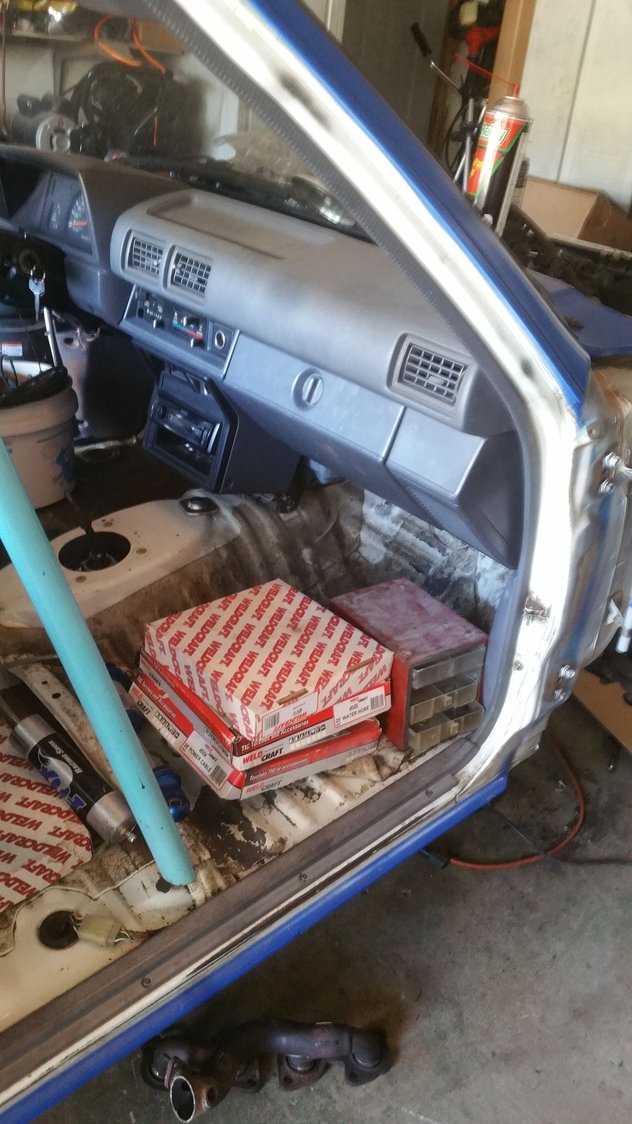

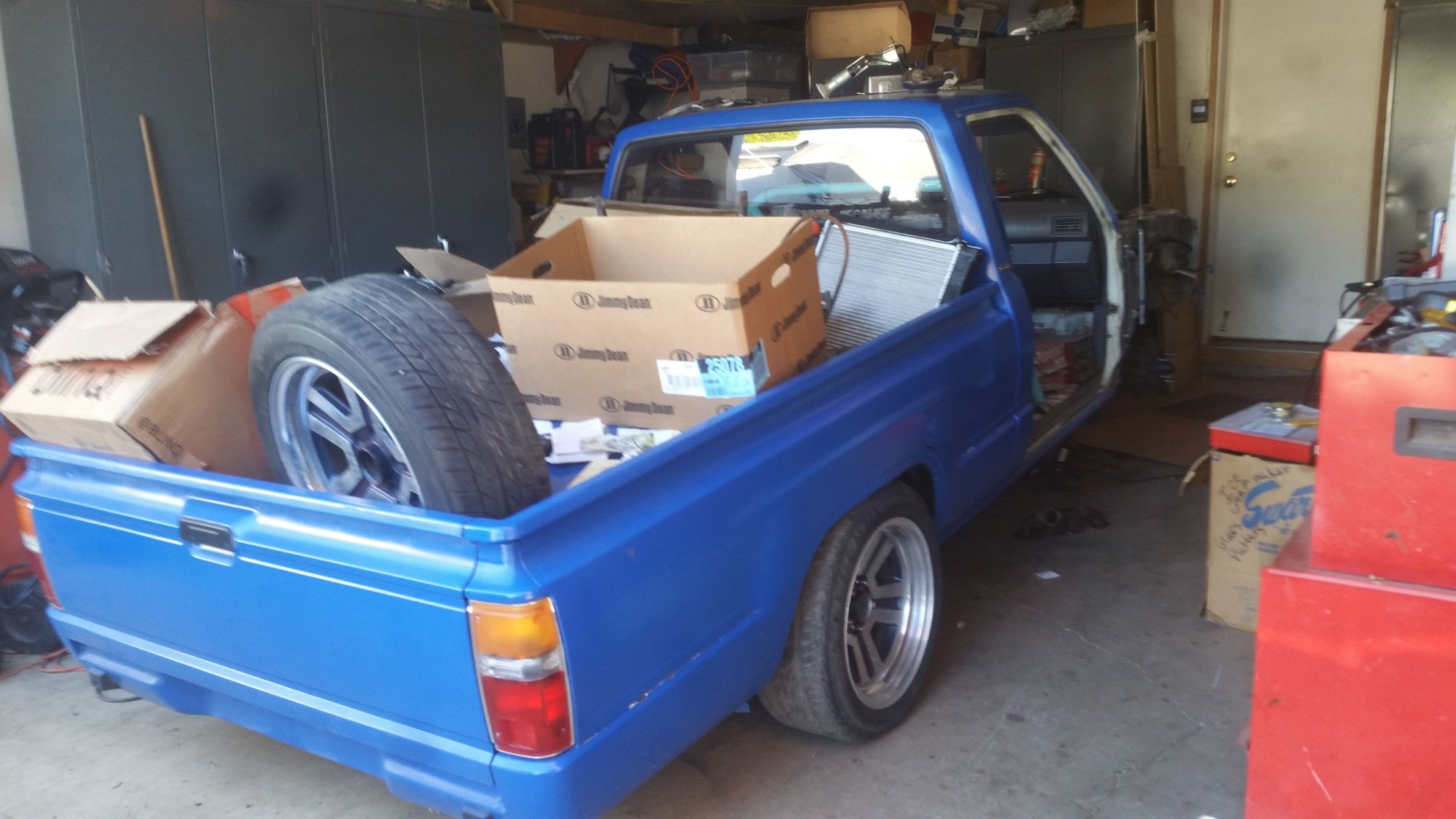

The first day we had it home and in the garage it was tear down time. Over the next few days and weeks the front end and interior were stripped the rest of the way and It ended up being a really handy trash collector and the bed was constantly full of random crap.
The roll cage is out of a 71 datsun 510 which is another project i have that isn't being worked on currently. We were going to chop it up and make it fit but decided it wouldn't be worth it and be harder than just making a new one.

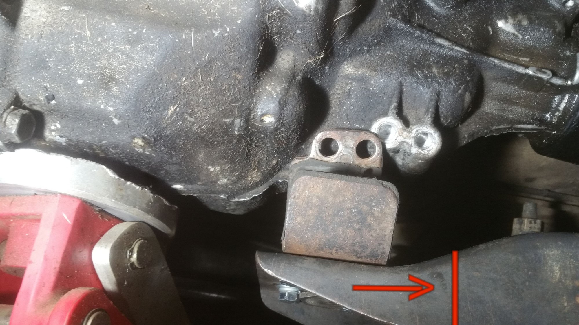

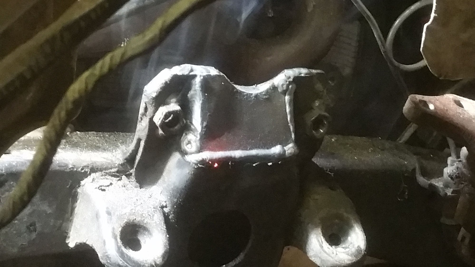

The first part of the project was to get the motor where we wanted it sitting then weld the motor mounts that got cut back in. Then get the transmission crossmember motified so we could bolt it in. We decided to shove the motor as close to the firewall as we could without beating it in to much. We also dropped the engine by cutting the engine crossmemeber out to give us a few more inches of clearance. (Currently it has a crossmember we custom built while it was on a rack. But have to pictures yet. I'll be pulling it out soon to paint it and I'll upload).
That is the stock crossmember with the stock mount and all we had to do was cut the mount in half and slide it back into itself and re weld it then spin the runner piece 180 and it lined up perfectly.

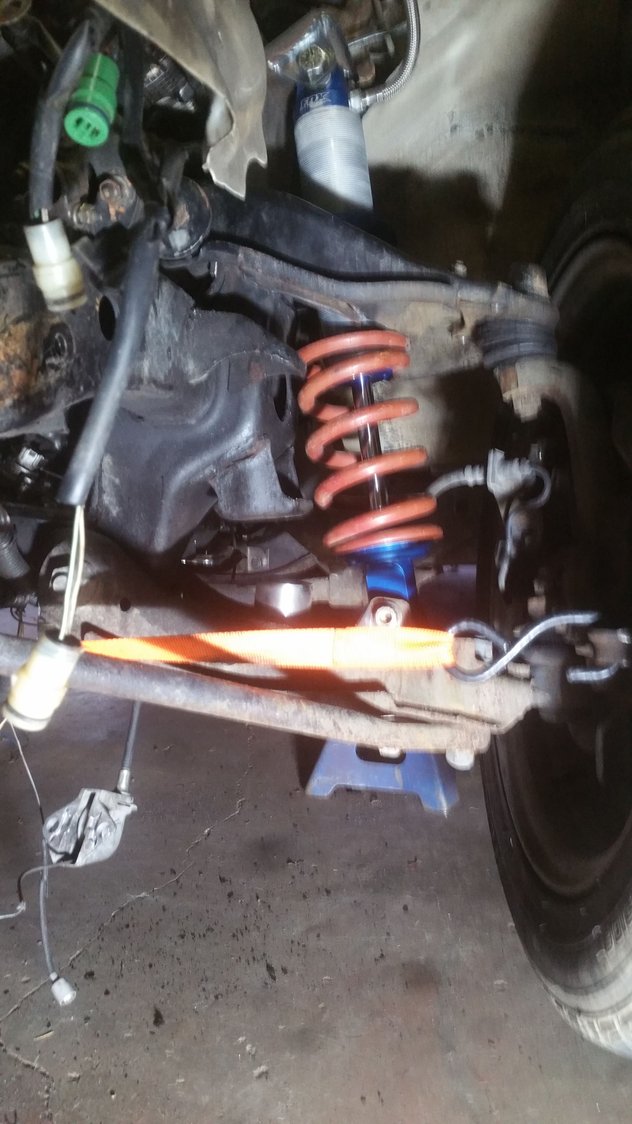

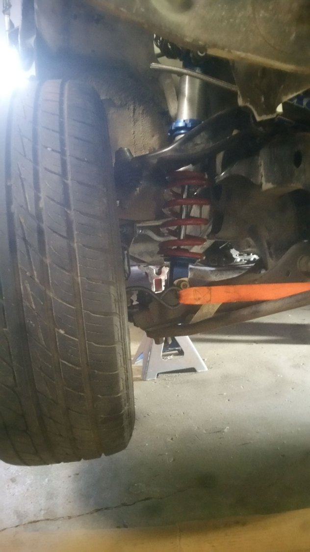

We had a stupid idea to take a set of coilover we had laying around and figure out a way to install them cheaply. We messed around with the coilovers as this wasn't a fast project by any means!

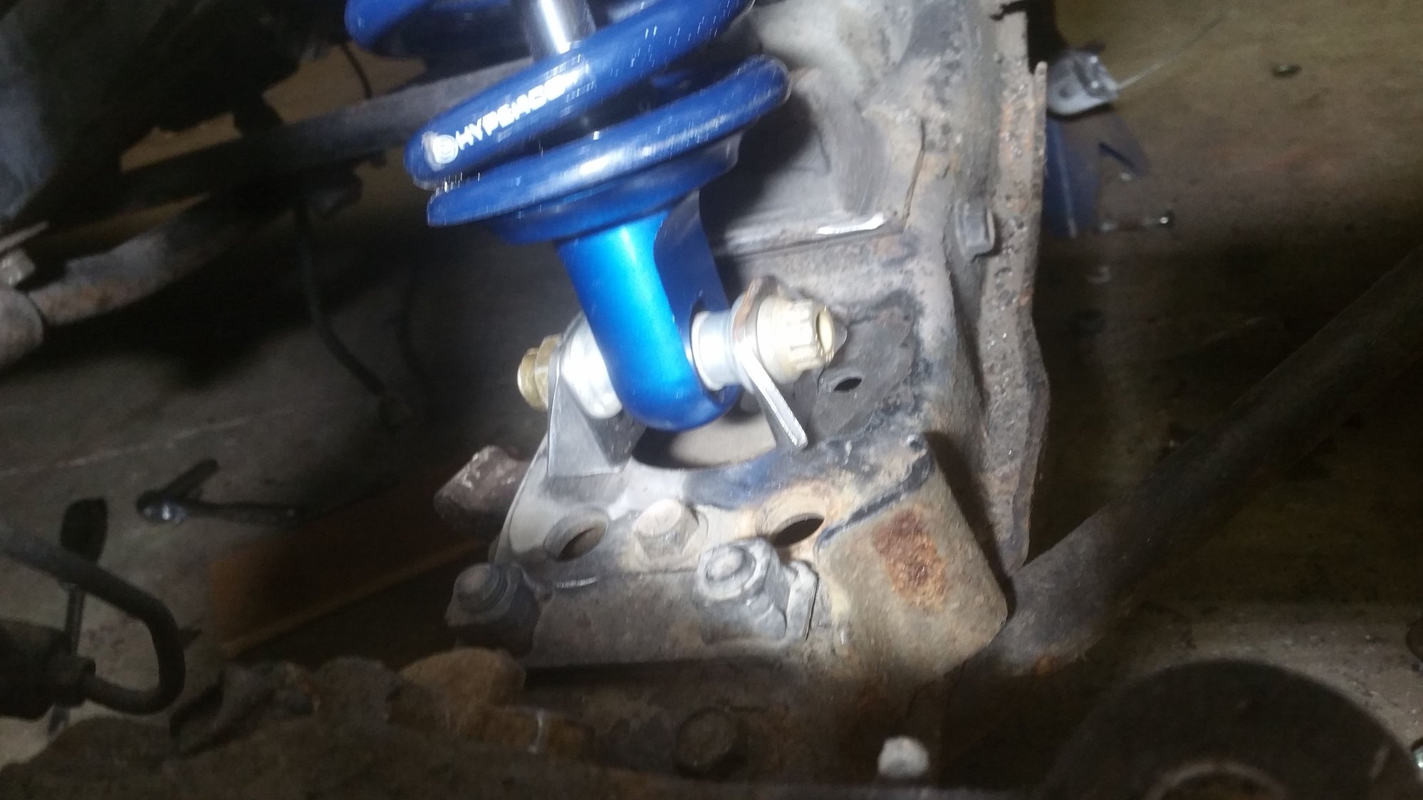

We removed the top control arms and cut the little lips off the inside and re welded them to open up the centers enough to slide the shocks down into. (I don't have a picture of the upper arms at the moment but can take some if anyone is interested). After digging through the mounds of random parts i found some tabs that worked perfect as the base and top of the coil itself.

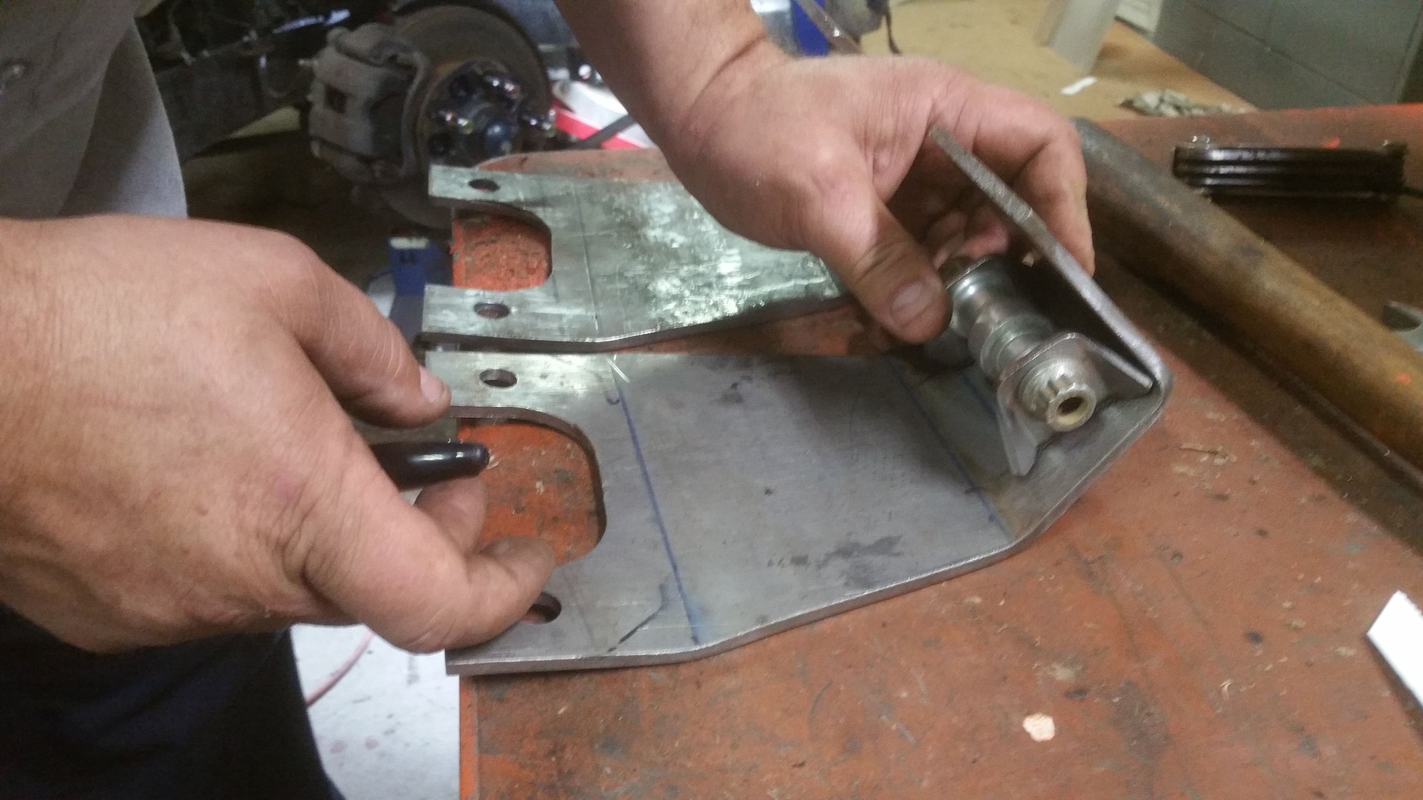

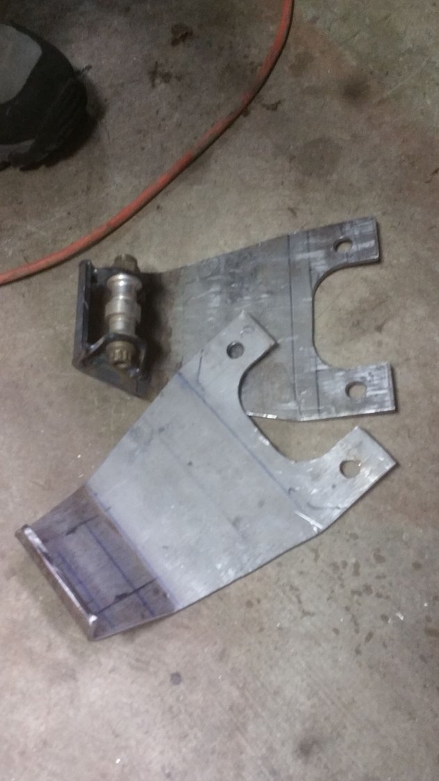

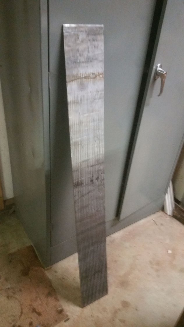

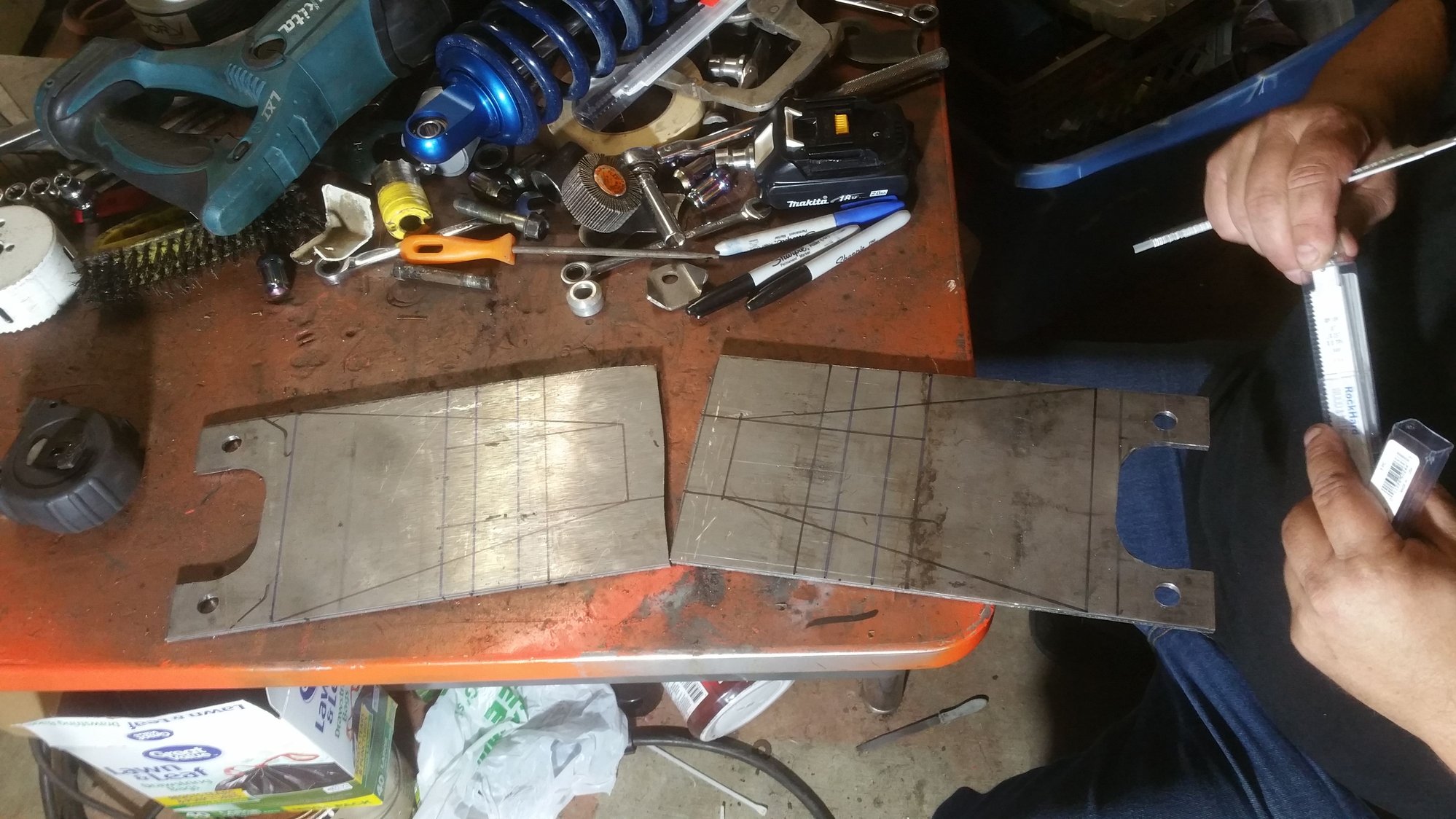

Went down to the local metal shop in town and picked up a little sheet metal to start on building the towers to mount the coils to. Instead of buying hoops online I figured they probably wouldn't work due to using stock control arms (But who knows lol).
Testing the metal by bolting into the stock upper control arm location.

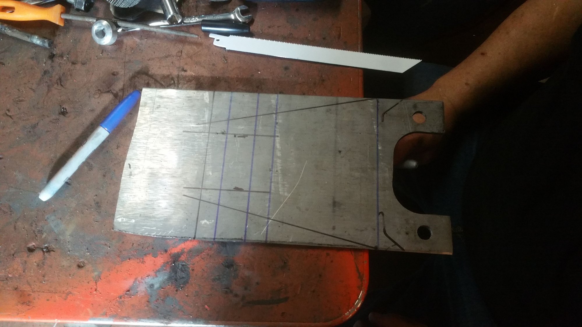

Getting all the lines laid out for the shape of the towers.

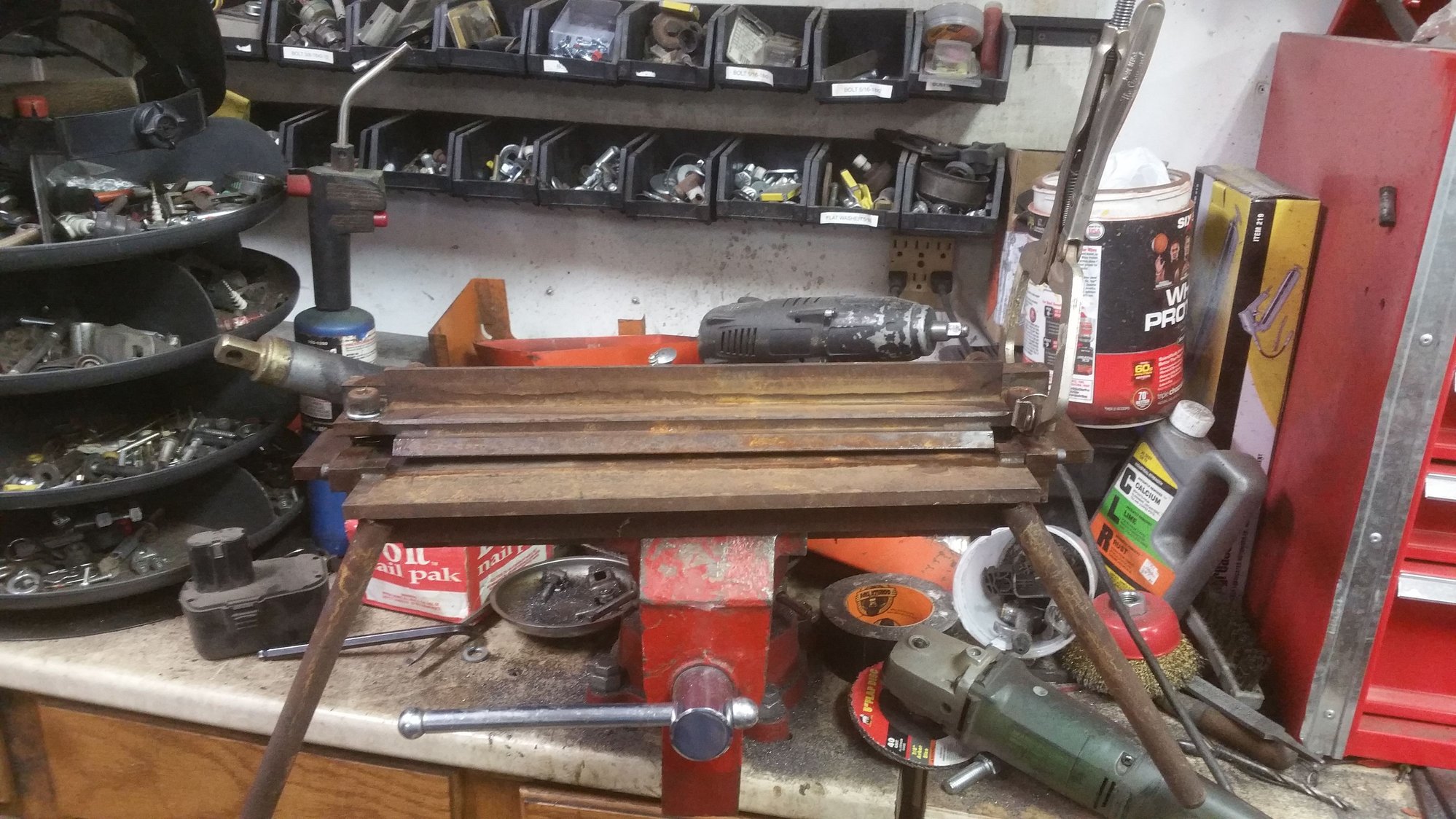

Our home made sheet metal bender which worked perfect for this job.(Oh and the huge ass mess we made while building this truck is now all cleaned up)!
With everything tacked together we wanted to get the coils bolted in to see how they would look. Everything cleared surprisingly well with no problems.
I still need to make mounts for the reservoirs and fix the fender wells that were cut out.
One of the biggest things we wanted to do while building these towers was to insure that we would have a good amount of travel while still allowing it to be low. So we actually lowered the truck so it was about an inch off the ground from the cross member and the tires where resting against the bottom of the wheel well.
Then built the towers to hold the coilovers with enough travel to go another 2.5 inches lower and then lifted the truck to the position it would be riding at sop it would have plenty of travel and droop. So technically the truck is lifted from its "stock" position.
After test fitting a few times we had to remove the hump that was in the middle and cover it up to allow for clearance of the shock itself. We also decided to use some 600 pound short shocks instead of the lighter weight tall blue ones that were originally on the coilovers.

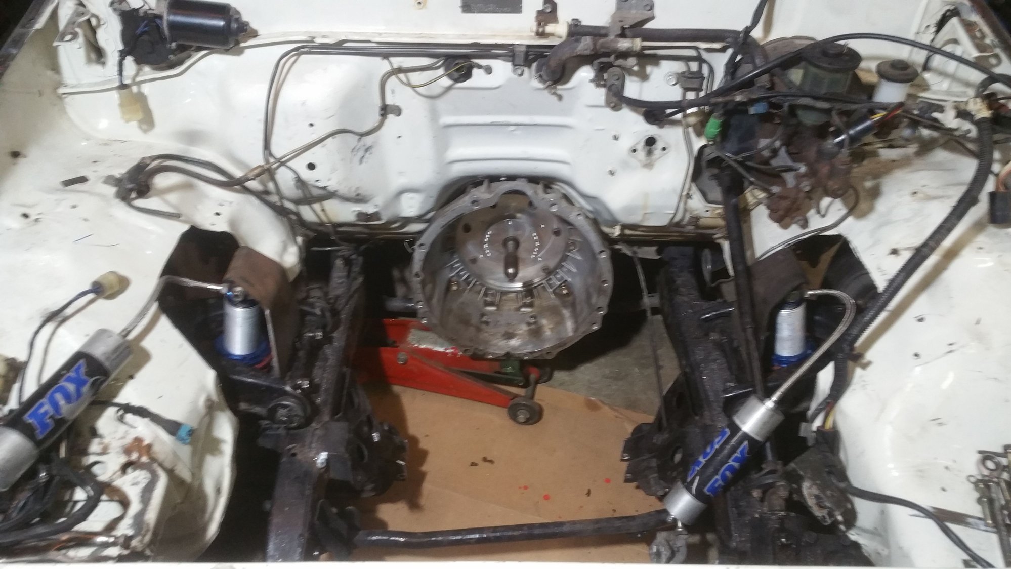

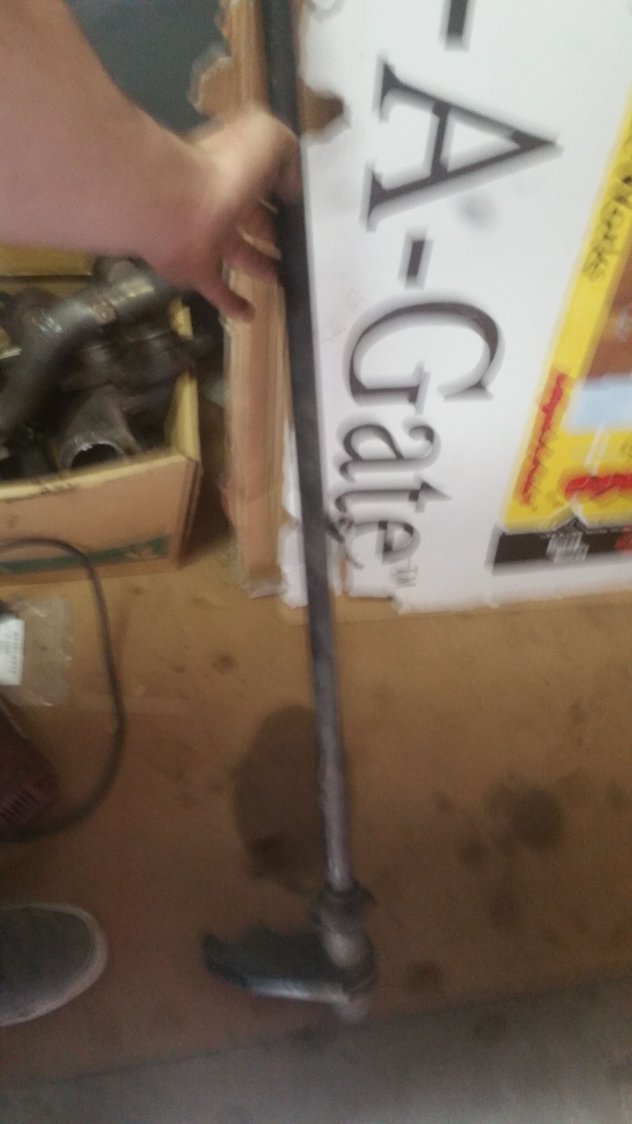

Oh how nice it was to pull the old torsion bars out and free up all that needed room for the exhaust. (which is the main reason we went with coils).

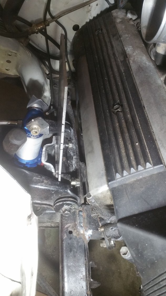

Both left and right installed for time being before they get reinforced. The steering shaft and steering box cleared perfectly with nothing special having to be done to them. The crossmemeber had to be cut out to get the oil pan to fit in the correct position as we dropped the motor much lower and shoved it as far back as we could without cutting into the firewall.
