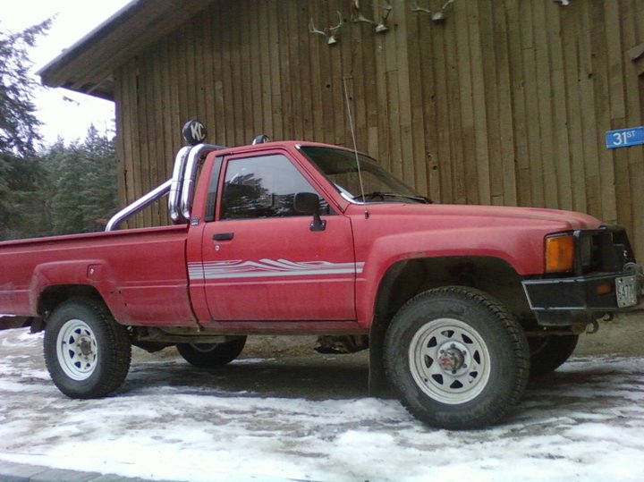

this is what it looked like after we got it and put on a roll bar.

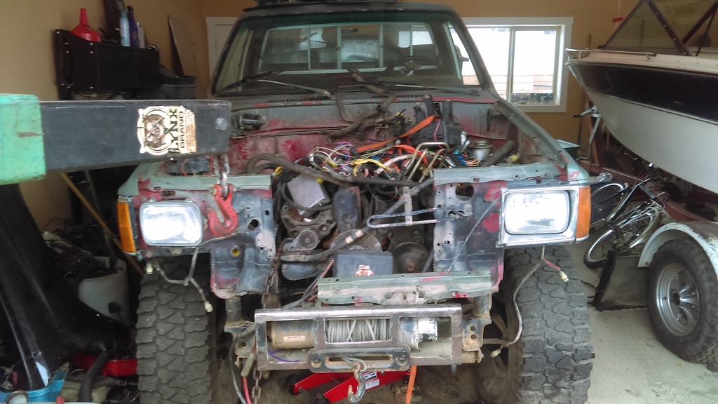

currently getting some love. vortec 350 sbc

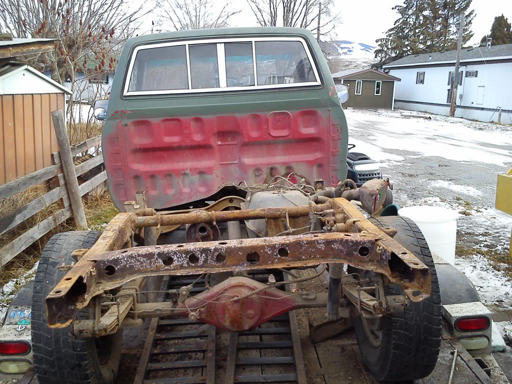

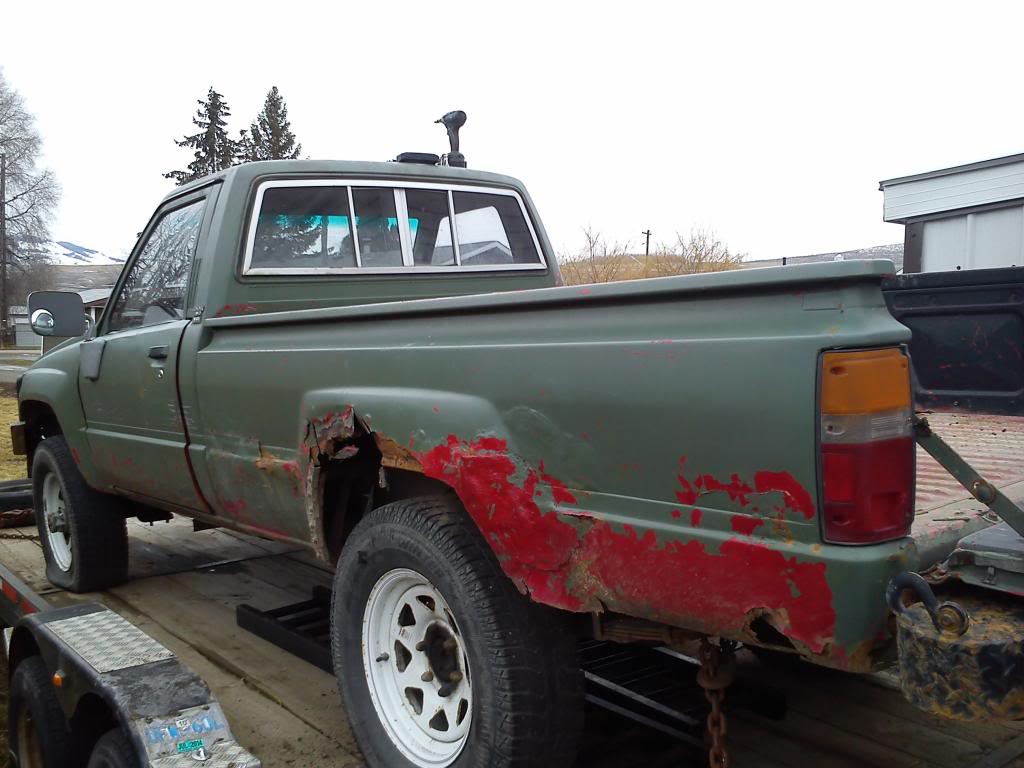

this is after the motor blew, and after i took the roll bar and bed liner out

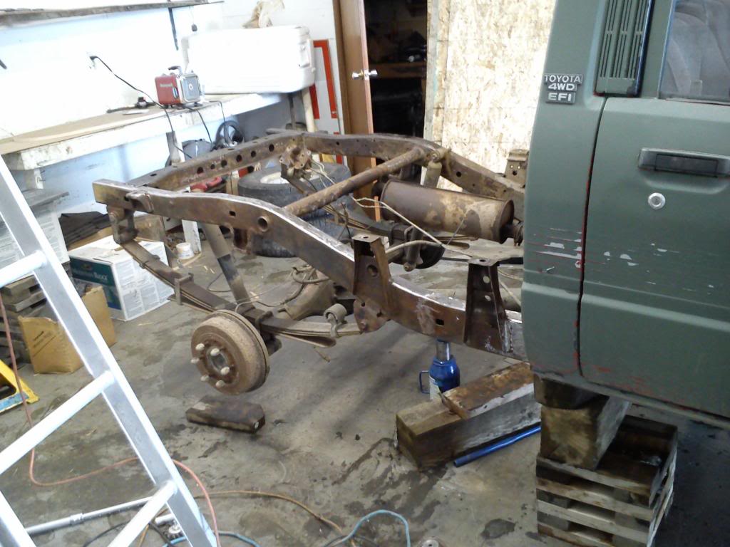

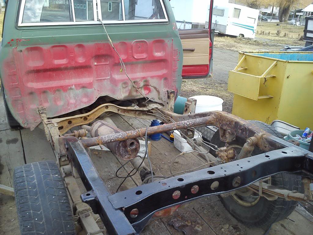

took the bed and bumper off

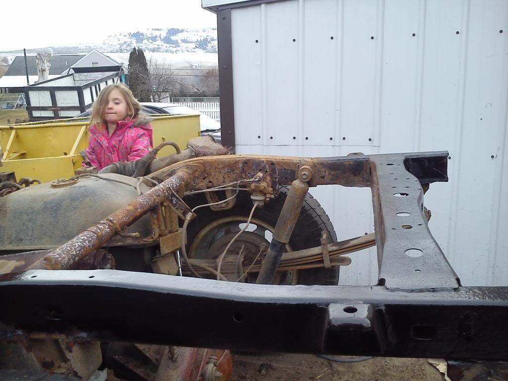

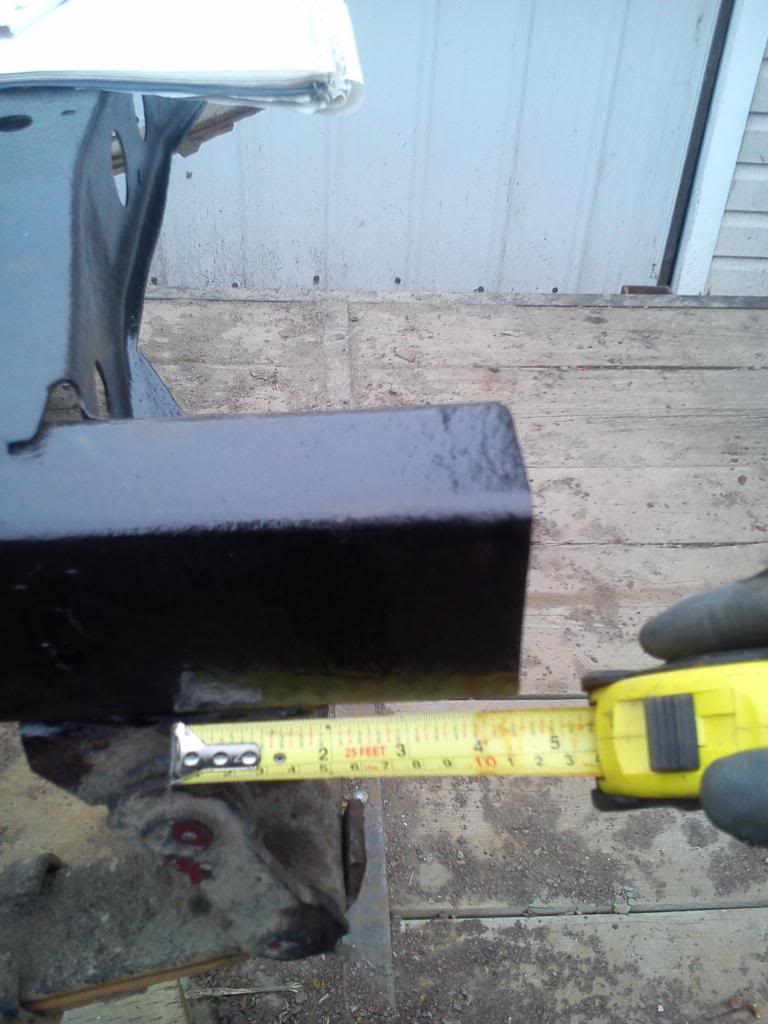

Trimmed the frame a bit, left enough for when i put the longer leafs on

not sure what to do to clean up the inside of the frame. other than cut out the thinner inside wall and grind it down and weld on a new wall. any idea's?
Old 02-28-2014, 10:19 PM
Yota's Avatar
Join Date: Jun 2013
Location: kelowna BC
Posts: 363
Received 0 Likes on 0 Posts
turns out i might have chopped off to much ...
http://www.pirate4x4.com/forum/toyot...-swap-faq.html
any ways, did some reading. all 38 pages in one sitting. my back and eyes hurt. and im going to do this, im not worried about huuuge ride height, as im moving the gas tank, and will deal with t-case xmember when i get there, and honestly the very last thing im going to worry about before this truck drives anywhere is the rear drive shaft length. ill find something to fill the gap when the time comes lol (dual t-case . losing the auto tran and maybe changing motors)

You can always box in the rear frame and hang the rear shackle mounts off the back vertical.

thnx for the imput. i was thinking about maybe just moving the front hangers waaaay forward, putting the axle where ever it lands and then find/fab the drive shaft to fit, but, i have some time to consider lots of options before i even get to the putting things back together part. (motor tranny tcase (s)) and .. on and on

How much frame is left after the shackle mount ? You really only need to slide it back a few inches if you want to run a laid back shackle angle (35-50*) Which I find works great with 63s cause it softens up the spring rate. Those are 1/2 ton springs after all. Most people don't bother cutting off the stock shackle mount and just weld up a new one directly behind the stock one.

U can use the factory rear shackle mounts if u use 56" ford springs. I cut my frame off rite behind the mounts. Flip the springs around so the long side is forward and add a new front mount 11" forward (if I remember correctly) and ur in business. Rear axle stays in the same location.

thats a good call, but, would i be losing alot of the droop im trying to attain?
this is exactly what i wanted to hear!! thats y i left what i left thinking i was doing the right thing. thanks! and now i can worry about something else. haha.

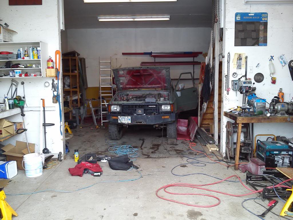

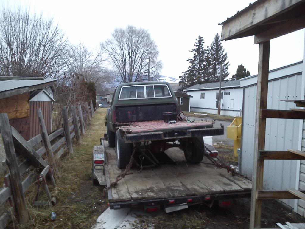

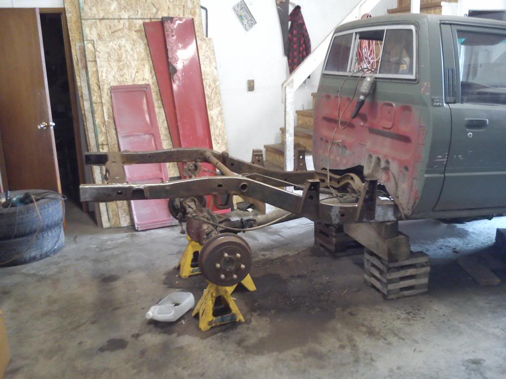

moved into the shop!!!
it snowed and was really cold, so we got the big truck and hooked up the flat deck and rolled the yota into the shop, nice n dry and warm and good lighting

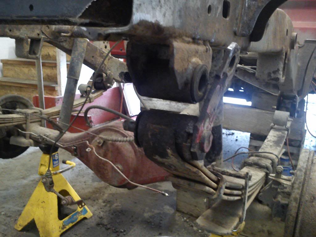

Got a bigger grinder, and a bigger wheel, went much better this time, and took the tires off, ghetto blocked up the rear to get ready to drop the axle and leafs

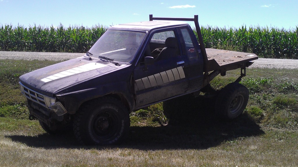

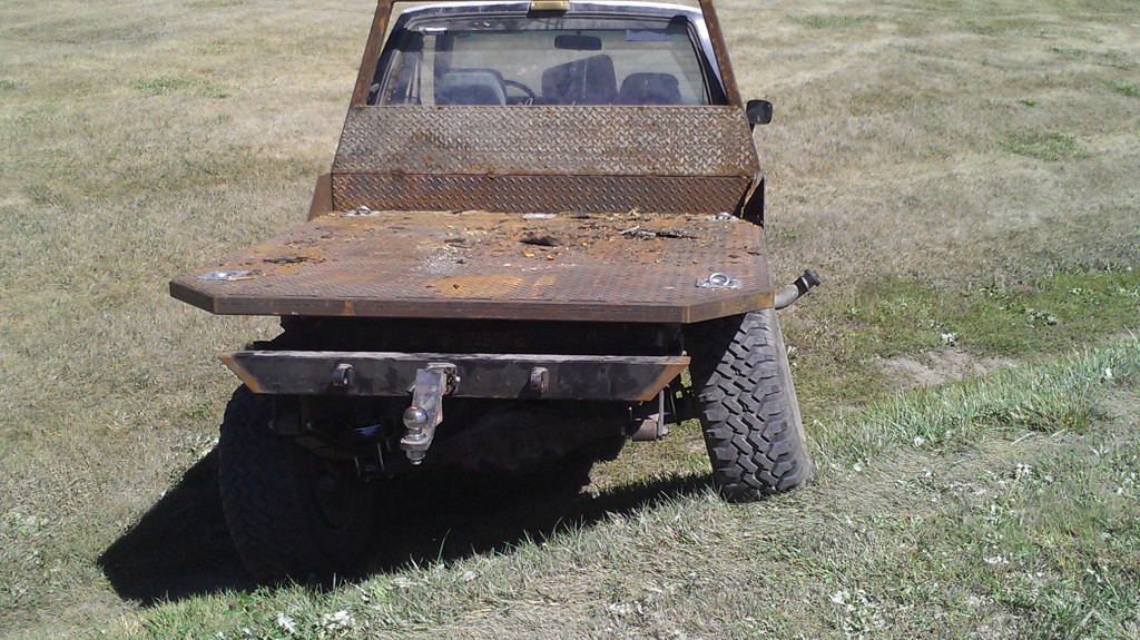

I think they droop pretty good personally. More than likely I would've went with 63's but I had already cut my frame off and built the flatbed before I knew about this site or swapping springs as an option. Name:  IMAG0216_zpse597c107.jpg

^ cool, i like that flat deck i want to use the checker plate on mine but im going to put sides on the bed so i can use it for work.i'm thinkin ill just beef up the end of the frame and over hang the mount a half inch past the frame, and if i have to i can allways adjust my spring perches.

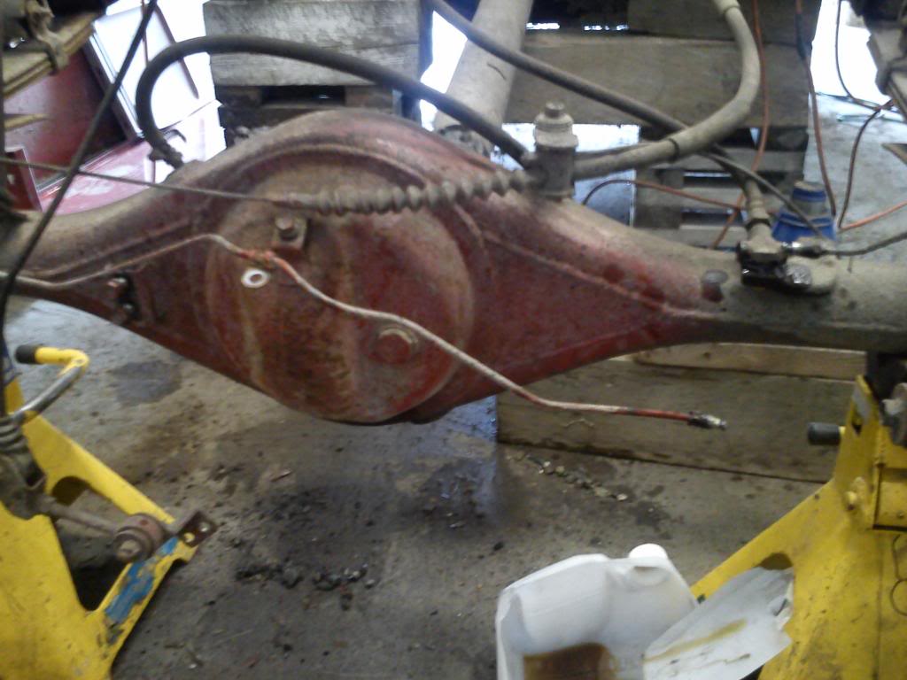

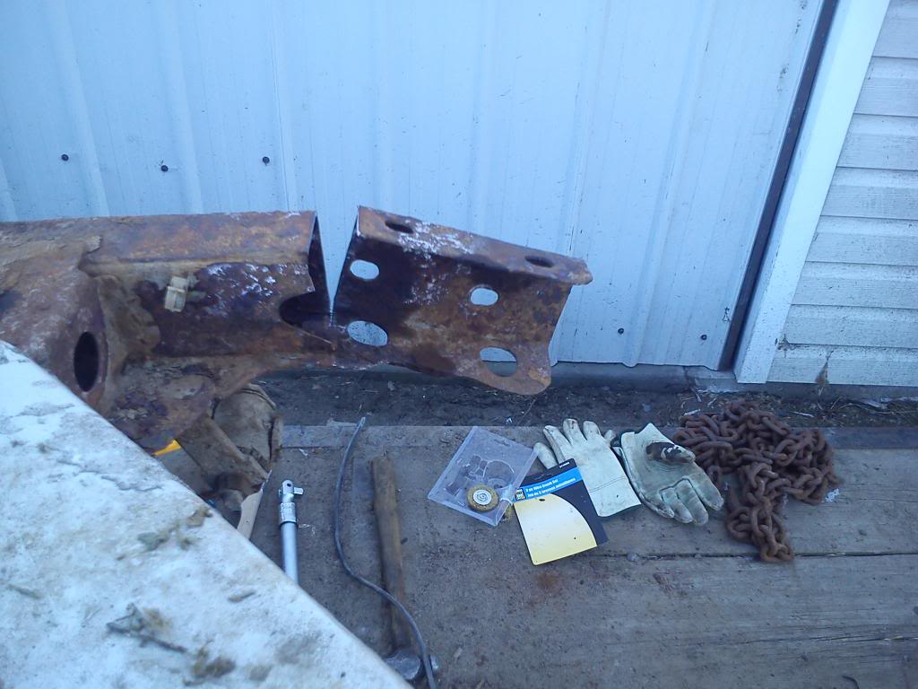

Had a fight with these, got fed up, grabbed a big hammer.
Took some of the lines that weren't rusted to dust apart

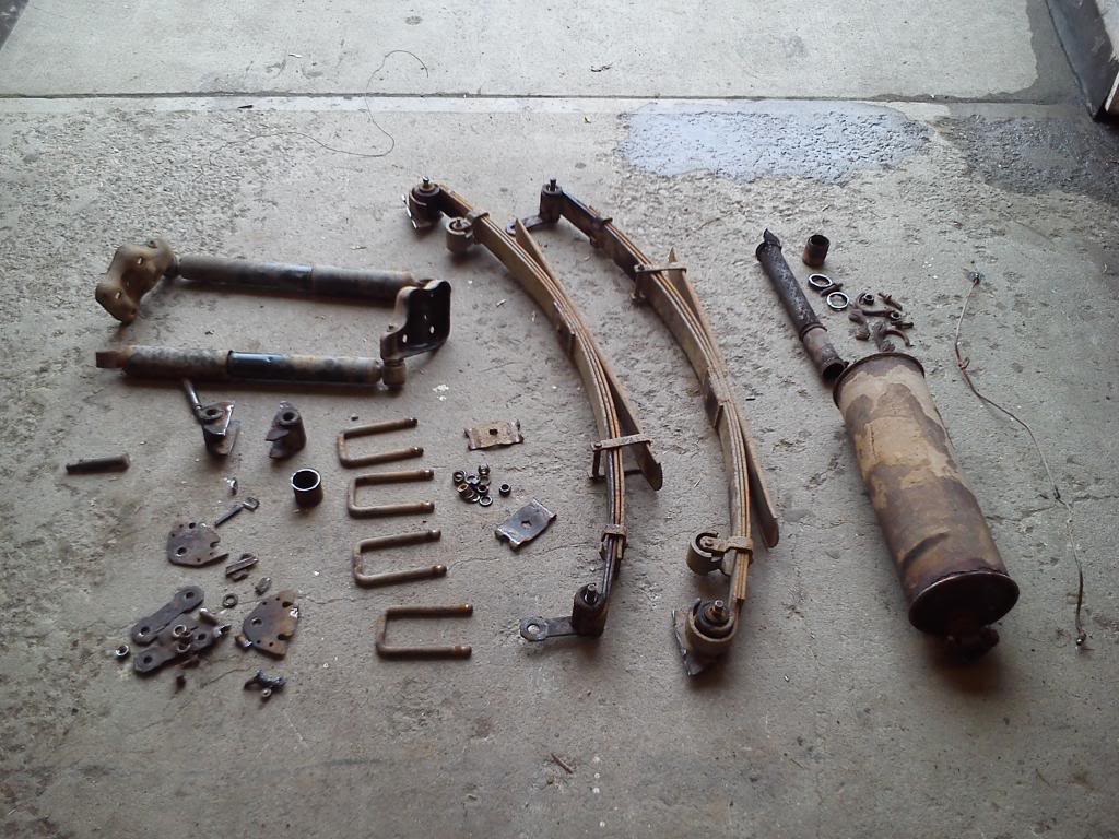

nice little pile today
