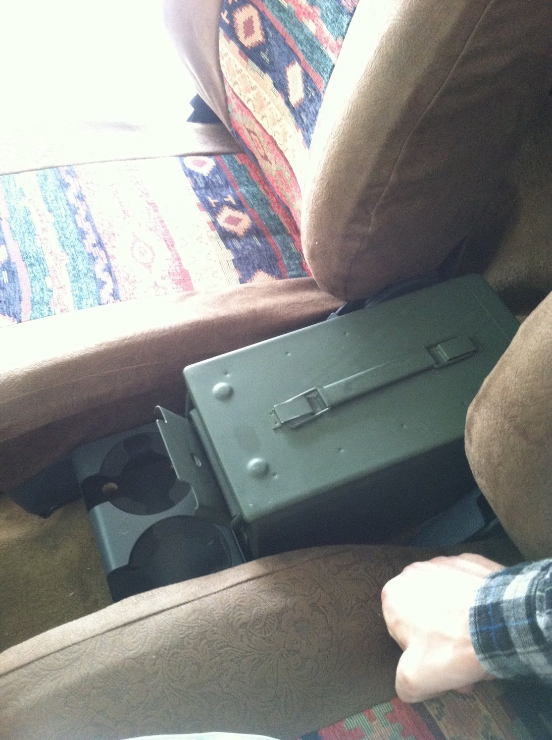

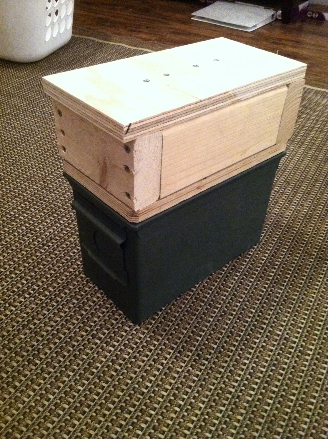

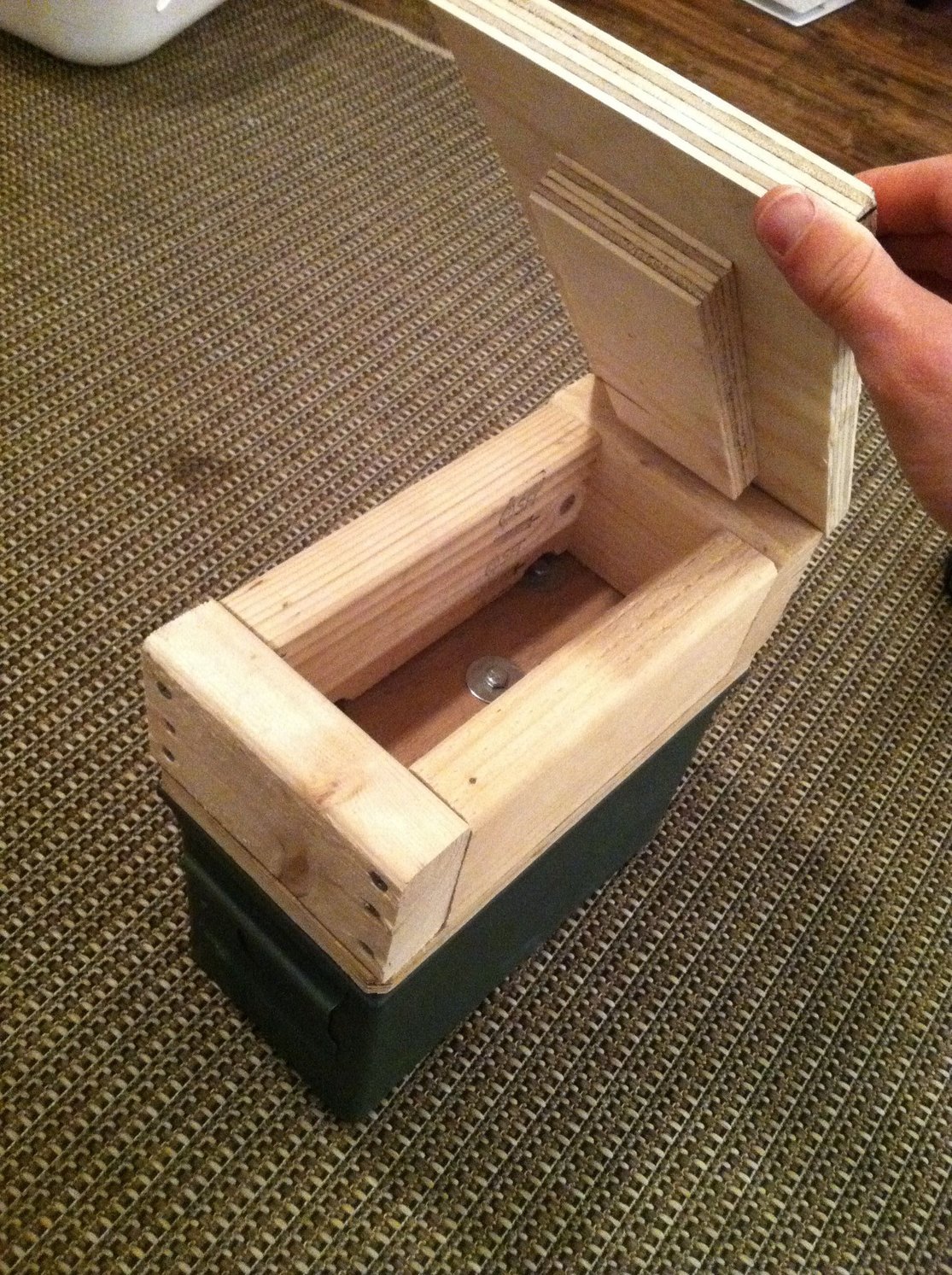

.50 cal console
After driving around with different combos of stacked box/single box I decided the best option would be to add a little height to the single .50 cal ammo can.
(Also borrowed my dads Tuffy cup holders for a test fit)
Old Feb 13, 2016 | 05:27 PM
  #144
84maroonsolidaxle's Avatar
Joined: Jul 2014
Posts: 134
From: Austin, Tx

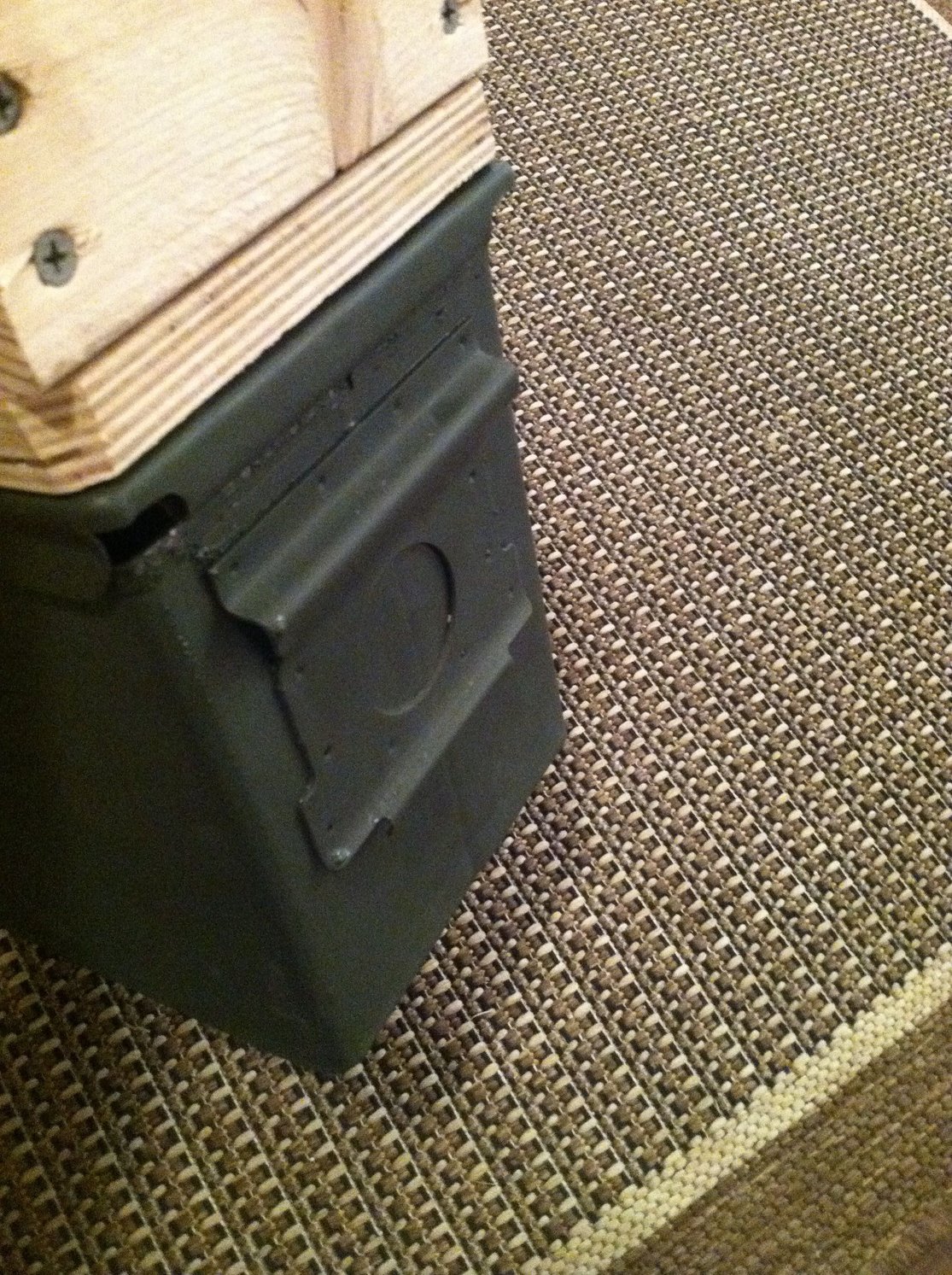

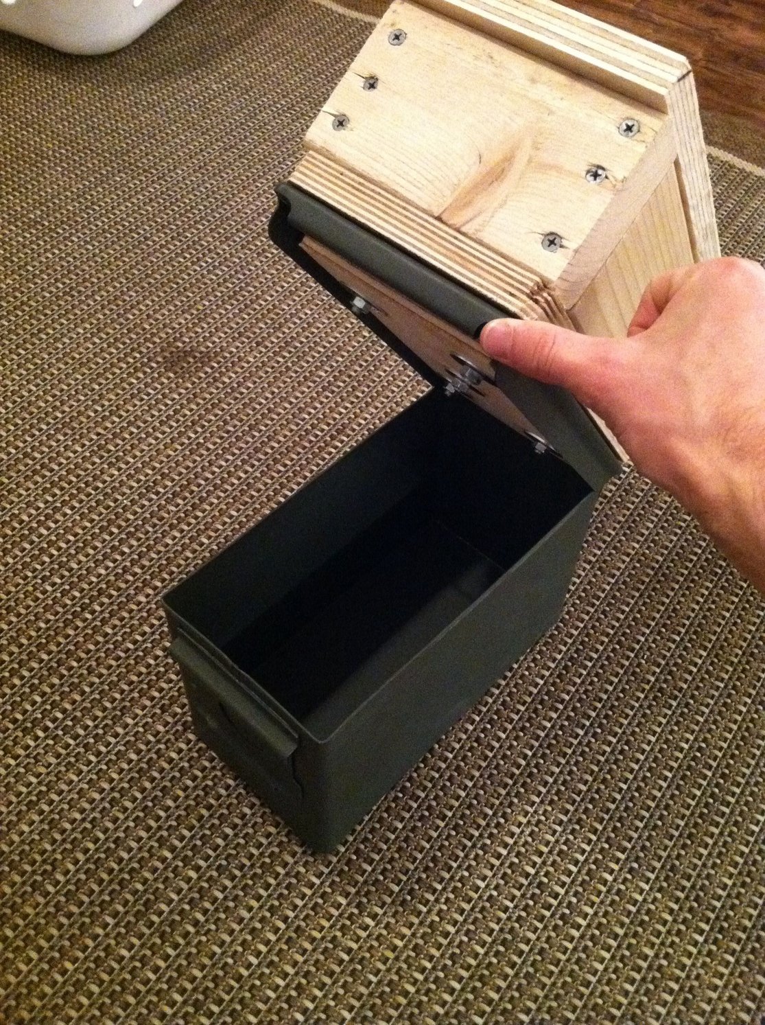

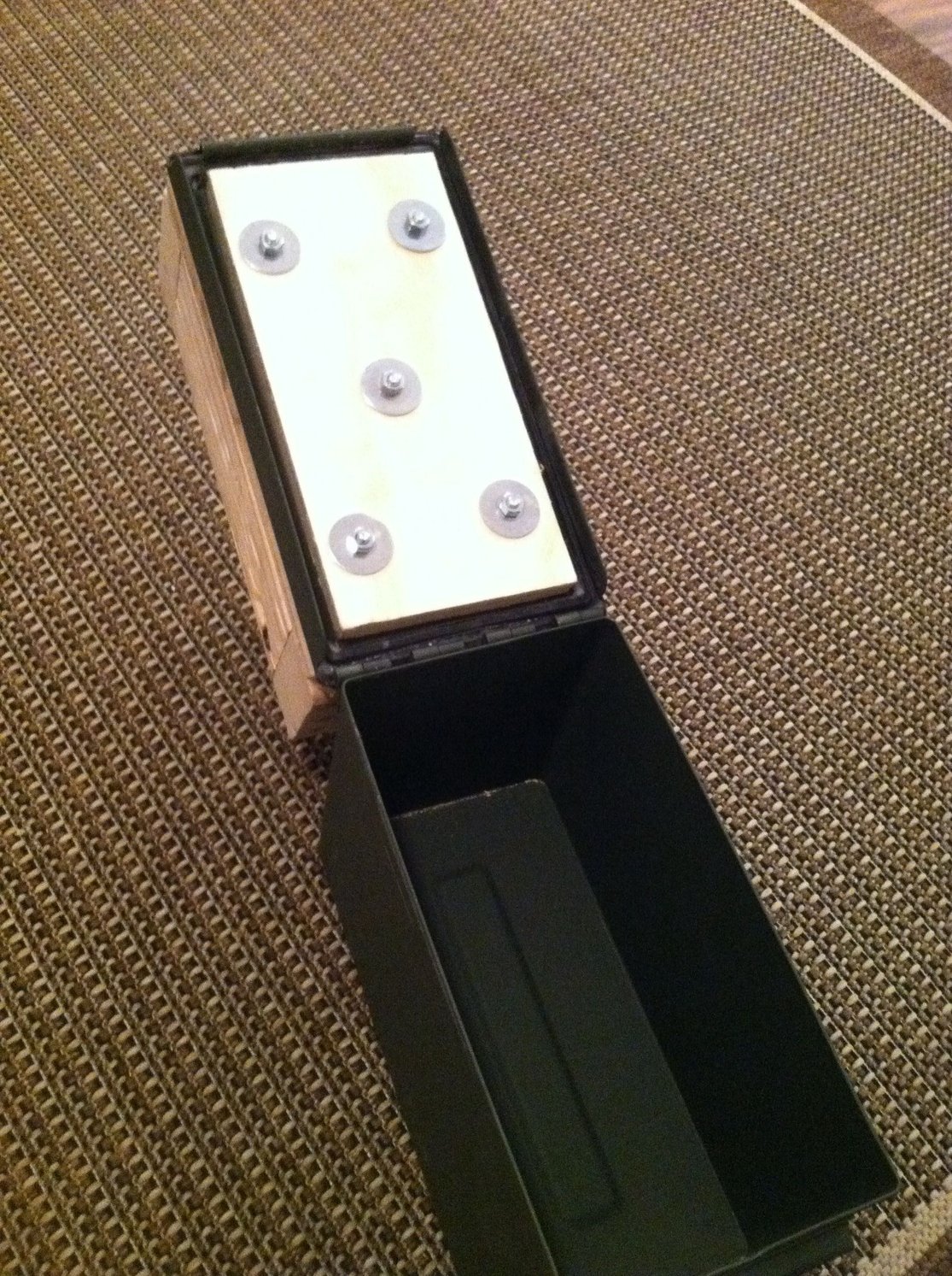

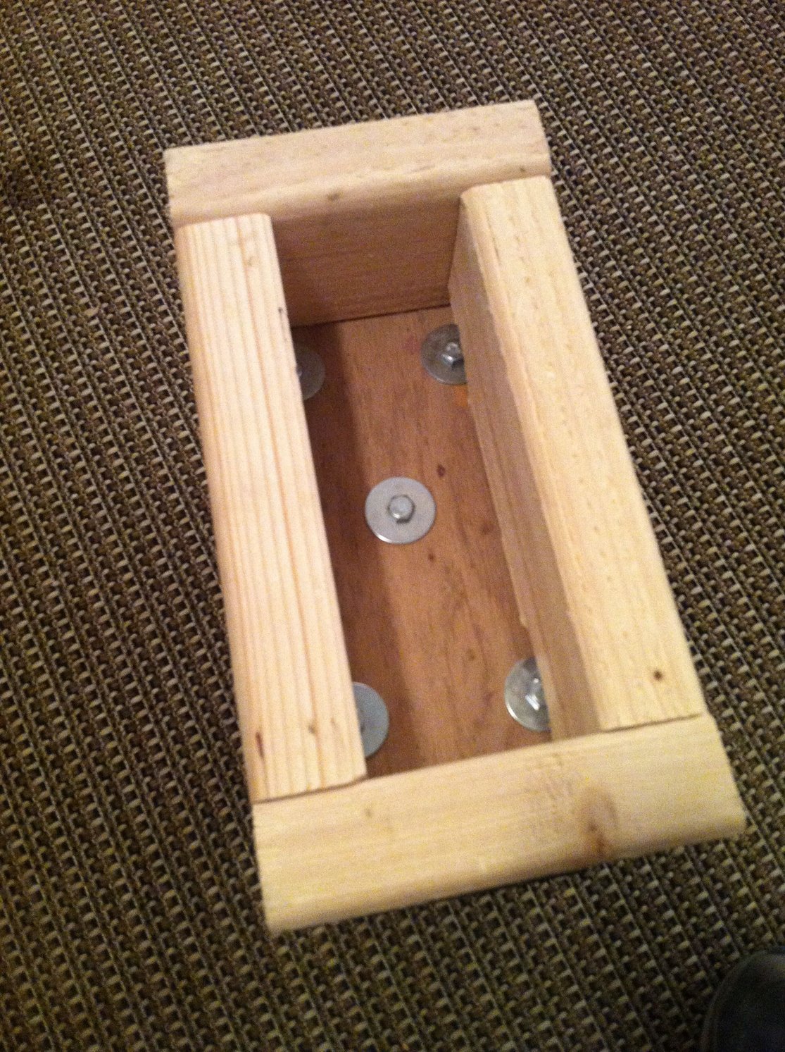

2x4 box
I guess it is no coincidence that the height I found to be most comfortable is very near to the factory sr5 console.
I needed about 8" on top of the can to get a comfortable level for an arm rest.
I removed the top handle and front latch mechanism. The lid stays put without it.
Built a 2x4 box to sit on top and store a small amount of cargo.
Bolted to the lid
The top will be getting some hinges and a pad

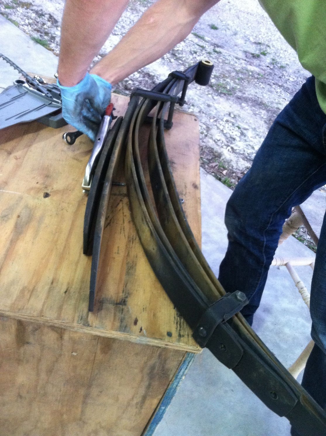

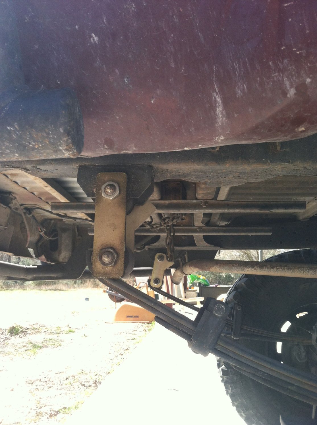

Springs
Originally Posted by Gizler00
I always contemplate doing the Ammo Can Mod to mine and removing the Rear heat console. There really is not much storage with my current setup and I would love more.
Looks great man. How are the springs settling in? Mine are still getting there. I need to go flex it out.
In the process of deleting the rear heat in my dad's 4Runner for that reason.
My front springs are good but the rear was too stiff without a load.
I took out 2 springs and it softened up a lot.
Also my rear OME shocks were completely extended at ride height with no load so I removed them.
Rides better now. Front is a little flat. Thinking about adding my rear leaf to the front if it will fit.
Probably eventually get longer shocks all the way around.

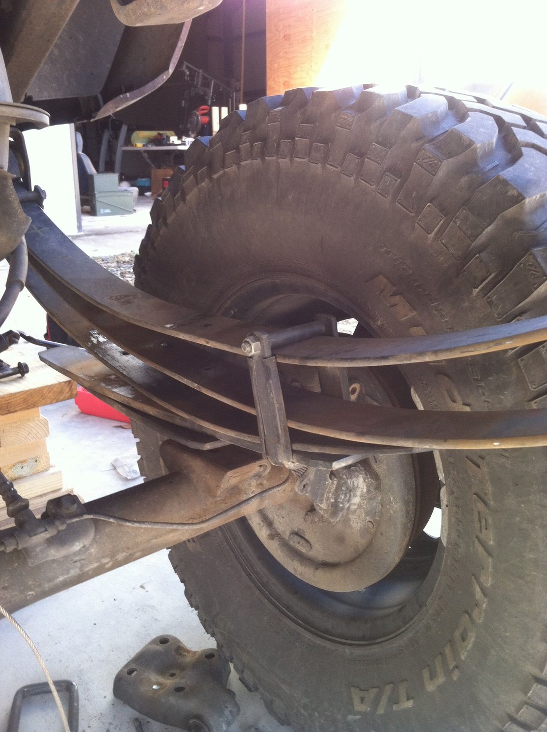

Messing with springs

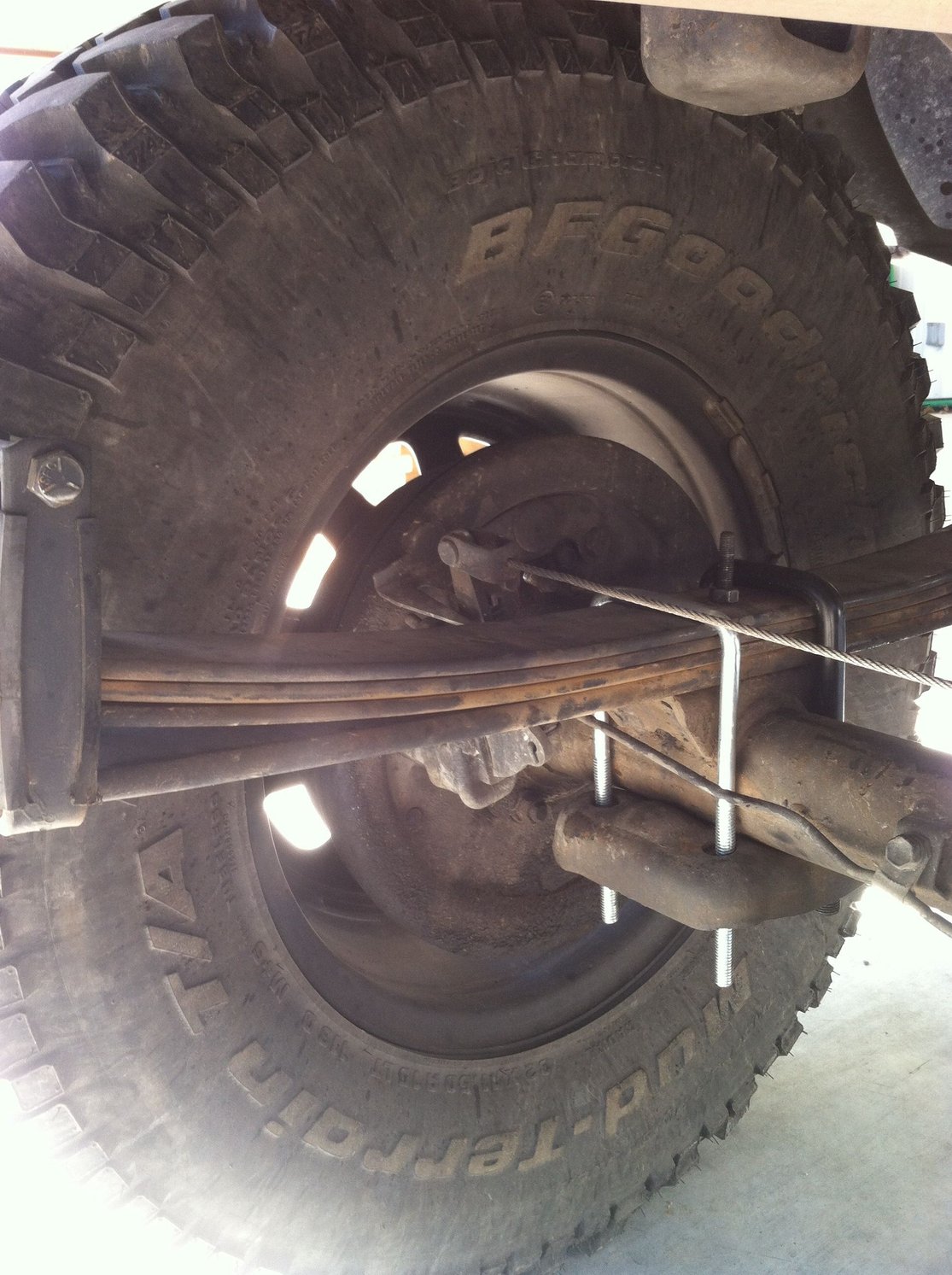

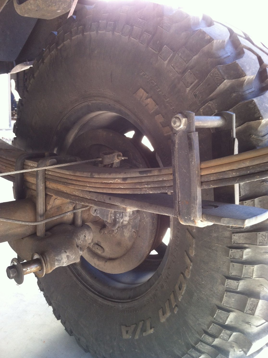

Shackle closest to the camera in the pic above is the full medium leaf pack. <br/>Shackle in the background has 1 overload leaf and the 3rd leaf from the top removed. Little better angle.
Old Mar 10, 2016 | 03:31 PM
  #153
Joined: Jul 2014
Posts: 134
From: Austin, Tx

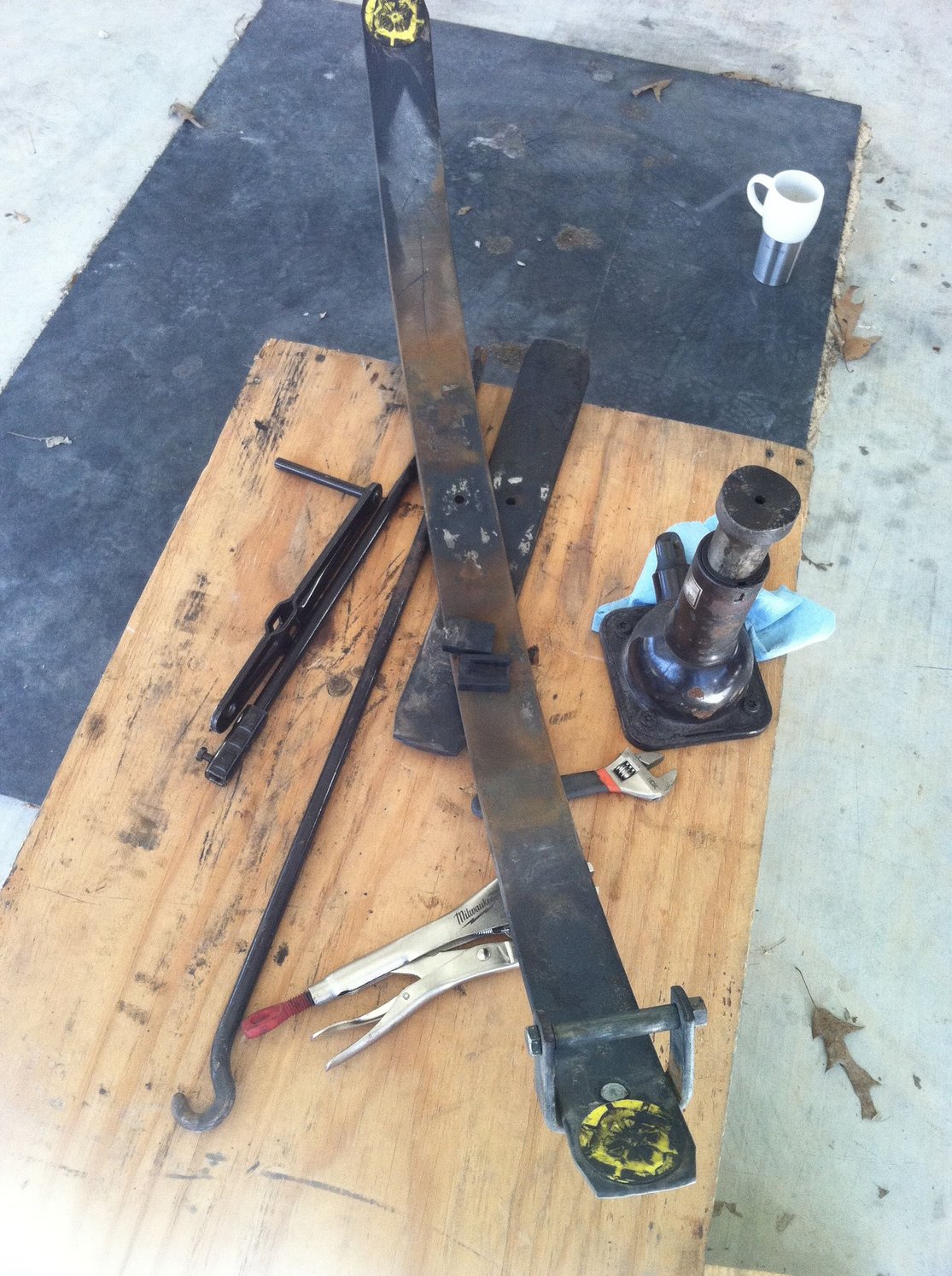

Springs cont
Taking it apart.
It was surprisingly easy.
Big one on the bottom and third from the top. Might reinstall the overload when I get longer shocks.
Old Mar 10, 2016 | 03:33 PM
  #154
Joined: Jul 2014
Posts: 134
From: Austin, Tx
I took the whole pack out on the driver side to disassemble and remove 2 leafs.
After doing that I realized the springs could be removed while still installed in the truck.
Saved myself some time and work on the passenger side.

Before and after
First pic is full pack
Seconds has 2 removed

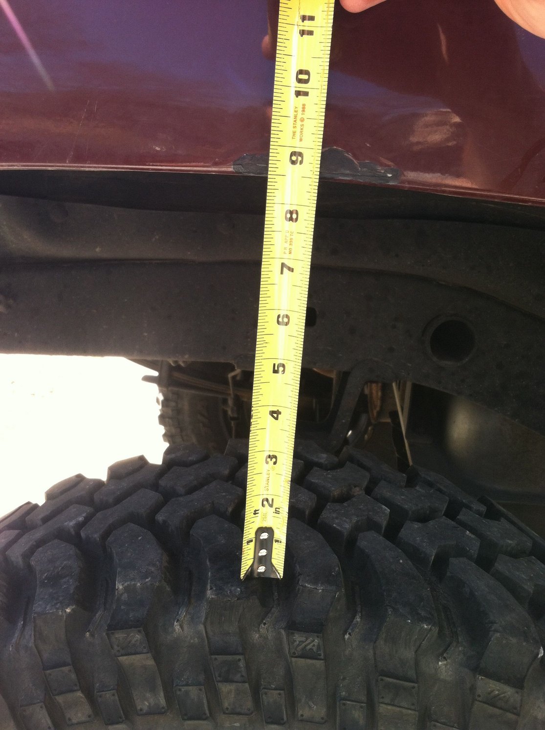

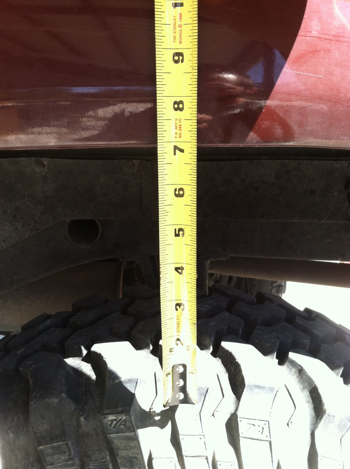

Measurements

End result

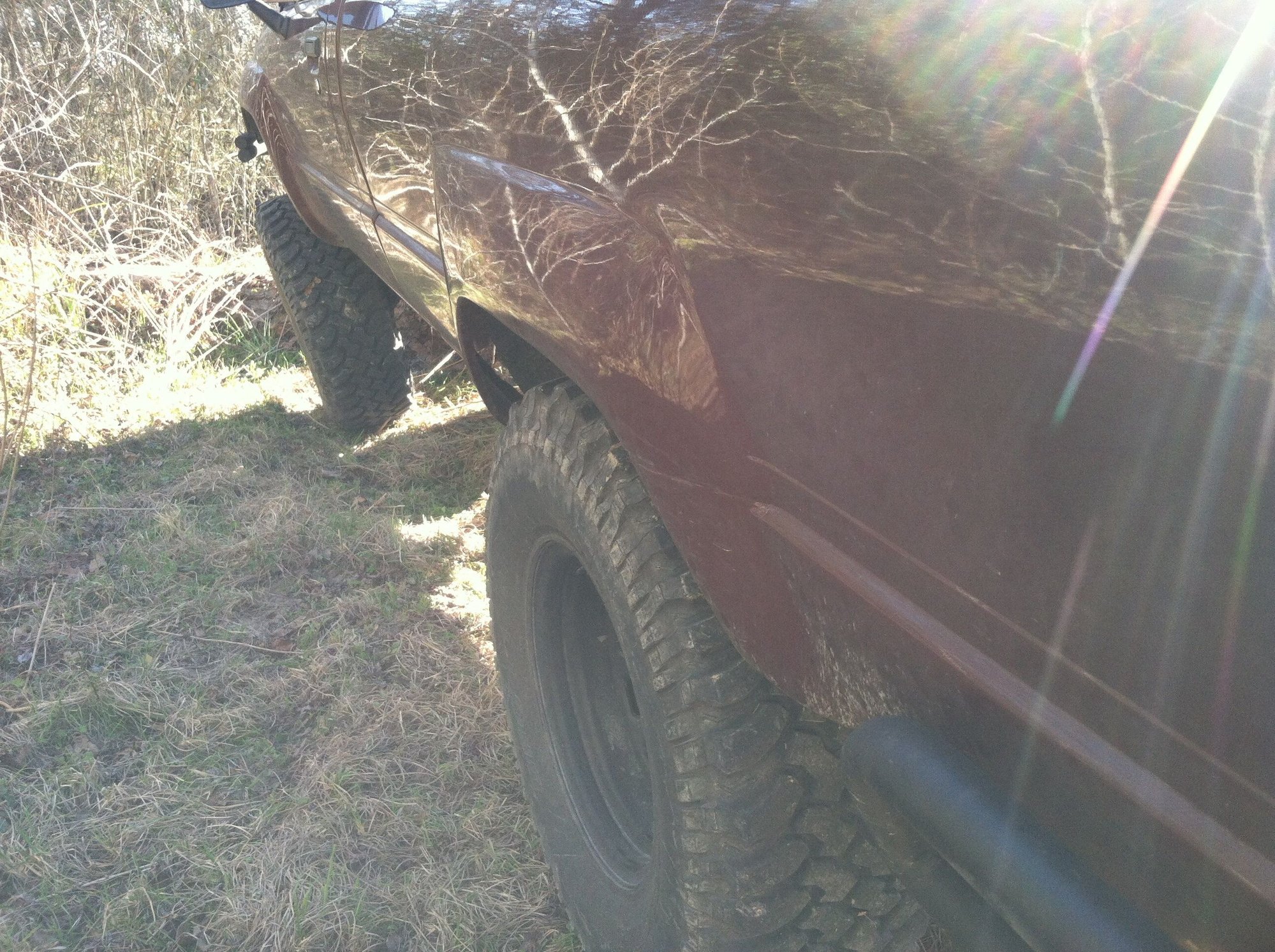

Lowered 1.5" and much softer.
I think it will sit fine and maybe be a little softer with my camper shell and some tools in the back.
But I usually drive around unloaded.

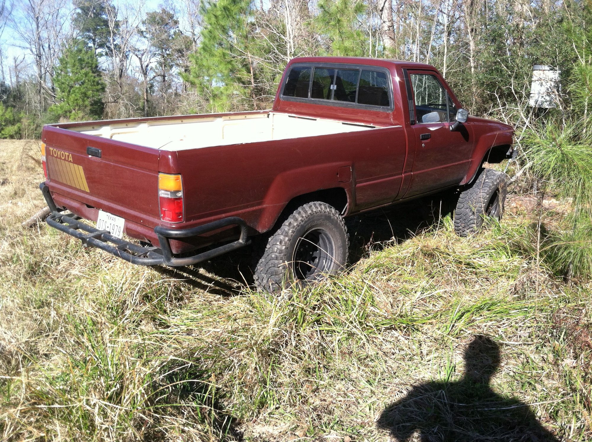

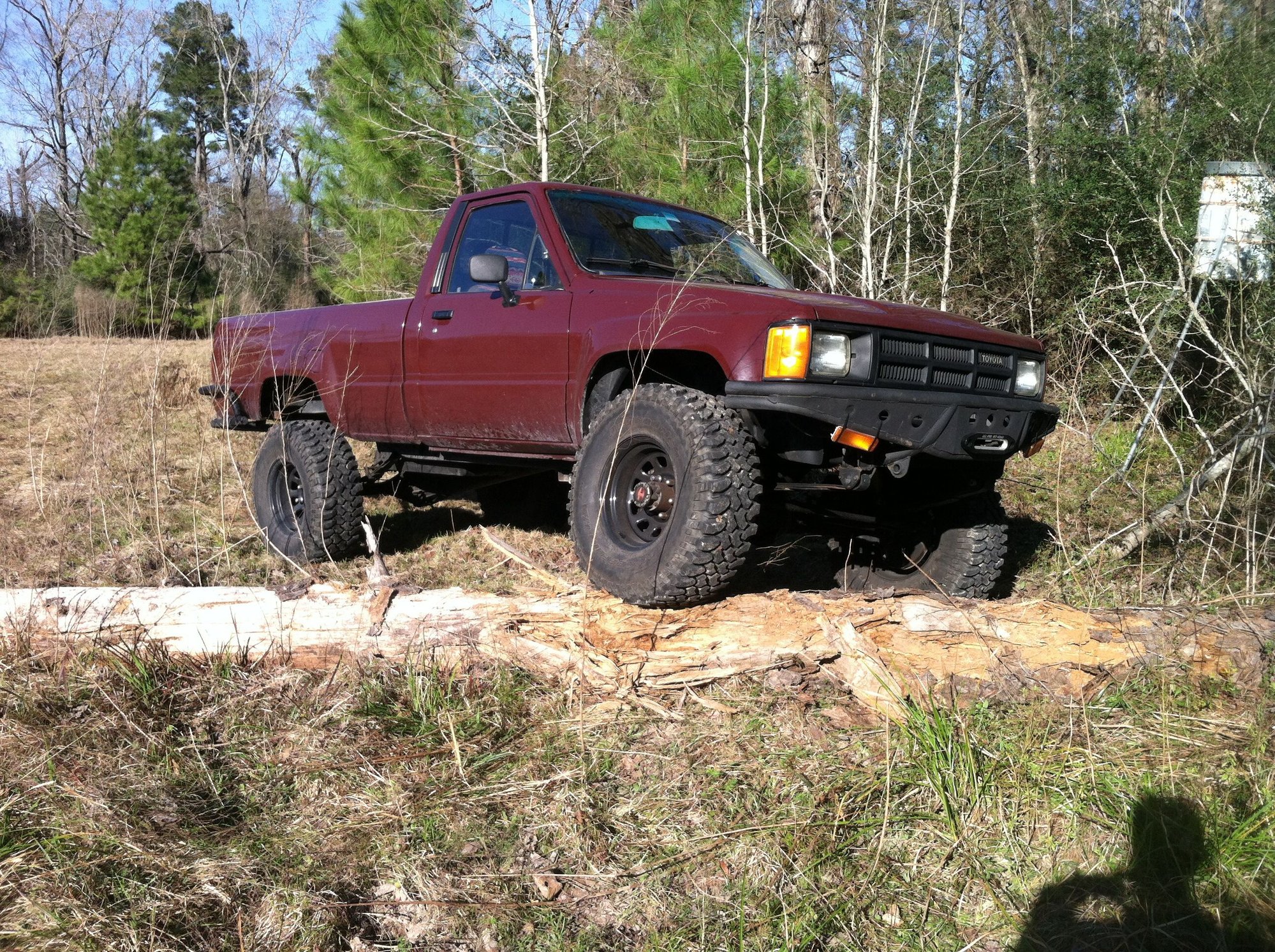

Flex pics
Testing out the new set up on a log.
Rear shocks are not installed in these pics. They are too darn short and constantly top out after bumps. And completely restrict droop.
