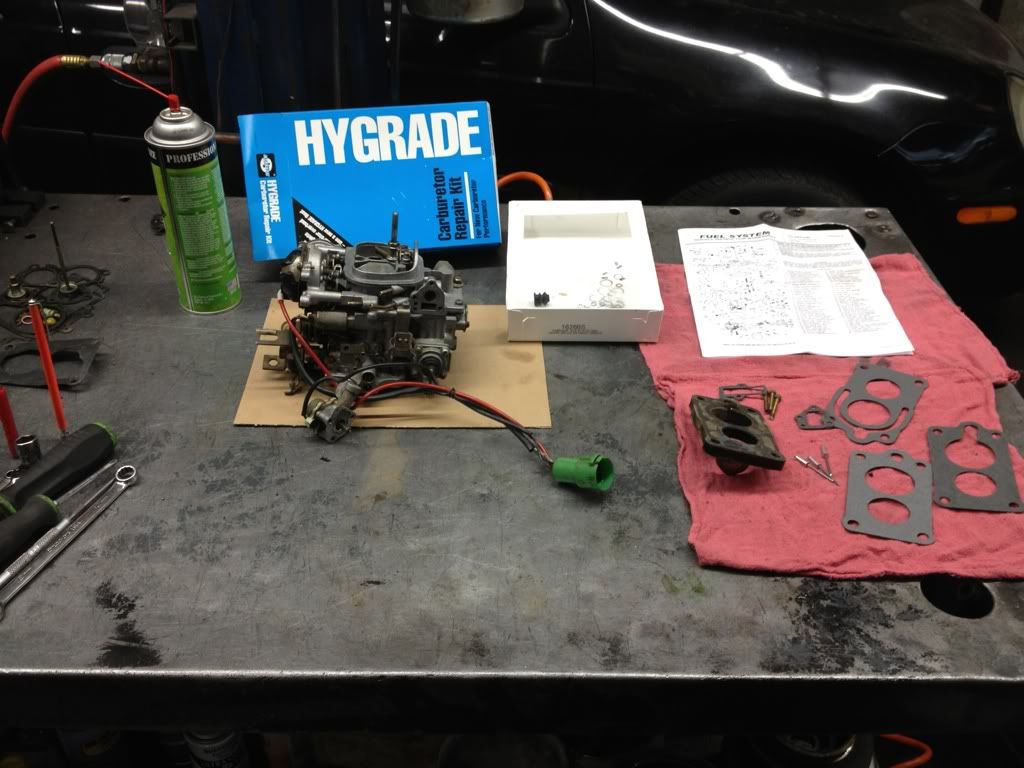

Broke down and rebuilt the carb today. Ordered the brand (standard)kit which was told the best most complete kit. It worked out good except the fact it didnt come with a bowl vent solenoid diaphragm ! Came with a gasket and rivets but no diaphragm. I air checked it and it works so o well it will do. Just need a fuel pump and fuel amd she should fire up.

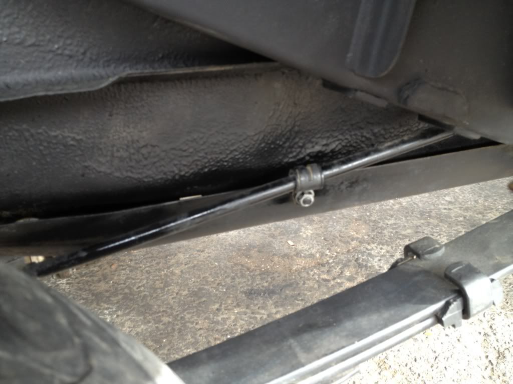

So I got my radiator back in and full of fresh coolant , new power steering fluid, front shock towers cut off frame , the rest of the frame wire wheeled & rattle canned , ebrake line mounted on gas skid , and fabbed up a quick coolant resivor mount. Ordered my fuel pump / pump spacer / fuel filter / motor oil & filter / PVC / air filter , should have it all tomorrow morning. Also placed a order for a few lil things from trail gear which should be here by wednesday. Getting pretty stocked to get this thing to move under its own power again. Although I still have lots of work before I actually wheel it. Heres a few pics nothing special.
Frame painted
The ebrake cable mounts on stock rear spring hanger , since I put the 63s in and cut out the old hangers I had to weld a bolt to the gas skid plate and use a nut to mount the hanger so the cable wouldn't be flopping around.

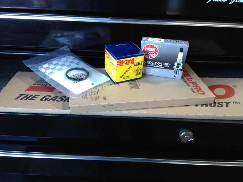

My trail gear loot came. Extended brake lines , extra line mount and clip , and 4 frame bushings for front shackles.
Also ordered a intake manifold gasket set , valve cover gasket set , NGk vpower spark plugs , and thermostat. Hopefully have time this weekend to install all these things.

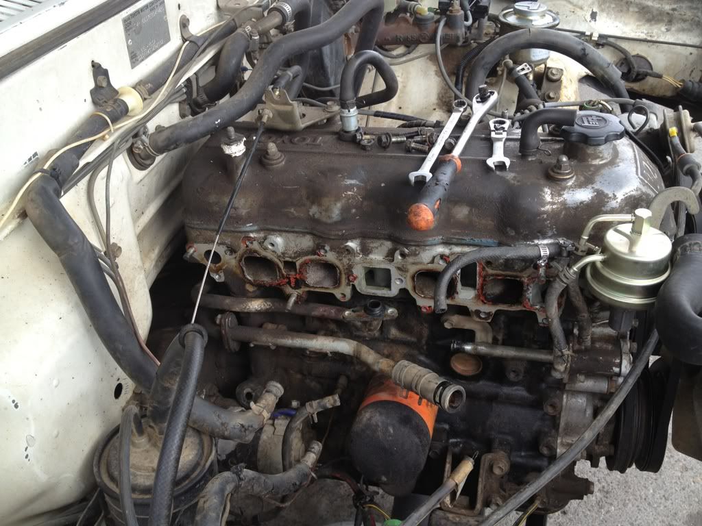

Didn't get a chance to do anything this last weekend. But thankfully i have a cool boss who allows me to store my projects at the shop so i can wrench on them on my lunch breaks. I got the intake mani off yesterday , and cleaned up the surfaces to get ready to install hopefully tomorrow. The last owner obviously thought a hundred pounds of silicon would be better than a gasket lol. Also got my extended steel brake lines on and blead, no pics yet.
If all goes well it will be running again tomorrow , and hopefully better now without the huge vac leaks. Still gotta put new seals on valve cover and paint or polish it, and put in new thermostat and plugs.

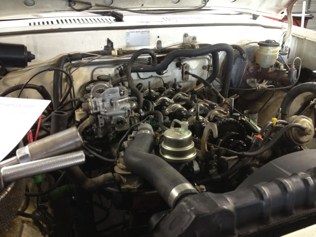

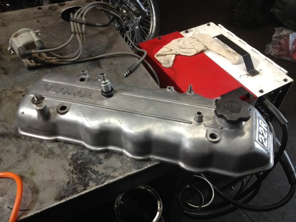

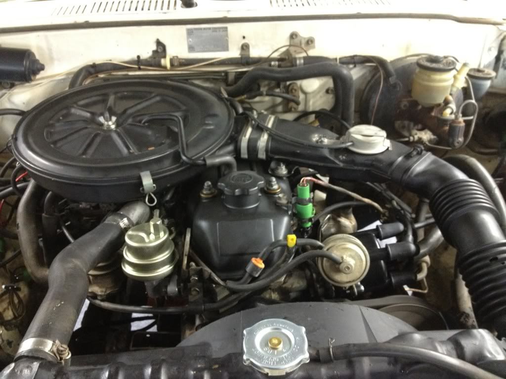

Got to the shop for a few hours today.
Adjusted valves
Parts washers make cleaning stuff easy
Plug wires , NGk plugs were installed, cap, rotor
Painted cover , new gaskets and grommets , pcv
Air clean assembly put back on with fresh filter

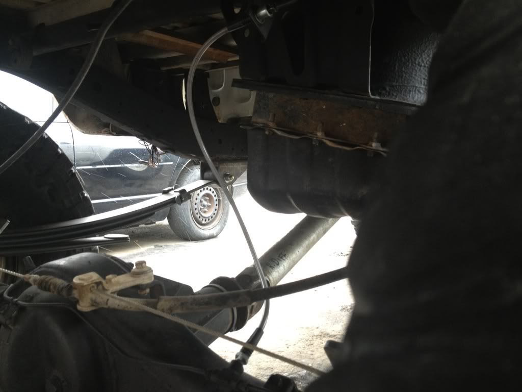

Few shots of the extended brake lines
Rear
Runs pretty good now . Just need to get a timing light on it and set timing.
