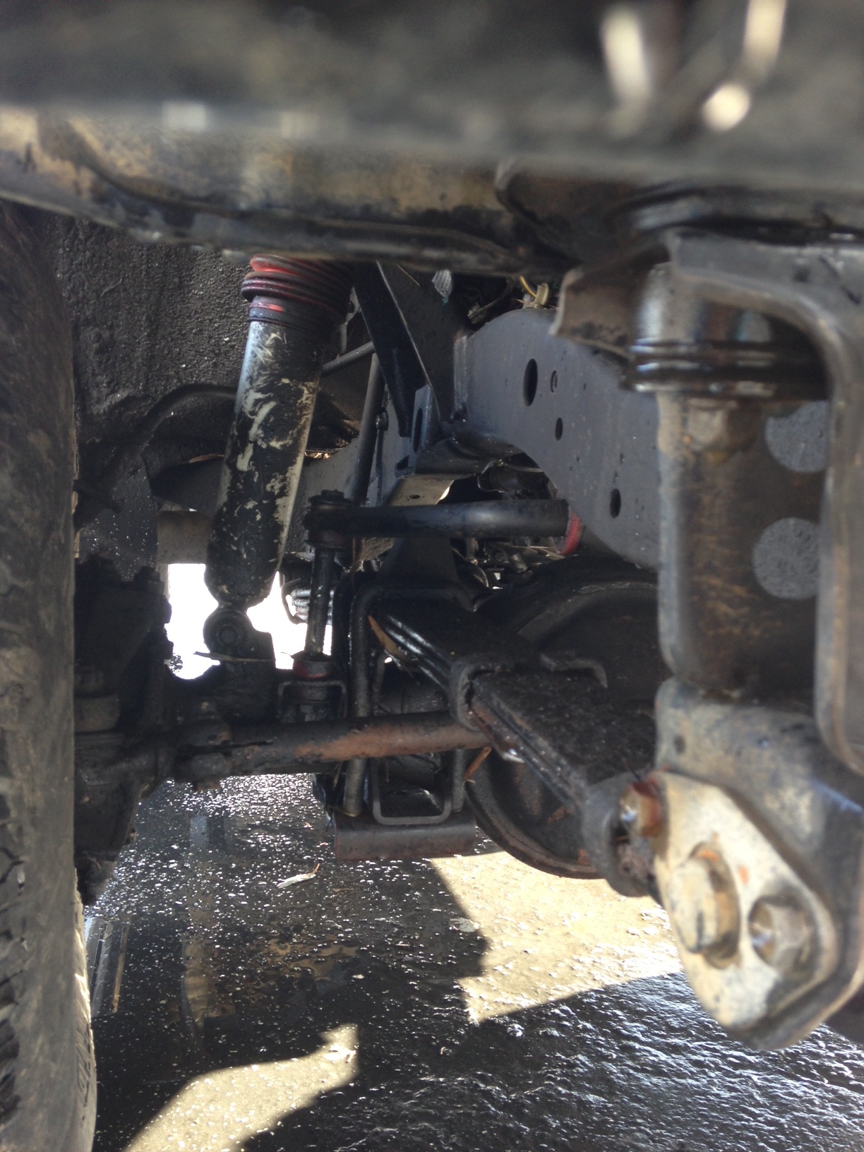

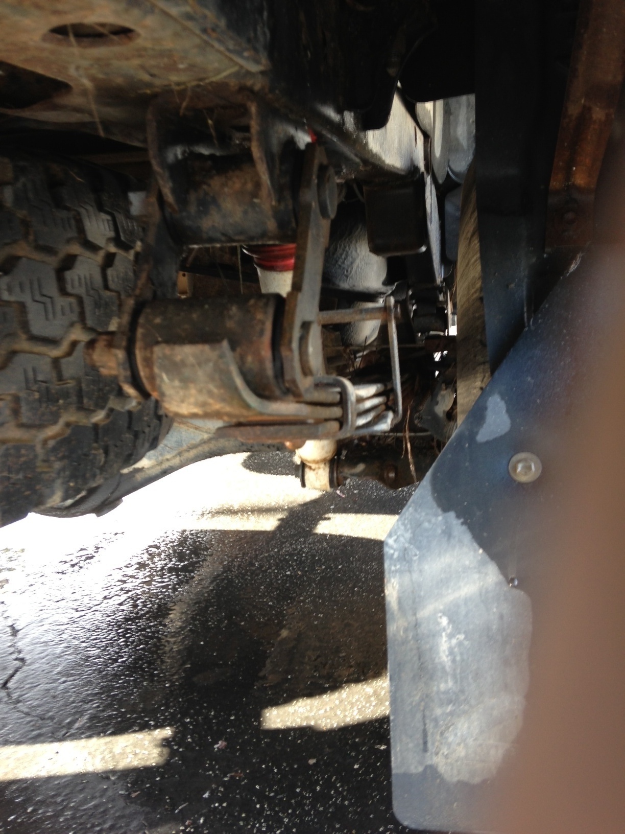

It is finally time (with funds) to bring the Yota to it's previous glory, with upgrades of course. Goals are to have a solid truck for camping, snow, desert, trips in and around California. Currently it has a saggy suspension and 250K on a questionable motor. I have decided to do a full OME Dakar suspension and rebuild the motor with ENGNBLDR components. I live in the Bay Area, Peninsula, and wanted to keep the work done local. ARB has one official distributor of OME products and it is Les Schwab Tires in San Carlos. I'm having them do the whole install and alignment of the suspension as I do not have a garage at this time. Here is a break down of the cost.

I know some of you will cringe at having to pay someone to do a simple weekend job, I know I do. But there is nothing I can do about it. I'll post before and after pics when I take them. Hopefully I'll have her up and running before end of January...

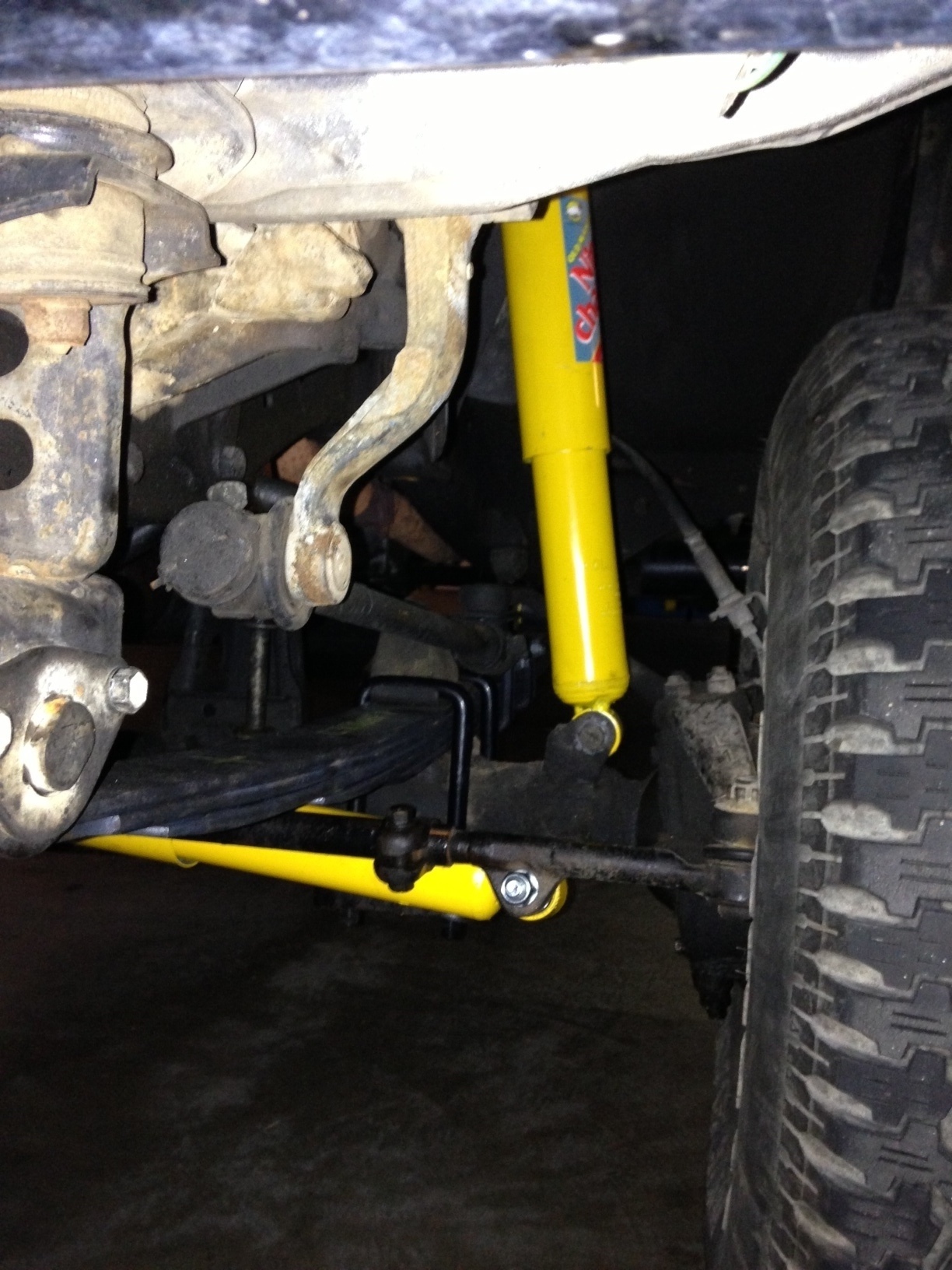

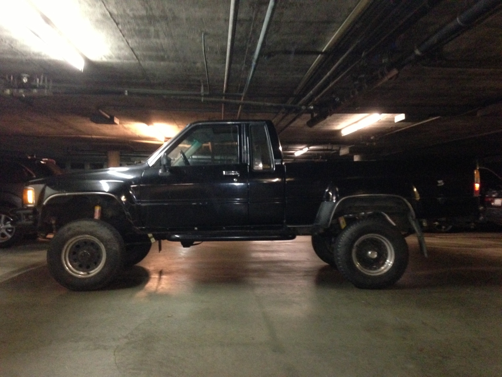

Here are the Post OME Dakar lift pictures. It sits much higher than before due to the saggy leaf springs. One issue is that the left rear sits higher than right. I'm hoping some flexing will sort this out.

Hey MTB,
The ride is MUCH better than before. The front was sagging so much it was hitting the bump stops constantly. I'm still getting used to getting in the truck, it is higher than before. I can imagine the driver seat material beginning to wear out. I think I need to flex it some for it to settle.
