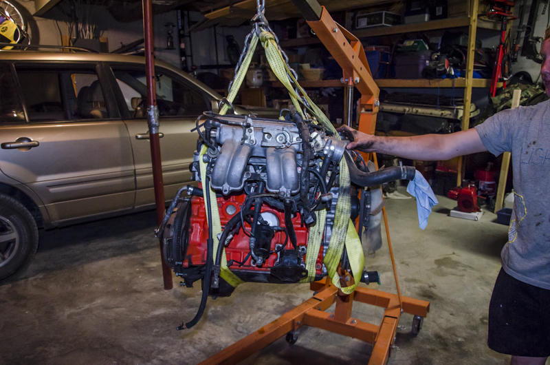

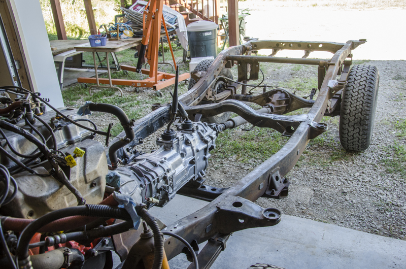

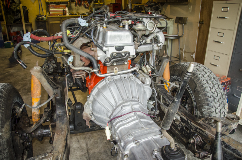

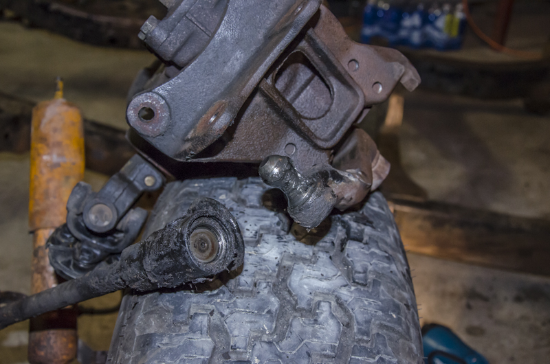

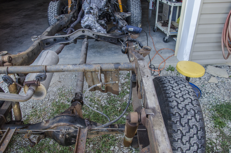

Removing engine and transmission
The other day I pulled the gas tank, some break lines and fuel lines, and the exhaust.

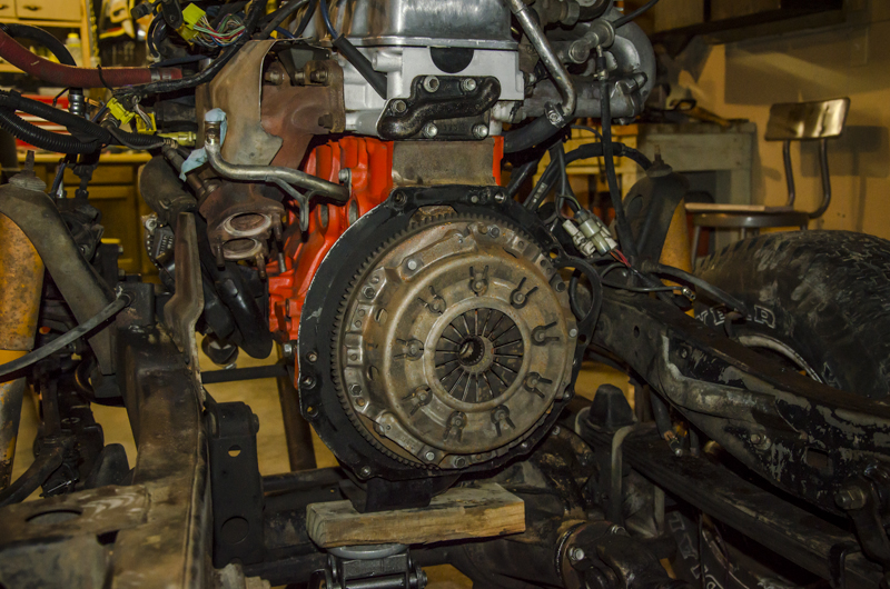

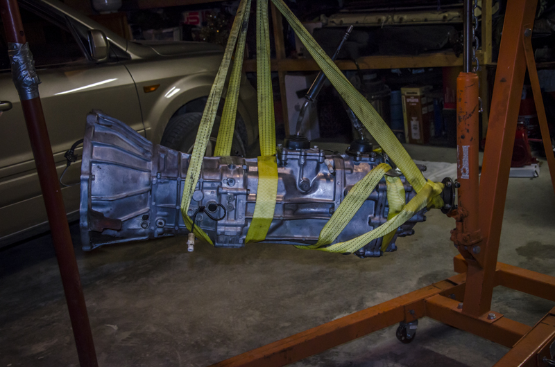

Yesterday we took off the engine and the transmission.
I was also wondering if it would be a good idea to go ahead and replace the clutch disk and all that. And how hard it would be.
That is about as far as we got because the transmission took around 2 hours to do which was way longer then I thought it would take.
Old Sep 6, 2013 | 06:36 AM
  #31
Gizler00's Avatar
Joined: Aug 2007
Posts: 3,276
From: Pennsylvania
Looks great!!
I would most definitely replace the flywheel(or machine it), and get a clutch kit if you have the money. You dont want to go through all this work and have a clutch fail after its all back together.
I would also suggest that you replace the rear main seal as well as the trans front seal.
Save you alot of headaches later on.

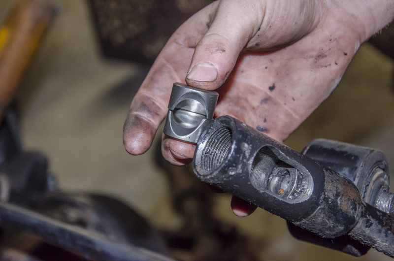

Today I started to take the diff off but got stuck on the leaf spring bolt. Do any of you have any suggestions to get it out

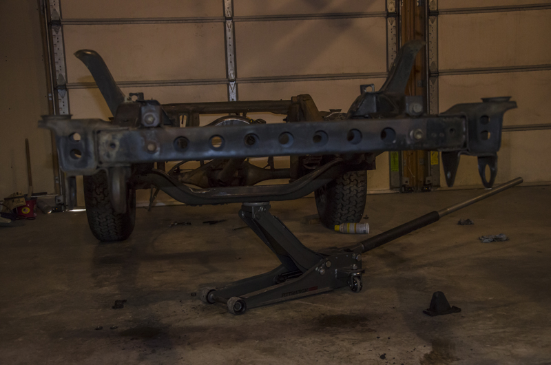

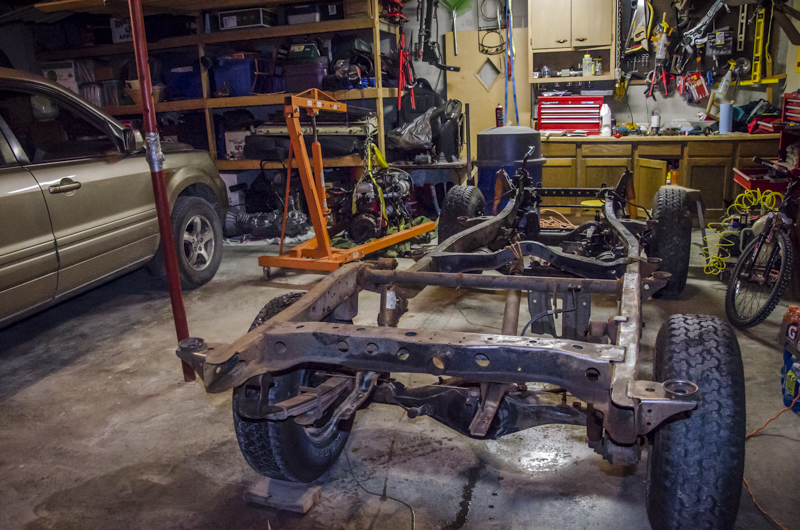

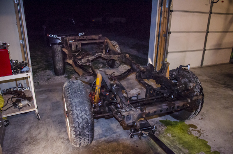

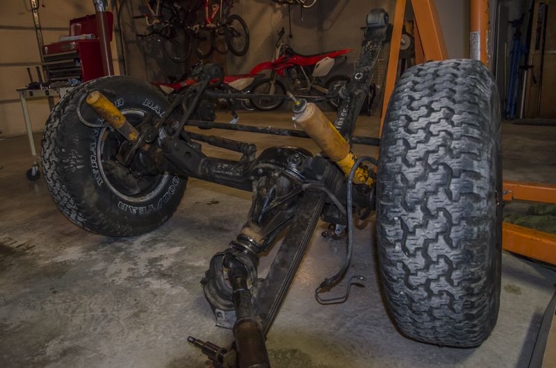

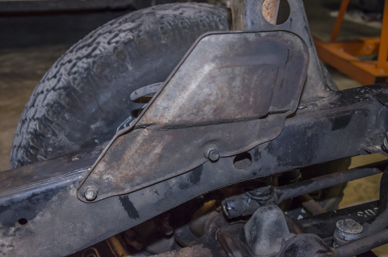

Getting frame ready for sandblasting
Today got a little bit done. We took everything off the frame to get it ready for sandblasting.

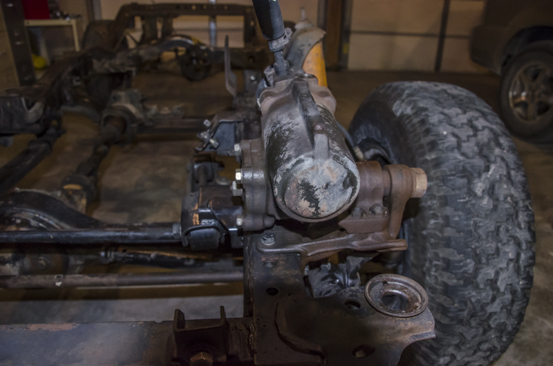

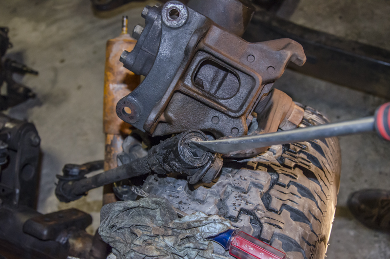

Took steering box off

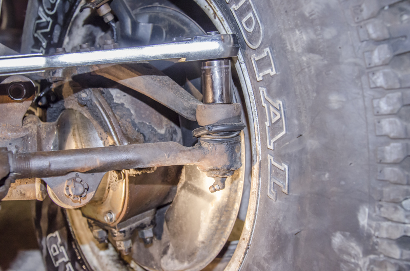

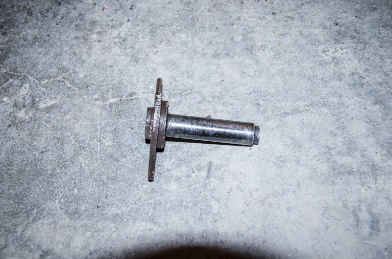

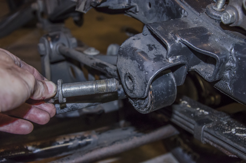

Now on to the springs. They took for ever to get off. The first one we cut off. Then we heated the rest with a torch.

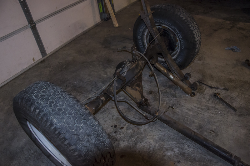

We had to cut 2 of the 4 ubolts to get the rear diff off.

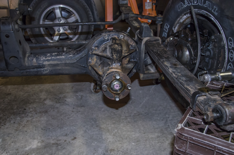

Then we started to take stuff off the rear diff.
After we got everything off the rear diff we started on the front.
And that is as far as we got. Do any of you have suggestions on what i should replace while I have the body off. Also do any of you know of a good around 3 inch suspension lift kit that would be a direct bolt on.
