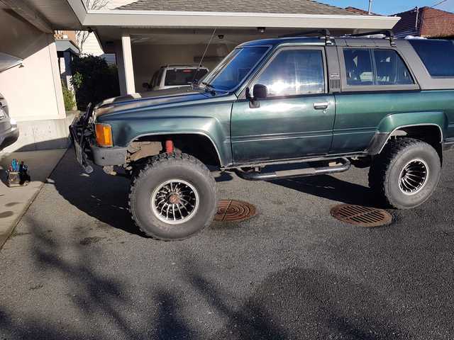

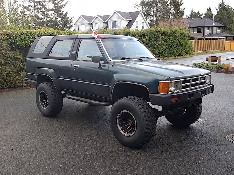

I’ve been looking for another Toyota since moving here and came across one right here in Comox. It’s an SR5, is the first year of the 22re and has 393,330 km at time of purchase on 12/30/17. This one has a fairly fresh rebuild and injectors, driveline seemed pretty solid on the drive home and has a good, solid frame and floorboards. I have a few issues to take care of:
Battery/brake light came on (dead alternator) when I was driving it home last night
Clutch needs to be bled
Has a small exhaust leak at the manifold, I noticed a broken stud today
Heater blows good, not a lot of heat
Lots of wires under the hood that have brittle casing, need to replace them
Horn doesn’t work, probably the pin not contacting the horn ring like my last Toyota
Interior is what you’d expect for a 30 year old vehicle, I’m on the hunt for a donor vehicle
Speedo, tach and all the gauges work - even the clock - but no dash lights.
Wiring looks terrible
Seats are decent, I want newer ones without 30 years of farts in them
Tires are mud tires and sound like it too, they need to go. Replaced with 33 x 1250R15 BFG KO2s

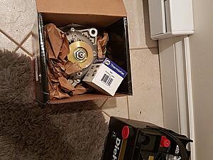

Parts

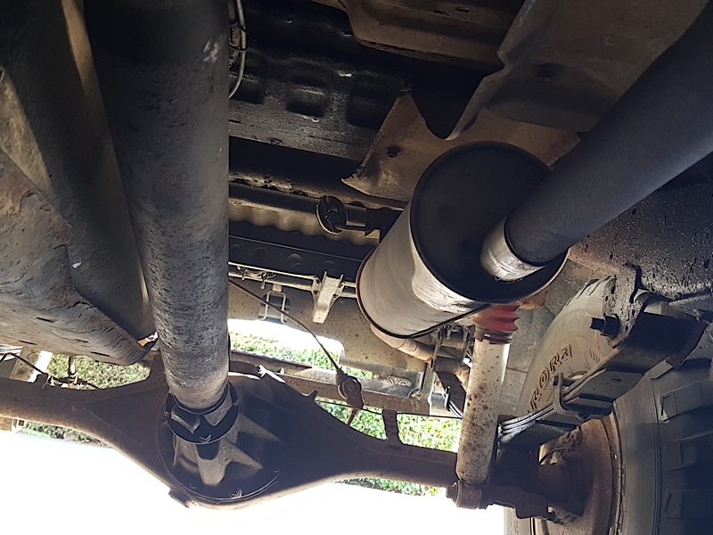

Tracking down the exhaust leaks. 2 broken studs, the rest of the nuts were pretty loose. Also no muffler clamp just before the muffler, picked one up today

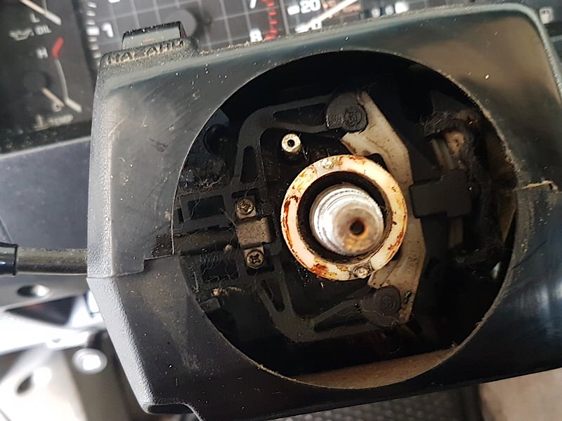

Horn doesn’t work, took the steering wheel off, cleaned both contact surfaces and used some dielectric grease and horn works.

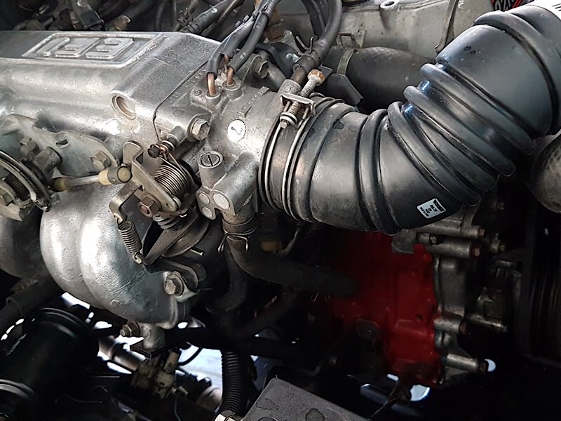

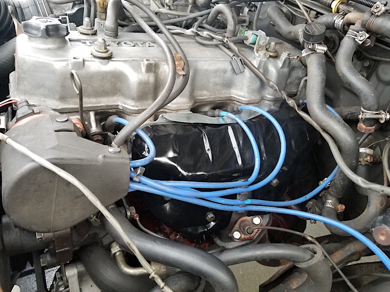

These vacuum lines were not routed properly and idle has been terrible. Google has a good vacuum diagram, all fixed.

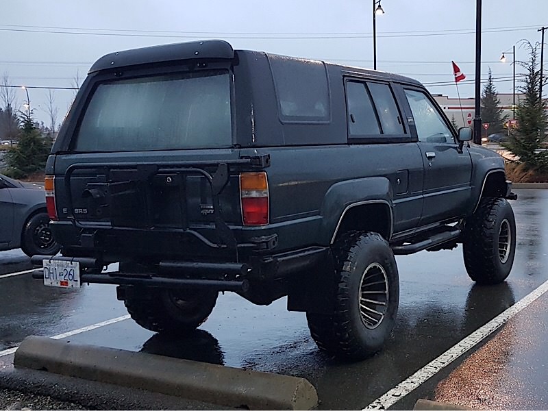

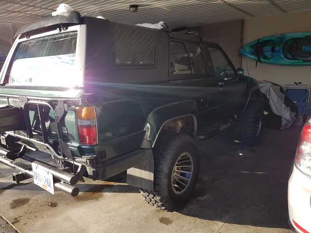

On your pathfinder rear tire swingout, I would recommend pulling the interior panel on the right rear quarter panel and see how the original owner mounted it. if done wrong you will end up with cracked sheet metal
You don't have to have a rear license plate light?

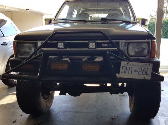

Front bumper is a valiant attempt by someone to fab one up. The welds are terrible and it’s crooked. I’ve removed the square led lights and the taped together wiring, next is the fog lights/wiring and then the bumper. I’ve ordered a rear license plate holder and light from amazon.

The previous owner has the original SR5 chrome wheels, and a spare tire in their shed which I haven’t picked up yet . And another hood with a scoop almost as wide as the hood, it looks ridiculous.

Is the tire carrier's bolted to the quarter panel?
Old Jan 21, 2018 | 10:40 PM
JohnnyCanuck's Avatar
Joined: Feb 2012
Posts: 699
From: Vancouver Island
Yes it is.

Exhaust leaks - gone
We are getting ready to move to Campbell River in may to a new place so I haven’t done a lot to the 4Runner. One thing I took care of is the exhaust leaks - and there were lots - and it sounds great. I ended up buying a new manifold, all new studs, exhaust manifold gasket, flange gaskets and a heat shield which was missing from the old manifold.

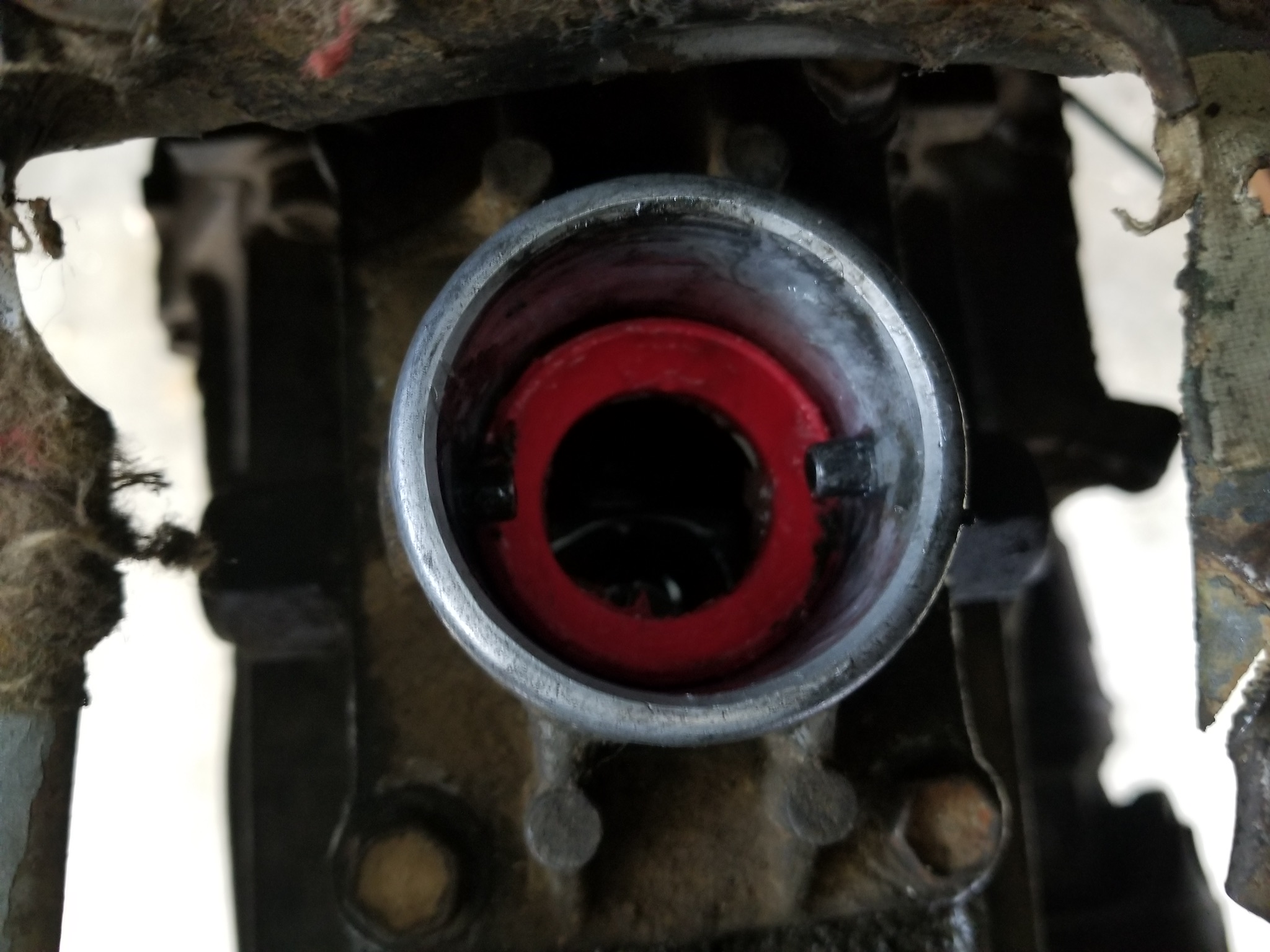

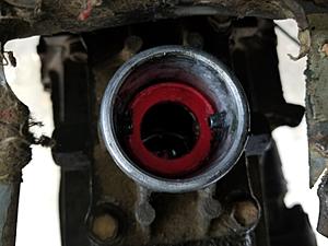

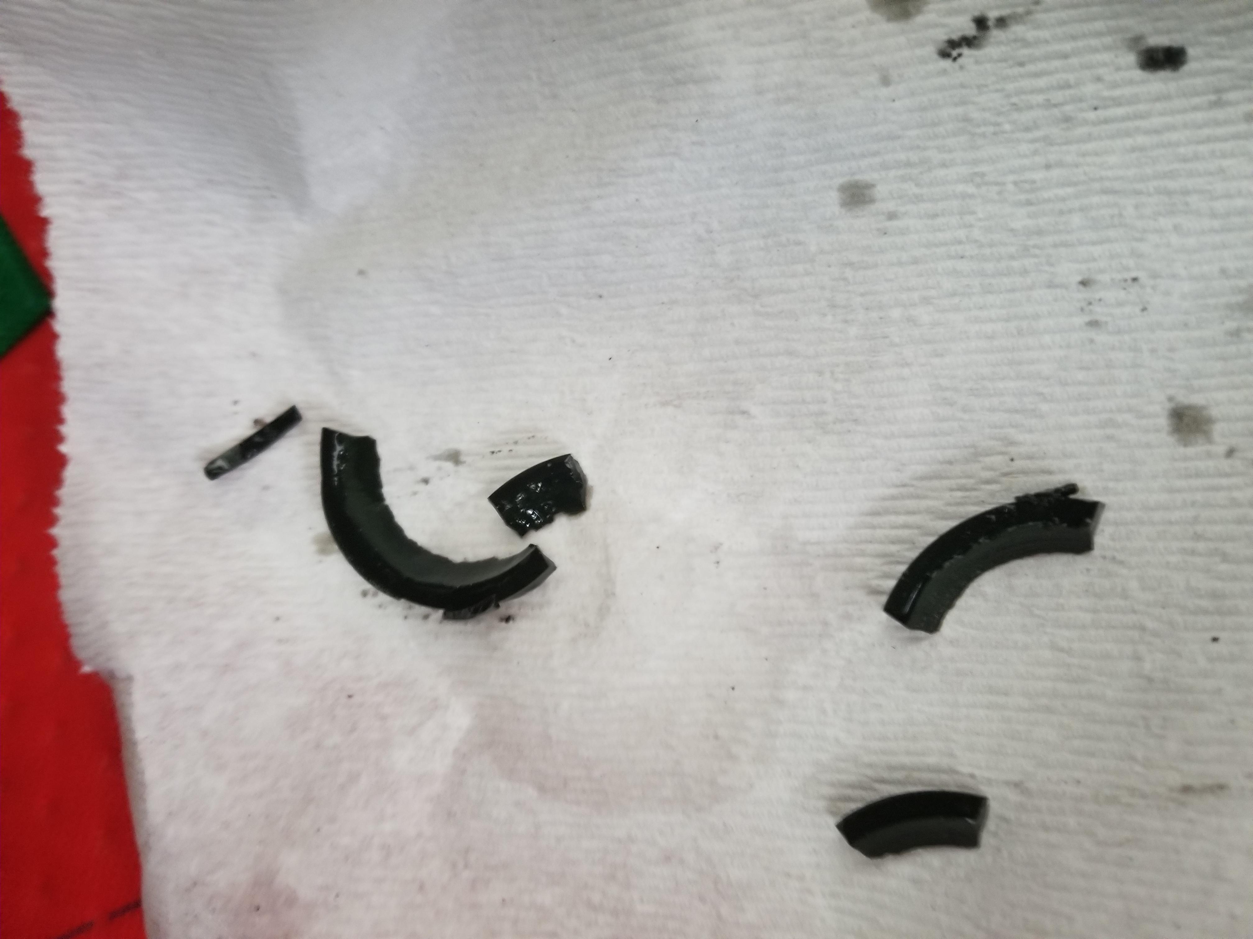

Did the Marlin HD shift lever ball seat and lever socket, 2nd Toyota I’ve done this on. If you’ve never done this; do it.

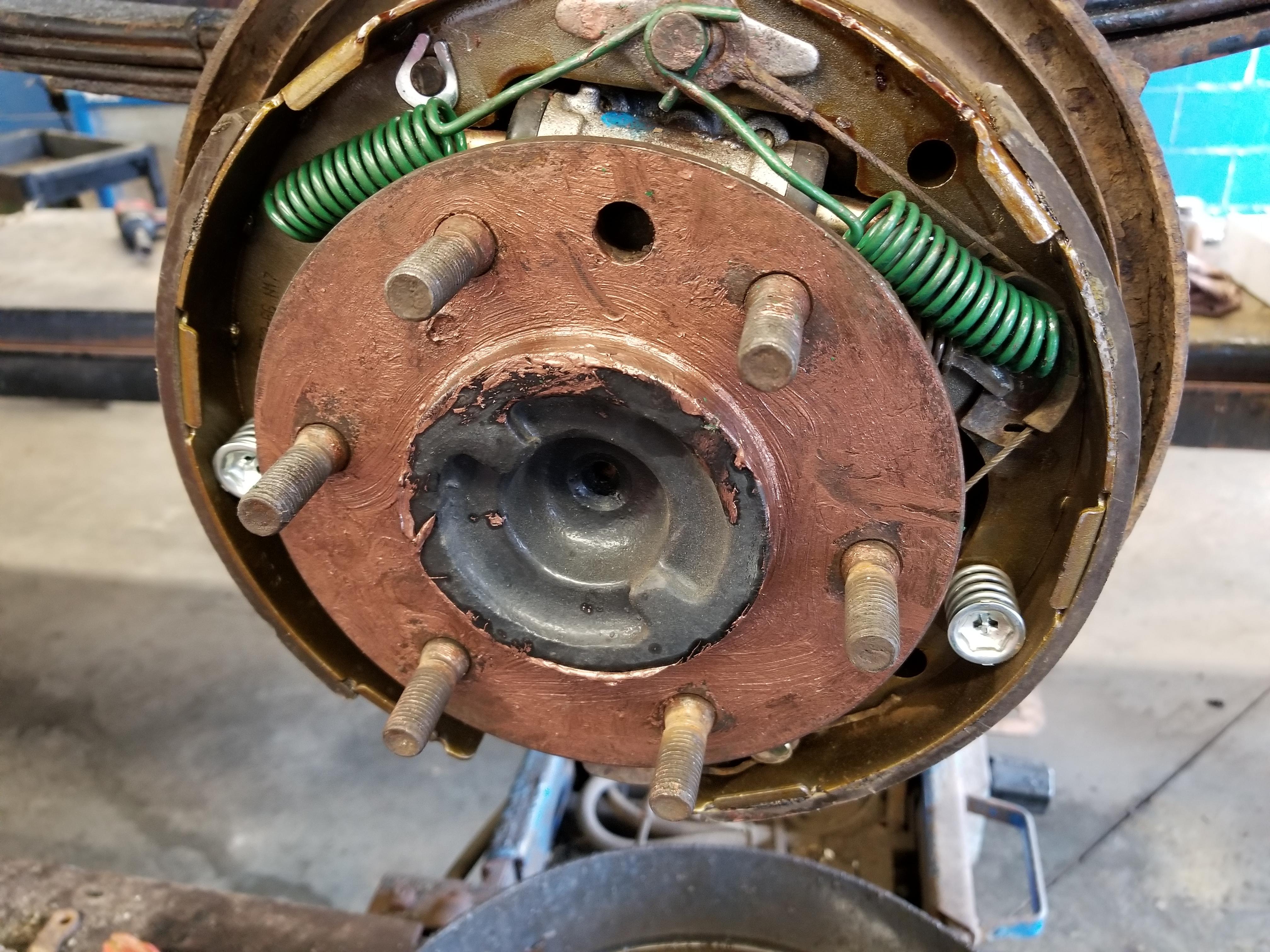

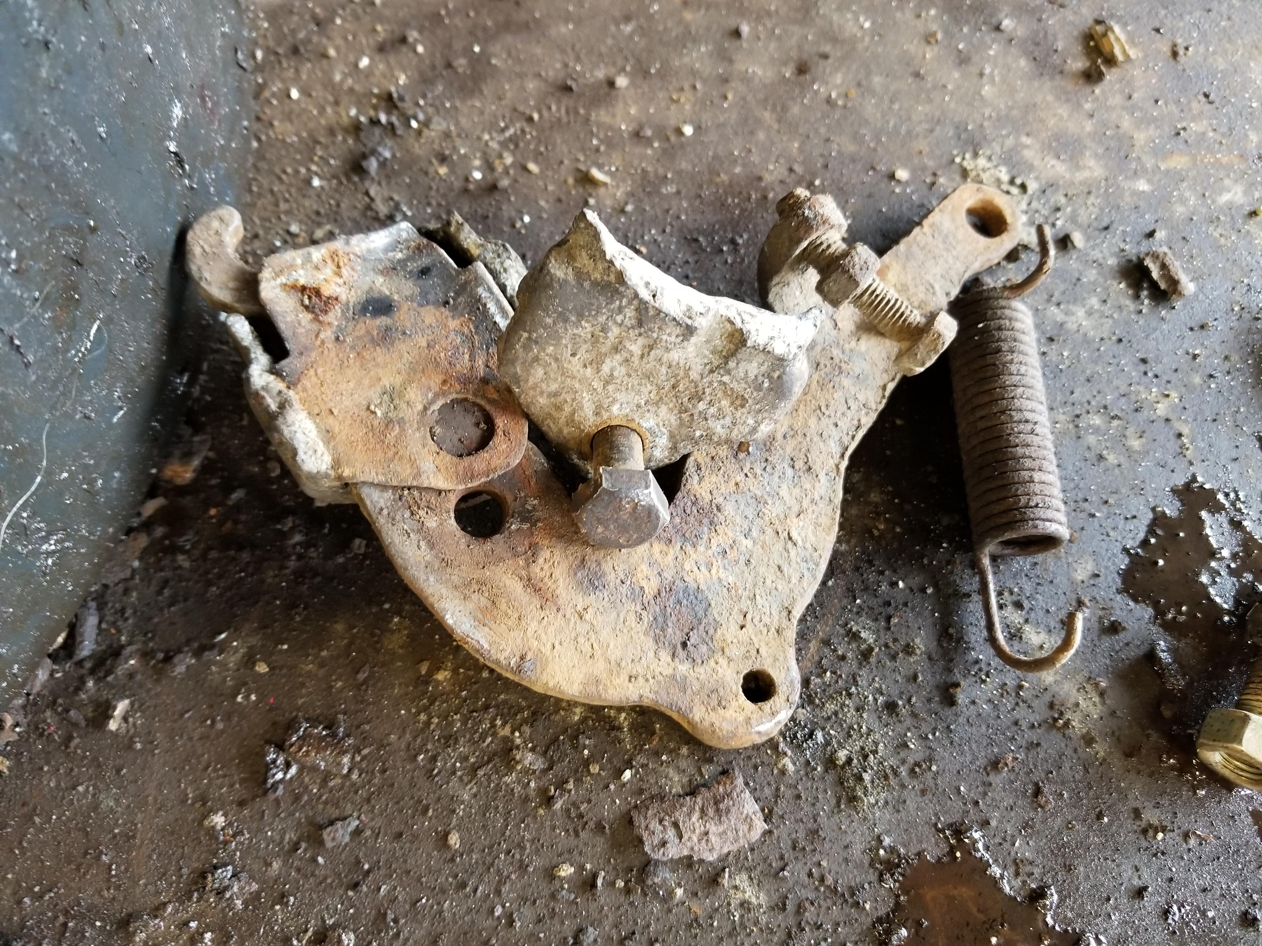

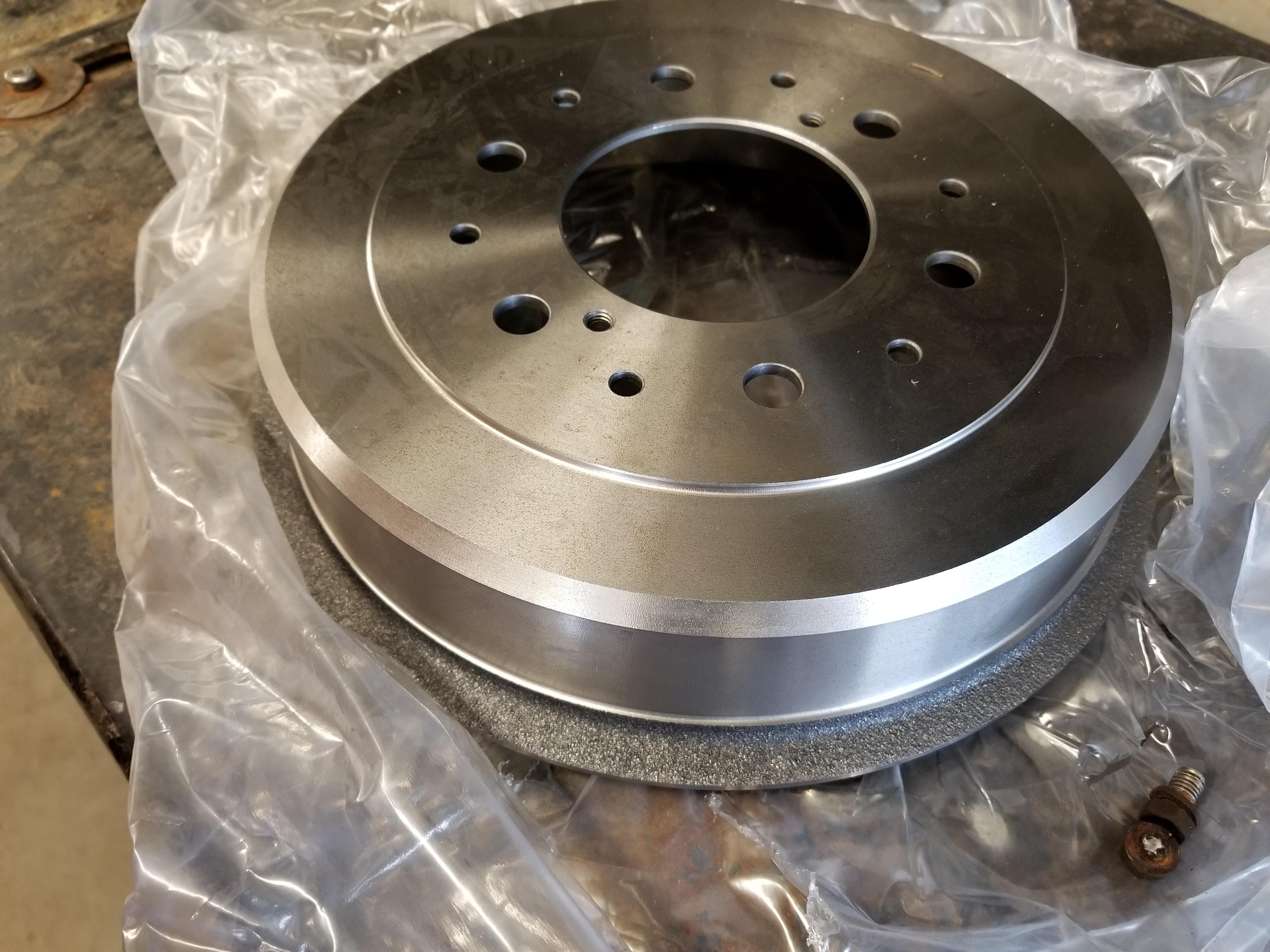

Tackled the rear brakes, bell crank was busted inside the LR drum, scavenged one from a local fellows spare rear diff. New drums, wheel cylinders, hardware kit and lots of anti-seize
