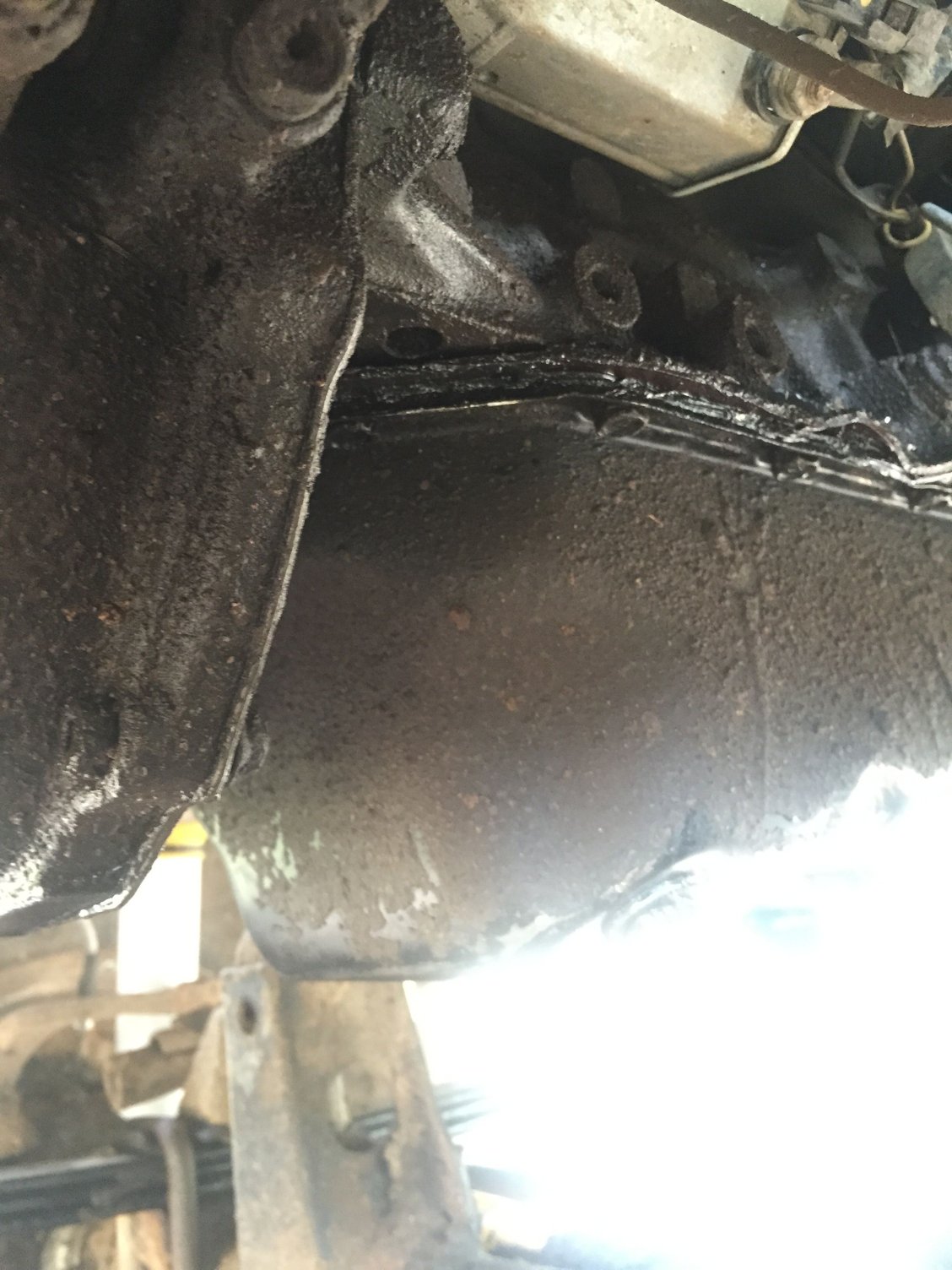

I was taking out my driveshaft to prepare for changing my diffs and noticed this bracket on the driver's side that bolts the engine to trans.
And here is the passenger side where it looks like there SHOULD be the same thing.
I'm not sure what its called so i've had a heard time searching about it or ordering one.

Found it, its called a stiffener plate in case anyone else needs to know.
[edit] I installed the plate but the bolts into the engine block started to tighten then slipped...I am guessing this is why there wasn't a plate there before. So I guess I need to figure out how to get some helicoils in there
