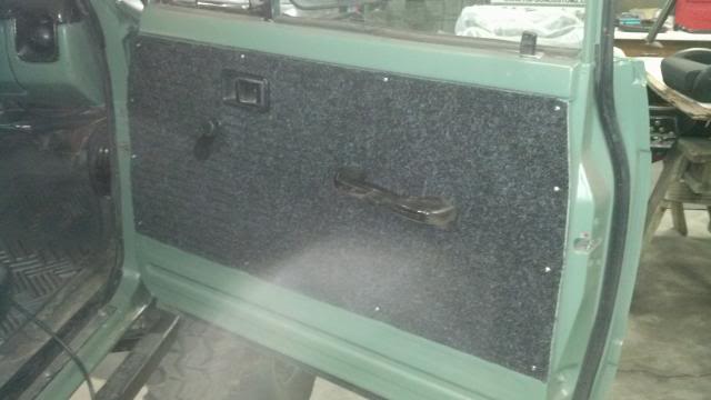

Haven't been able to do much on the truck or anything else for that matter.. But I did get started stripping the interior so I can put the cage in and I made some cheapo door panels... I wanted something waterproof and would be easy to clean..
I think it came out good and reduces road noise.....

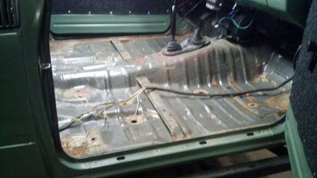

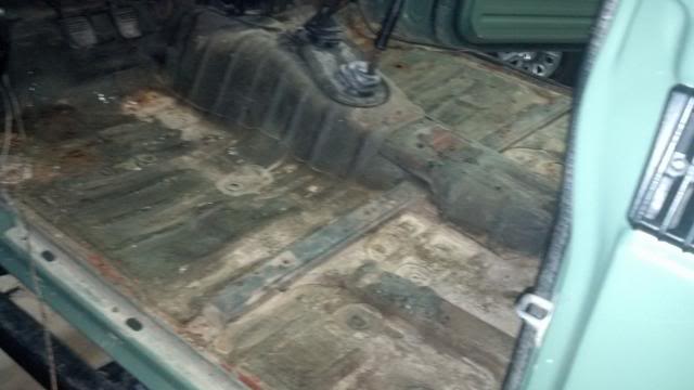

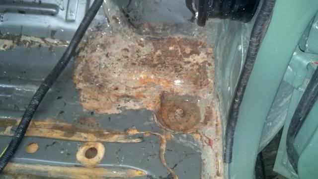

I also started getting ready to put the cage in..
Took me about 3 hours to get the interior stripped and the factory sound stuff off.

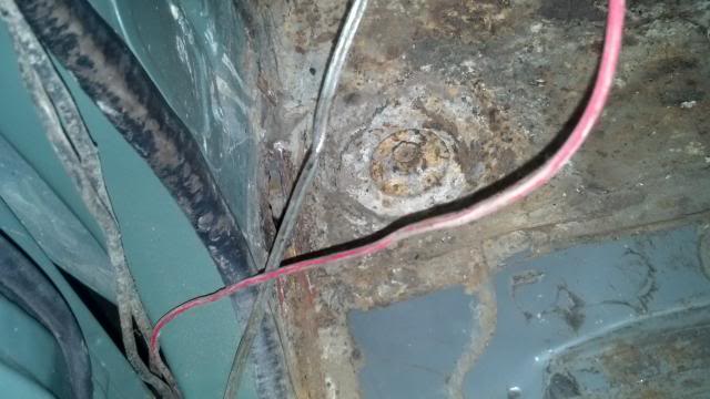

There are a few little spots that need some attention, but not bad for a 30 year old truck.
I have a few days off, so I am going to get the floors cleaned up and start on the cage..

From: Calistoga, CA
what did you use to remove the sound deadener?
Old Nov 23, 2013 | 04:35 PM
  #191
Toyota~Boy's Avatar
Joined: Oct 2006
Posts: 1,514
From: Kenna, WestVirginia
i used a hammer and flat spade to kinda chisel it loose on my 93 prior to doing a Bed liner interior
Old Nov 23, 2013 | 05:11 PM
  #192
gmack192's Avatar
Joined: Sep 2008
Posts: 522
This......I used an old wood chisel. I found that if you hit at a downward angle towards the remaining sound goo, it seems to come up easier..

Yea a wood chisel is pretty good for that for removing that stuff. I really like the door panels, they look good.
Old Nov 23, 2013 | 08:23 PM
  #194
gmack192's Avatar
Joined: Sep 2008
Posts: 522
Thanks.... Cheep and easy.. Just the way I like it.

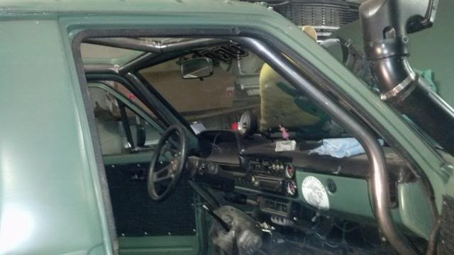

Woooooo-whooooooo
In spite of all the poo that has been going on in life, I actually got to start on my cage...
I just have it tacked in now, hopefully I can get it nailed in by the weekend.

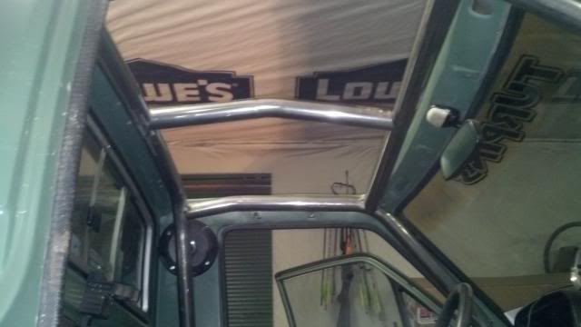

It is from 4XInnovations and it fit pretty good so far.

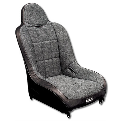

Ordered some different seats than what I had planned on... I am going for comfort.. and my poor old back...
Old Nov 26, 2013 | 02:22 PM
  #197
gillesdetrail's Avatar
Joined: Jan 2013
Posts: 803
From: Montreal, qc
That looks like a good mix between comfort and support, I like it.
