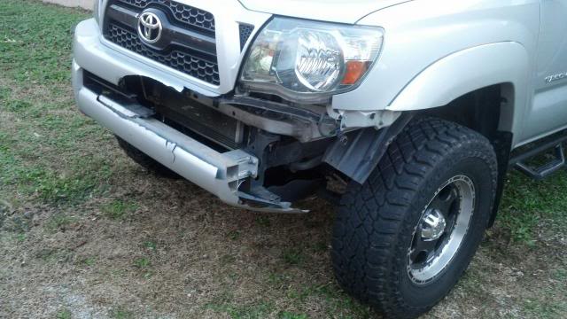

Heading home from work Thanksgiving morning, I am THANKFUL the buck didn't come through the windshield......

After going round and round with State Farm, the truck is at my "preferred" body shop..
And I found out, I don't have rental car coverage..Ugh

Glad your ok! That buck did some good damage too. I will have to check my insurance to see if I have rental car coverage...

That doesn't look all that bad considering what it could have done. I assume it is still driveable? I used to have State Farm too, they SUCKED!! I've never had a worse insurer

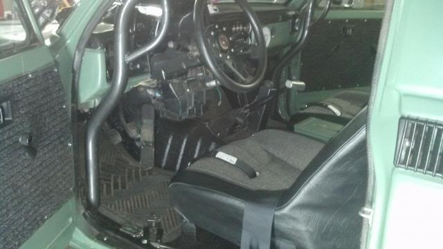

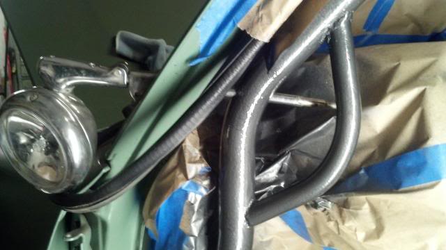

Anywhooooo.. I got the woods truck back together for the time being (until I figure out what I wanna do next).. Some pics of the cage, seats, and other little things I did over the past few days off.
I really wanted to keep my spot light, a life long friend gave it to me some 20 years ago.

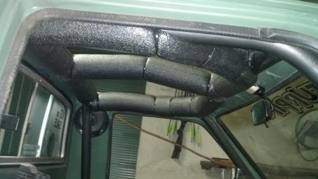

I also have a habit of hitting my head, so..........NOGGIN PADS

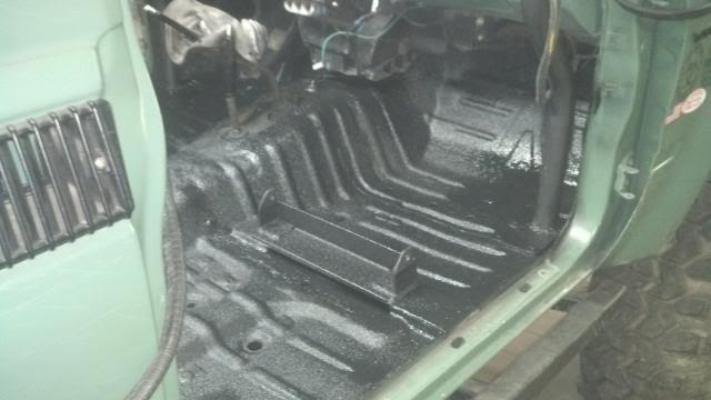

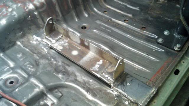

The seat mounts for the front, I have pins in the back, so if needed, I can fold the seats forward. The original seat mounts were a little rusty and there were cracks in the floor.

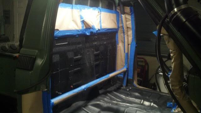

Taped off and primed.. with super duper $$$$ primer..
I used Raptor liner, 3 bottles, I think it came out pretty good... If you ever decide to do this, make sure you specify BLACK... I was sent the tintable. Fortunately the lady at Lowes saved the day and tinted it for me. FER FREE.

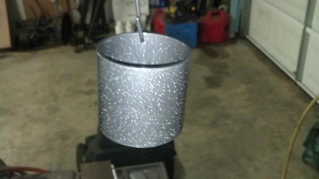

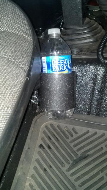

When I got the seats in, there was not enough room between them for the lockbox/cupholder combo I had before. So I had to come up with something else.. 3 inch PVC couplers (CHEEP)....Painted with Rustoleum Hammered Black

2 self tapping screws and whalllaaaa...Cup holders, well water bottles any how.

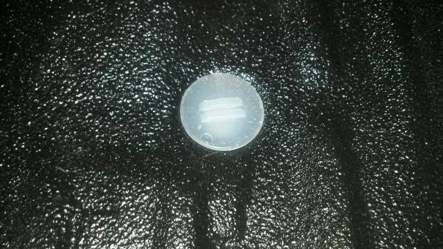

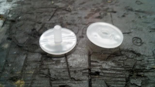

One other little problem I had, all the rubber drain plugs were hardened up and brittle.. So I had these little plastic things that held the flap disc I used to the cardboard they came on.. Also from Lowes
They screw together nice and tight and are easy to remove to clean out the floors..

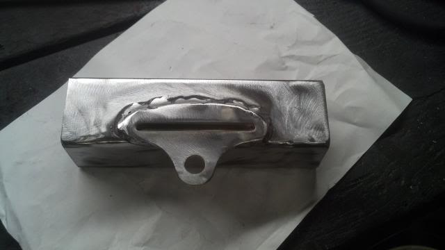

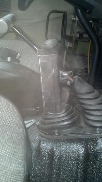

Another thing that has been bothering me is how easy (and how many) it is to steal one of these trucks.. See it all the time on here, Pirate and Marlins forum... so I came up with a CHEAP, EASY, and SIMPLE way to at least slow down a thief... I HATE THIEVES...
I took a piece of left over square tubing, (just happened to be the right length) and welded a left over seatbelt hold down to it.. Then painted it with, you guessed it, Rustoleum Hammered Black...
I just slide the tube over the T-case lever and pad lock the transmission shifter to it... and PRESTO the levers are locked together.

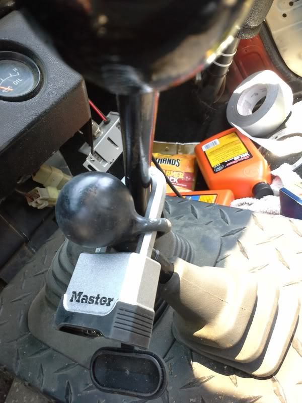

Nice Variation of what I did:
