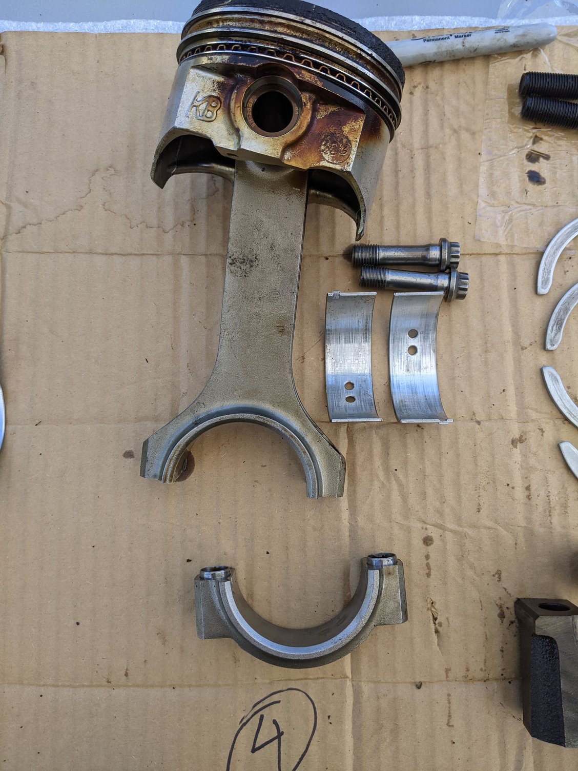

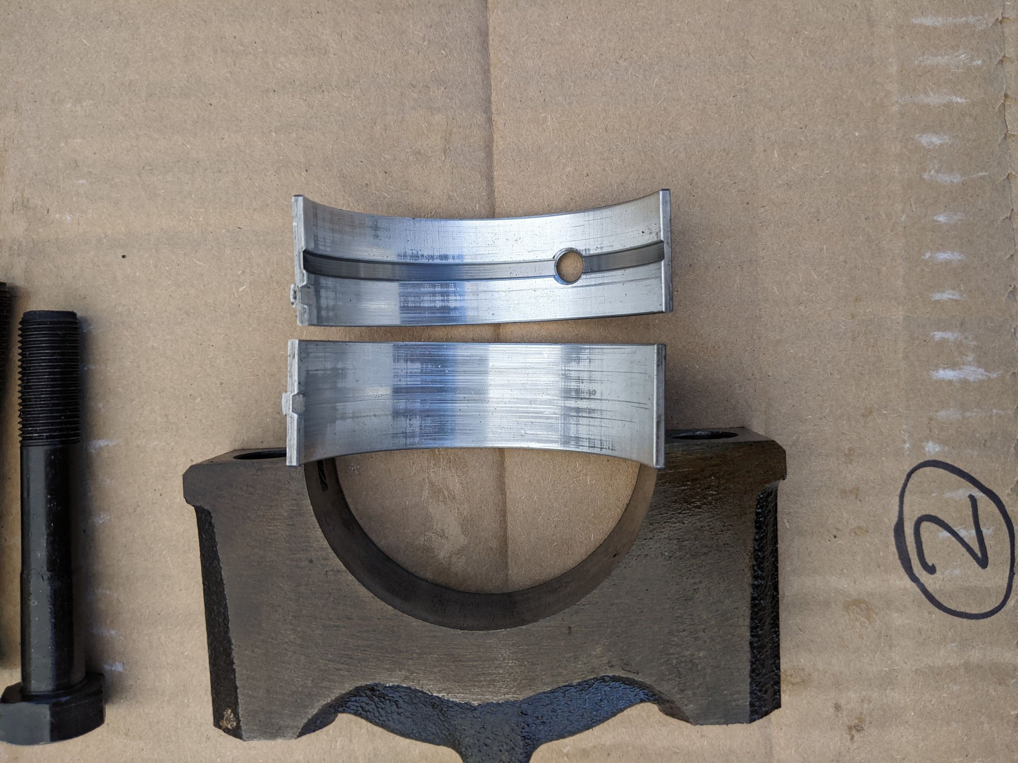

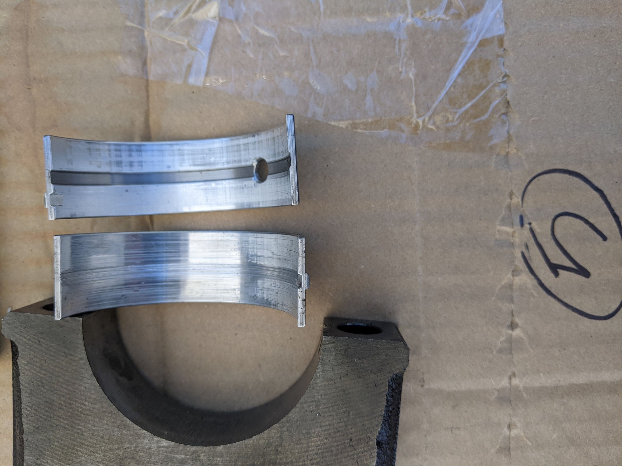

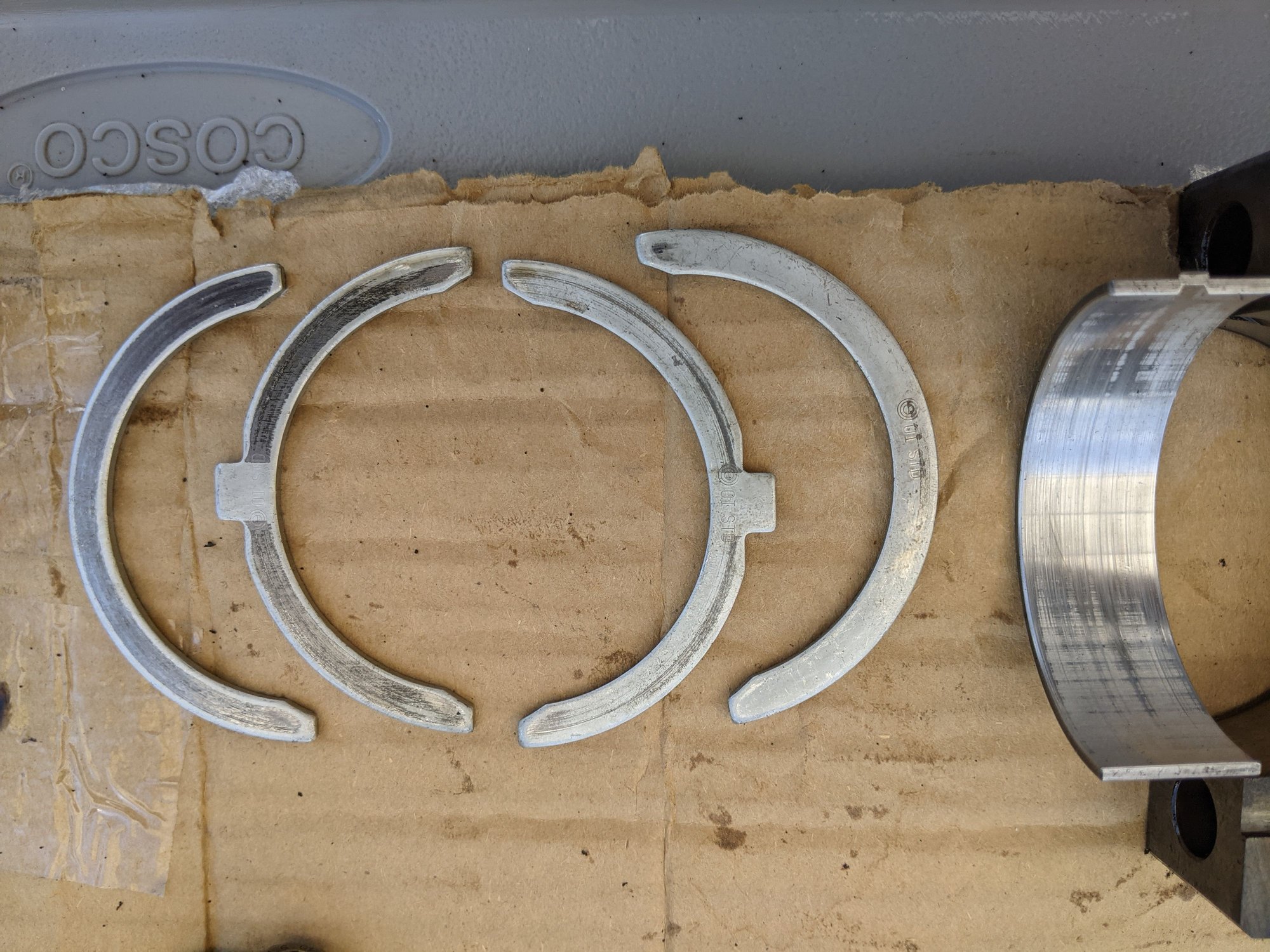

Mid morning update. Rod bearings show wear (didn't bother to plastigauge as I will be replacing them). And as Enzo predicted the thrust washers are worn into the copper, rear side shows significantly more.

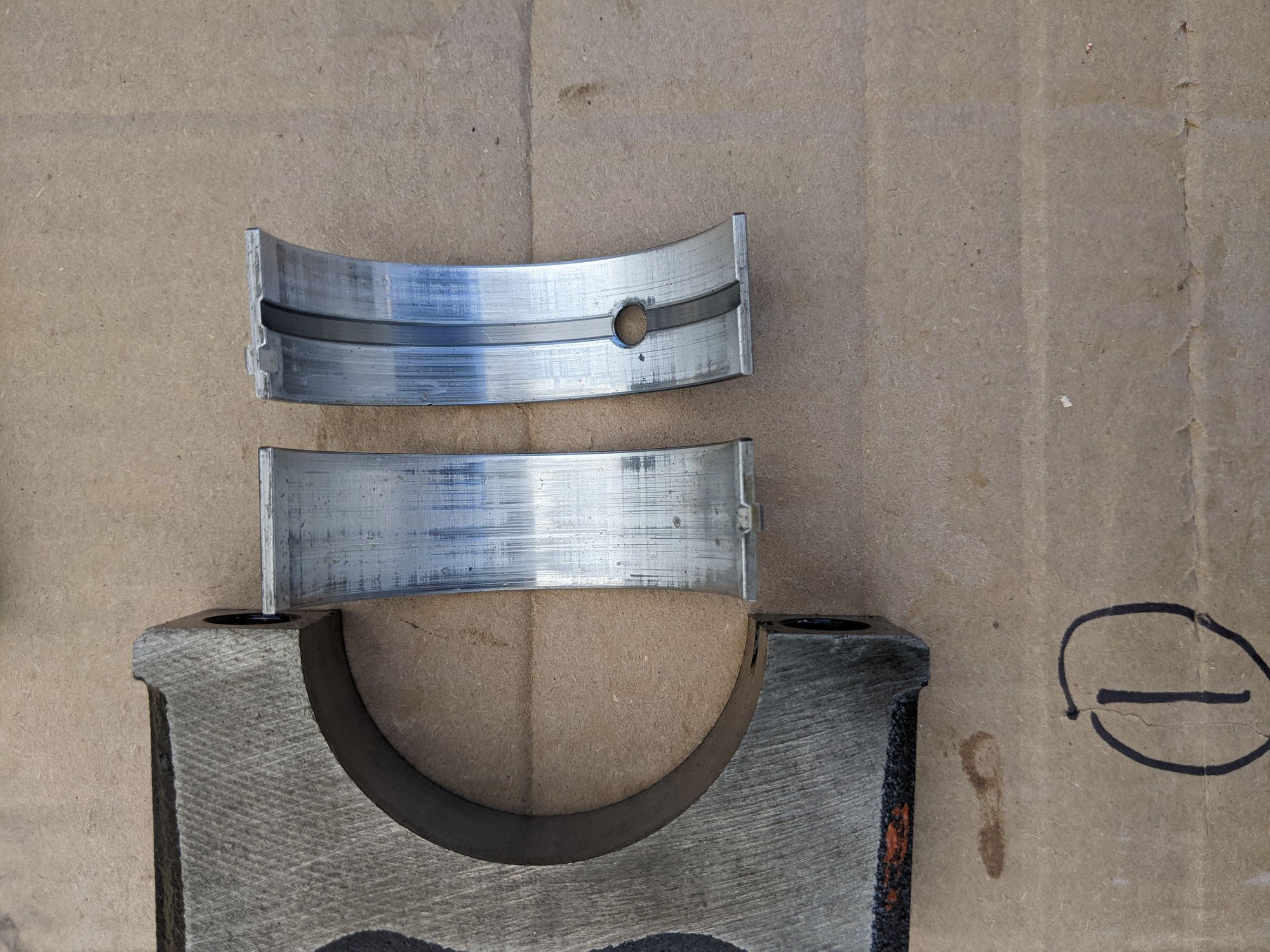

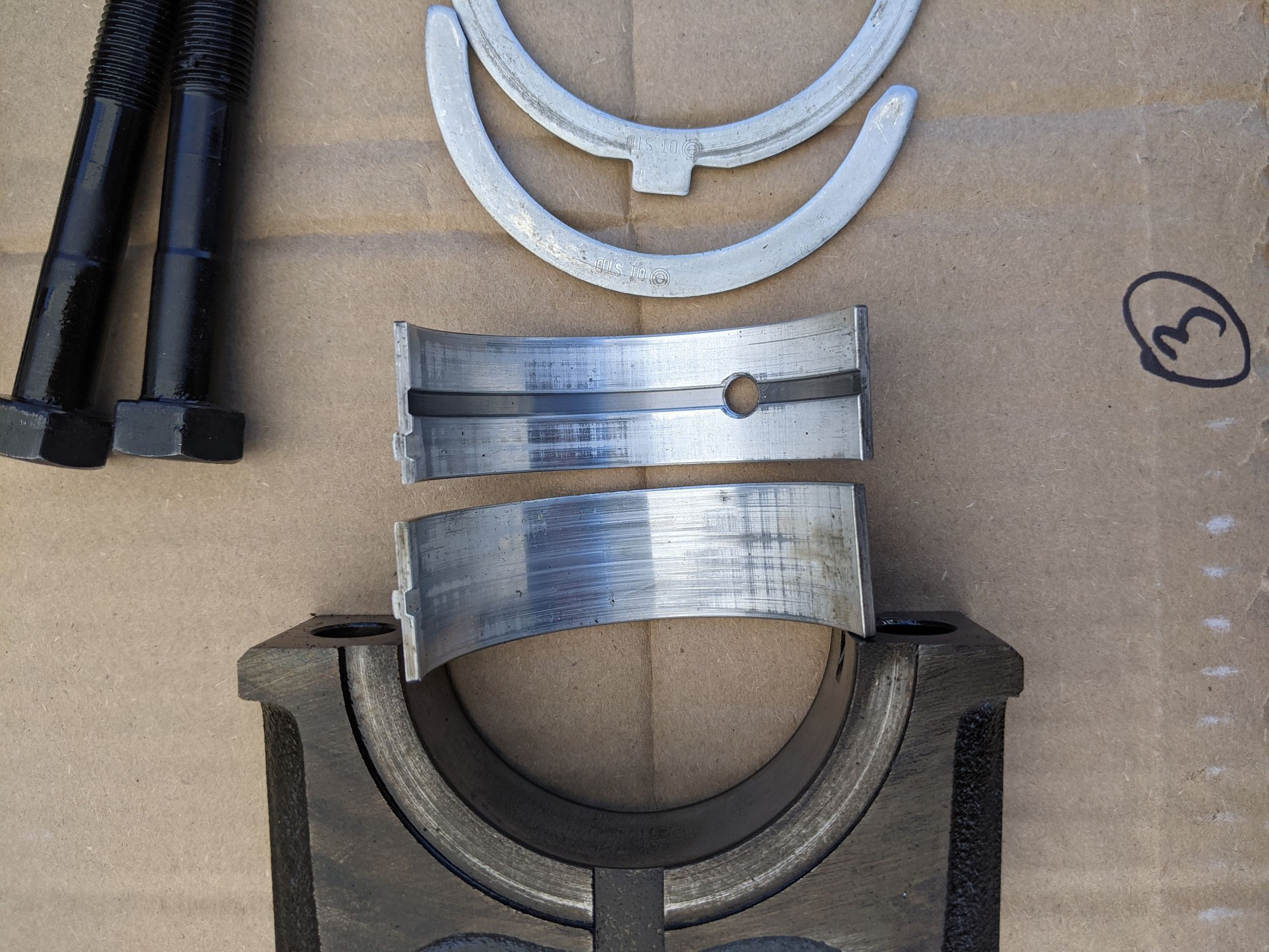

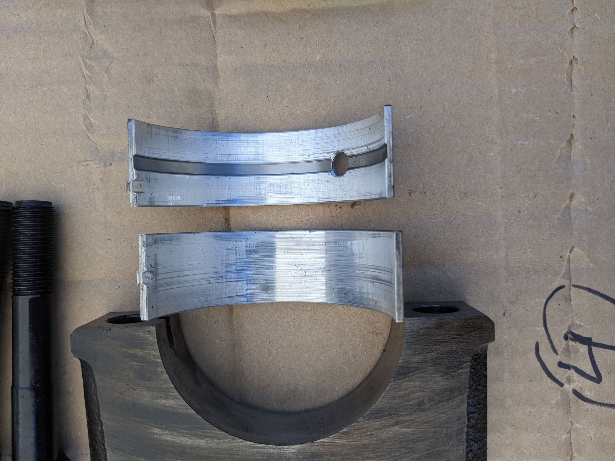

Main bearings:

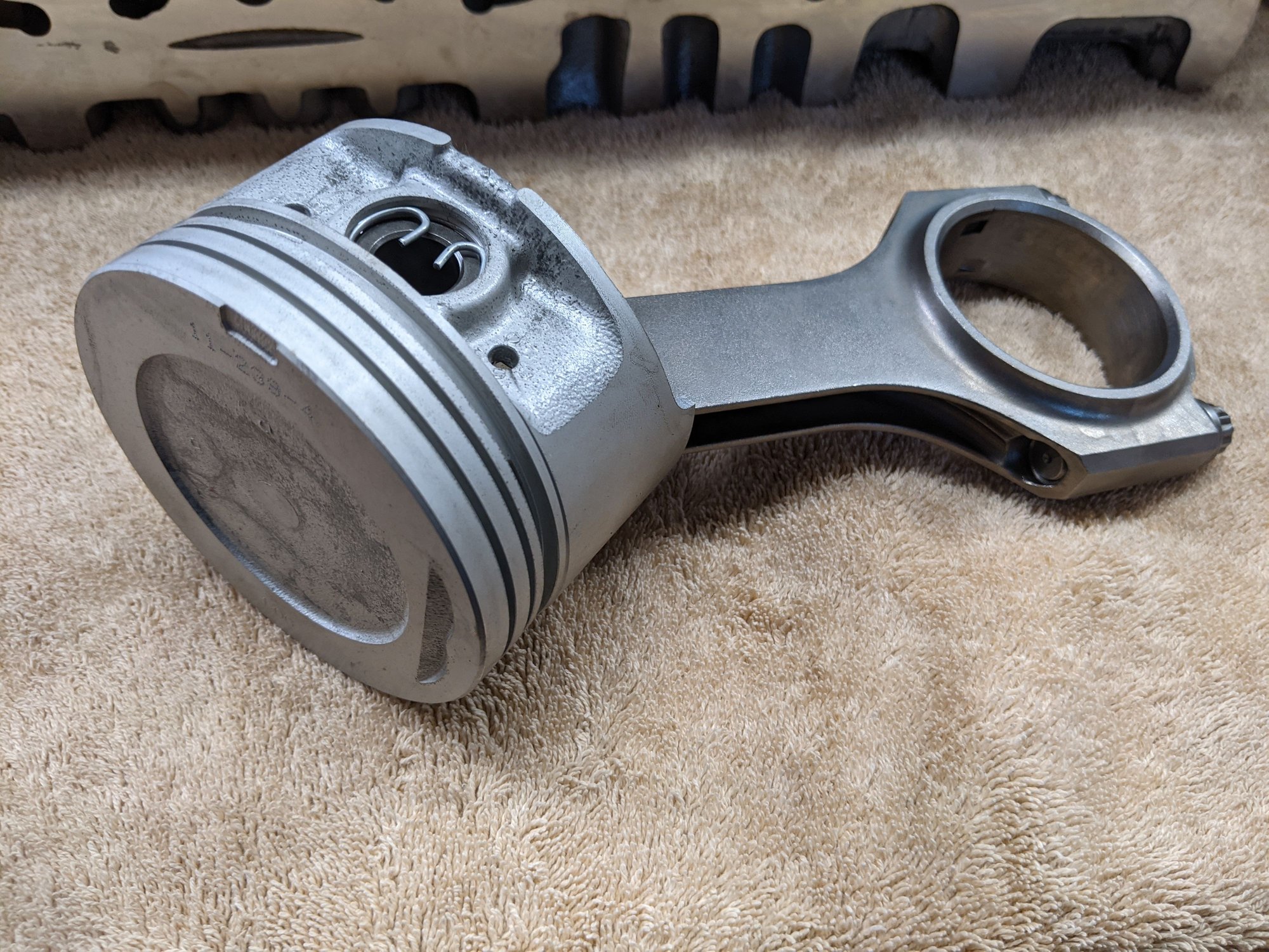

I dropped the head, crank, block, rods and valves off at the machine shop yesterday. Going to get the block cleaned up and bored. Crank polished. Head cleaned and a valve job. The pistons were collapsed by a few thous. So new piston are in order. Machinist recommended stock. Also since the block has been milled before, he suggested that I use a thicker head gasket to maintain correct piston height clearance. Anyone have suggestions?

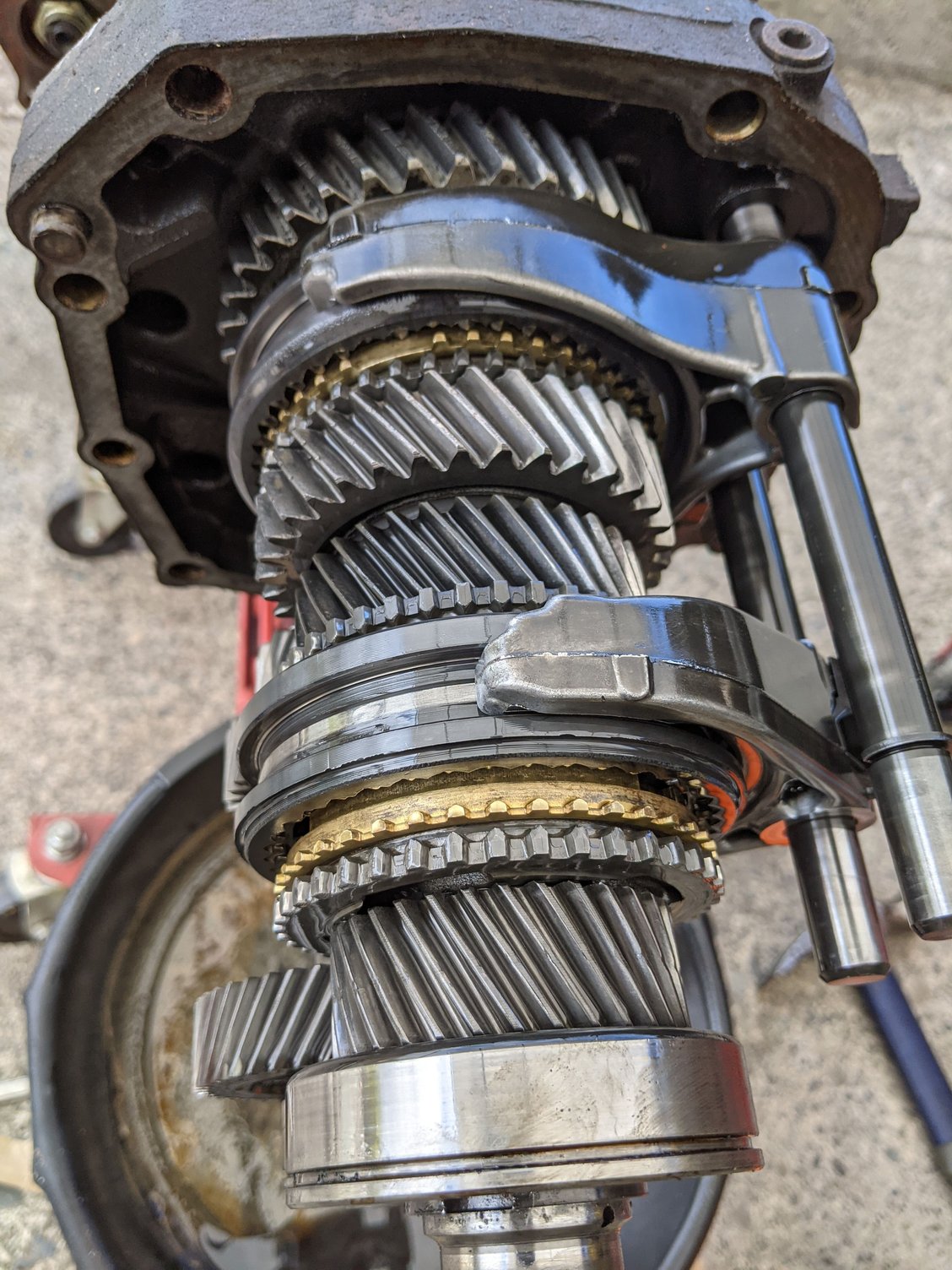

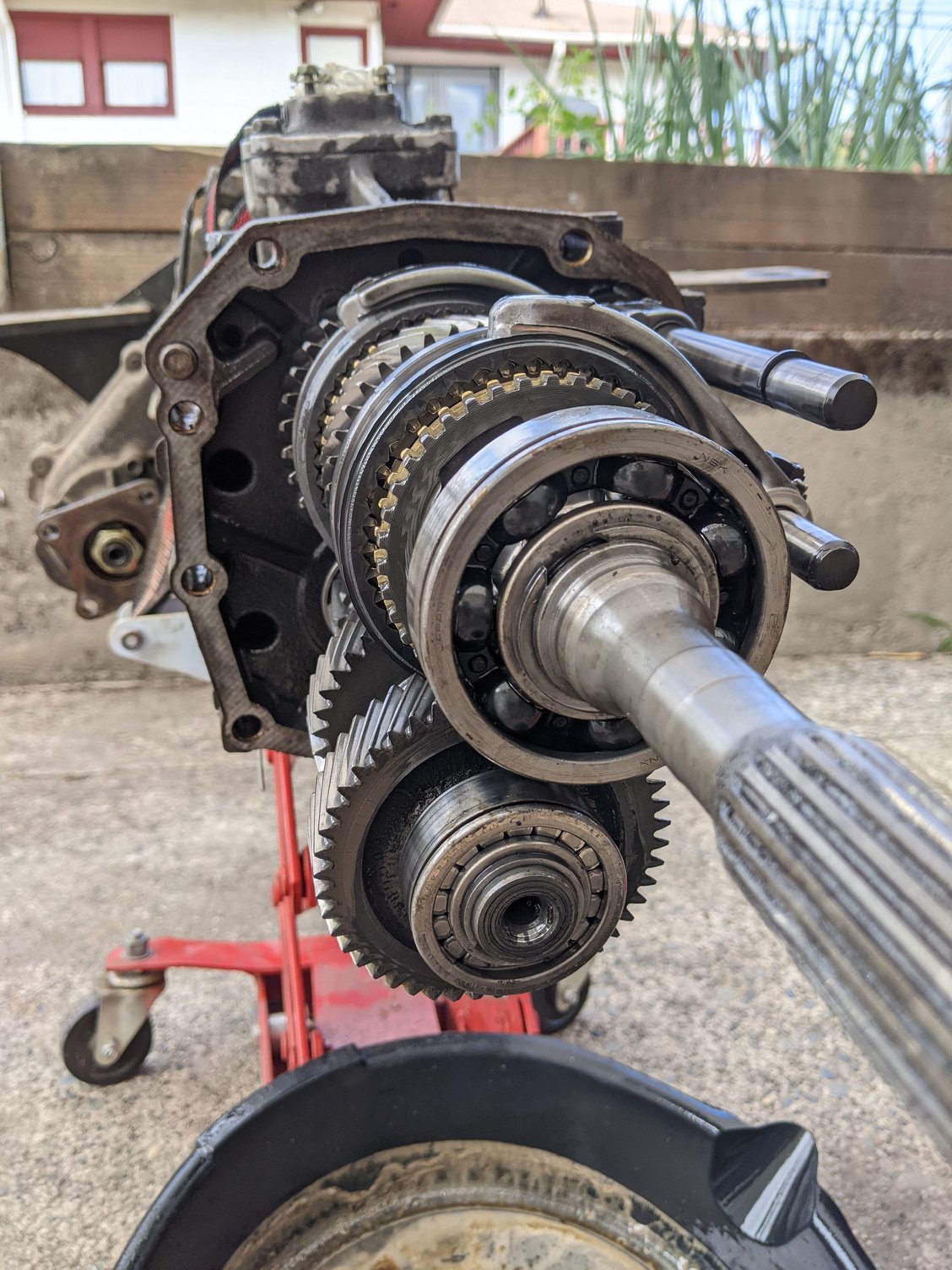

While I wait for the machine shop I thought I would have a look at the transmission. I've had noise in all gears except 4th, 5th being the worst. I hope replacing the input bearing will correct the issue. I've wanted to do it for a while and told myself that next time the transmission was out I would. So here we are.
Bearing, gaskets, seals - anything else I should be doing while I'm in here?

Is there an acceptable amount of wear on the transmission housing at the input bearing?

8" three jaw puller made quick work of removing the input bearing.

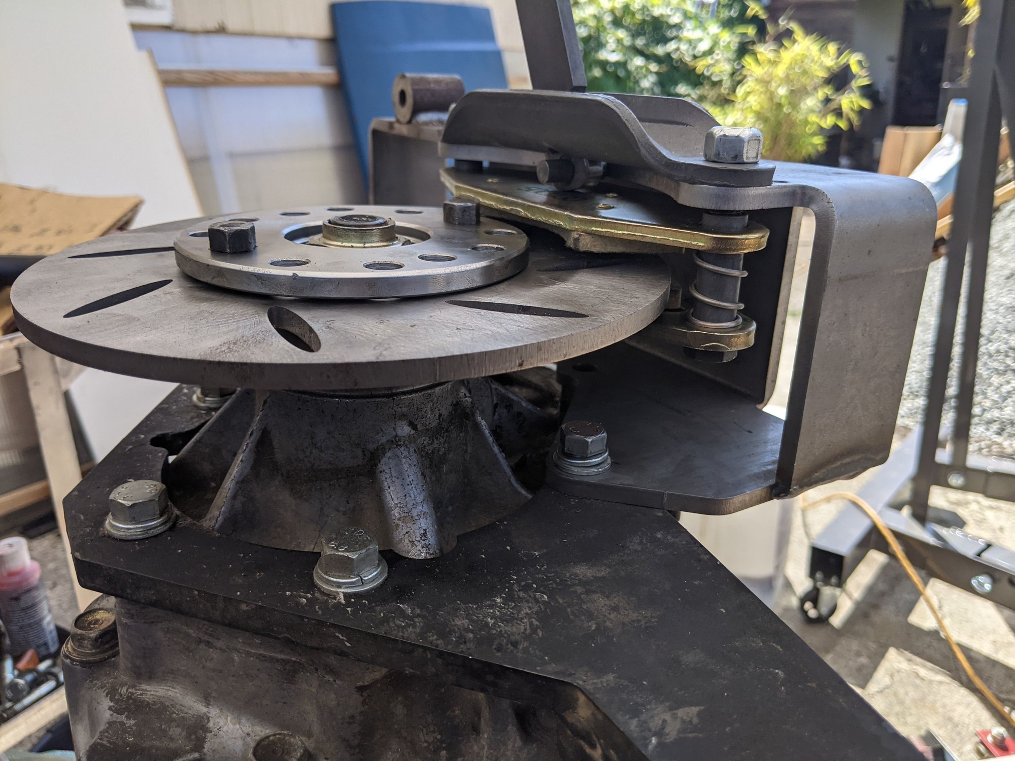

I got the new input bearing pressed on today. Installed new seals and gaskets and reassembled the transmission. On to the next challenge. I am attempting to install a sky offroad transfer case parking brake kit. However, it is not compatible with my front range offroad crossmember. The brake kit is intended to bolt right to the back of the TC. The crossmember is 3/8" thick causing the brake mechanism to not line up with the rotor. Anyone come up with a clever solution to this problem? I've been staring at this for a while and best I can come up with is to cut the bracket apart, remove 3/8" and weld it back together.
Pressing the new bearing on.
Misaligned rotor and brake.

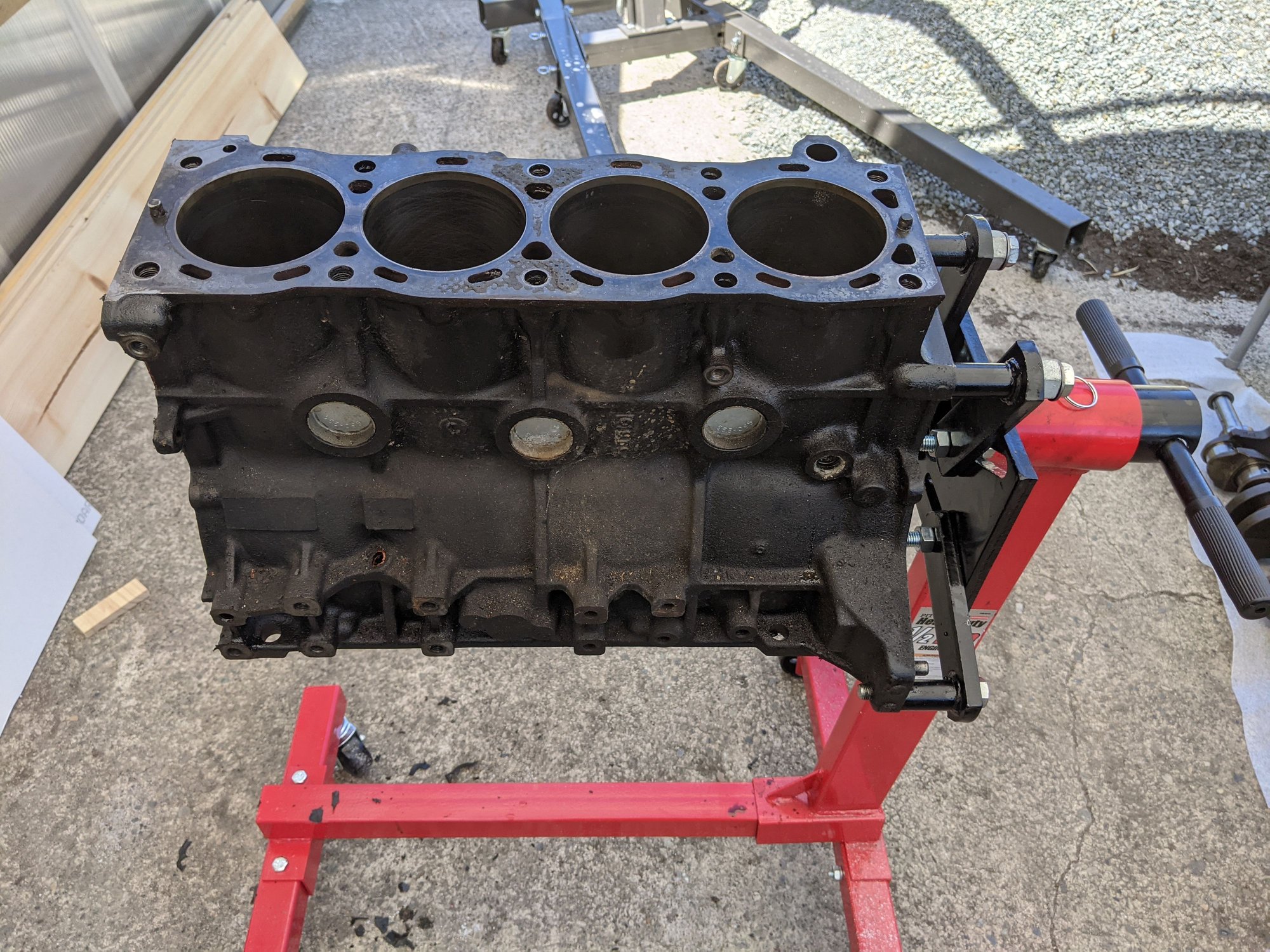

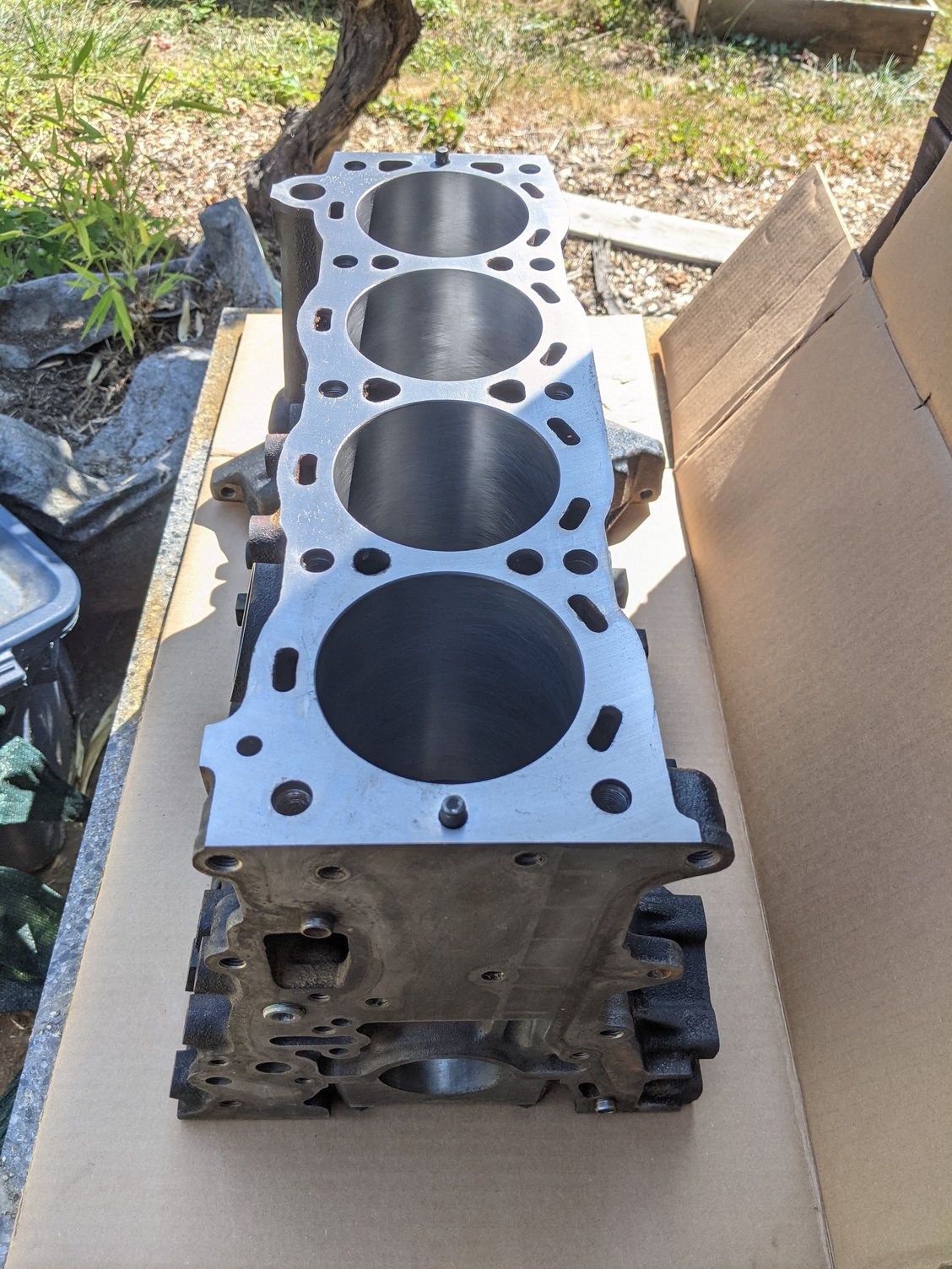

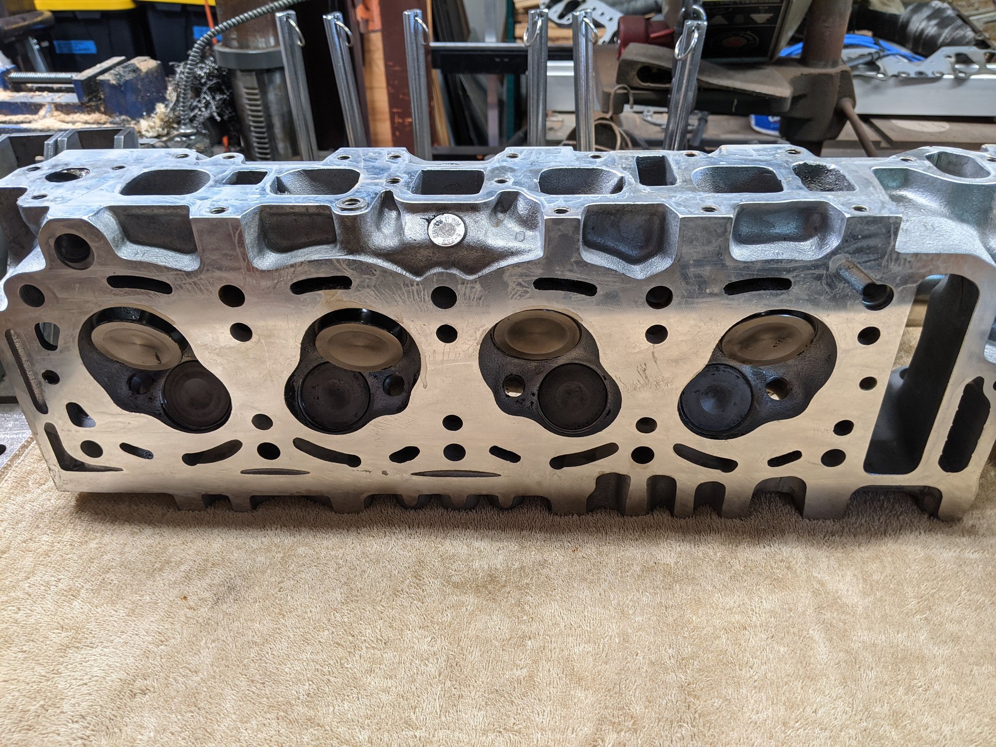

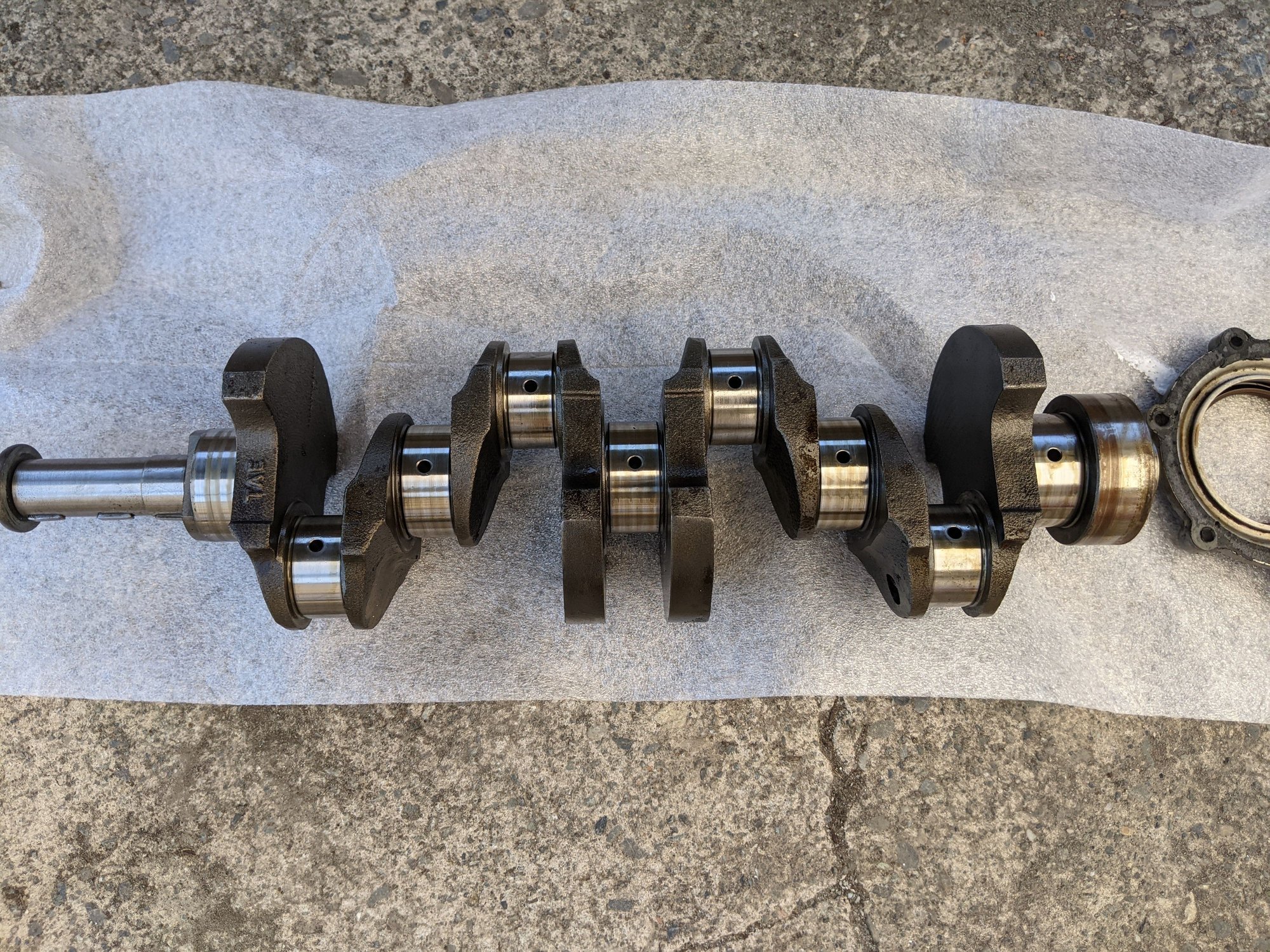

Well, after much waiting the parts came back from the machine shop. Bored, honed and surfaced the block, polished the crank, setup the new pistons, surfaced the head, lapped the valves and hot tanked everything. Next step is to get the main and rod bearings in place and get the head gasket sorted out.
