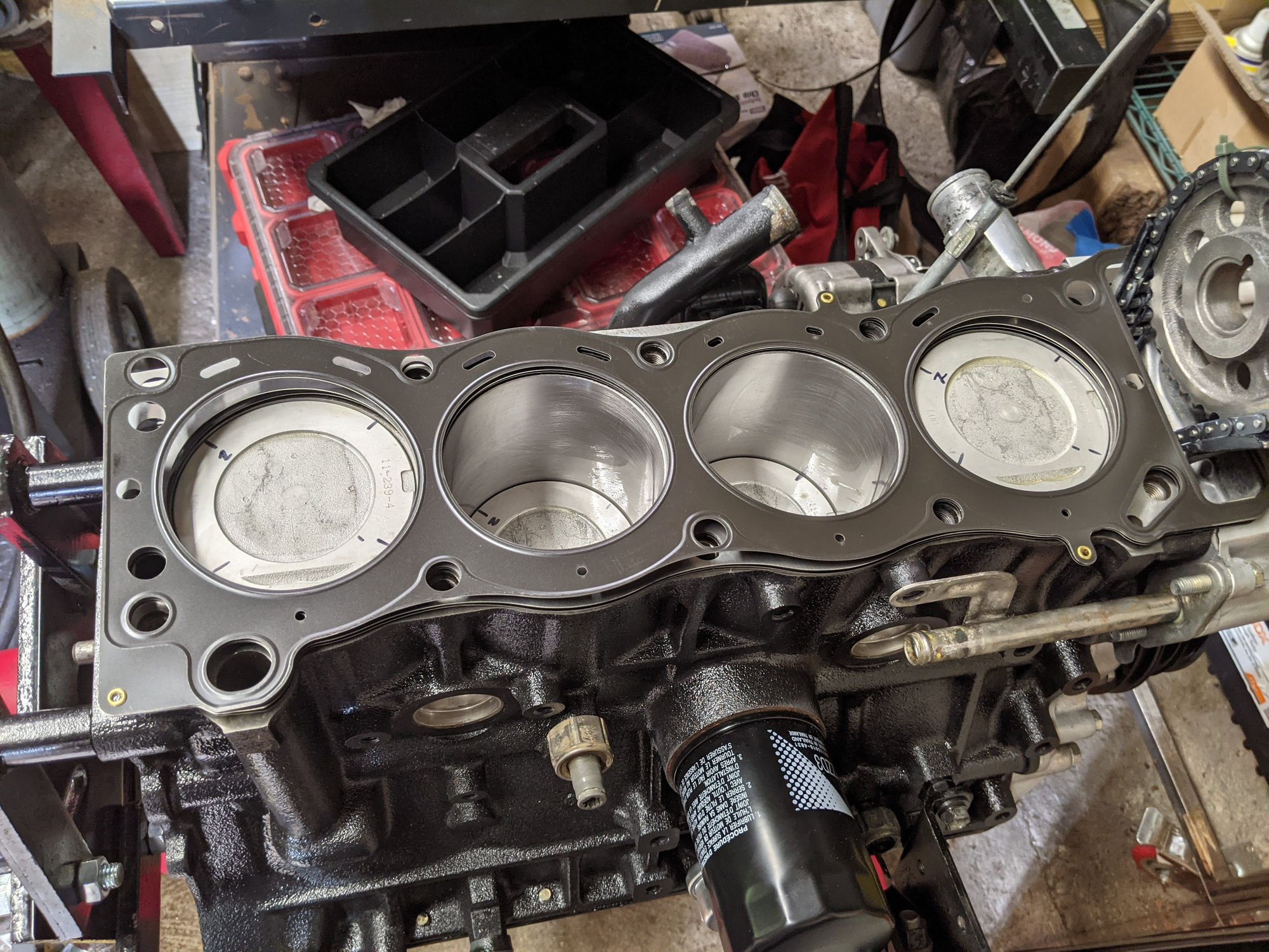

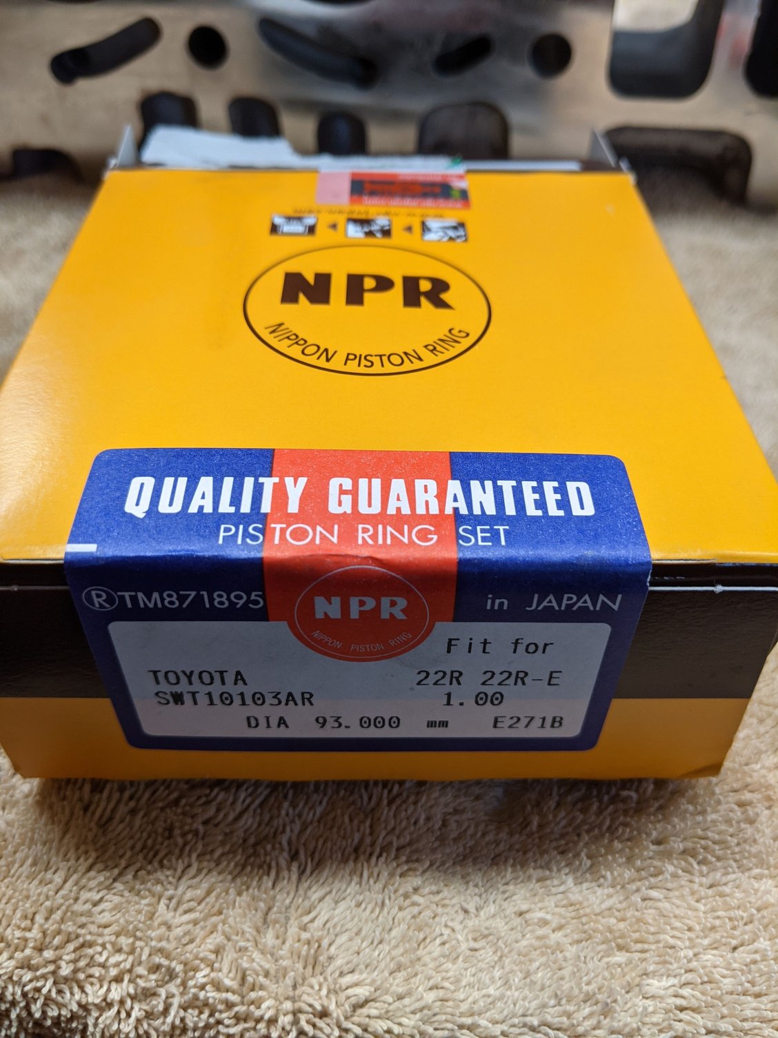

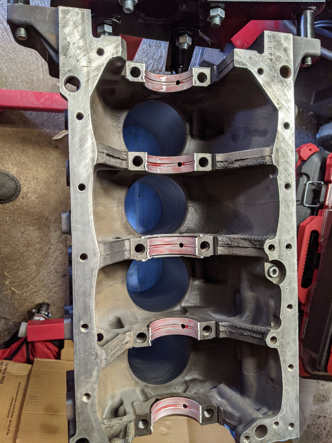

How much did it get bored out?
Old Aug 24, 2021 | 04:09 PM
  #102
cascades's Avatar
5 Year Member
Joined: Jul 2018
Posts: 207
Likes: 95
From: Seattle
Originally Posted by swampedout
Shiny!!!
I'm at 93mm - so 0.40 over total.

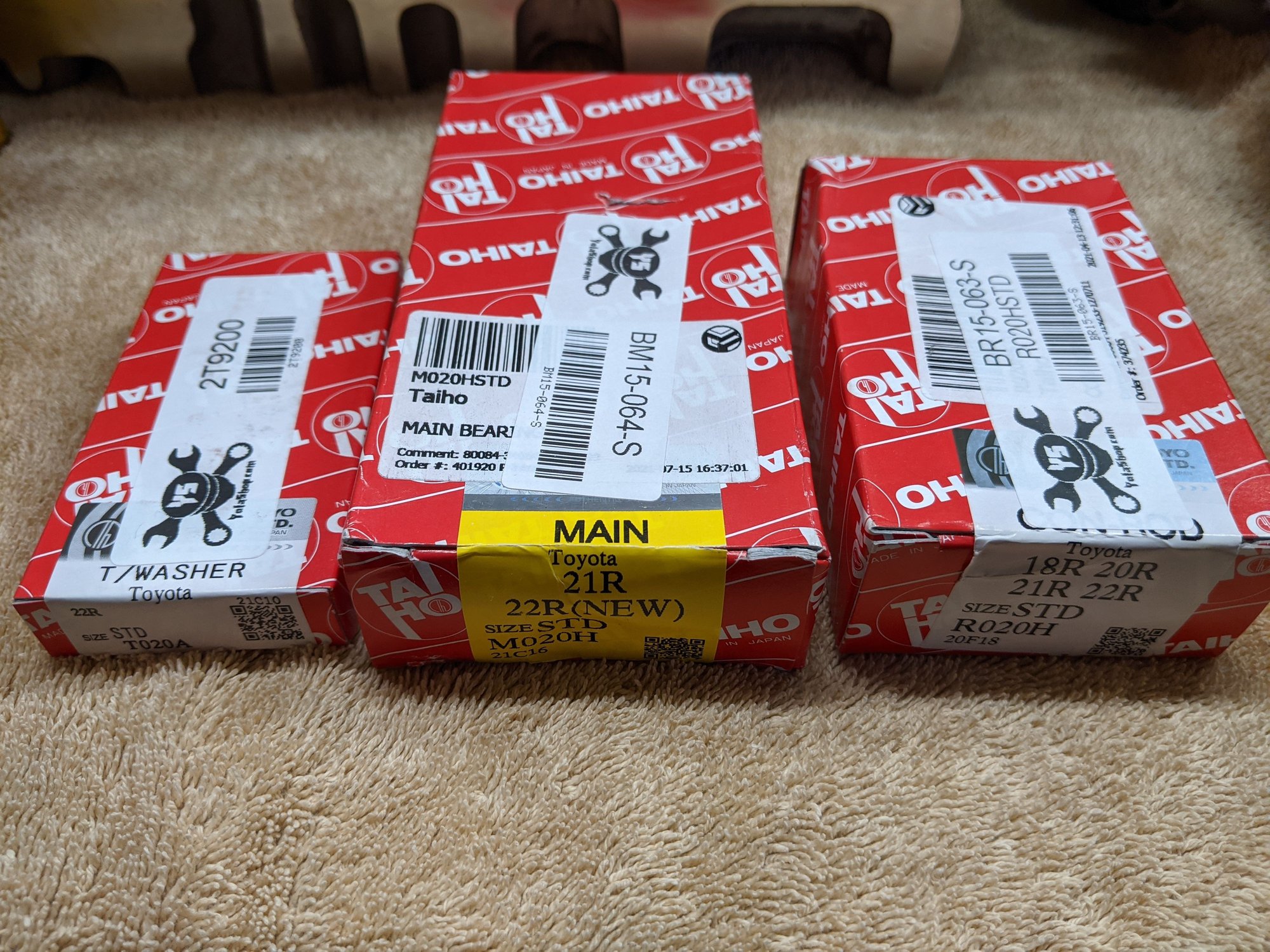

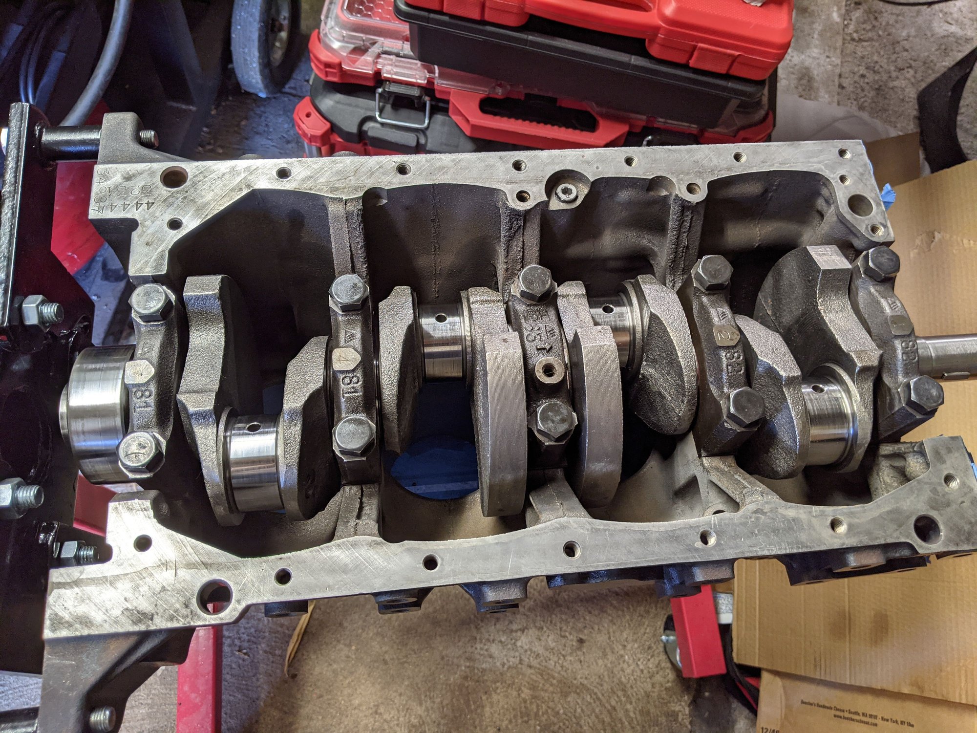

Got the crankshaft installed today. Torqued to 75 ft/lbs in three steps as per the sequence in the fsm.

I was curious because I never heard of that brand of the bearings. I might ask you in a year or 2 when I rebuild my 20r.

Taiho is manufactured in Japan. Supposedly OEM.

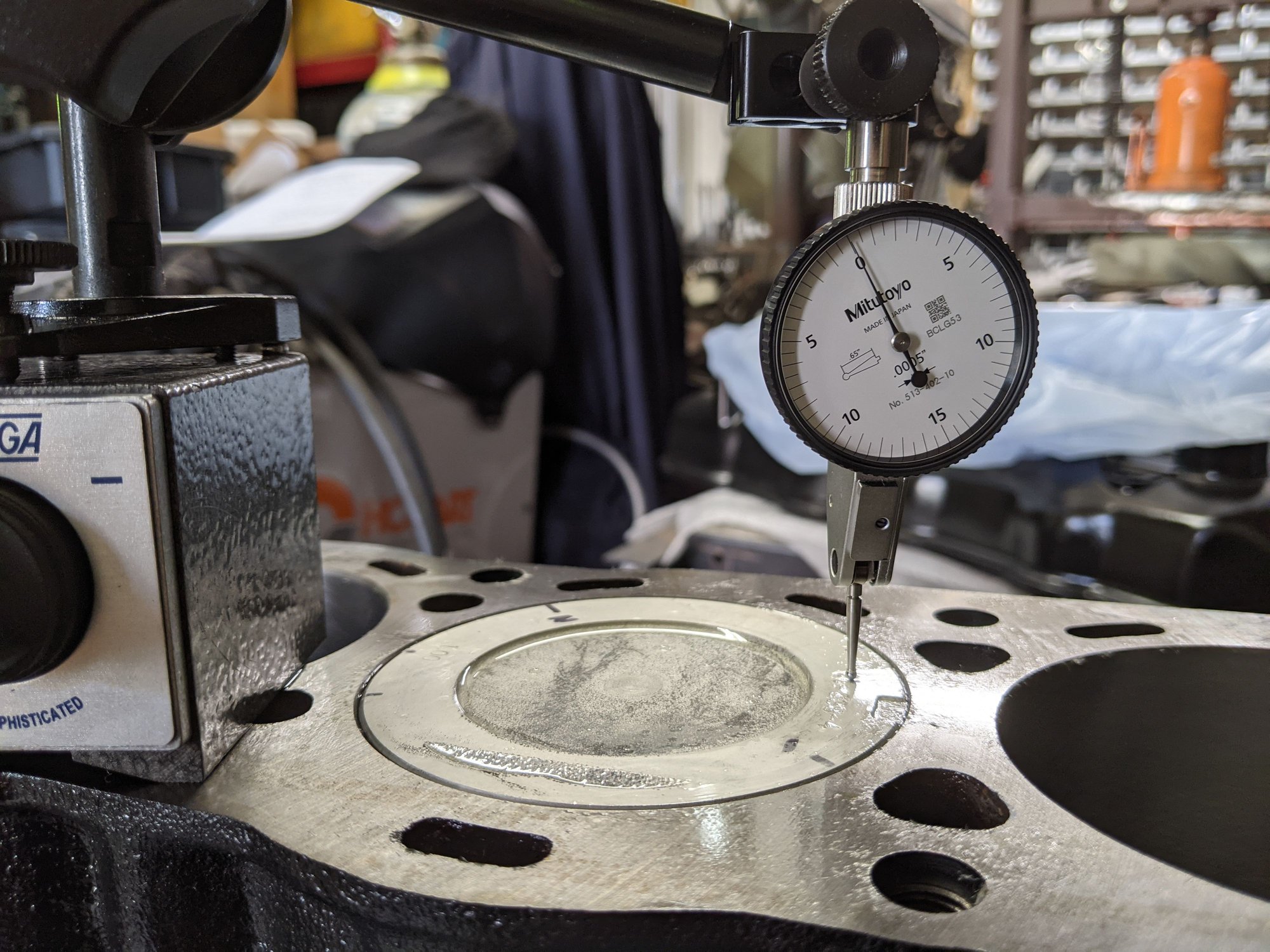

Set the rings and installed one of the pistons today to check height clearance. Does not appear to be an issue thus far.

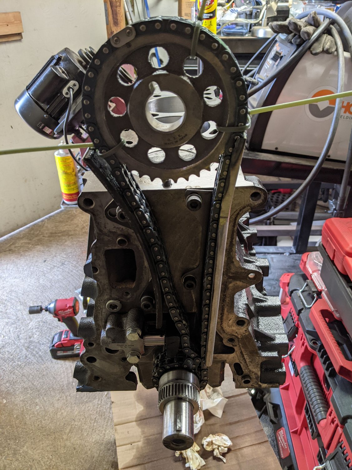

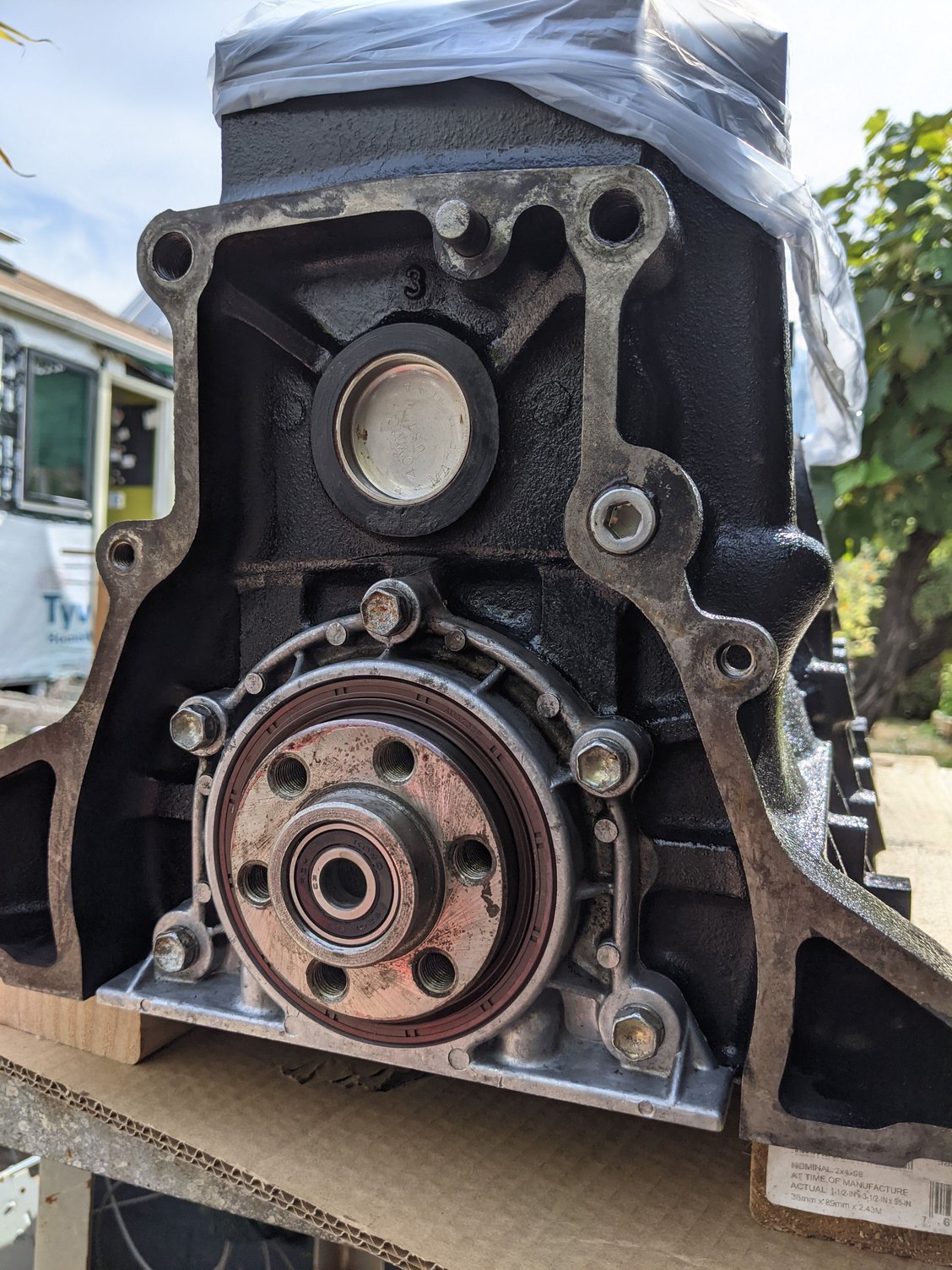

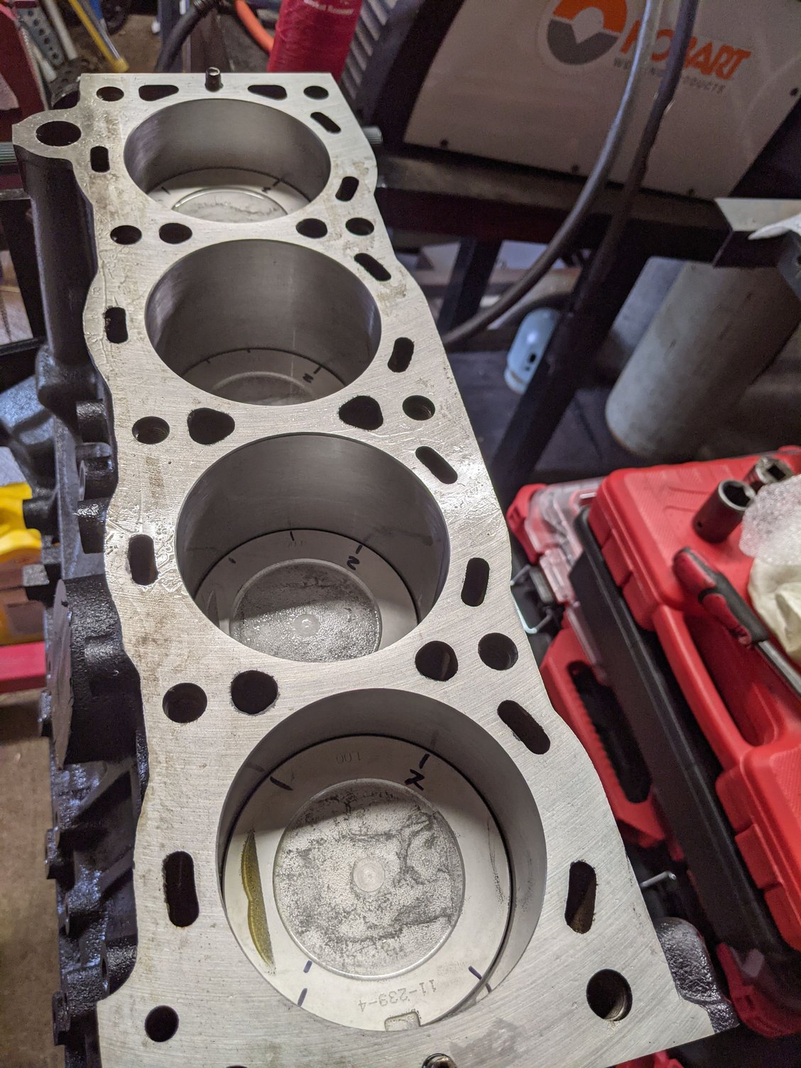

Pistons, freeze plugs. rear main seal, timing chain and timing chain cover installed today.

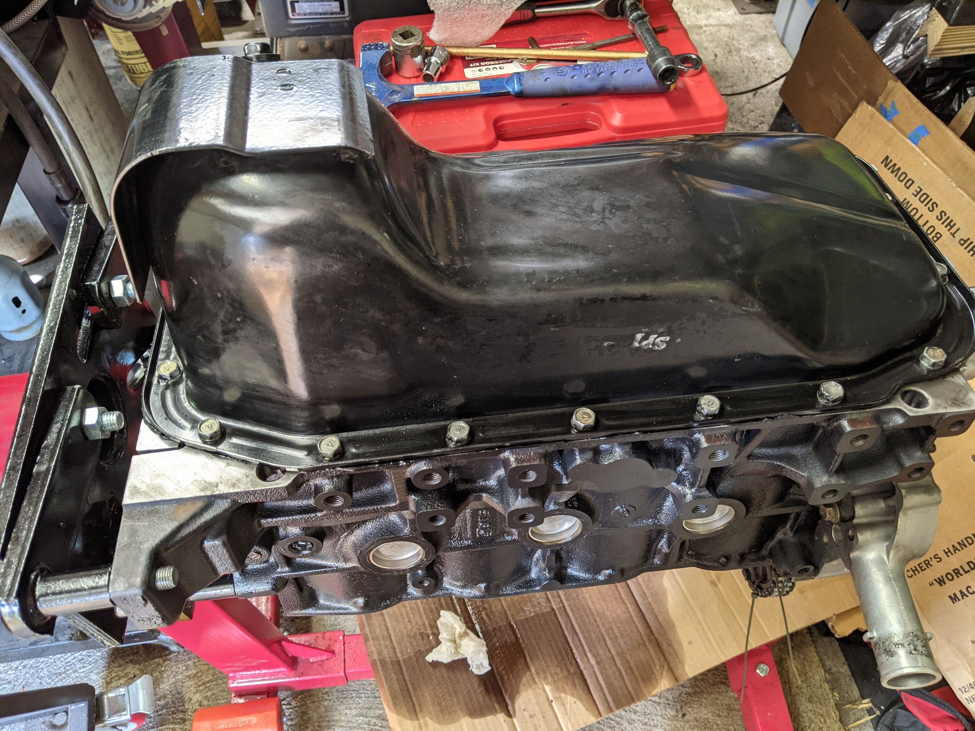

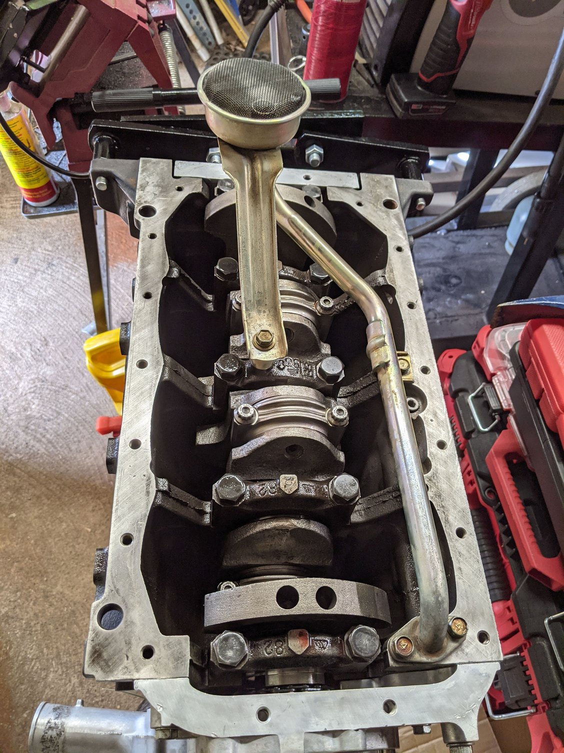

Oil pickup and pan, oil pump, valve springs and smoked ribs today!
Installing an oil pan on the stand is the only way to go.

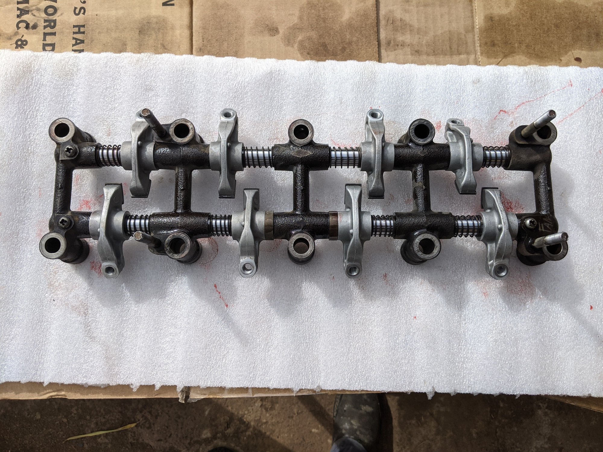

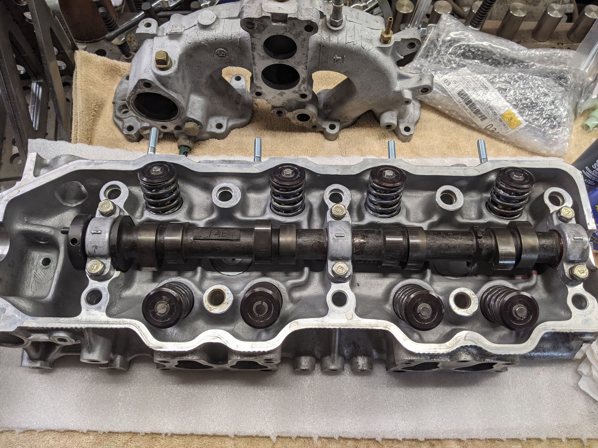

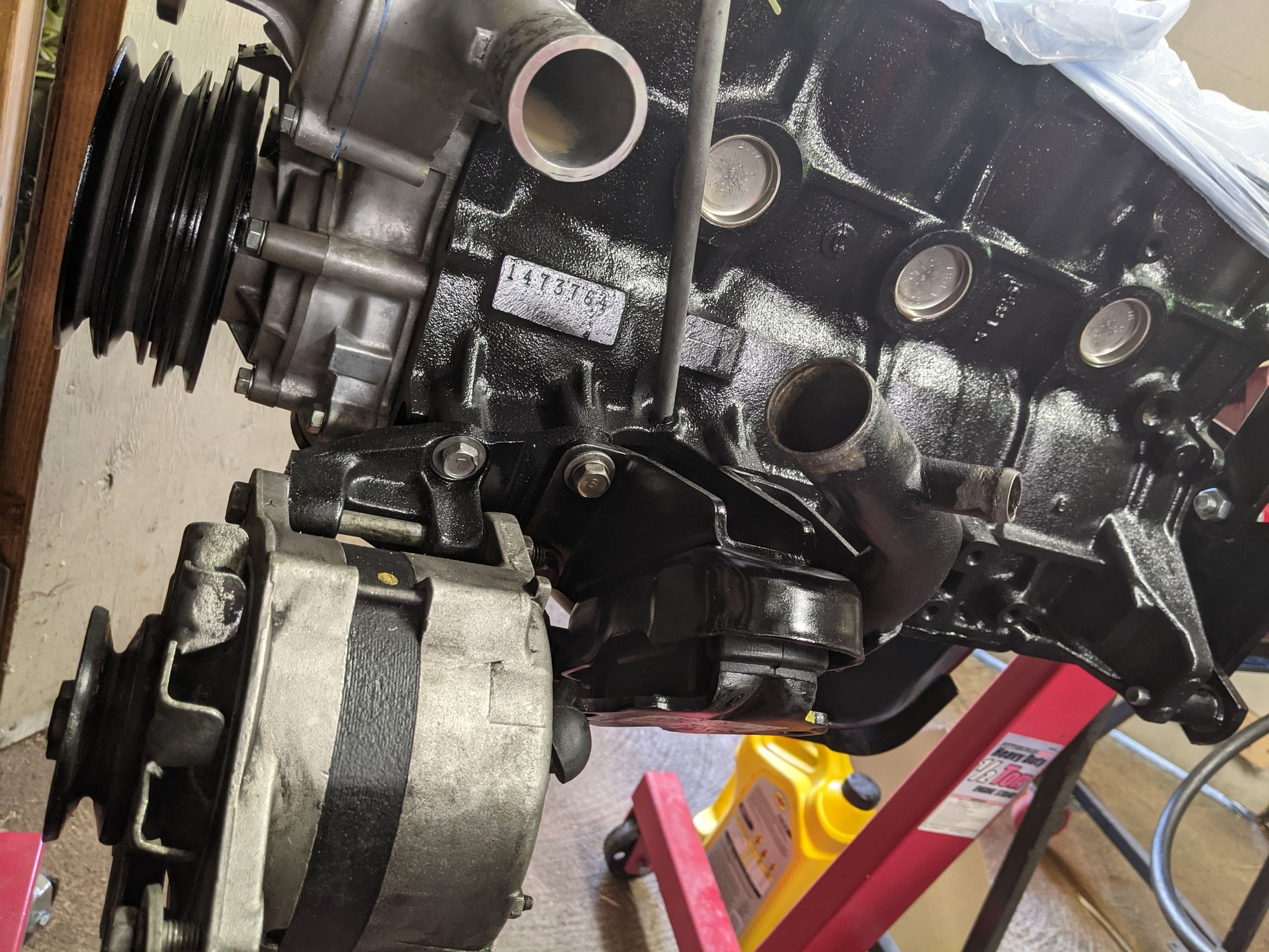

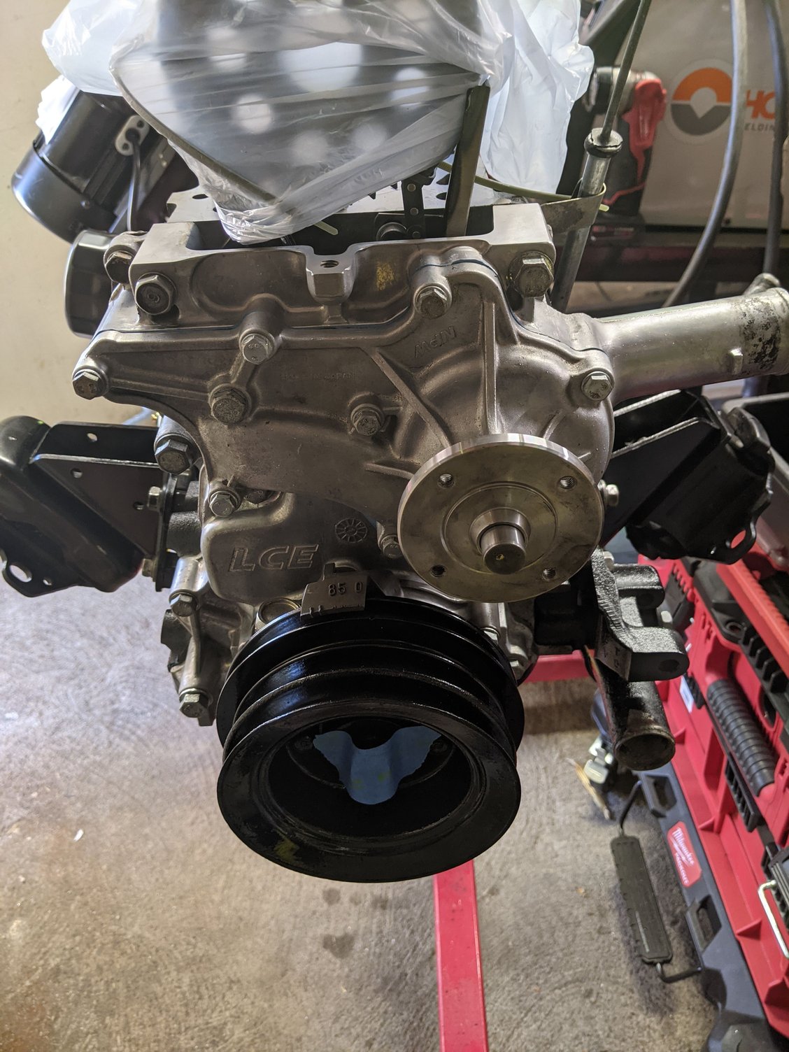

Camshaft installed, various other parts, transmission to block braces (previously missing), engine mounts, alternator, water pump and crank pulley.

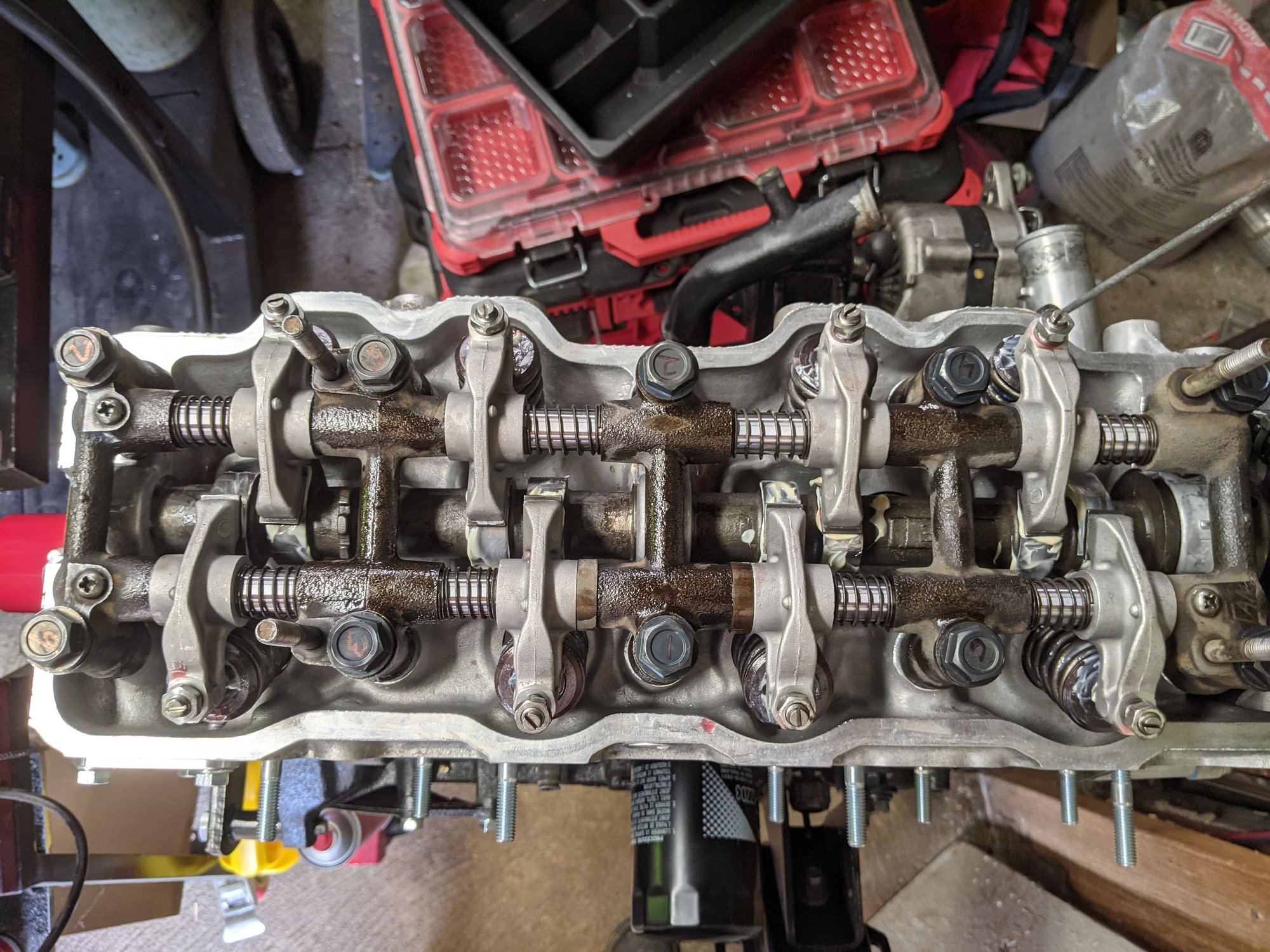

Decided to replace the rocker shafts, so head will have to wait until the parts come in.

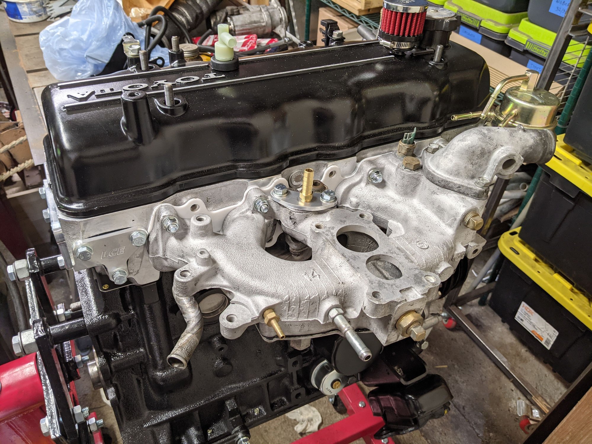

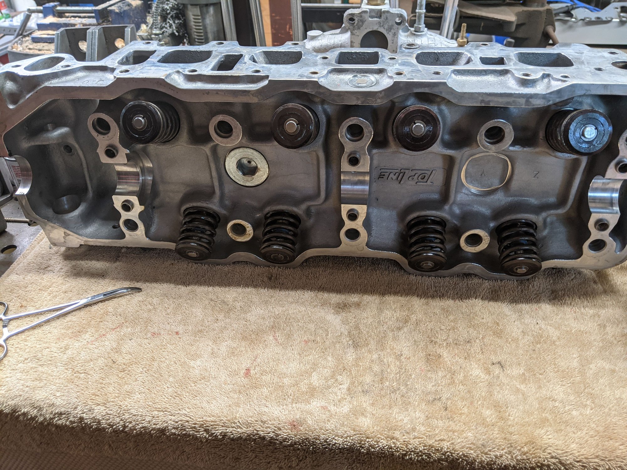

Rebuilt the rocker assembly (new shafts and adjusting screws), installed cometic head gasket, installed head, adjusted valves, installed distributor, mounted fuel pump and got the intake bolted up.

And got Weber and spiral adapter installed. That's it for today.
