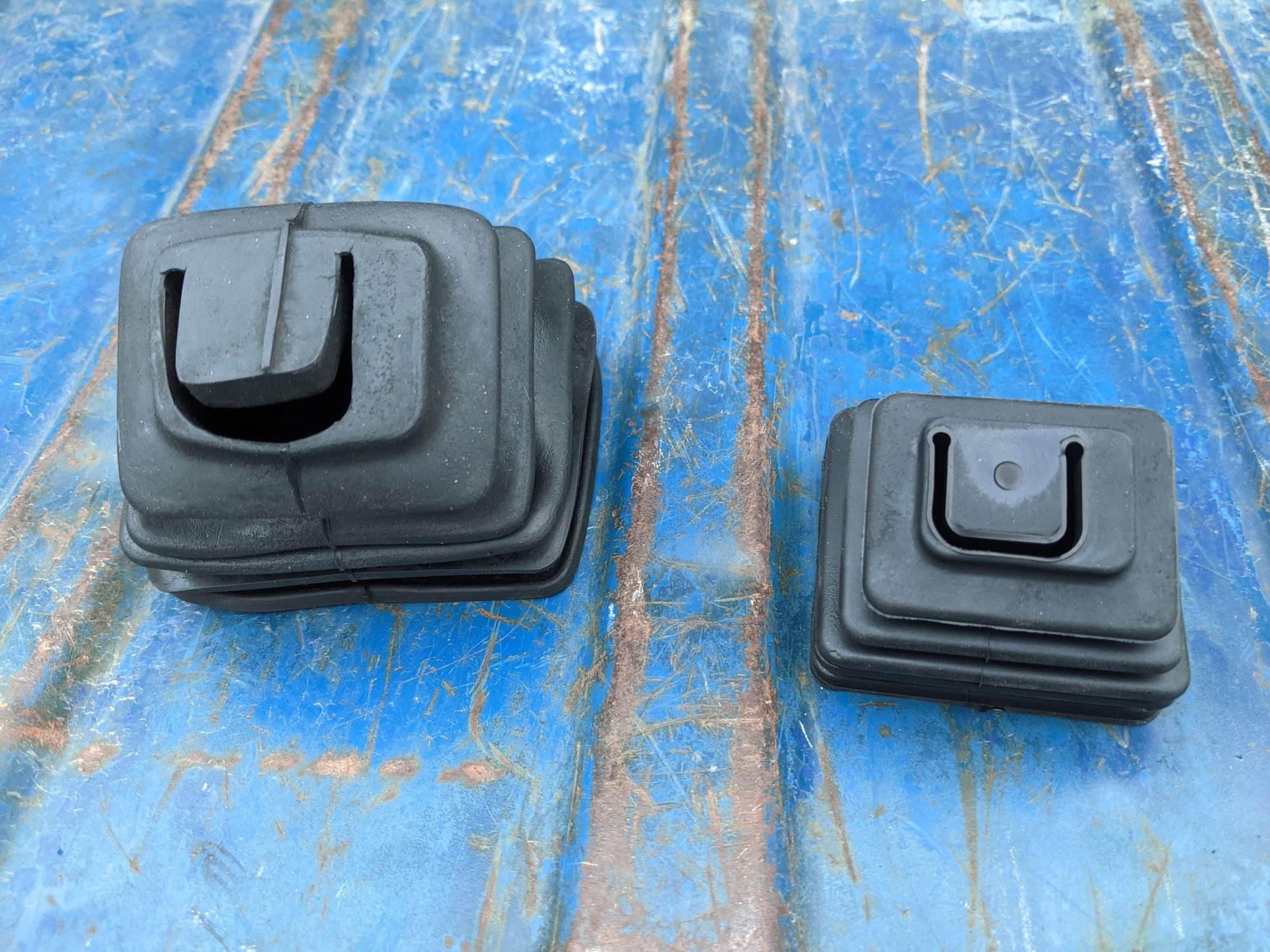

Public service announcement: Do not put the clutch fork boot in the parts washer! It will swell to a comically large size!

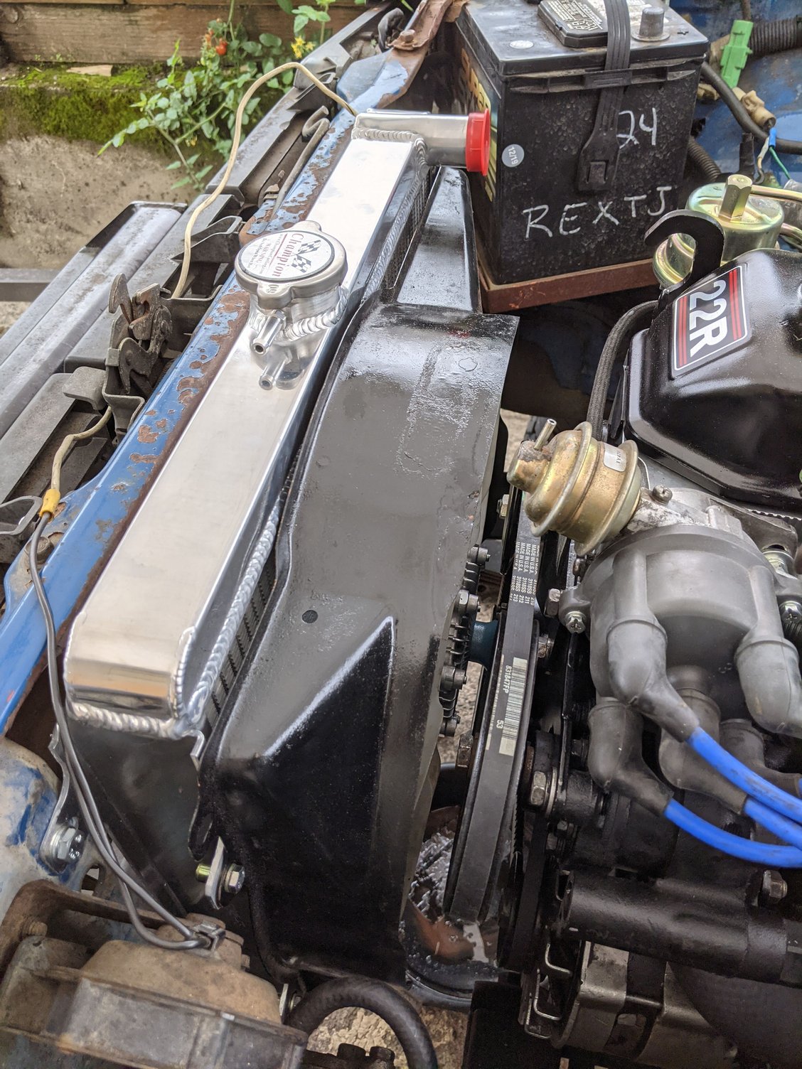

I got the new aluminum radiator installed and the new drive line arrived. Tom Woods custom with double cardan and extra thick wall tubing. Arrived in less than a week and looks awesome!

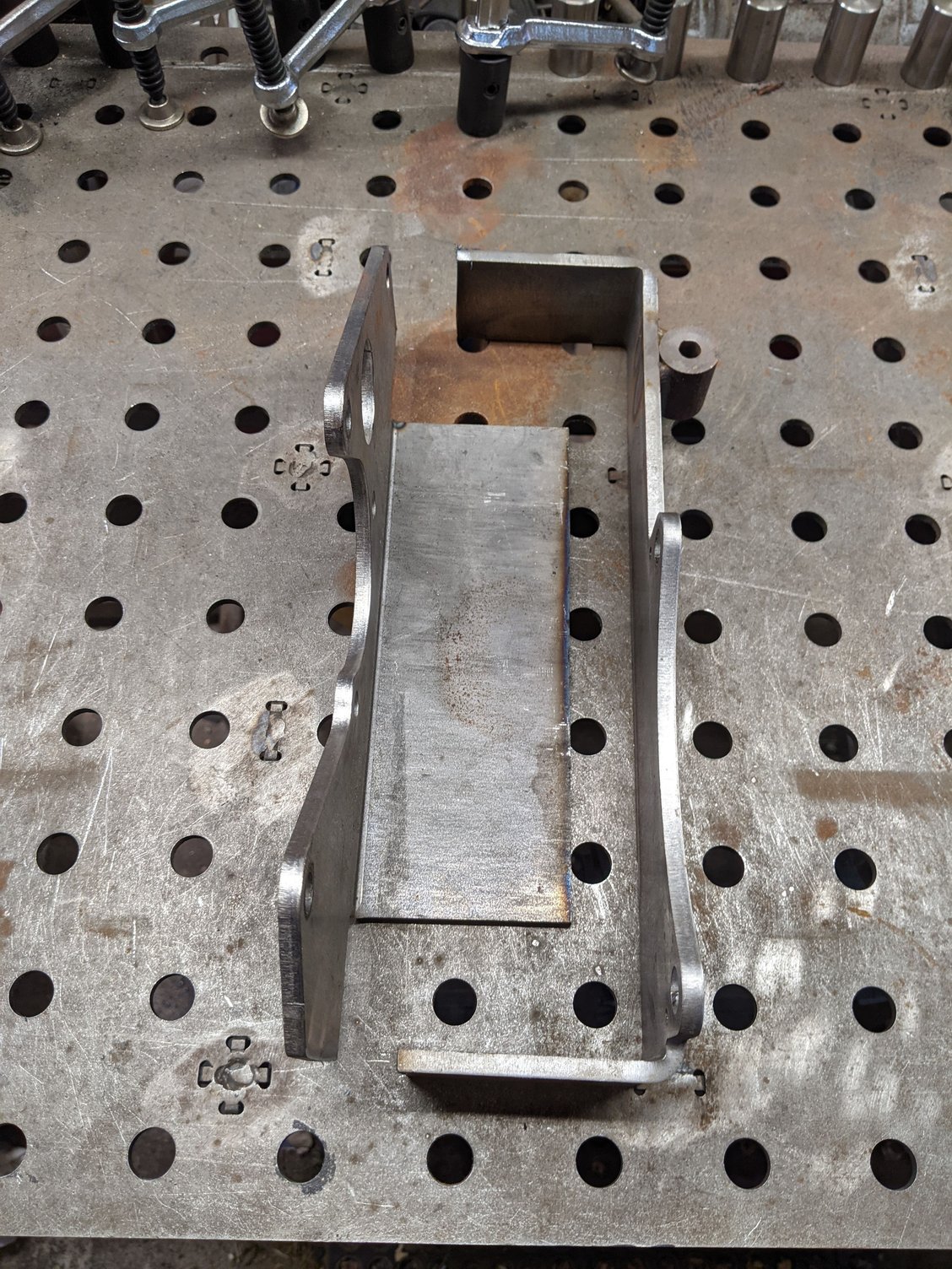

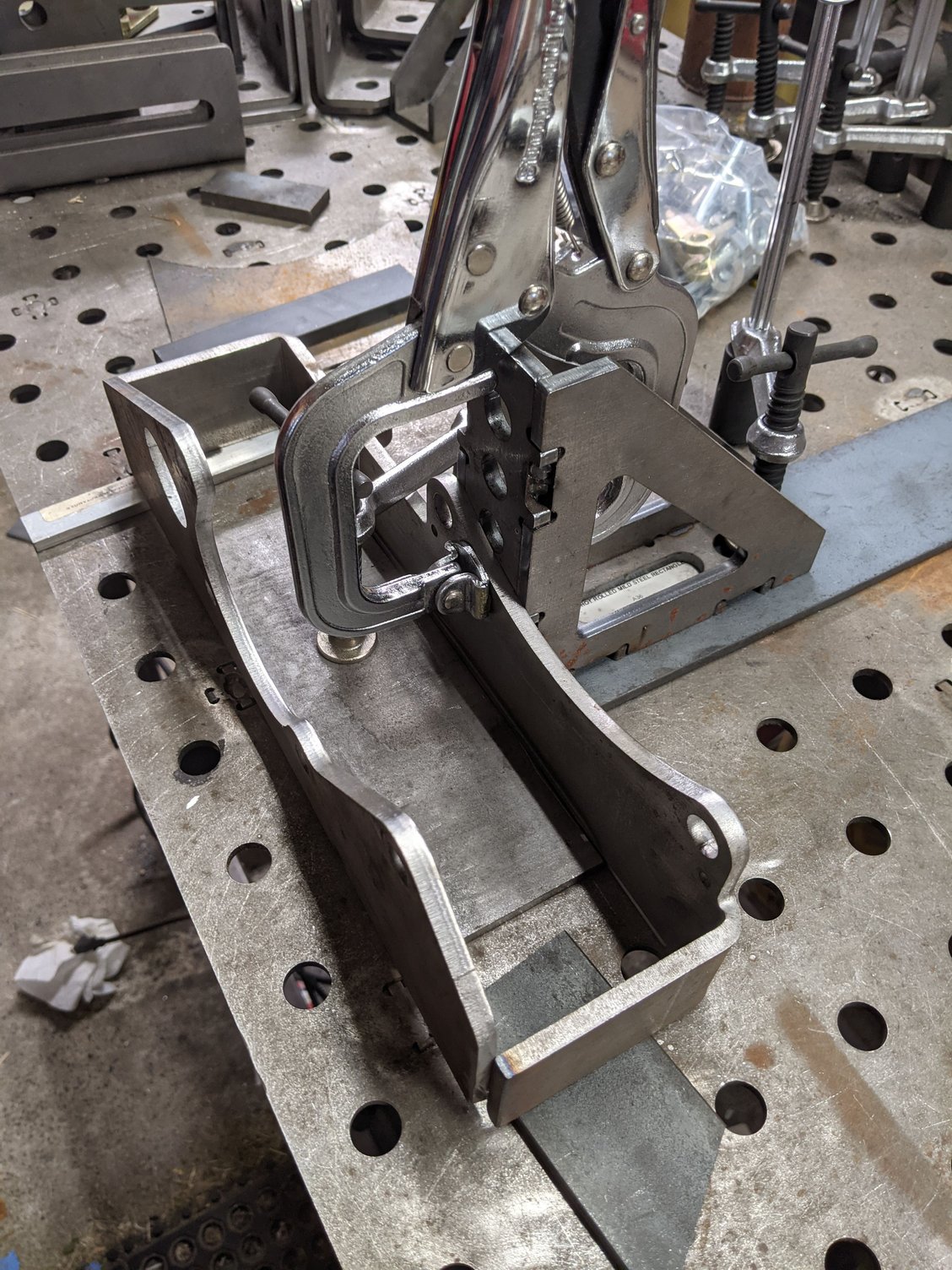

I considered doing something like that, but wanted to have the option to remove the brake if I ever needed. So I ended up cutting the bracket along the welds, removed 3/8" of material, then welded it back together. I got it installed and everything lines up right. However, I cannot for the life of me get the parking brake cable/lever correct. I've tried every combination and none will put enough force on the brake disc to hold the truck. Do you have any pictures of your setup? I had to remove the stock parking brake cable mount when I installed the cross member-I think that is part of my problem. I sent an email to Sky but haven't heard back.

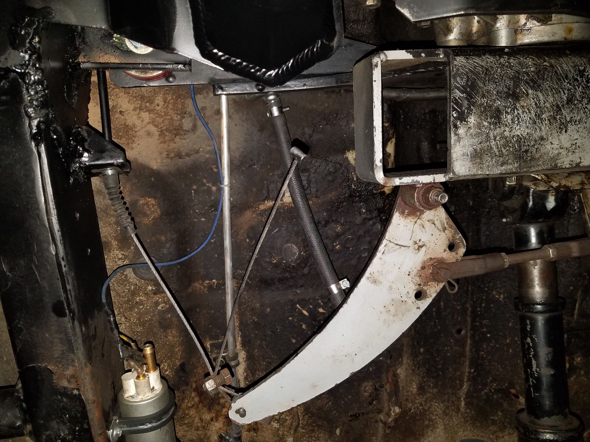

xmember/rear liknk mounts went in the same place for me so I cut off the "end of cable" bracket that was on the frame, then welded it back on in a location that "works".
I did have to take up some of the line slack in a somewhat hillbilly method (split bolt with nut to pinch a loop in the line). I'll try to get a pic or two tonight and post them up.

current setup

Gotcha, thanks for the picture. Nice to see how someone else made it work. My cable has a different end-it's an eye bolt swaged on that fits the sky lever bolt exactly. Anyhow that shouldn't matter, I'll keep playing with where to locate the cable end bracket. Thanks.
