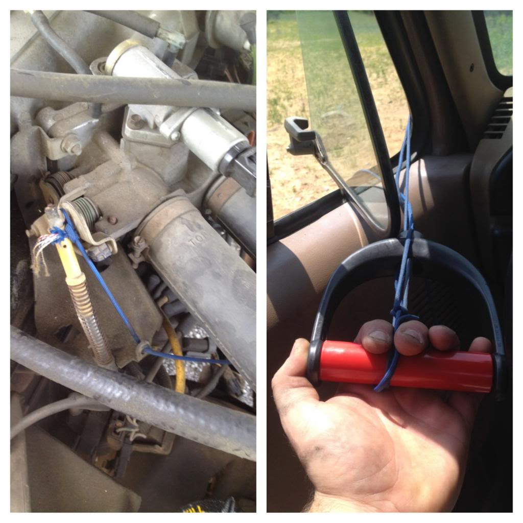

I had some 550 cord in my tool box, and a resistance band behind the seat of my truck. Tied the cord to the throttle body thing where the original cable goes, ran it to the cab and then tied the handle from my resistance band to it. Drove it about 20 miles like that all the way home. Very interesting to say the least...

Nice hand throttle! At least you know that you could always make it home if you lost a foot on a trail... The rear drums are an absolute PITA for sure!! My BFH and a gallon of WD-40 barely did the job on mine.

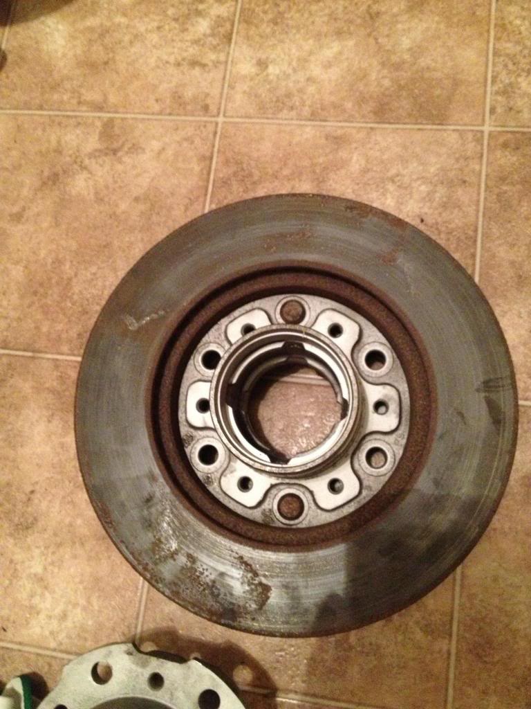

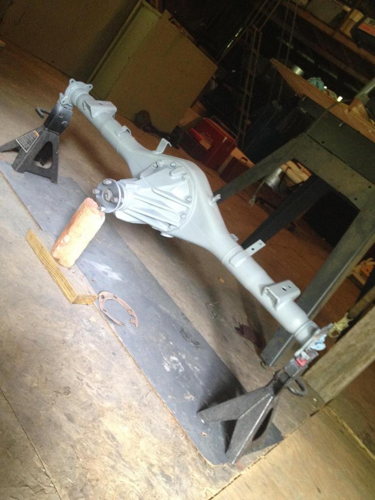

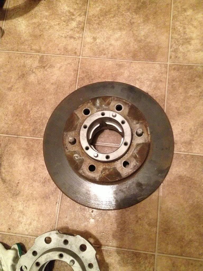

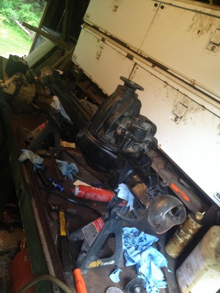

- Sandblasted and painted rear axle. I'm still waiting on a rebuild kit so I can throw the shafts back in it. I got some rear disk brackets for IFS calipers, however, I'm going to try and locate calipers with an incorporated e-brake that way I don't have to use a transfer case e-brake. If I can't....no big deal. I'm also going to wait to put gears and a locker in the rear for the time being that way I can get a rolling chassis and get the engine, tranny, etc. mounted. I will just temporarily run one driveshaft if it comes down to it.
- Front axle is modified for front e-locker.

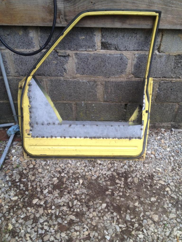

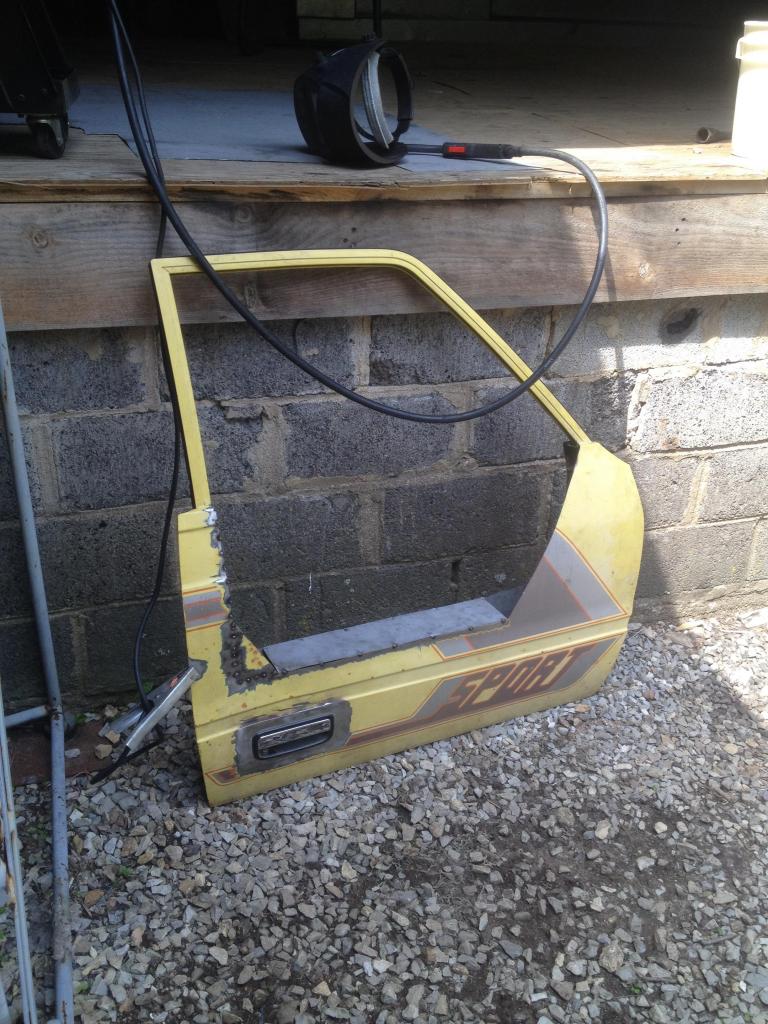

- Worked on half doors, however, I'm still toying ideas for an inside door latch. I'm thinking of getting some clutch/brake cable off a bike or motorcycle that way I can put the latch where I want it. I also want to sandblast the inside of the doors that way I can put POR15 on it before putting the rest of the metal on.

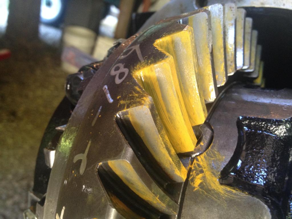

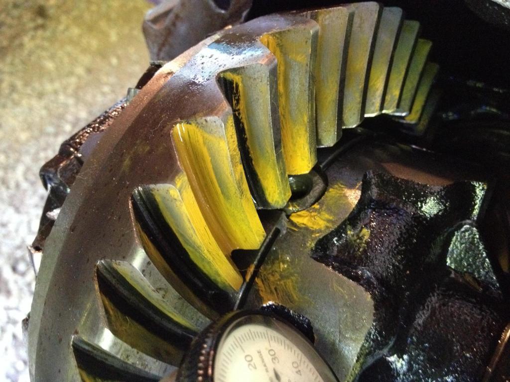

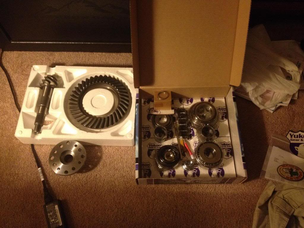

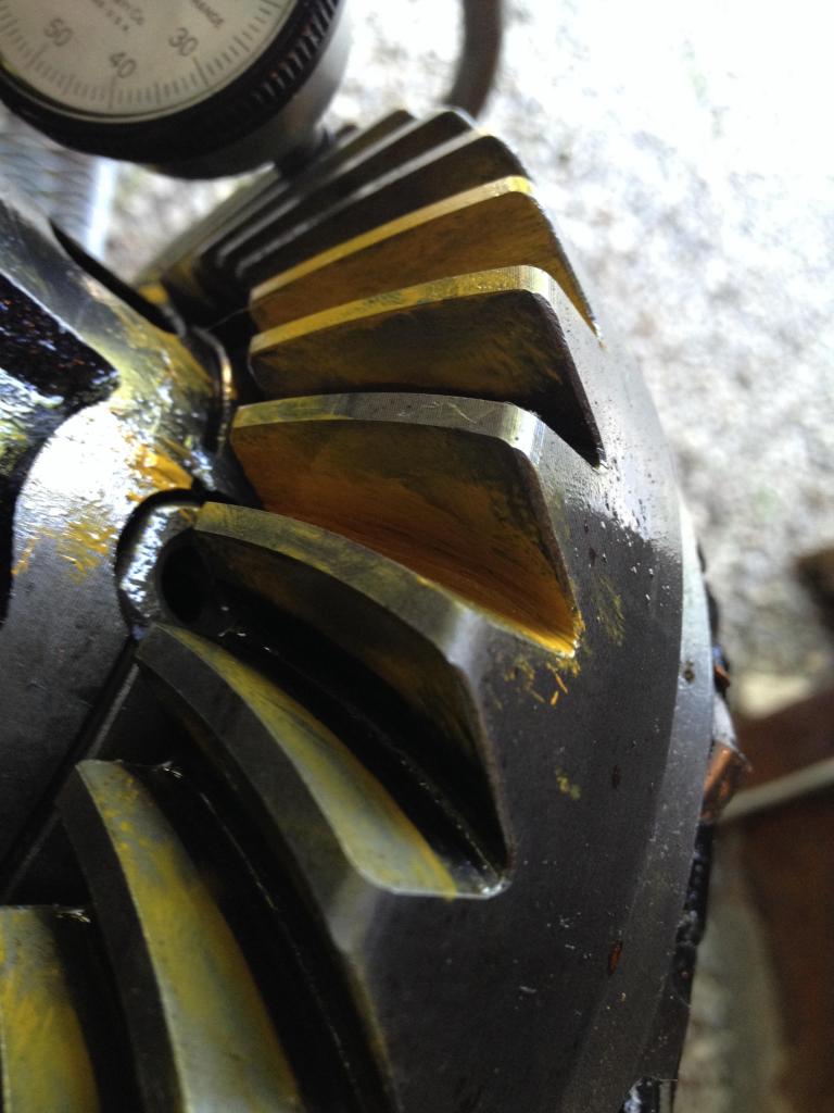

I received my e-locker back today setup with 5.29s. I'm less than pleased with the result. I payed a friend to set them up an right now I'm not sure what to do. I think I'm going to just try and set them up myself. I have never set up gears, but I've done a lot of reading and I feel like I can do it if I take my time. In my opinion the contact patch makes me think the pinion is too shallow on the ring gear. It is difficult to see the pattern but the pinion isn't touching anywhere on the lower half of the ring gear. Just the top half.. And I put two indicators on the ring gear and both measured 0.029 backlash. Idk what the preload on the bearings is as I don't have the proper wrench to check it. Here are some pictures and a video.

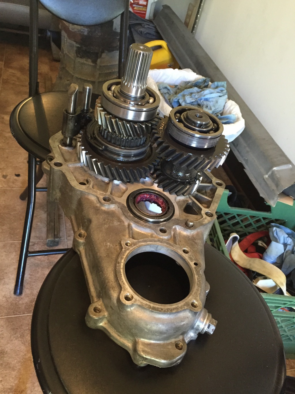

I may as well live at school and work, but I've slowly been picking away at this thing. I've ordered a bunch of parts - clutch kit and flywheel for the 3rz, e-locker motor guards, triple sticks, I got all my adapters in for the drivetrain and both 23 spline inputs. I'm probably going to send my 2nd bad e-locker to ECGS and they'll send me a fresh one.
I'm currently disassembling the rear case and getting the sections sandblasted before I install the 23 spline input, and then I can bolt it up the range box. Aside from that, the range box is ready to go.

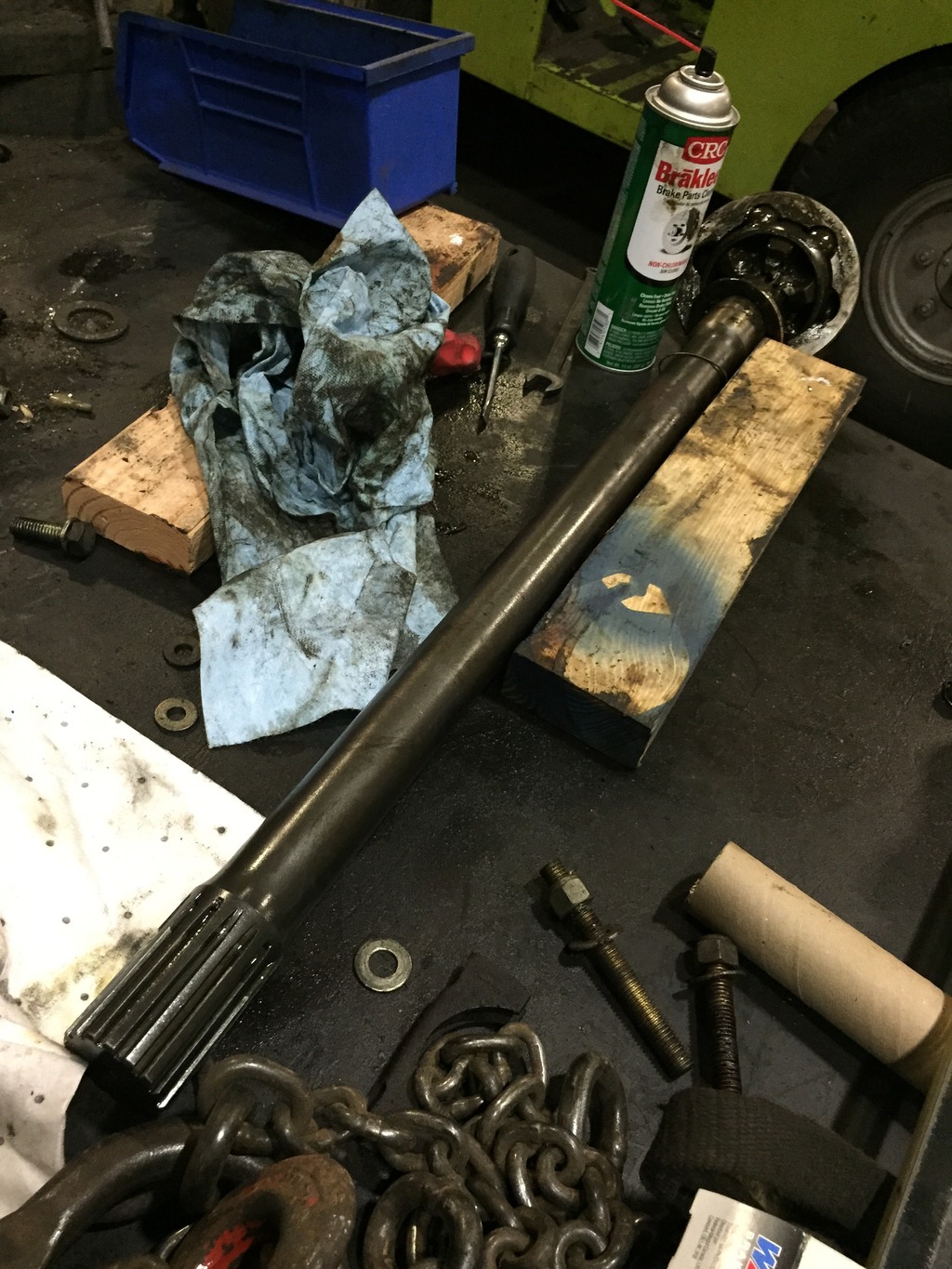

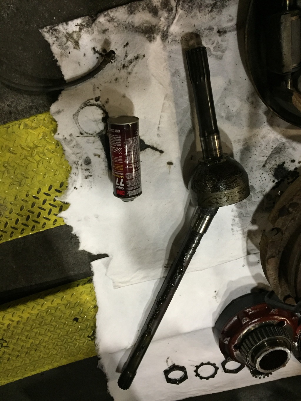

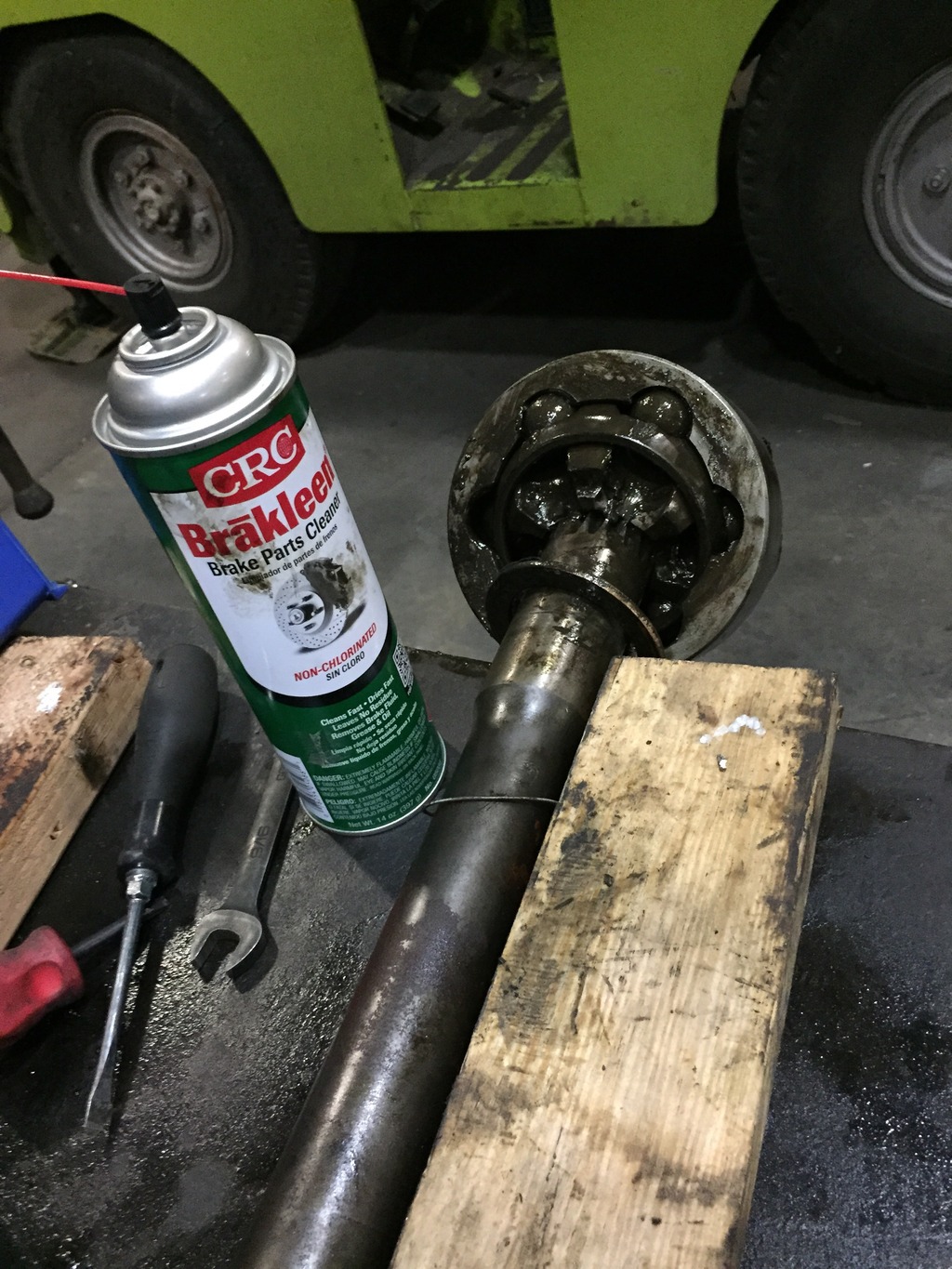

On a side note, wouldn't it be awesome if Toyotas had birfields this big?

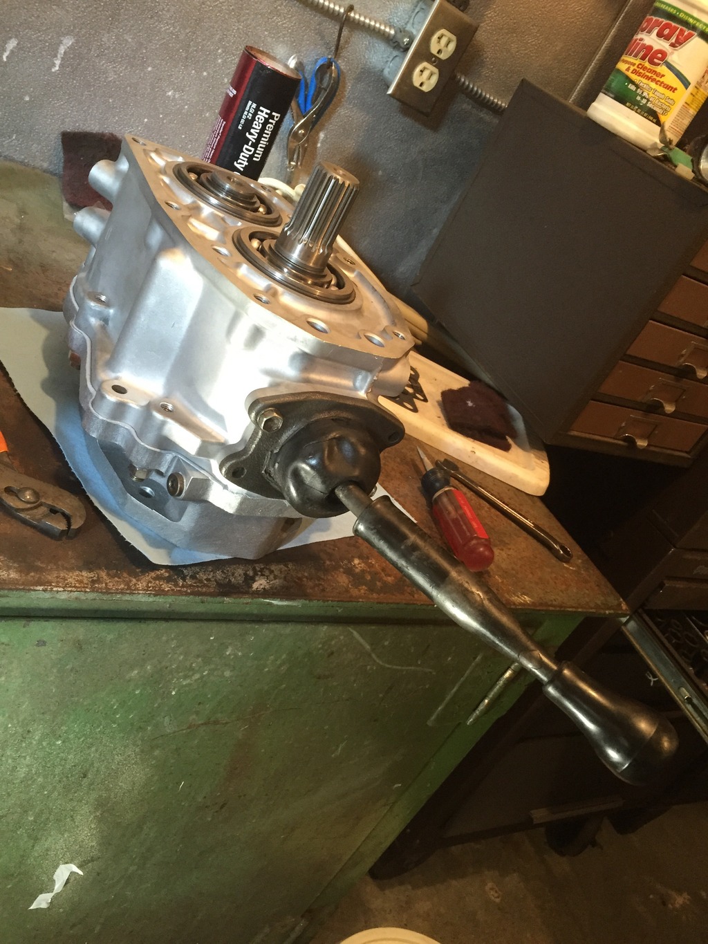

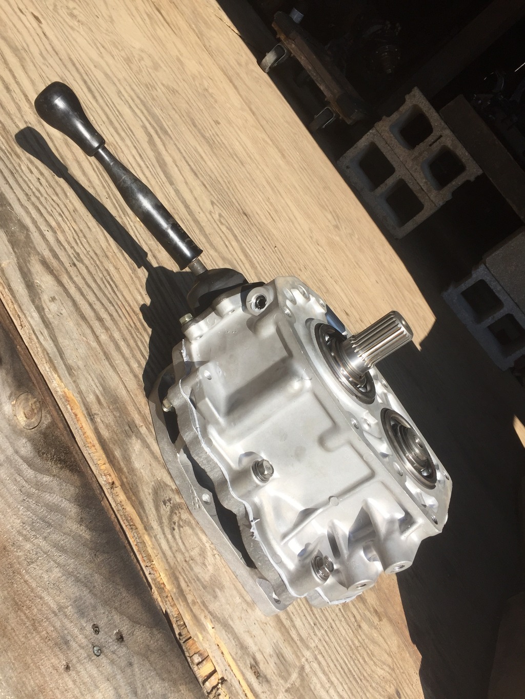

I finished up my drivetrain for the most part today. Bolted up the range box to the trans, cleaned up the rear case, installed the 23 spline input and resealed it.

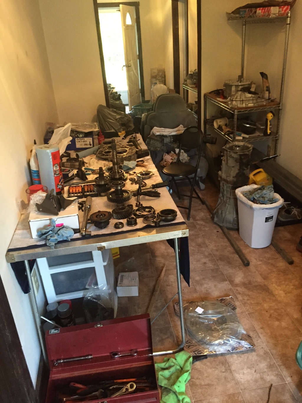

Here is what it's like to build a truck in your house:
Resealing the case with the new 23 spline input:
The rear case and triple sticks are only mocked up in this picture. I need to get a torque wrench that takes the replaceable inserts before I can bolt it up and torque it.
