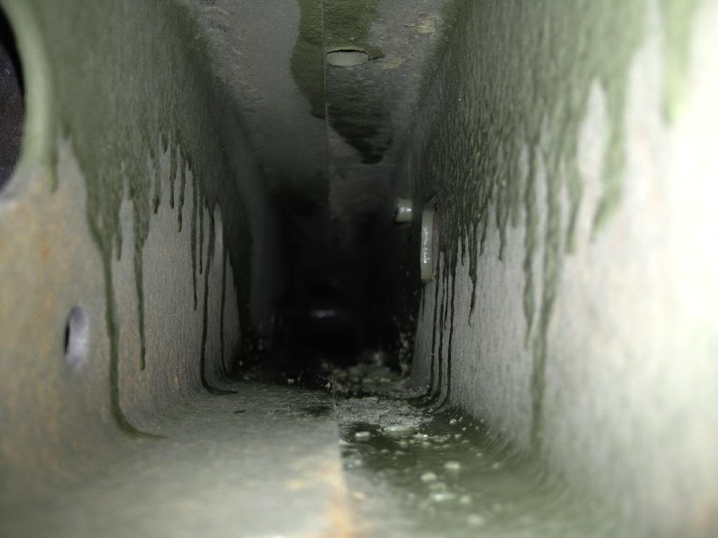

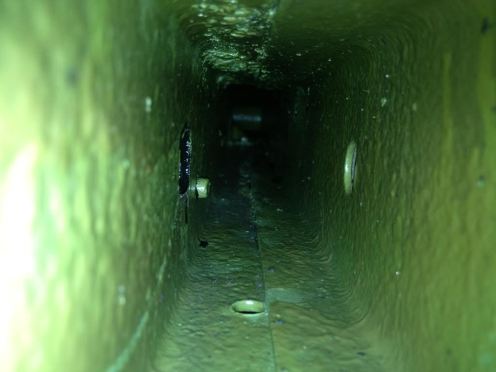

Here are two pictures illustrating the differences between Eastwood's Rust Encapsulator, and 3m's Rust Fighter with a Shutz gun.
The picture above is Eastwood's product. I ordered two aerosol cans which came out to about $30.00. This is only one coat. Two cans was enough to do one coat on both sides.
This picture is after doing 3 coats of 3m's Rust Fighter. Now I have about $110.00 total with this, that's the price of the Shutz gun, the 360 degree wand, and two jars of Rust Fighter. To me, the price is worth the piece of mind.
I'm sure if you spent the same amount of money with Eastwood you might get the same coverage. However, the nozzles that came with the aerosol cans had only 4 holes, so it wasn't truly 360 degrees of spray pattern. The wand I bought for the Shutz gun had 2 slots in it, and they overlapped each other making for a better spray pattern. Hopefully this helps anyone trying to decide what to do for the inside of their frame.

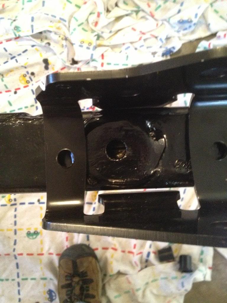

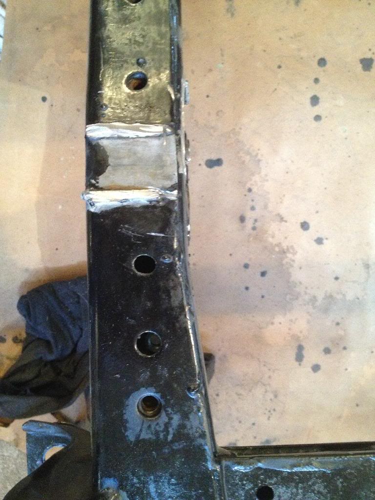

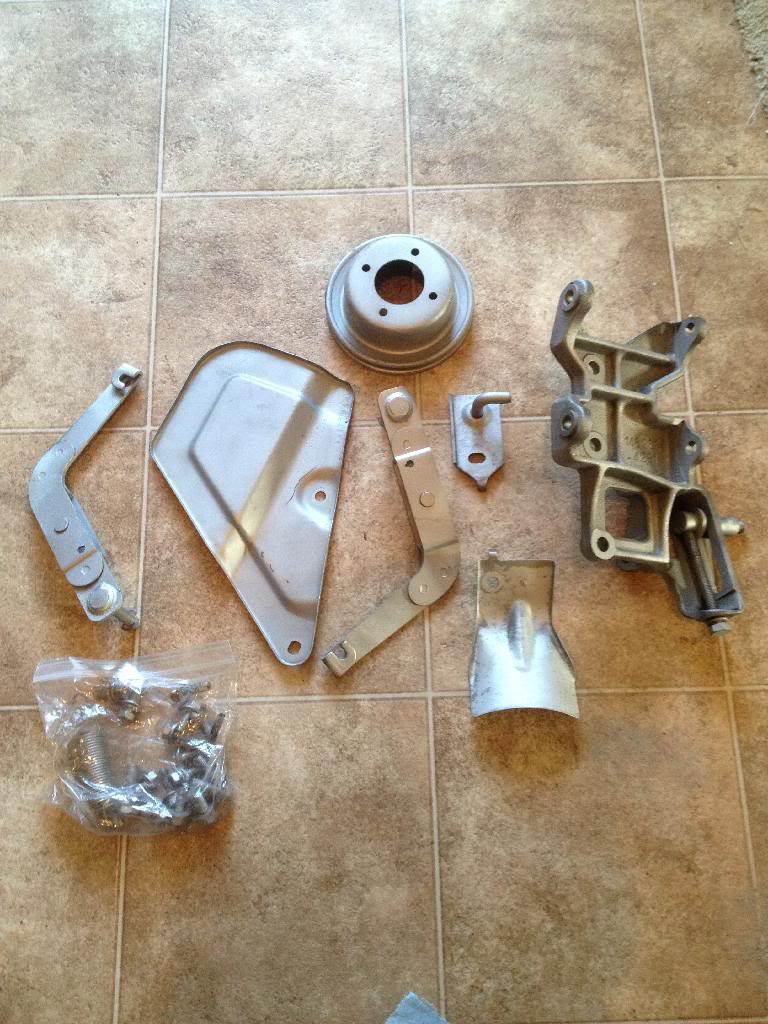

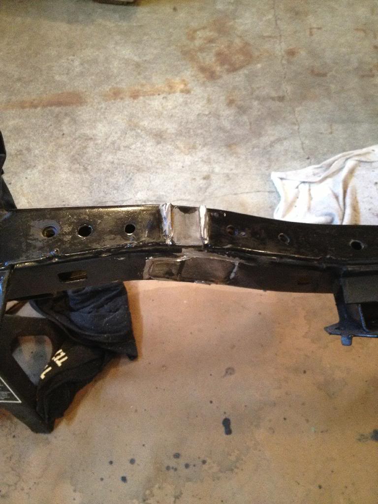

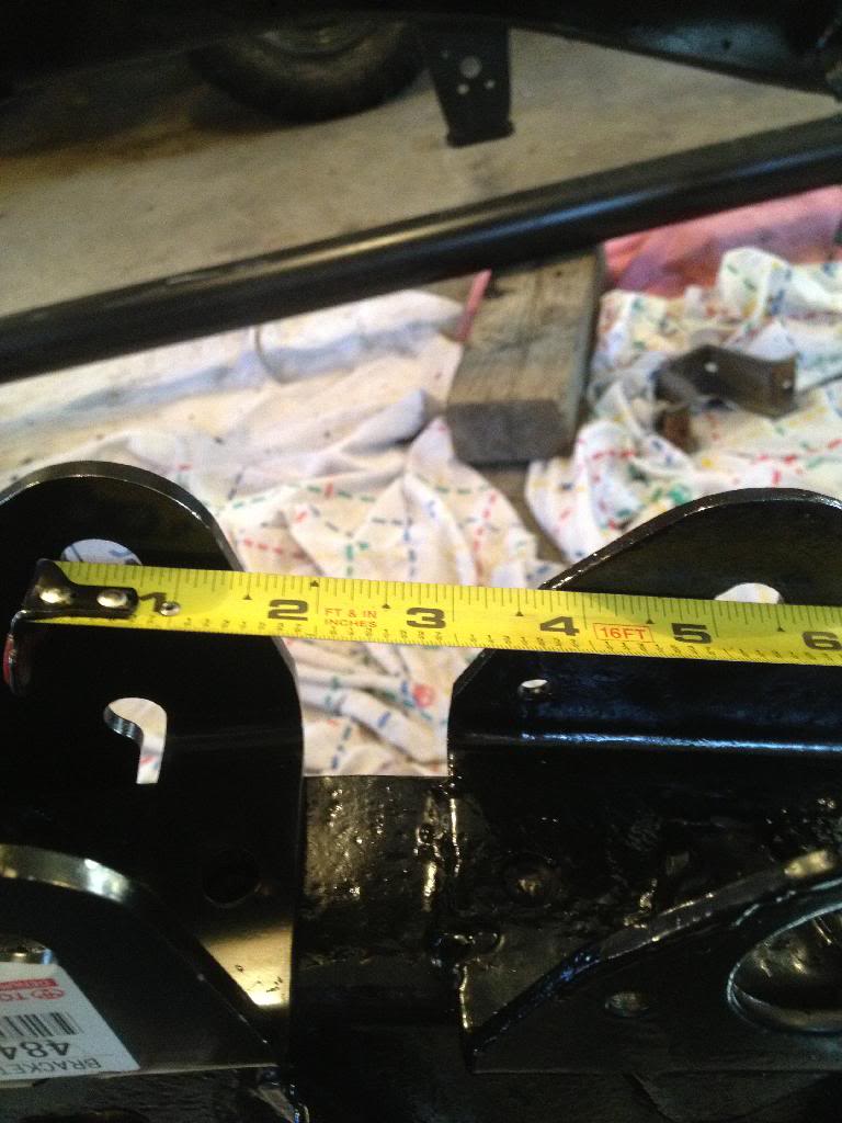

With the curve in my frame, what have most people done when mounting their IFS steering box mount? Since the mount is flat and will be in the curve. Also, would it be a wise choice to go ahead and do high steer without the cab on the truck? Or with the cab on? I've been leaning towards doing it with the cab on, since ill know what's there, what's in the way, and what isn't in the way. If there aren't any real issues then I'd like to do it with the cab off since there will be plenty of space.

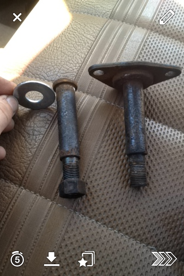

Also, I ordered a few parts for RUFS and the Mazda rear spring swap. Sky boomerang shackles, OEM bushings, and new rear spring hangers. I read somewhere a guy used OEM hangers off a 89-94 pickup for the rear spring swap because they were cheap, like $20.00. Well that wasn't the case for me. I paid like twice that. I noticed after I ordered that TG hangers are somewhere around $30.00, but there is a problem. When I was redoing my frame, I drilled drain holes in the bottom and welded washers there. TG hangers are mostly solid metal on the bottom, and where the new spring hanger is supposed to go, there is a big ass washer in the way. This is why I'm glad I got OEM hangers. The OEM hangers are partially open on the bottom. With the new hanger 5" forward of the old one, the OEM hanger just might work with a little bit of grinding.

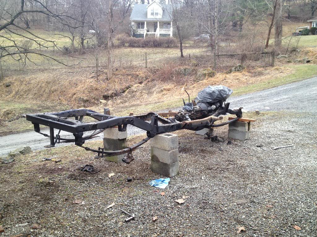

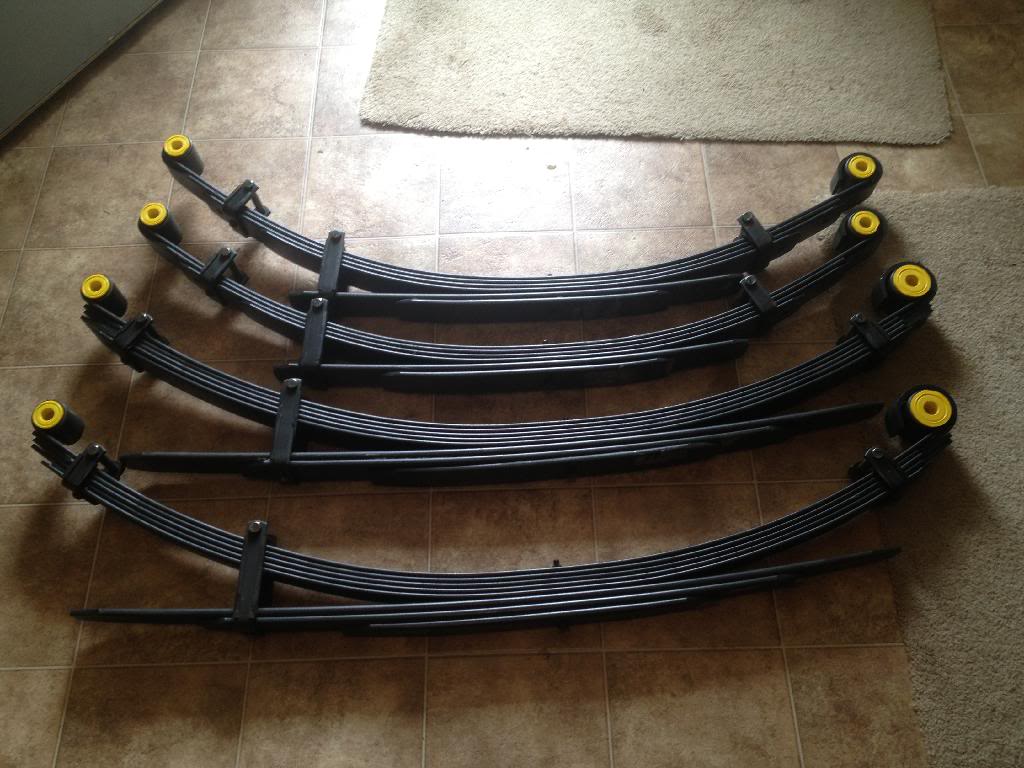

So I changed my Mazda spring plan and decided to do OME rears off of 89-94 pickups to use in the rear of my truck, which are 3 inches longer. Also will be using OME rufs for the front.
I'm not going to mess with any of the hangers yet until I have the truck most of the way back together. I couldn't reuse my old front hanger bolts because I mushroomed the threads too much when I took them out. So I beat the studs out of the rear shackle plates and made my own front hanger bolts.

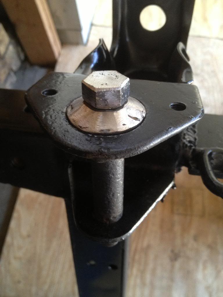

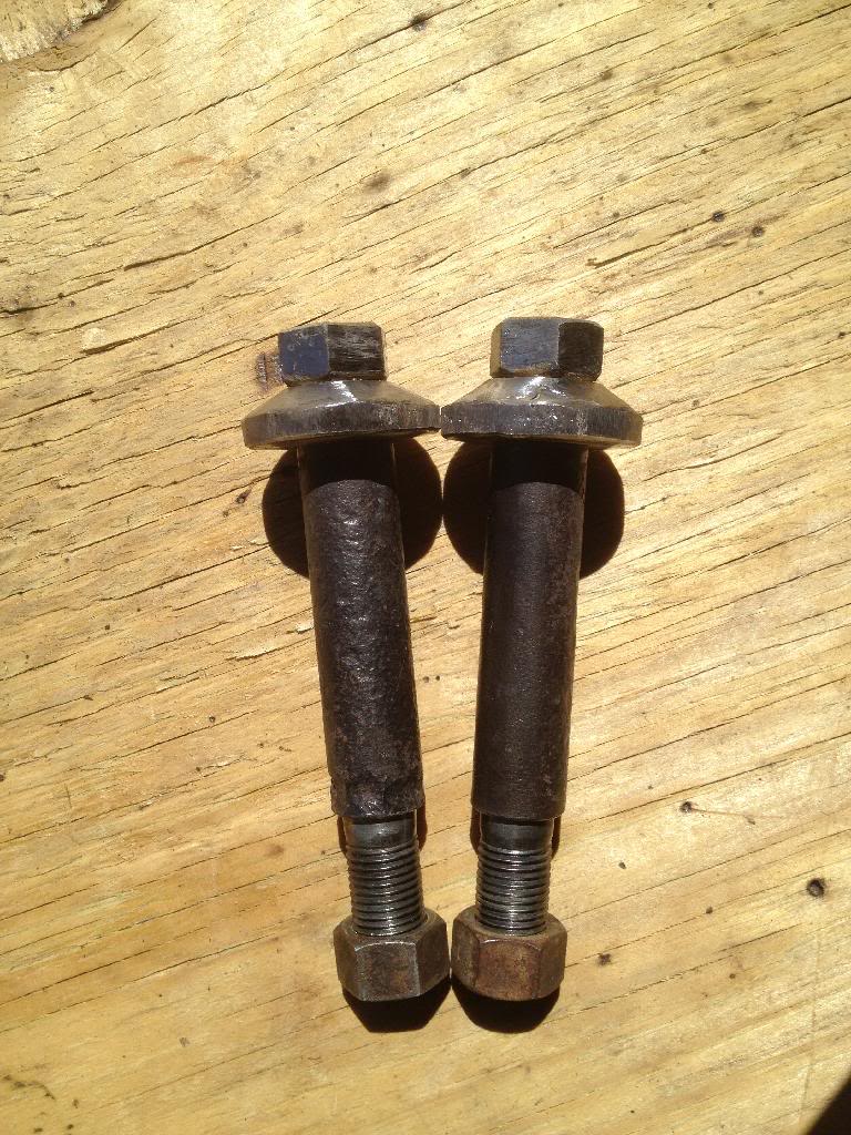

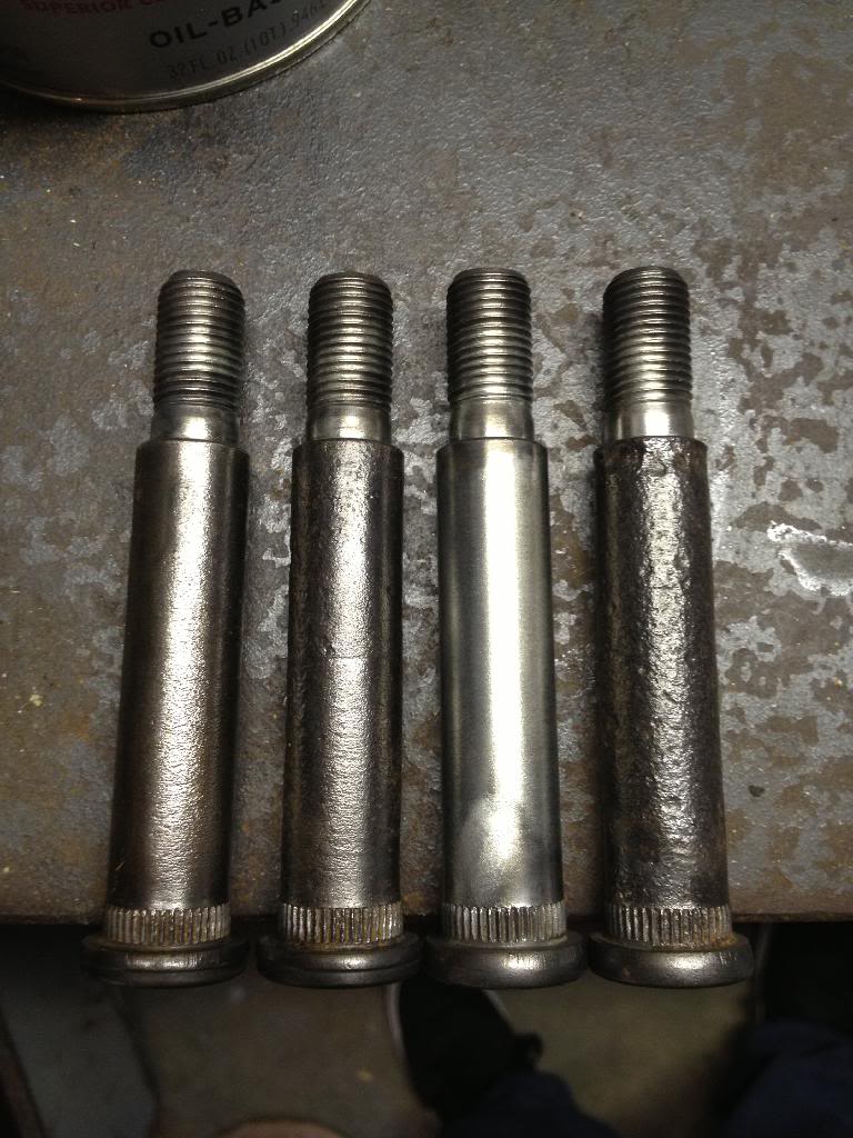

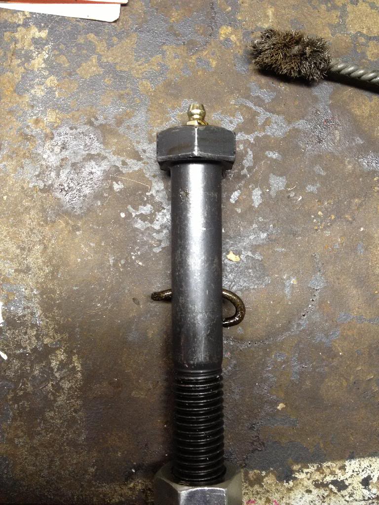

I also made greasable bolts for the rear shackles.

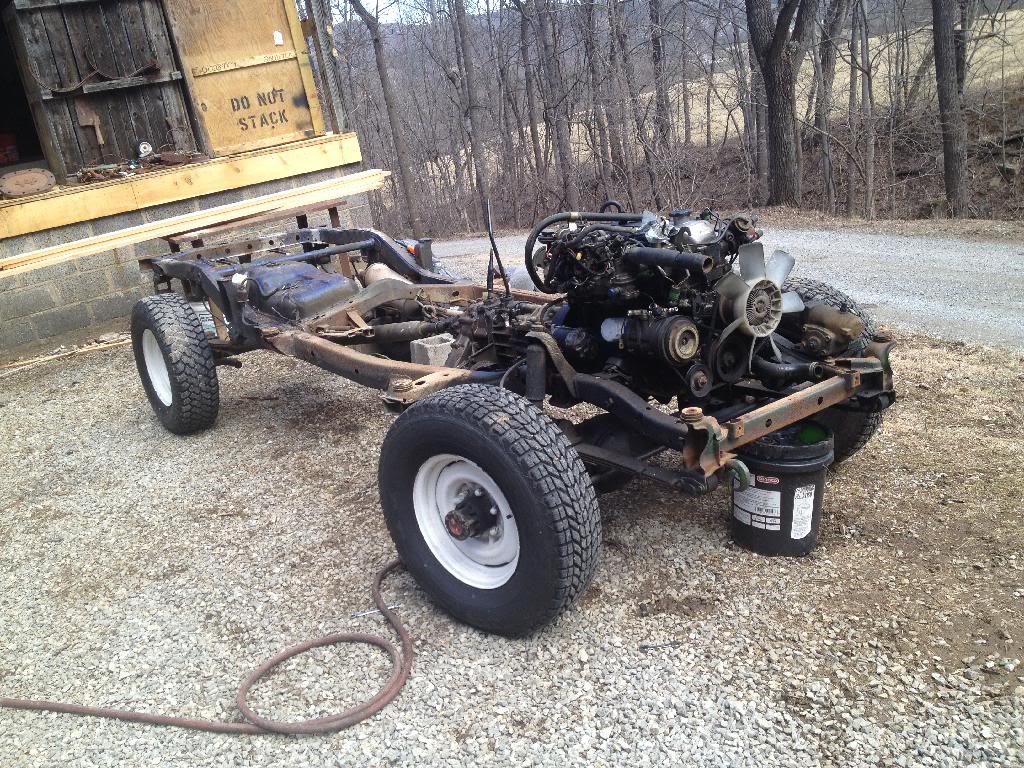

And I've since torn the truck most of the way down.

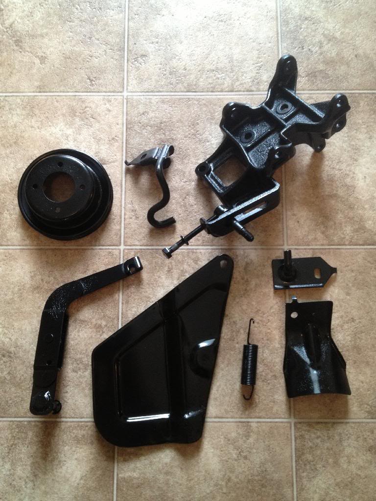

I painted up my u-bolt flip so ill be ready to mount my axles after I get the parts in for the front and get it rebuilt.

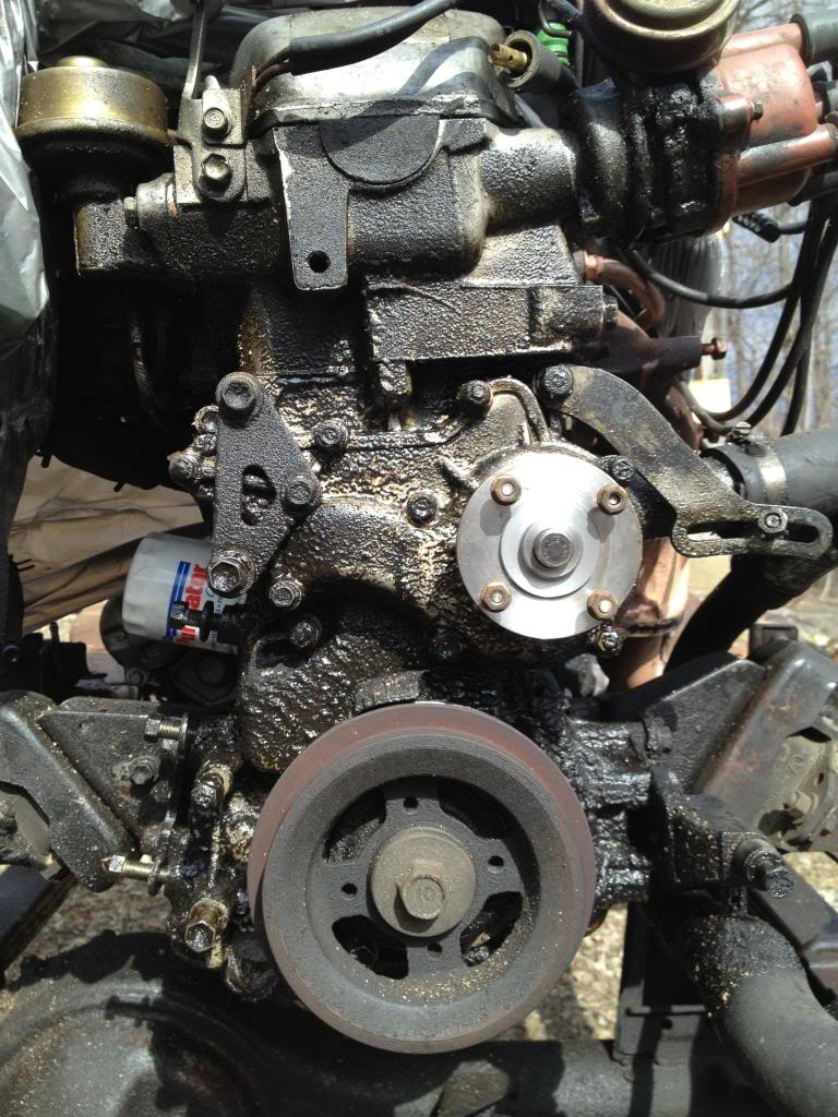

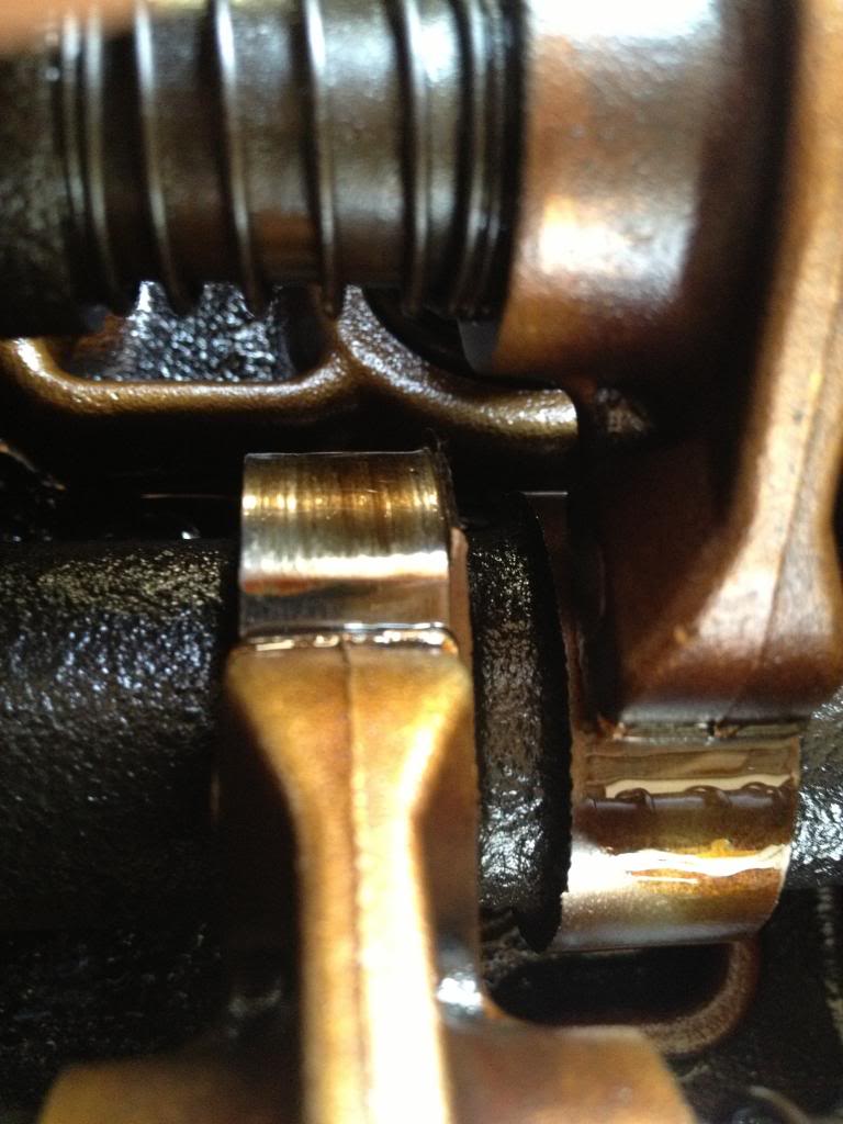

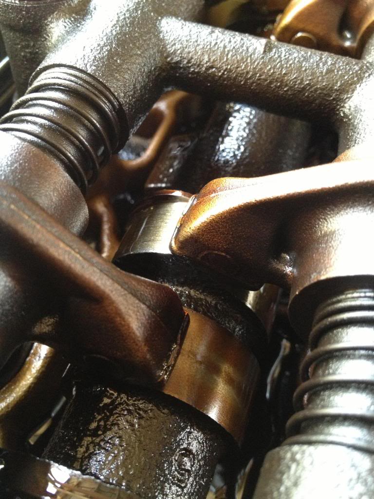

Anyway, I encountered a big setback today. I originally planned on putting all new gaskets on the engine so it had no leaks when it was all back together. I pulled the valve cover today, and this is what I found:
So I'm pretty bummed about my find. I hadn't planned on rebuilding this engine. When I drove this thing home, it was ridiculous how gutless it was. I'm surprised it even got me home looking at the internals on it. And the reason I don't want to rebuild it is because I'm sure it will still be pretty gutless after a rebuild. And I originally just wanted to do gaskets to hold me over until I could locate a wrecked Tacoma with a 3rz. Not only that, but by the time I spend the money to send this thing off to the machine shop, desmog, carb, exhaust, etc. I feel like I could have spent comparible money to do a 3rz swap. So I'm not sure what to do right now.

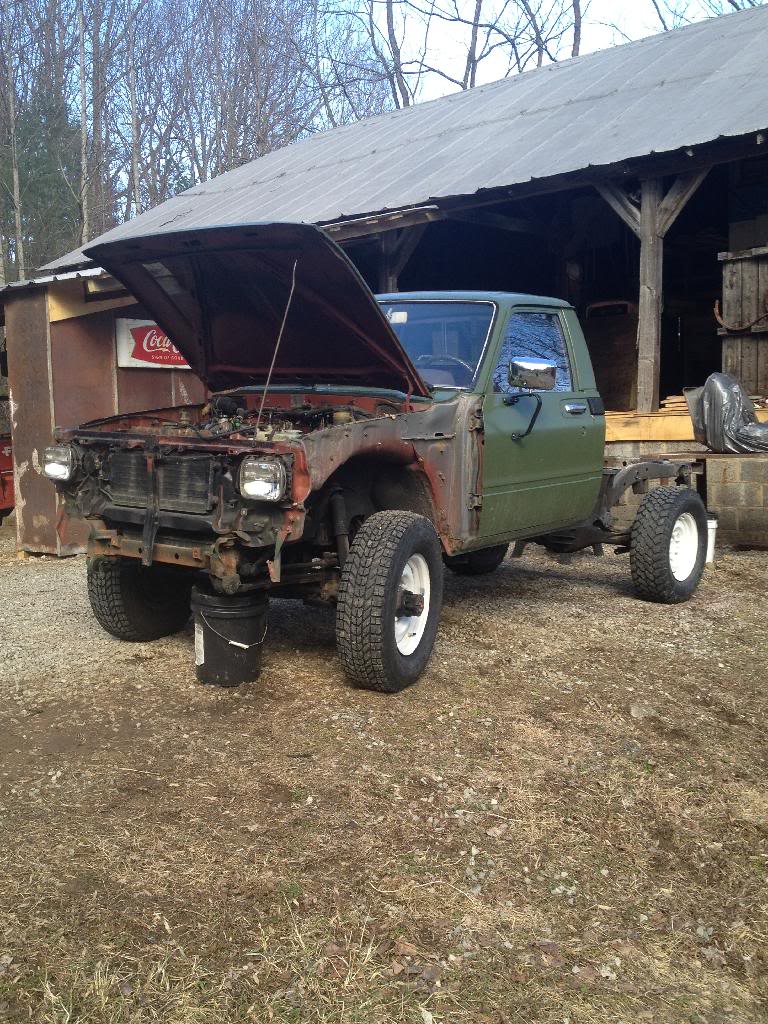

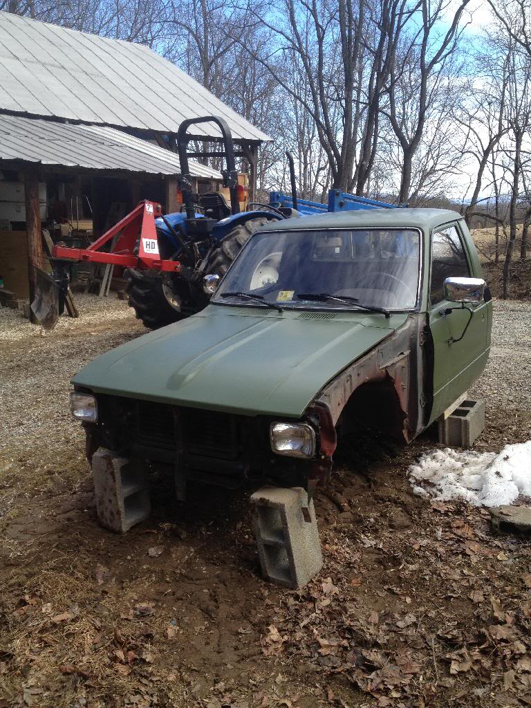

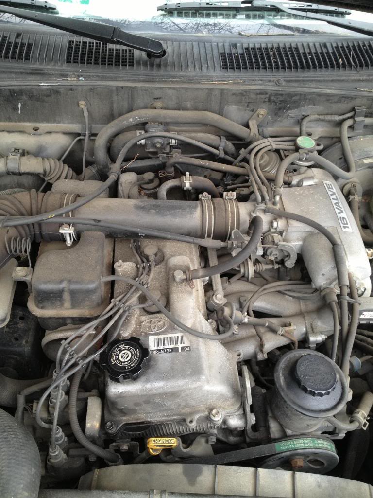

Update: bought a truck today minus the wheels and tires.
Has a running 3rz with 140k. One owner truck, and the guy claimed he changed the oil every 2k. Probably BS, but the inside of the valve cover where the oil fill cap goes looked new, so maybe not. Now I gotta figure out how to do wiring since I don't know s*** about it. Truck will be parted out besides the obvious thing I need.

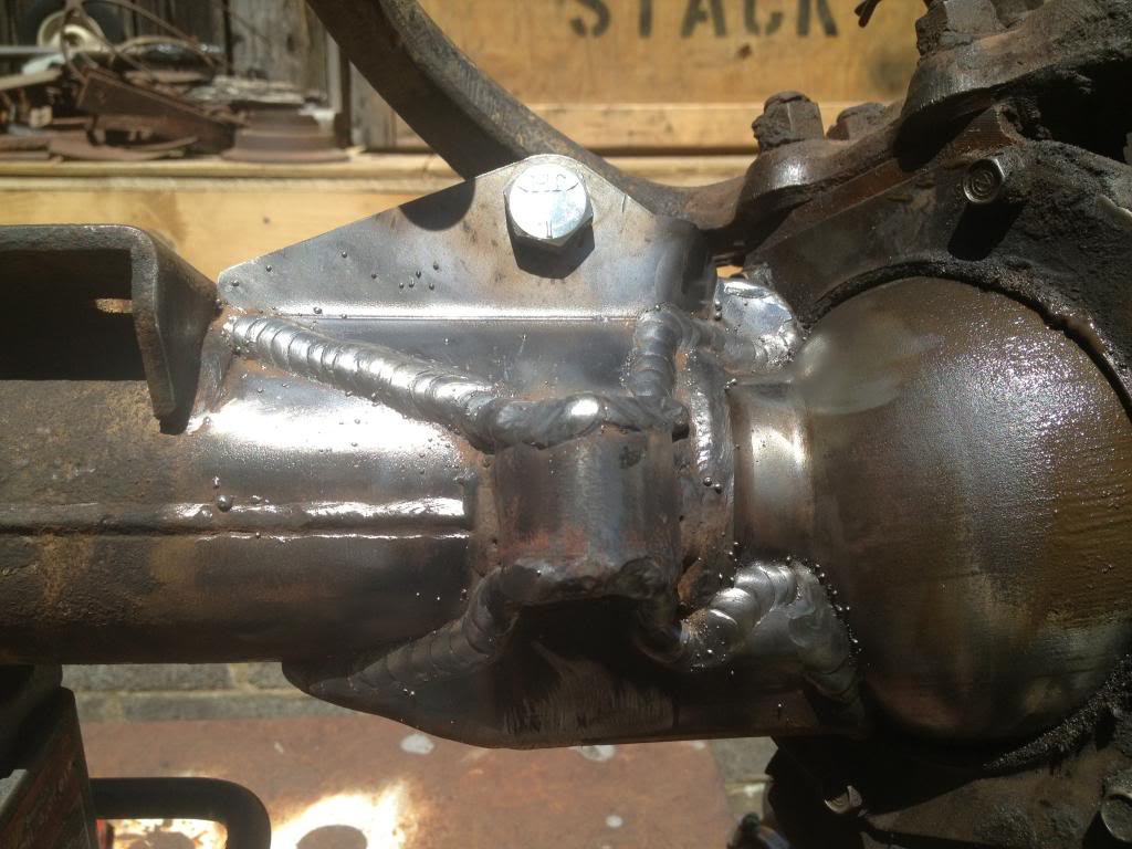

I haven't been able to find pictures of the gussets with the knuckles turned. You can see how tight of a fit it is. The metal rings clear fine, and the little scraper gaskets just barely touch the edge of the weld.

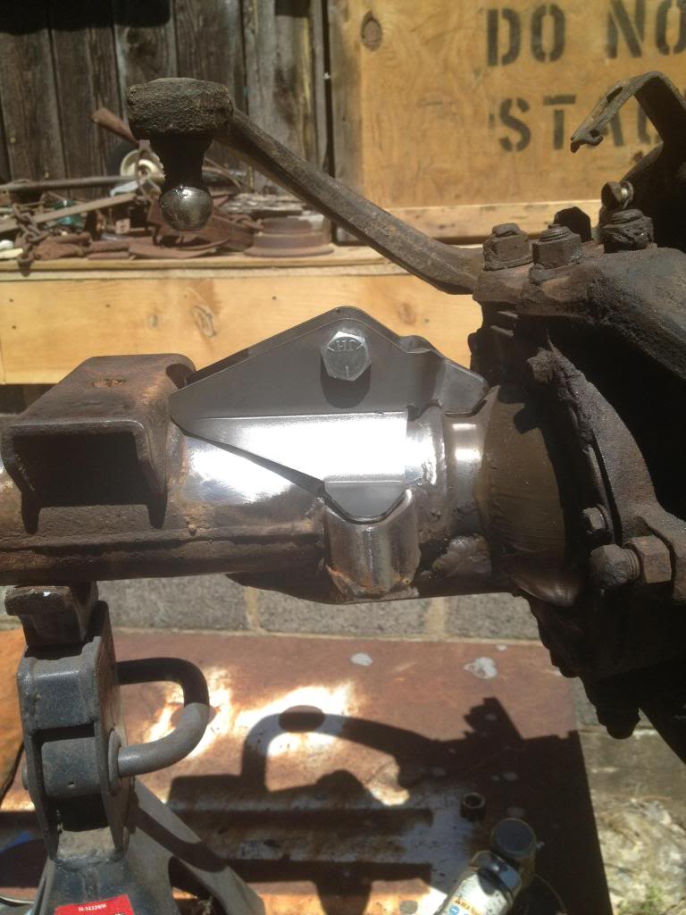

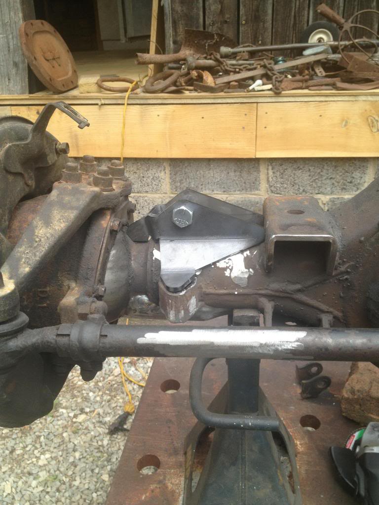

Finally finished all my knuckle gussets. It took me about 3hrs per gusset. Making sure the knuckle would clear the gusset and my welds took quite a bit of time.

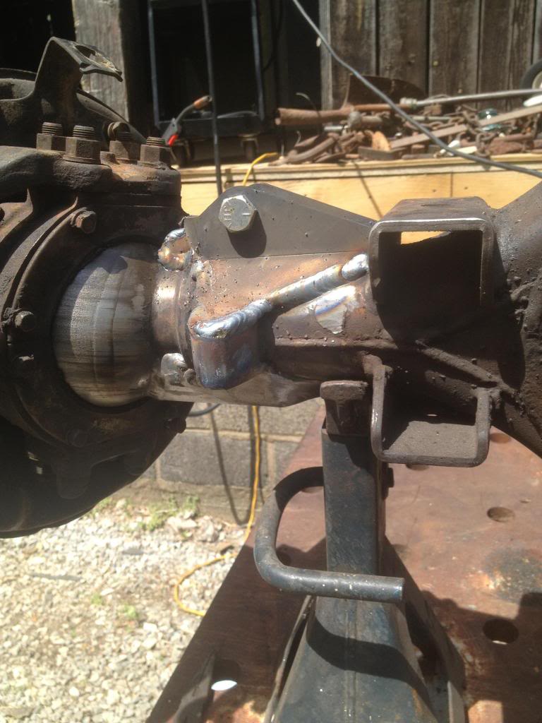

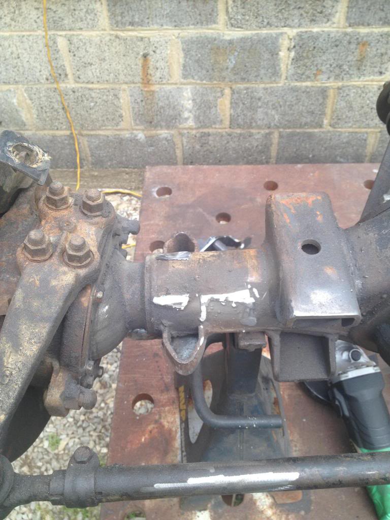

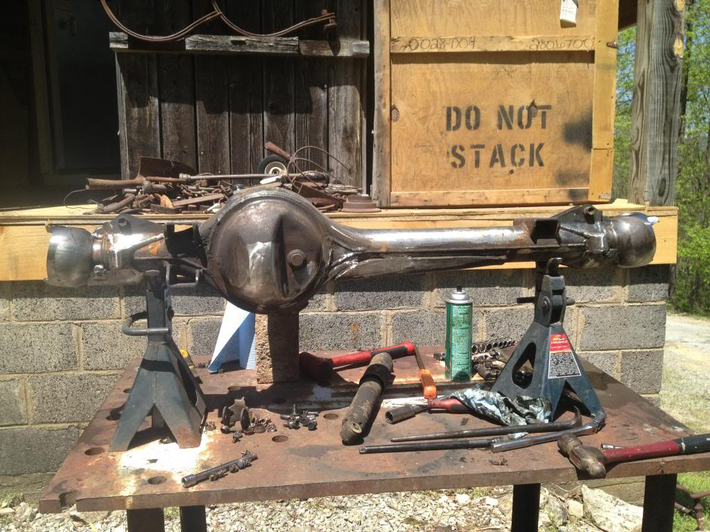

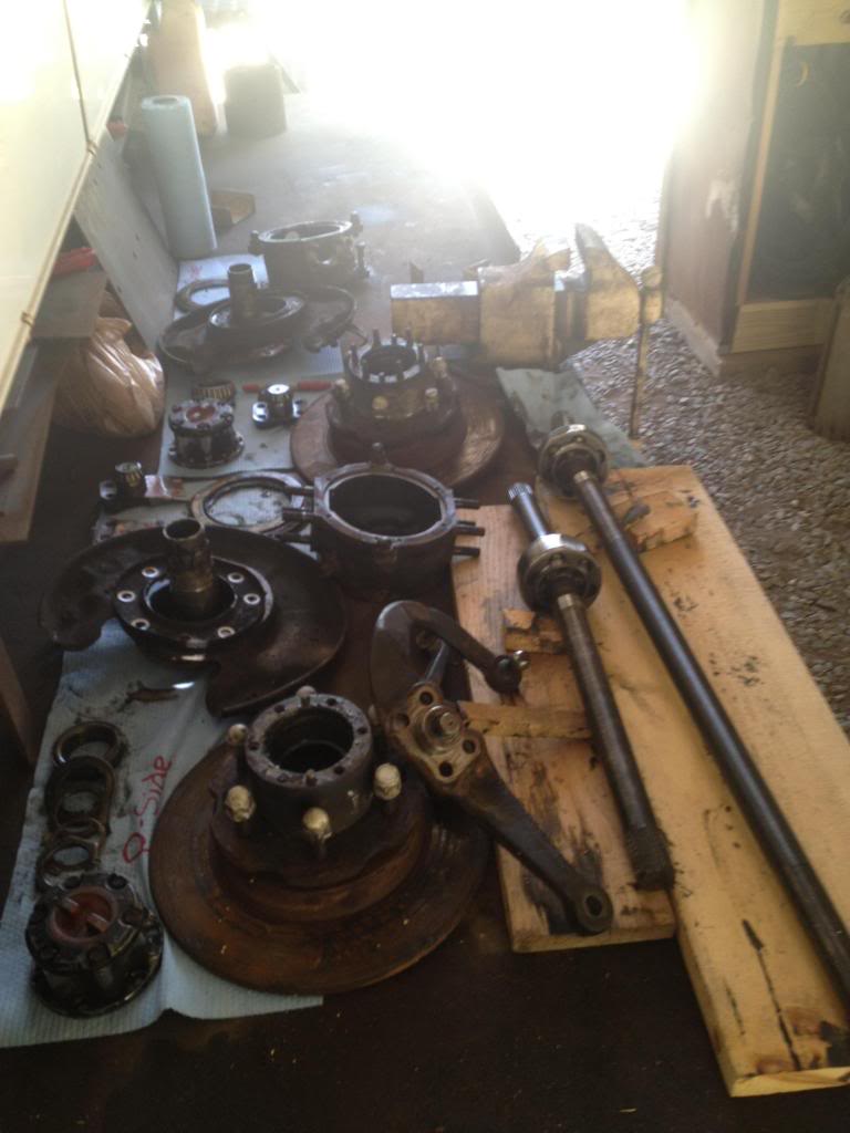

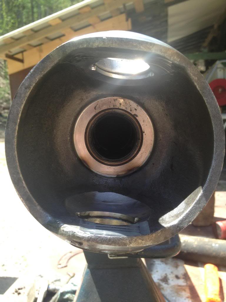

Made a little bit of progress on the front axle today. Got both sides torn down before work.

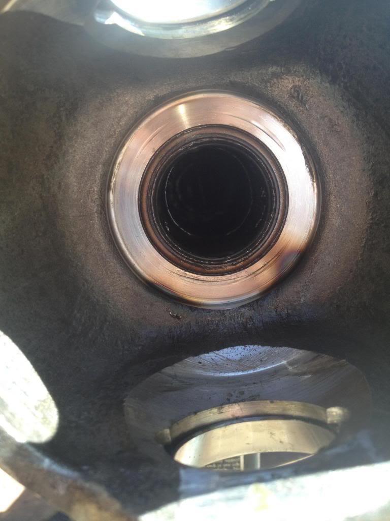

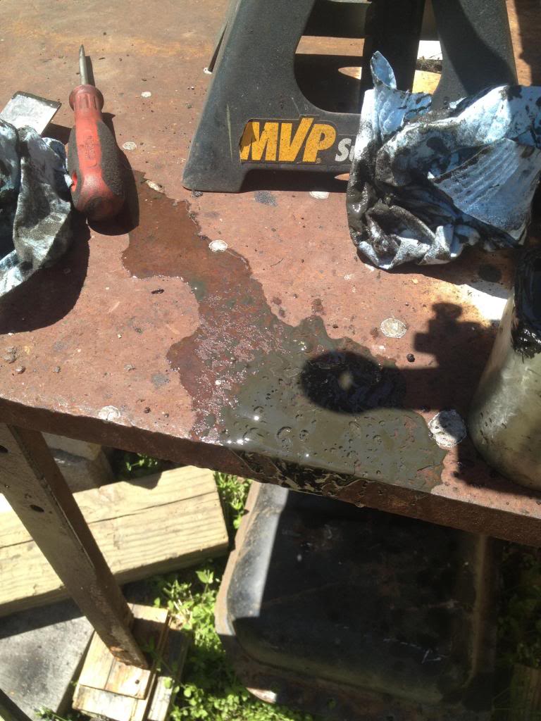

And I really hope I didn't warp my housing :/
I left the axle assembled in hopes it would help transfer the heat and to check clearances.. Hopefully everything works out okay when I put it back together.
Also, is there some sort of axle alignment tool for re-installing shafts? It seems like the inner axle seal could get damaged when putting the axle back in the housing..
