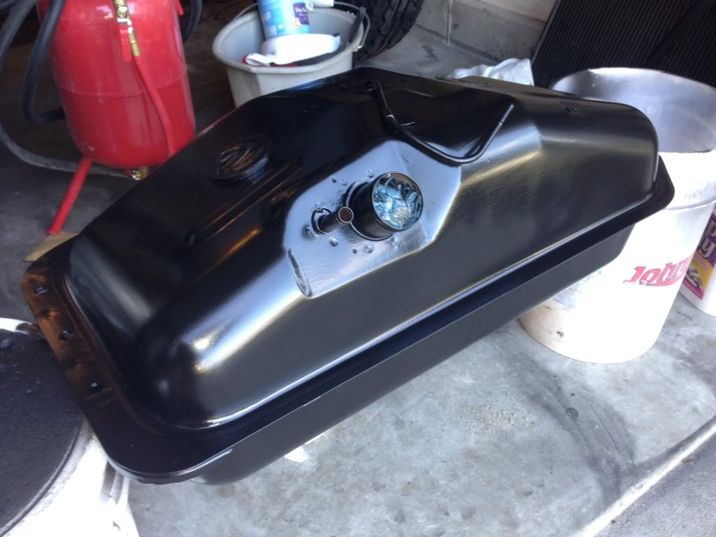

WEll, I promise you they do a good job. If you're going to keep it, it'll be a great investment to get that tank cleaned up, sandblasted out and sealed. Mines clean as a whistle now buddy. Before and after:

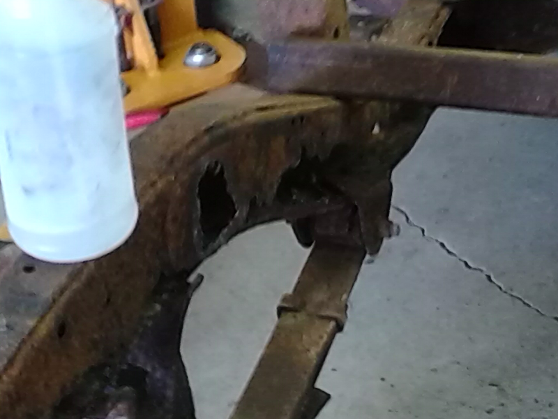

So I have came up with a few different options. I have a line on a fuel cell. 13 gallon. Now my only concern is it is off of a boat... so how could I do that? Other options are the f150 tank or a Heep wrangler plastic tank. Only problem with option 2 is it is a fuel injection tank so I would have to pull it apart n bypass the fuel pump... anybody have a pics of some tanks replaced with others?? The more pics the merrier!

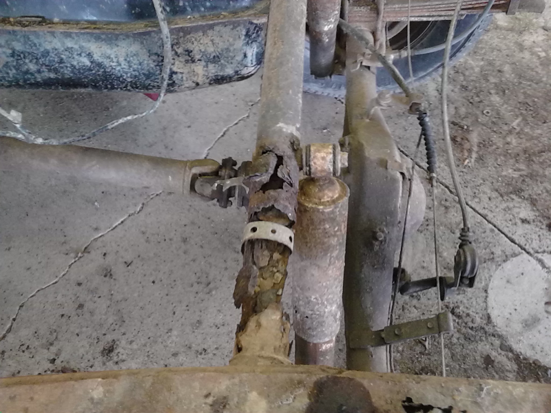

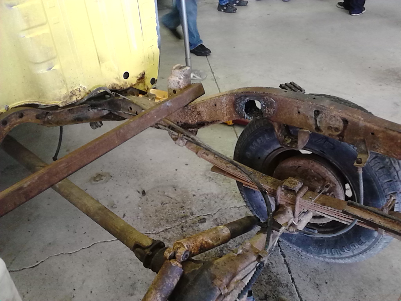

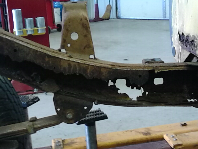

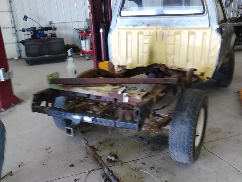

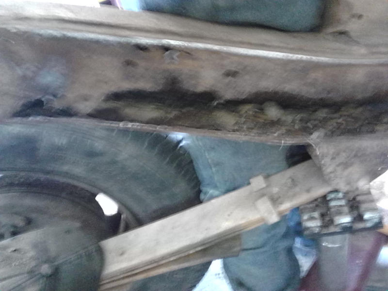

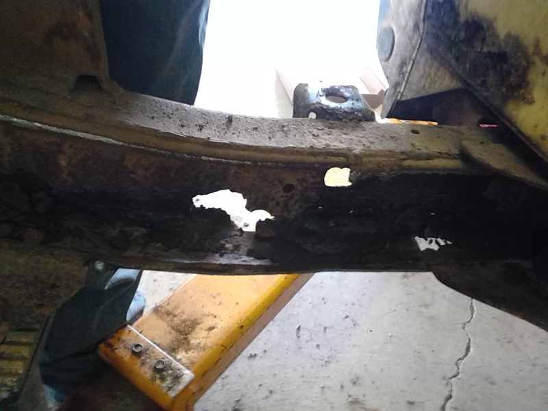

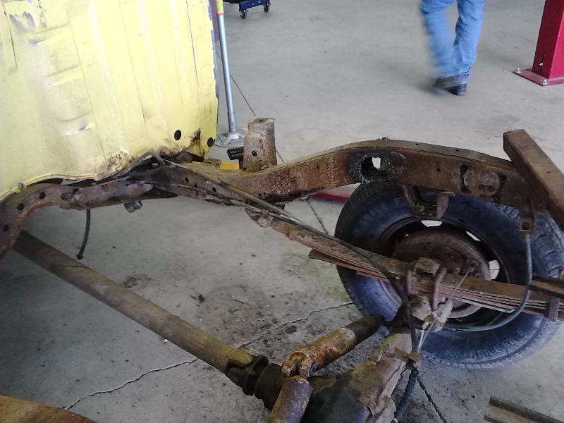

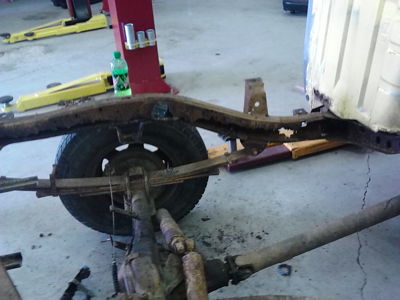

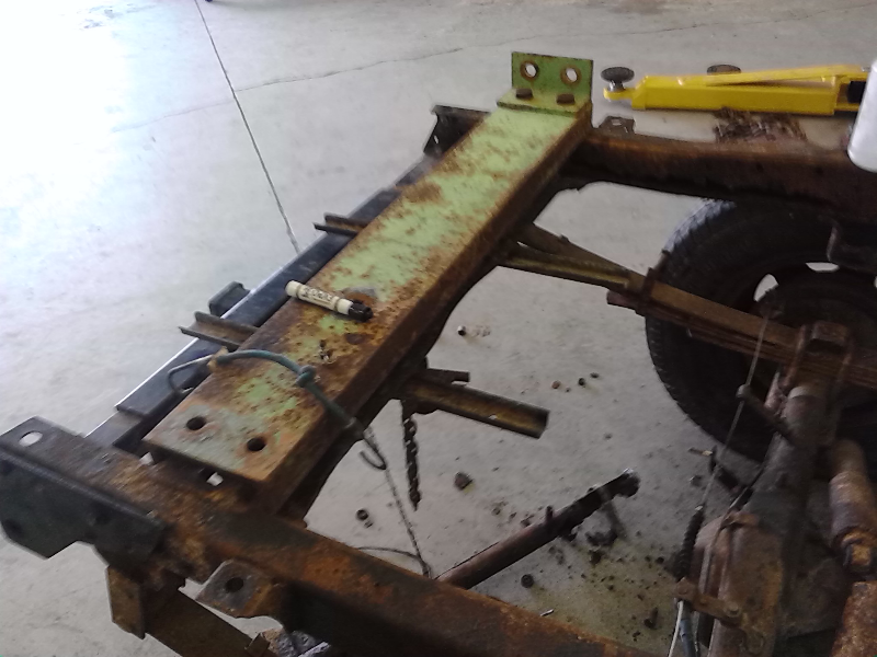

O how exciting my last couple days have been. Pulled the box off to do some frame repair and its turned into a back half repair lol here's some pics of the work so far. As you can tell the rear cross members are shot so they're getting cut out and replaced with bigger better metal .

Wow, first one I see that is worse than mine! But its fixable though with time and patience! Oh and a welder! but if that's what your back half looks like, the front might be pretty bad too, especially around the shackles. Mine was worse at the front than at the back.

Front is surprisingly good. Its got a few oil leaks that's preserved it lol. And yea its fixable. Everything is goin to be stronger and thicker so it'll be nice and stout .

Well.....guess ill be the one who says it. That frame is gone dude. Find another. Even patched well it would never pass inspection or be safe.
Dont kid yourself. There is nothing left.
Old Oct 8, 2013 | 08:03 AM
  #40
1980lwb's Avatar
Joined: Jun 2012
Posts: 157
From: petersburg wv
Pretty sure I have plated all the way down both sides. Inside outside top and bottom along with new thicker stronger cross members. I'm gonna give a guess and say its stronger now then when it came from Toyota. It will pass inspection since I had an inspector already look at it. If I could post more pics I would show you. Thanks for your opinion though.
