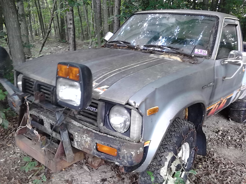

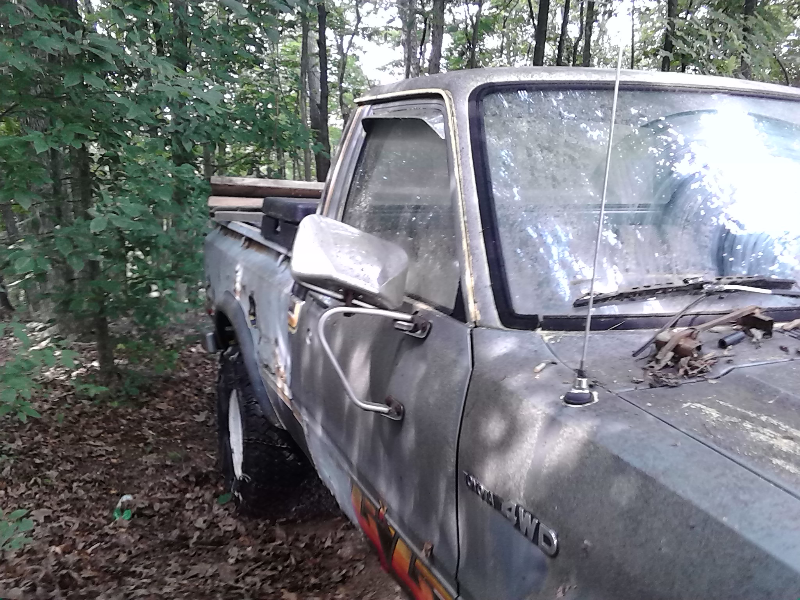

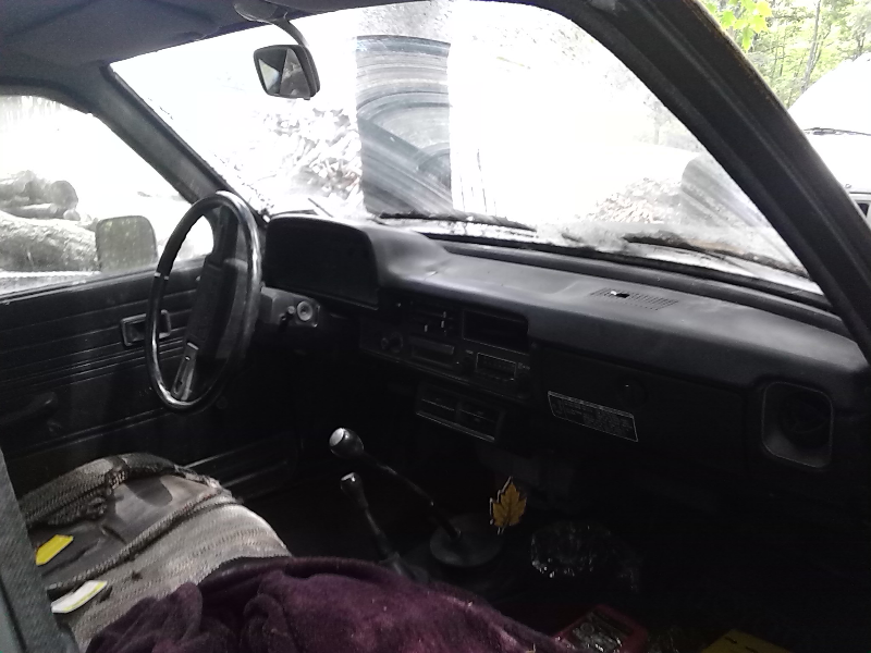

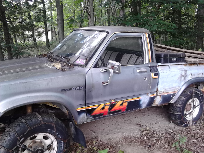

Long time reader but not a bunch of posting. I had an 80 before but had to sell... anyway I just bought another one. $500! Needless to say its not perfect but is great in my eyes! So I bought this truck off the 2nd owner and I also know the first owner! Pretty nice to be able to ask about the truck I think! So I bought it not running due to not getting any fire. Well it was just a few wires chewed in two... awesome! Well I did the obvious and disconnected the fuel line from the hard line under the hood to put some gas in a little jug. Ran good until it ran out of fuel. So then is when I ran into the problem. Once I hooked the line back up to run to the fuel tank it wonr start or eveb get fuel to the filter... when I crank it and stop to see if there is fuel, I can pull the line off the filter and it sounds like it is sucking air?? I hoping it is just a clogged line! Now to the good parts! When I had it running the a/c worked and the power steering was strong! So now with out anymore rambling I have some pics of my newest addition!
