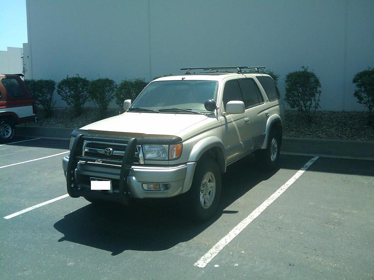

I dont know a lot when it comes to trucks so im here today just recently joined wanting to know the maximum wheel and tire size I can put on my '99 runner. Im going for a buffer look. I want to put all black wheels on and some bigger tires.
